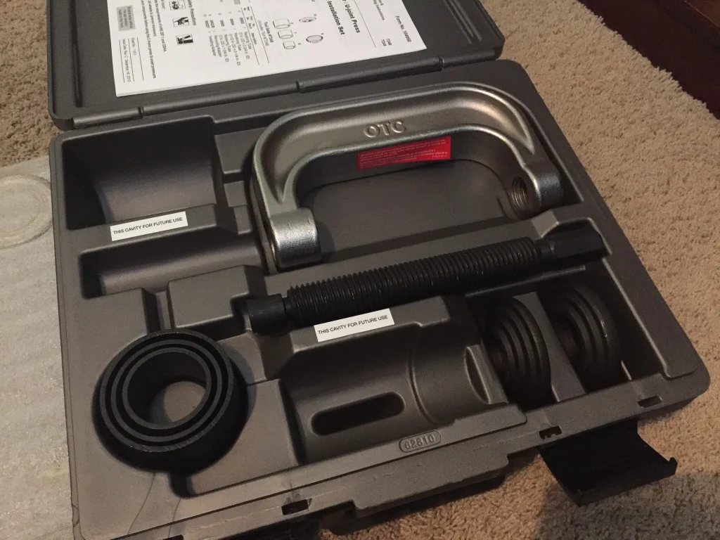

For anyone considering an OTC ball joint puller - this is what it looks like. I just got it in the mail.
