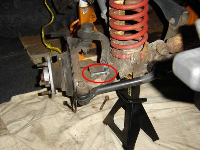

Well from the vibes that ya'll have about unit bearings, i'll be replacing mine too since my Jeep has over 118,000 miles.
As I understand it, the unit bearing nut (the 36mm nut), needs 240ft/lbs to be torqued correctly?
No that is too tight. It is 175 ft lbs if i remember correctly.
Reactions: Kyle_W
Reactions: Kyle_W
Shout out to @mrblaine for the unit bearing removal tip using a 2 1/2" long bolt and turning steering wheel, easy peasy.
