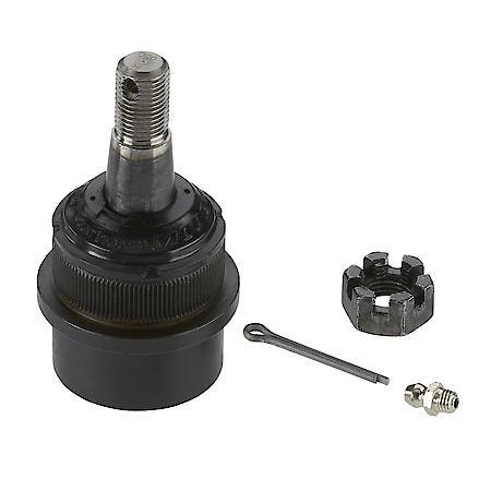

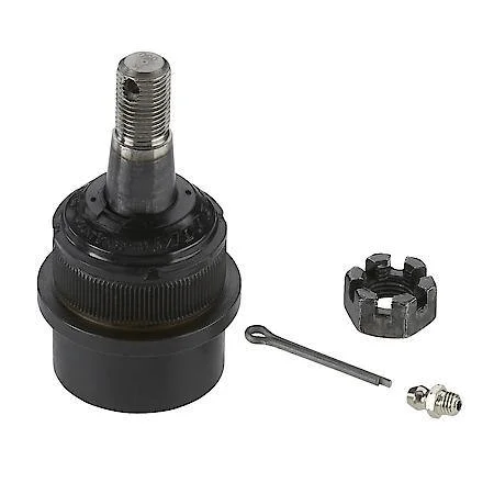

Need some advice...i need to do my 2nd replacement of ball joints soon. Problem is I dont remember if the first replacements are knurled or not. I purchased moog from advance auto and they seem to sell both versions. Am I stuck with knurled from now on if the first set were? If I cannot go back to using spicer, whats a good knurled recommendation?
Get the Spicer joints. Use Loctite 680 if you had knurled joints. Make sure to buy the Loctite primer, cleaner, activator also.

I don’t think the Moog ball joints are knurled. Looking at pictures of them they appear to be smooth

86375
https://shop.advanceautoparts.com/p...-k3134t/20516027-P?searchTerm=moog+ball+joint
I think these may be the ones I used.
