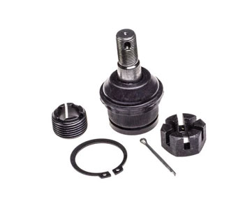

I can't figure out what the C-clip and that other thing with the threads are for.
I've already removed both ball joints and all that came out was the ball joint and what was left of the dust boot.
Some of the parts aren't needed for the TJ application, and are to be discarded. I never needed the coil or the clip. You will need the nut and cotter pin for sure.
Pre 90 Jeep knuckles don't have a floating upper pin like the TJ does. They do the adjustment with that threaded sleeve in the lower hole in the knuckle.
