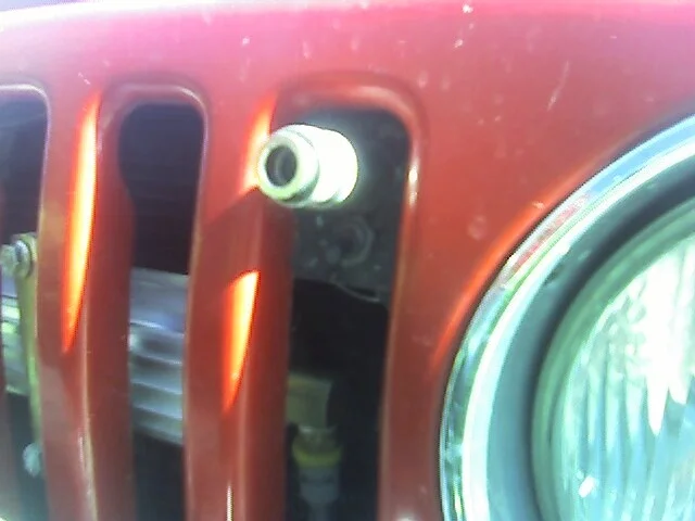

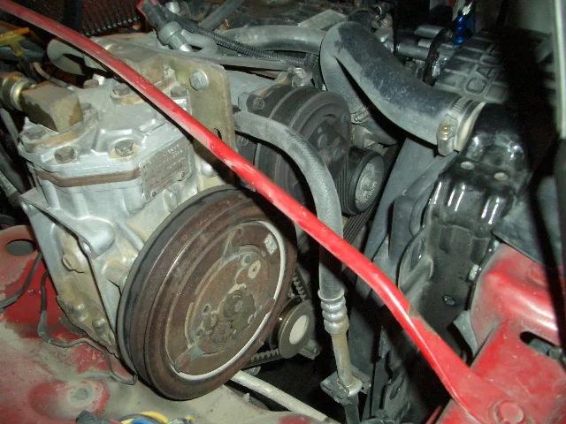

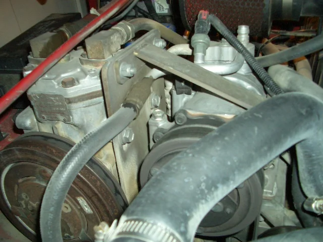

This is how I did my York system in my previous TJ. One key point to keep in mind if you plan to use flexible hose at the compressor, make sure the airline leaving the compressor is rated for high temperatures! Standard air tool type air line won't survive the hot temperature of the air leaving the compressor and it will fail/blow out. I found that out the hard way. Goodyear high temperature hose is what I ended up with, the red hose below, and it worked great. I found it at a hydraulic hose manufacturing shop.

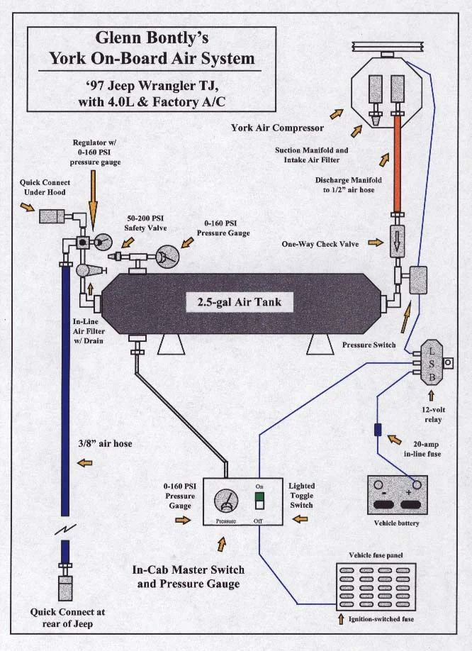

There's no need for half of the stuff shown below like the pressure gauges and relays, the compressor's solenoid doesn't draw enough power for that.

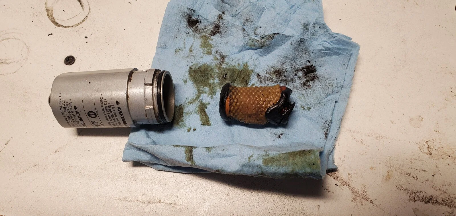

No, I am referring to a cooling device. Such as a transmission cooler to cool the air/blow-by. I dont have enough experience with a york, but on my sanden what little oil that is coming out is incredibly hot. So much so that it melted the filter within my coalescing housing. I know @jjvw installed a cooler on his york set up.
Interesting, I never had that problem but I do run several feet of hose before the filter. If you install it on the firewall you should also make sure it's not too close to the exhaust manifold (or shield it) because that shit gets HOT.
I just bought a small power steering cooler to cool the air so it doesnt melt. I did what @jjvw did
I got mine from a newer junk yard Grand Cherokee. It lives in between the pump discharge and the manifold. There is quite a bit of temperature difference on either side.
