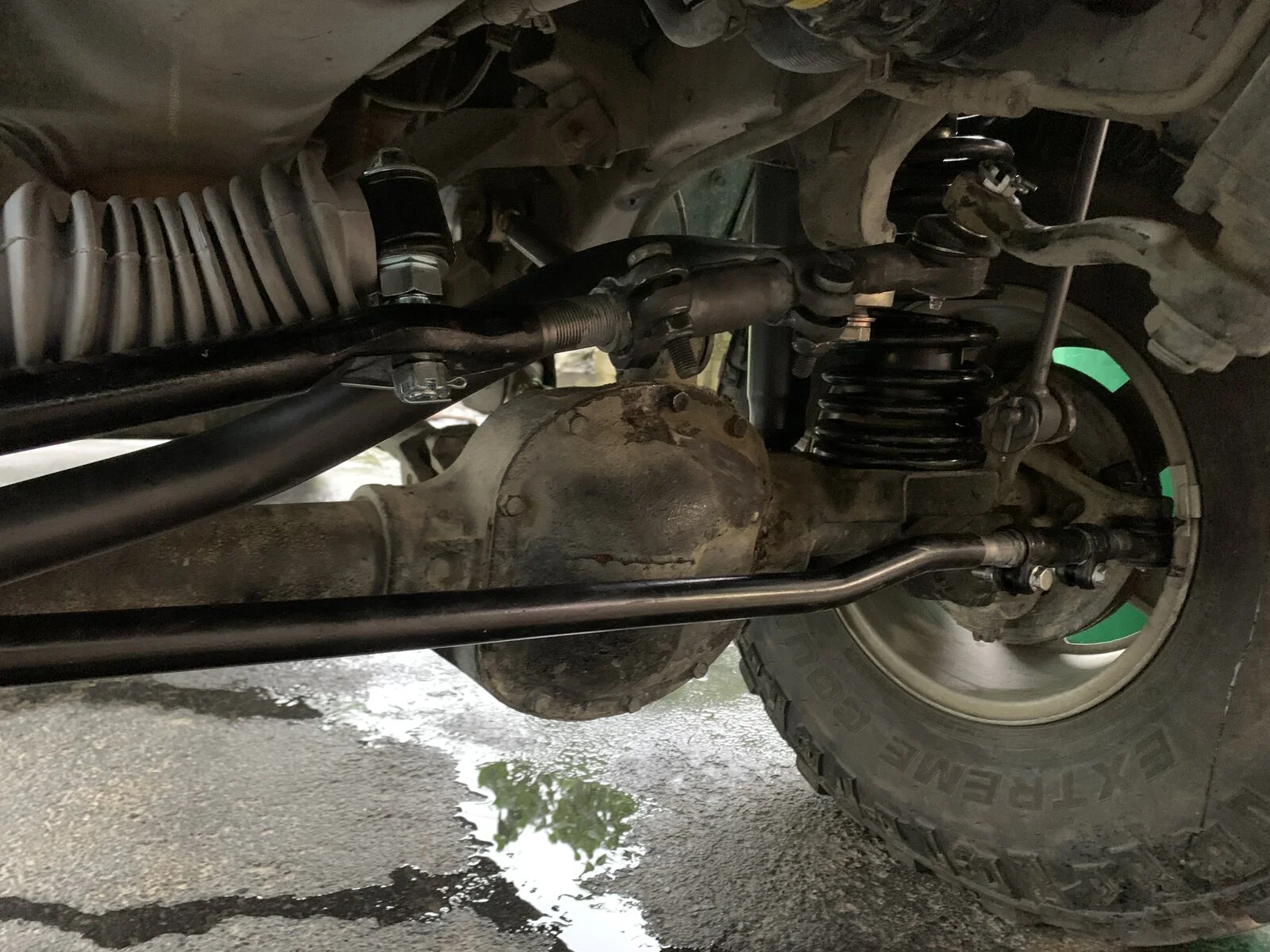

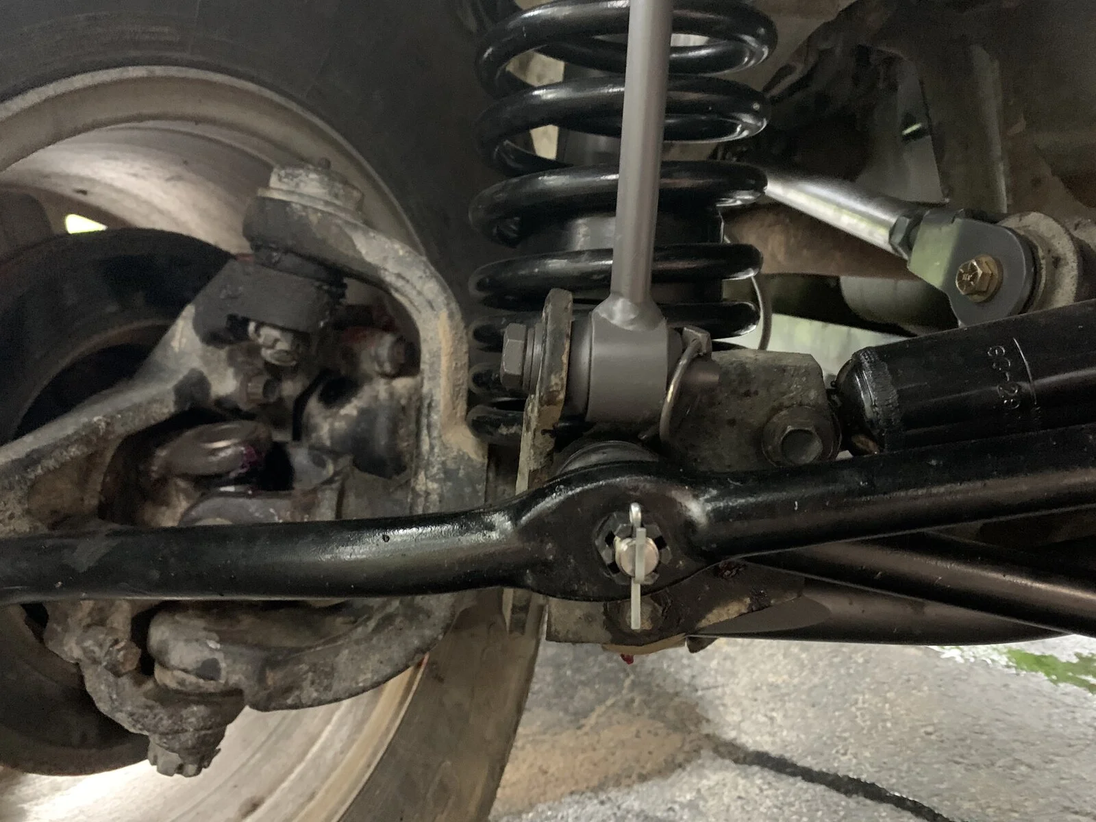

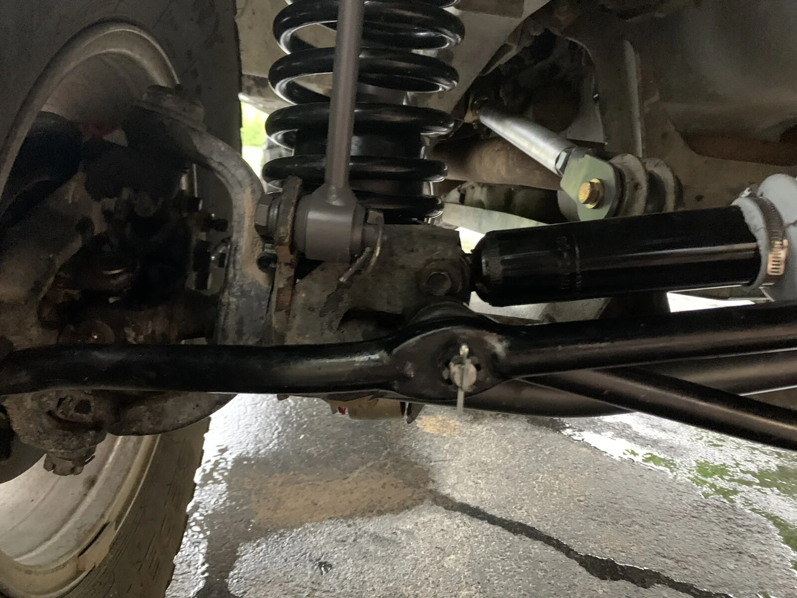

Along with my 4” lift this weekend O installed the is ZJ “kit”. I purchased all NAPA parts because that’s what I do often. 🤷‍♂️ Attached is a few photos. It seems the tie rod is contacting the sway bar link at full steer. I didn’t notice til today when I started to look in to where to hang the links when disconnected (let’s leave that discussion for another time)
Photos are of straight wheels then last photo of full turn right
What do you see??
thanks

Wait. Do I just turn the stud 90 degrees so it clears? It’s pouring out so I’ll let you know
