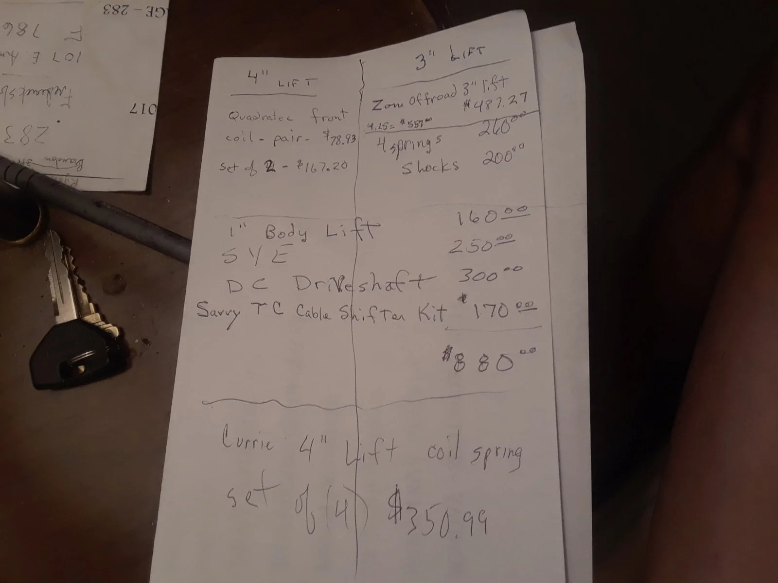

Don't try to decipher my chicken-scratch handwritten lift notes... I've been doing.my homework !.:)

Hey, there’s a way to do this without dropping it all at the same time. So, ask yourself, what do I really want. Then we’ll figure it out. There will be some compromises along the way, but they’ll be temporary and cheap. The game is to reach the goal of what you really want.
