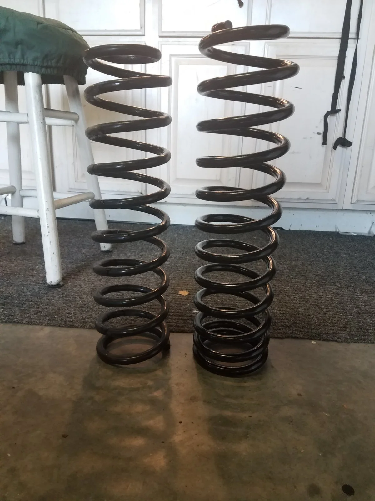

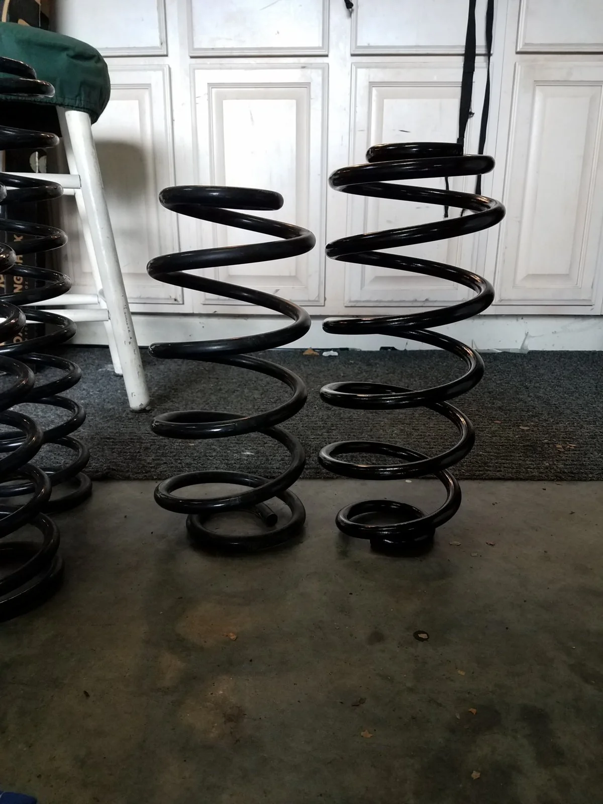

A couple of comparison shots of the "Settled" zone 3" springs, and the new Currie 3" springs

It seems so. One could speculate it's where they may have sourced the steel, or the forging process....who knows, but I think it's clear there was considerable settling. And you're 100% right, the springs and shock essentially MAKE the lift itself. Bottom line, buyer beware; if you USE your TJ prepare to pay a little more for some decent suspension

The shocks themselves are probably pretty easy to figure out. I'm sure if we took one of their shocks apart and then took apart a Rancho or Bilstein apart side-by-side, we'd probably instantly be able to see the inferior quality of the Zone (or RC) shocks. So that one is easy I'll bet.
However, the springs are a different story. All I can guess there is that they're using lower quality metals and a lower quality process. The one person who would likely know about this for sure (and all the processes involved in manufacturing shocks and springs) would be @mrblaine.
