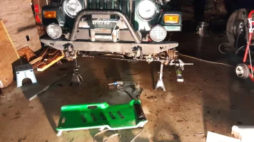

Installed all new steering parts and the adjustable front track bar. Got everything aligned and greased. Steering wheel should be close to center but will undoubtedly require some final tweaking.
79714
Also got the new rear control arms torqued and greased. And power-washed all the crud out of the skid plate in anticipation of changing the trans and tcase fluid tomorrow.
