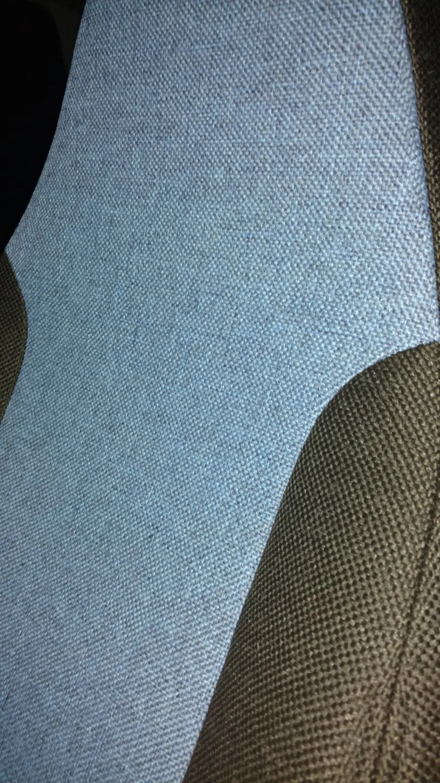

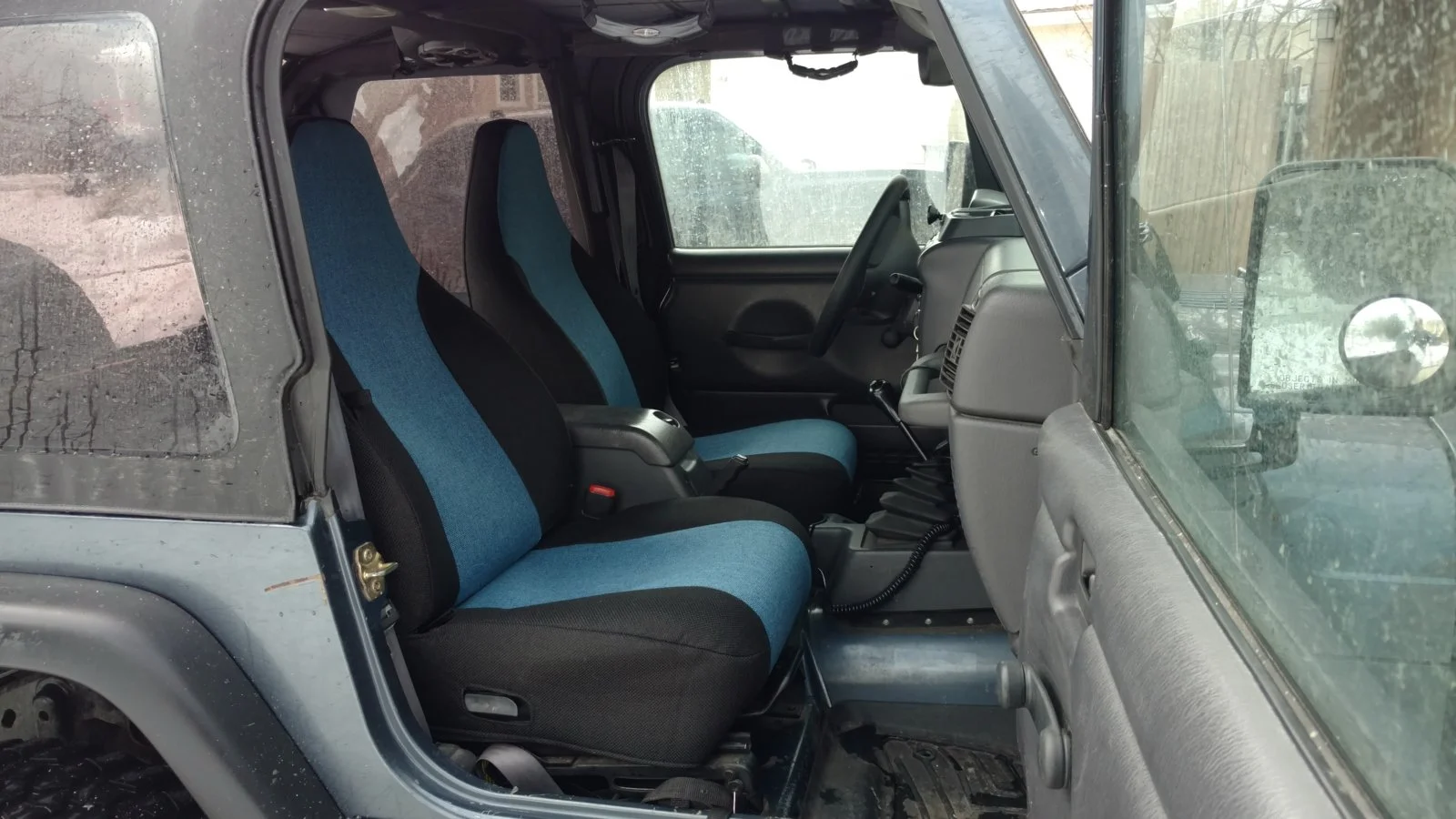

They look great. They are no neoprene right?
No, they're tweed. Looks & feels like a heavyweight canvas. It's gotta be super durable. Time will tell.

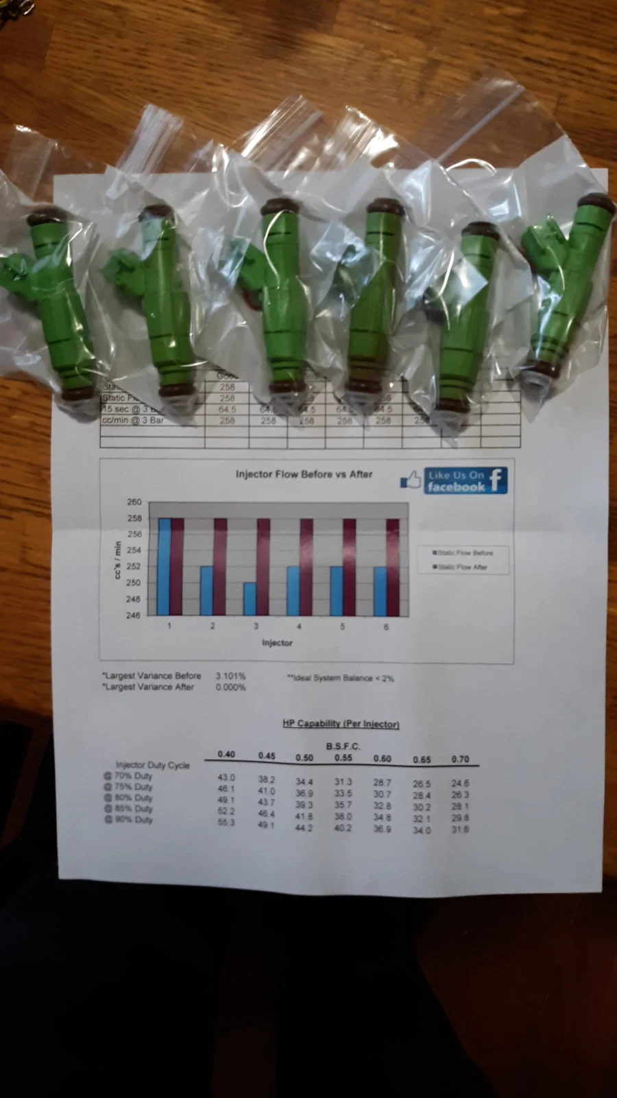

Received my flow-matched upgraded injectors from Injector-Rehab
79233
so then cleaned out the injector bores in the manifold and installed all new plugs
79234

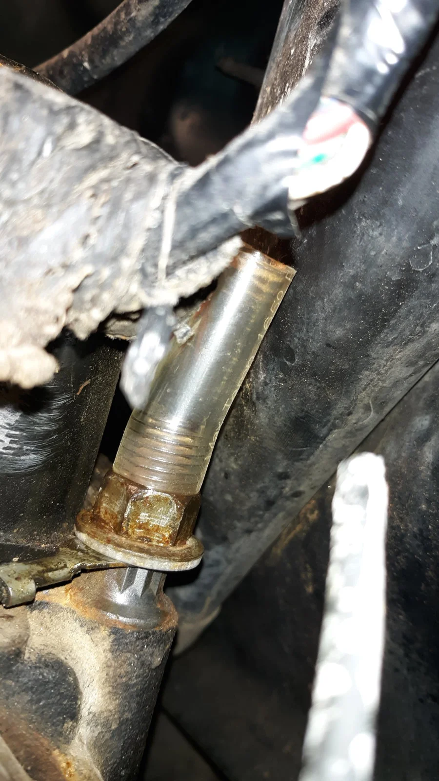

Moved the ground strap from the middle of the head to the back and put a super high-tech anti-chafe device on the rear head stud (piece of hose). Thanks @Jerry Bransford for the heads-up on that one!
79235
Also reinstalled the rear diff cover, put a new bolt in the driver's seat where the one was missing, replaced about two feet of brittle and cracking plastic vacuum line and (as mentioned earlier today) ordered some Currie lower arms. Four more days to get everything done!!

Like the anti-chafe, I'll add some of that to mine!

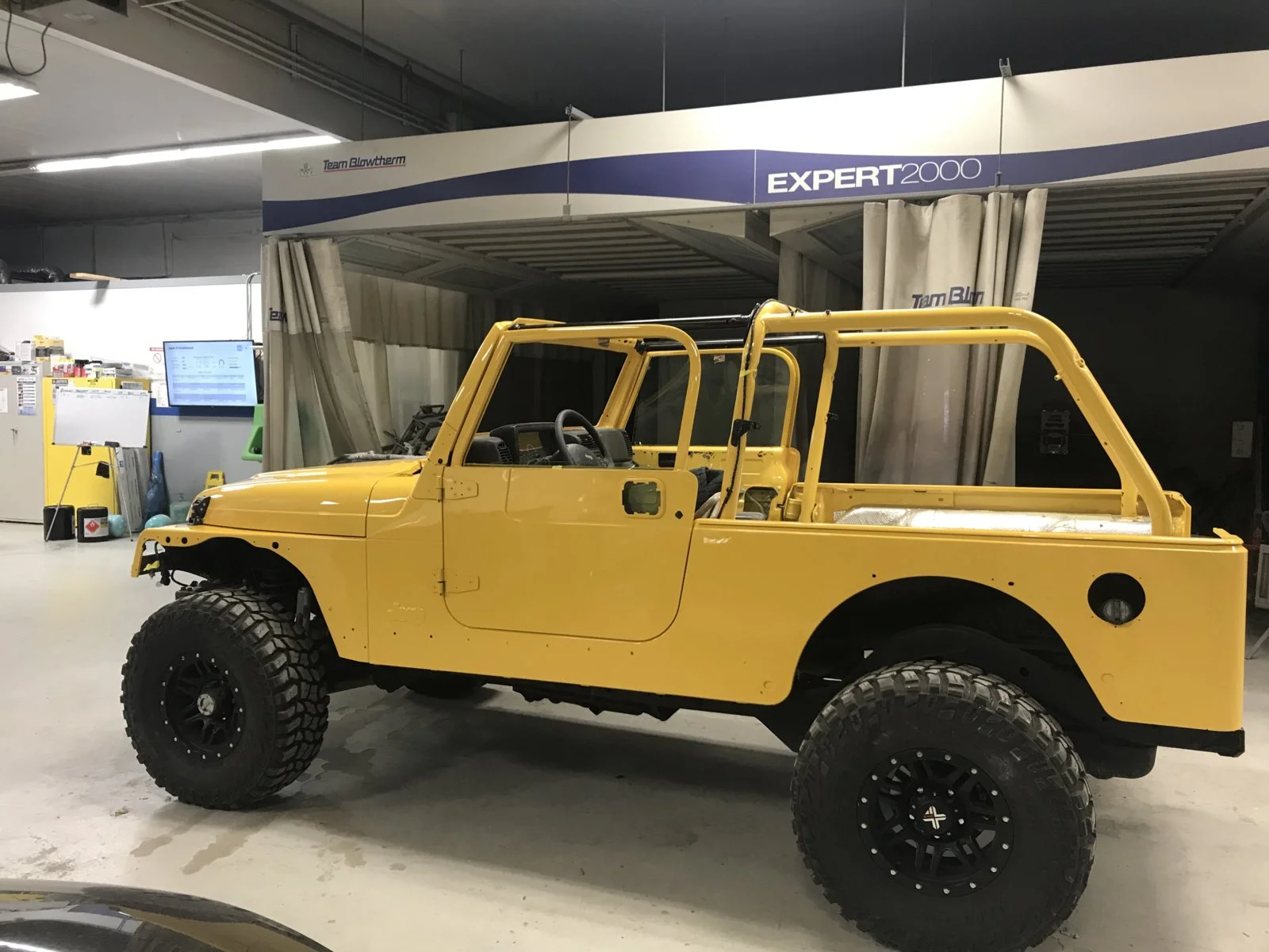

Installed 1/2" stack of washers under the back of my drivers seat mount. Big difference for me, Its way more comfortable. However I like my seat back more straight up than most and the bottom pretty much flat.
I really want to put a roll cage in mine, the windshield supports are incredibly flimsy, I am surprised they came out that way from the factory.
Like some kind of race approved full cage?
Or one of those show cages using the OEM cage & adding additional sections.
By your definition I guess it would be a show cage. There is a poison spyder roll cage just a few blocks from me for $900, but I just cant swing that right now. Anything would help and be better than the plastic bar between the A and B pillars.
