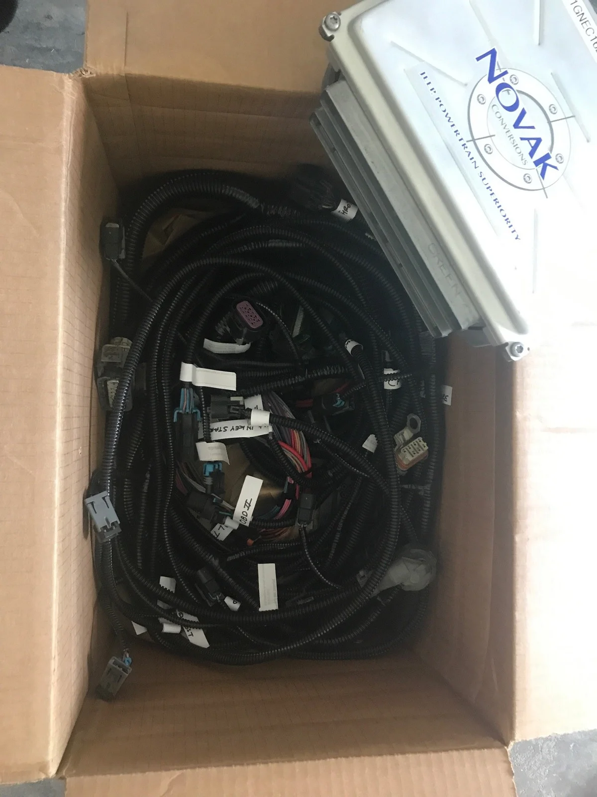

Here is the wiring and PCM for the build. Had them done by Novak Conversions. If anyone is interested in doing an engine swap into any Jeep they are the company to go with. When I mailed my wiring harness and original PCM to them only the wiring harness arrived. The PCM was lost in transit. Not only did they source me a new one, but did it free of charge.
Reactions: Jeepersteve71
Novak are indeed the guys to go to for engine swaps and all the parts you need to make it happen. They have almost everything you need!
