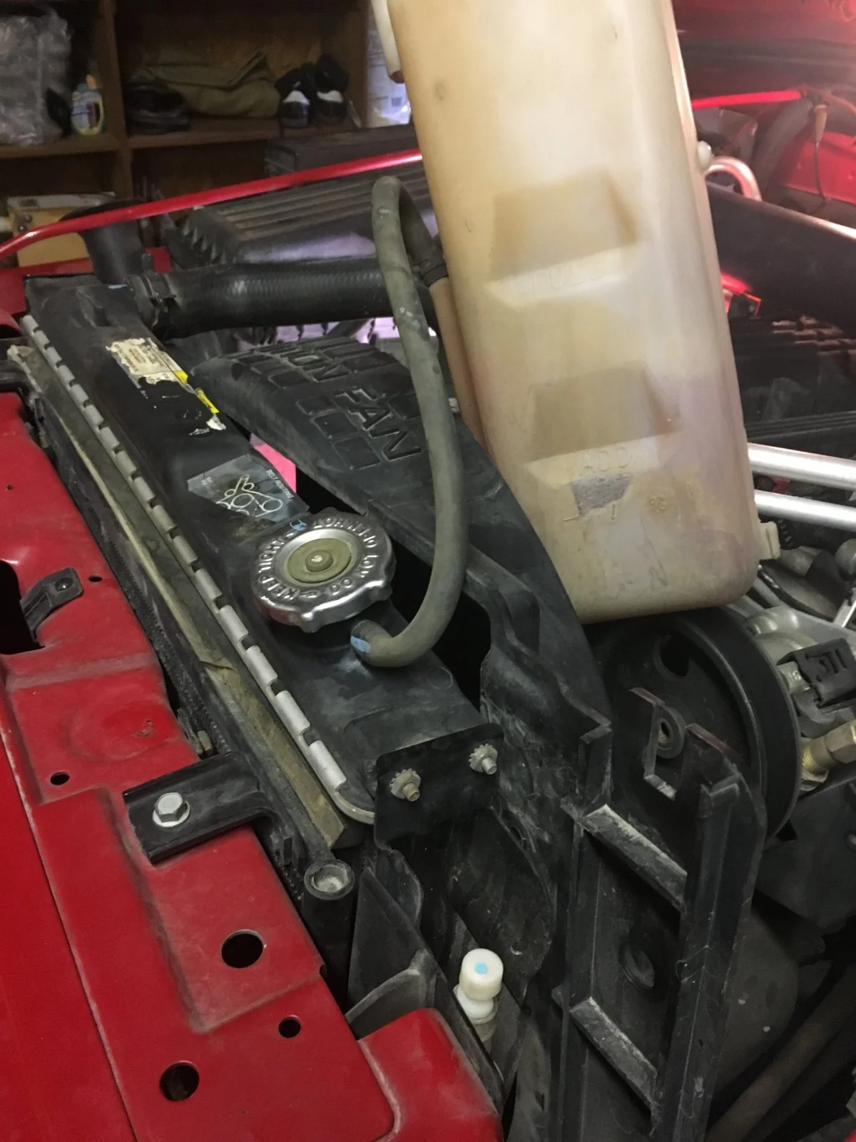

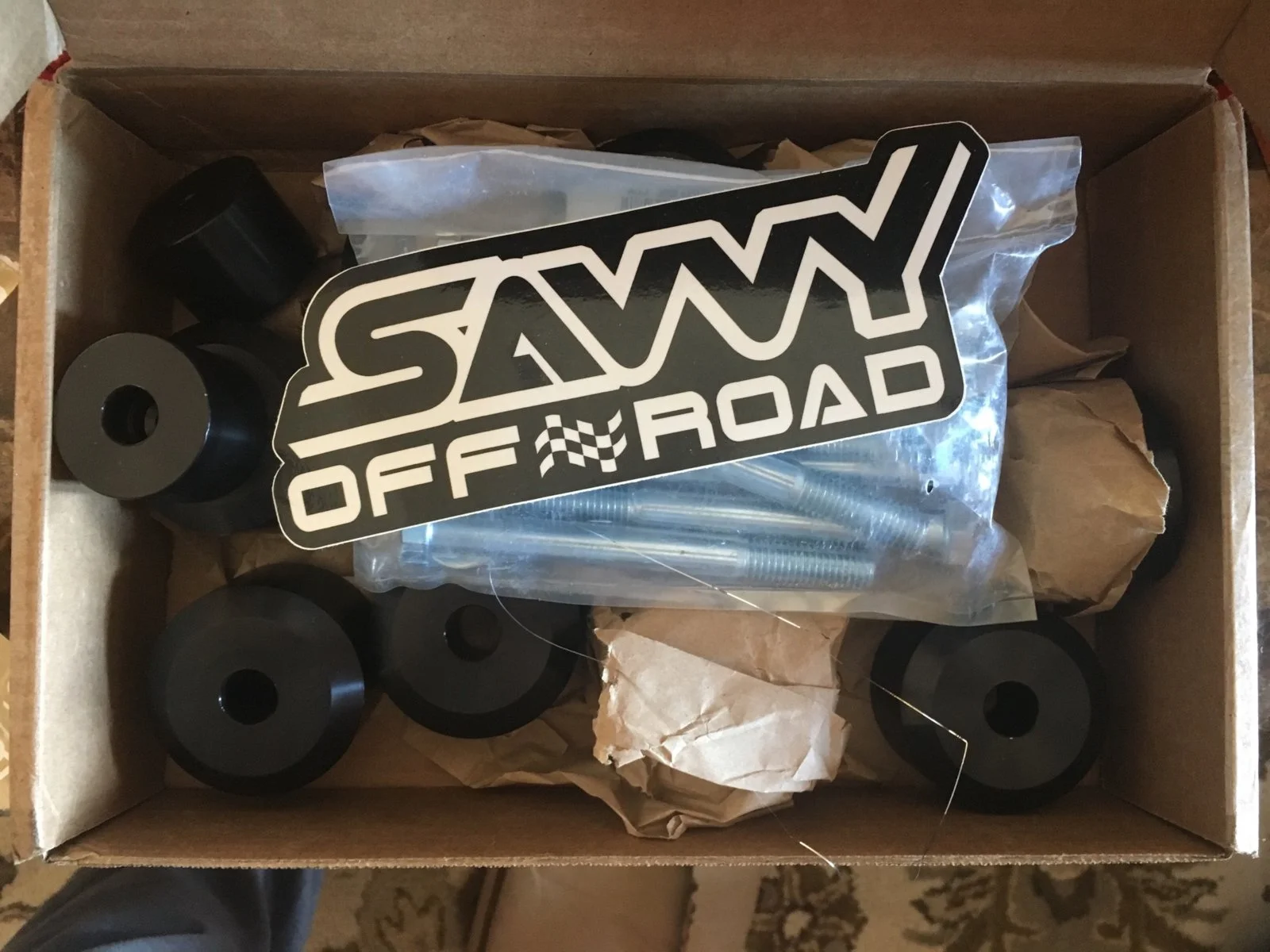

Installed my Savvy 1.25” Body Lift today. Undoubtedly my last mod for 2017! The Savvy kit is nice because it uses the stock rubber body mounts, which helps with vibrations.
Here’s what I did, some hints I learned and some problems I had. It was really cold outside, especially for TX, 22*, so I set up my friendly Mr Heater.
1. Remove gas cap.
2. Remove four torx screws that hold the gas fill bezel. If you don’t do this step the bezel could crack when you add the body pucks.
3. Remove four screws holding the fan shroud. If you don’t do this you could crack the shroud from stress. You’ll have to remove the Engine Coolant reservoir to get to the screw on the drivers side.
4. Remove the body mount bolts on the passenger side and front grill with a 5/8” socket. You will need a 12” extension to get to the one behind the rear shock mount. There are 5 body mounts on each side and 1 in the front under the grill, for a total of 11.
6. Loosen the body mounts on the driver side to ease the install.
7. Use a hydraulic floor mount to lift the passenger side of the tub from underneath the door where there is double thick body panel. Depending on how lifted your Jeep is, it’s very high, use a 4x4 placed vertically on your jack, or supports underneath.
8. Slip the body lift spacers in between the stock body mounts and the tub. This is a good time to replace rotten body mounts if you have some. Crown makes good replacements. If you use anti-seize, now is the time. Just keep in mind that your torque specs change with anti-seize. Finger tight only at this time. There are 2 different size bolts, so make sure you use the right ones at each location.
9. Remove snubber grill support, slip the bolt into the tub and out the hole if you can. Otherwise remove the headlight to get to it.
10. Use a little vasoline or lubricant to get the tapered snubber to slide into the Aluminum spacer and then screw it on the bolt.
I had trouble with the mount behind the rear shock mount. The threads in the tub were misaligned. I had to lower the jack and move to the drivers side for the time being
11. Remove body mount bolts on drivers side and repeat the process.
I was able to get the bolt to line up behind the rear shock mount on the passenger side when the drivers side was jacked up.
12. With the jack still on the drivers side, complete the last body mount in the front under the grill.
13. Torque everything down to spec. 6 body mounts on each side @50ft/lbs, 4 in rear and one up front @35ft/lbs (less if you used anti-seize)
14. Reattach fan shroud, 1” lower if you added a body lift only. Do the motor mount next if you are adding one and reattach at stock location when finished
15. Reattach 4 screws to gas fill bezel. If it’s too short you can lengthen it some by removing the two clamps and repositioning.

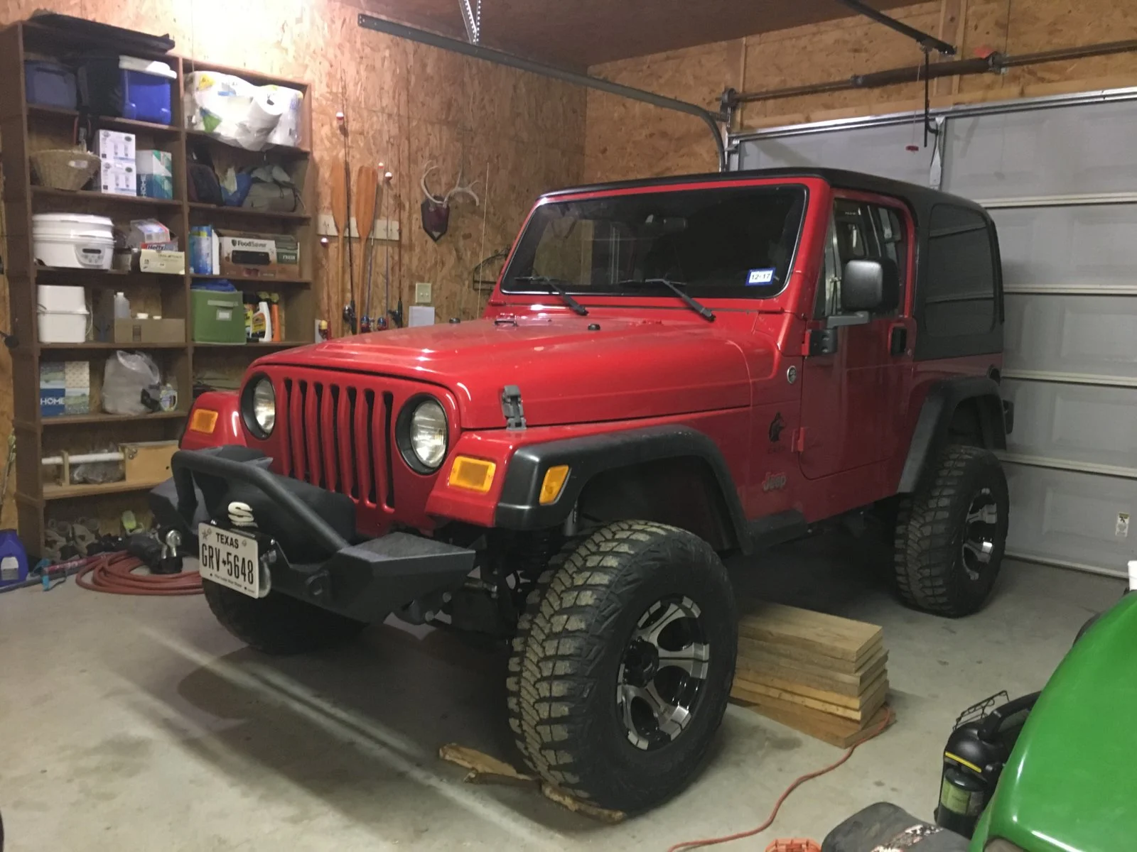

Before:
After:
Specs that changed:
1. LF from top of tire to bottom of flare. Before 5 7/8”; After 7 1/4”
2. RF before 6 1/8”; After 7 1/2”
3. LR Before 7 5/8”; After 9 1/19”
4. RR Before 7 3/8”; After 8 3/4”
Ready for 33’s! And get rid of some bumpstop! More to come!!!
