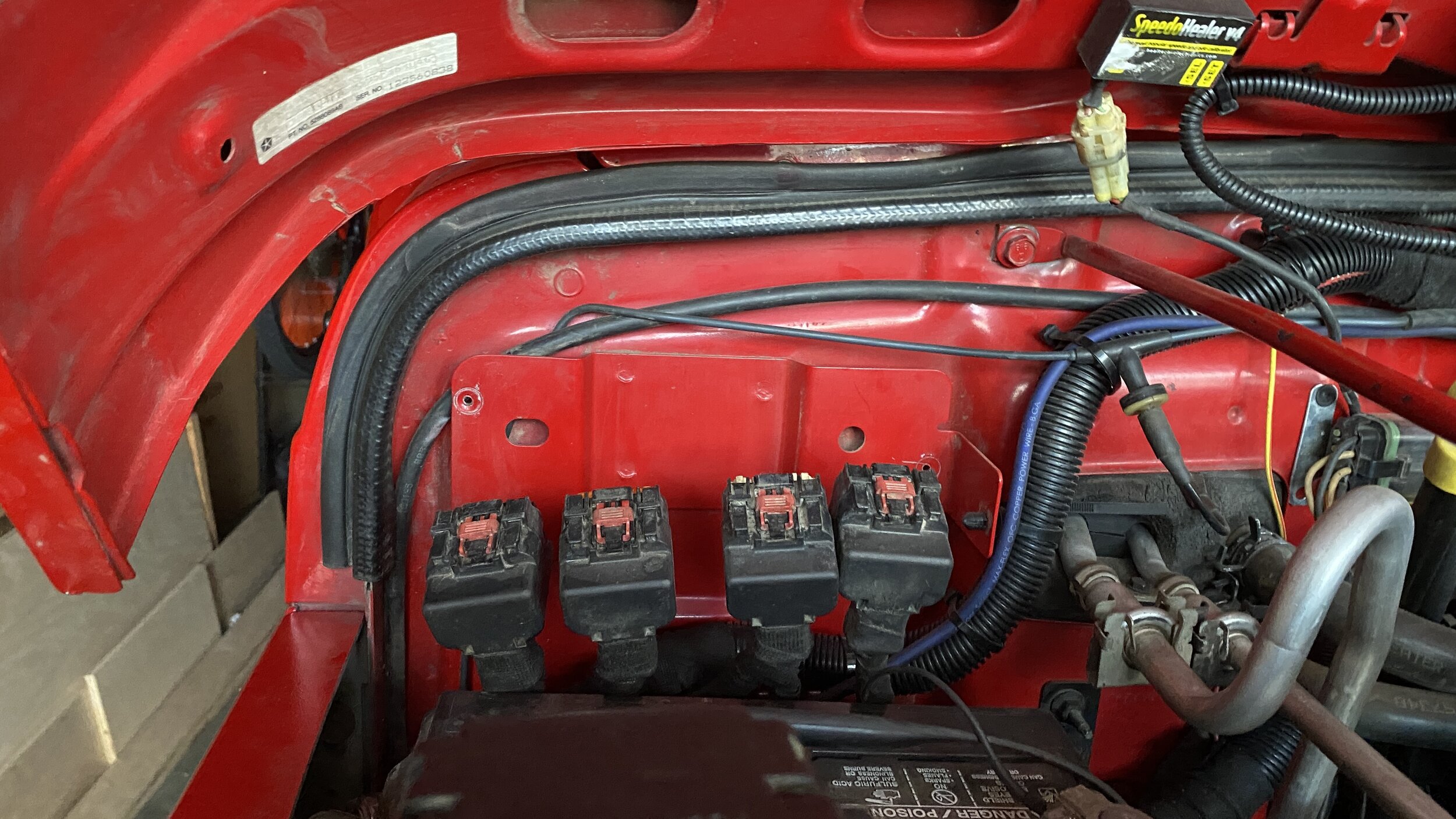

Laundry looks great. Back to the Jeep…you have to have a short to ground somewhere. That’s the only thing that would be heating up that fuse enough to melt it like that.
Blaine’s comments about fuse quality I think were more directed at that fact that it’s not interrupting the circuit like it’s supposed to. To me, that means is a BIG short, and it’s melting the contacts together.
Do you have a clamp that measures DC current for your multimeter? Probably doesn’t matter, since a short that big should be easy to find…think screw through a wire scenario.
Unfortunately, you’ll probably have to pull the dash apart again to find it
I found it and it’s corrected. It was big and it was dumb of me to forget I had left some bare connectors under the hood. 🙄 There was another thread on the issue and I forgot to update here. I’m just glad everything works. I’m sending the PCM off next week to get Mark’s new tune. Interested to see what changes. I wheeled last weekend and the temps stayed at 209* for a long time. Those temps are ok. Ambient temps will get hotter though, so I’m pretty sure I’m going to forge ahead and install the Setrab.
At least it was an easy fix!

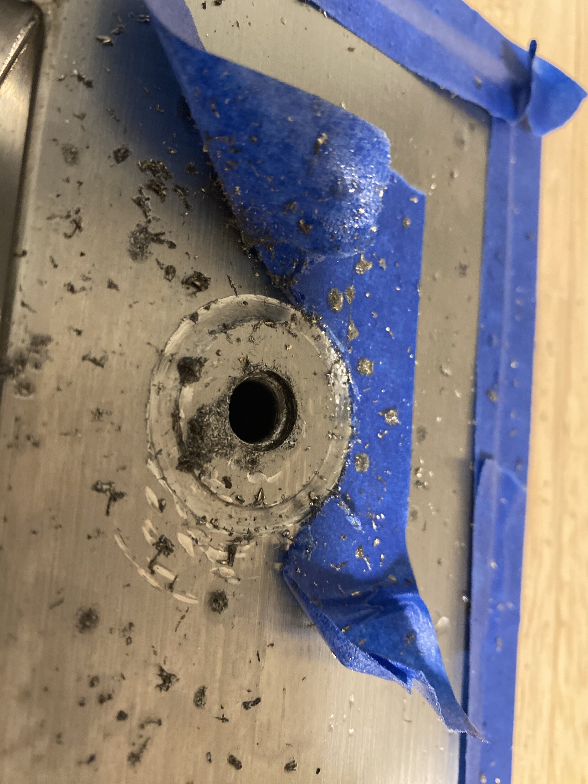

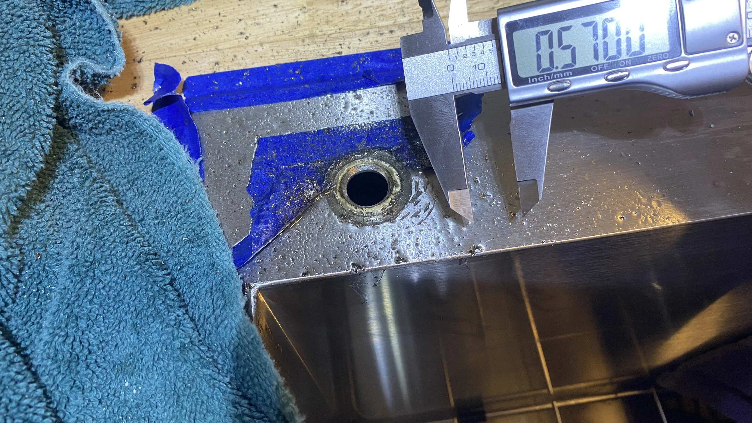

The sink was 16 gauge stainless and didn’t have a hole for a soap dispenser. Found one in brushed nickel for $10, just needed to drill the hole. That was the biggest PIMA ever. I didn’t realize stainless Harden’s as it heats up. After 5 hours of making minuscule progress I discovered slug knocker and borrowed from a friend who has everything. I broke his 3/8” drift bit, but it finally worked. 16 gauge is pretty thick. I bought my buddy a new drift. Now the 1” hole cost about $75. 😳 But I got a soap dispenser. 🙂
As you found out,you want low speed and lots of lube to keep stainless cool. Cobalt or other stainless specific bits are useful. My cobalt bits only get used on stainless
