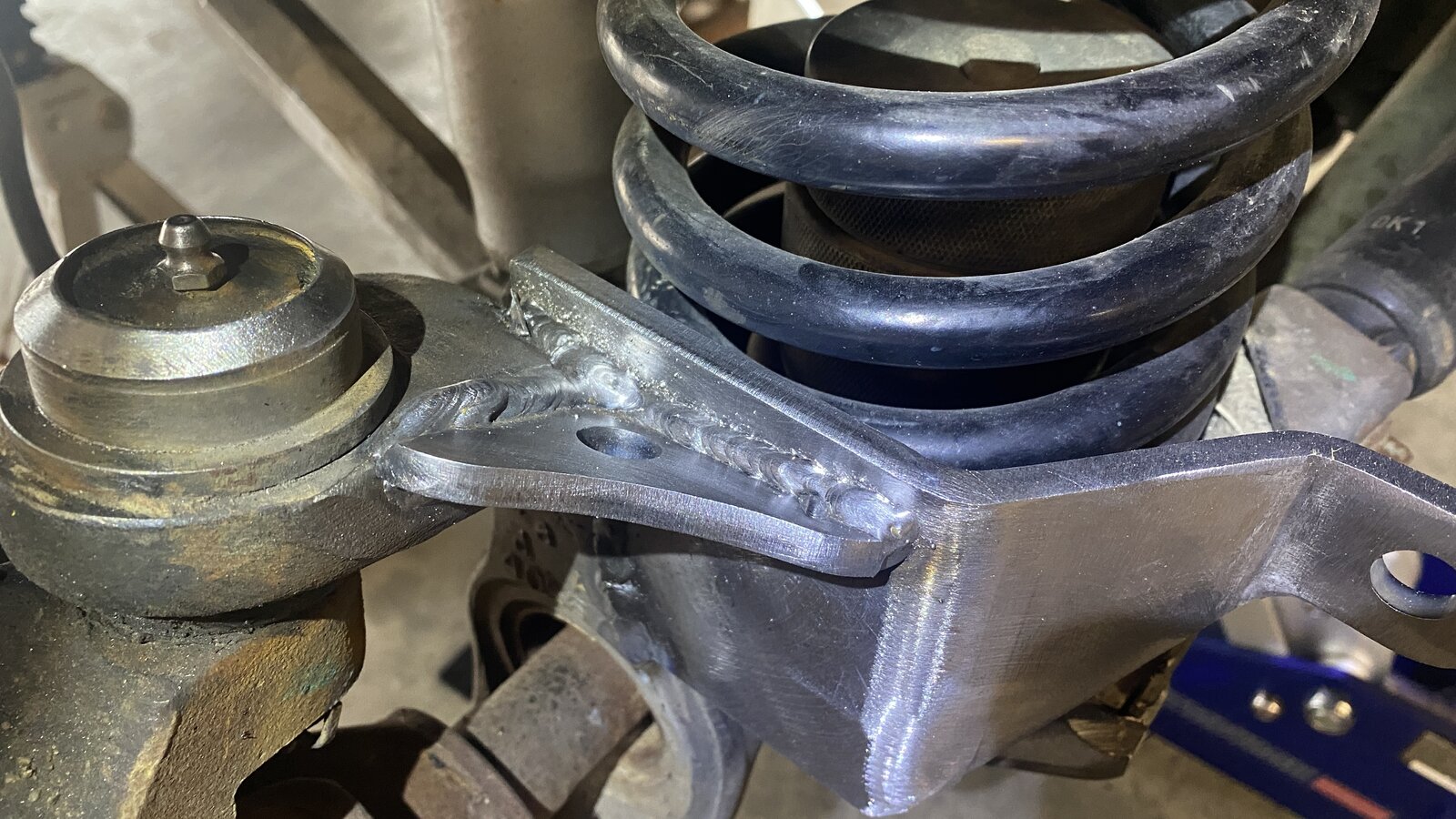

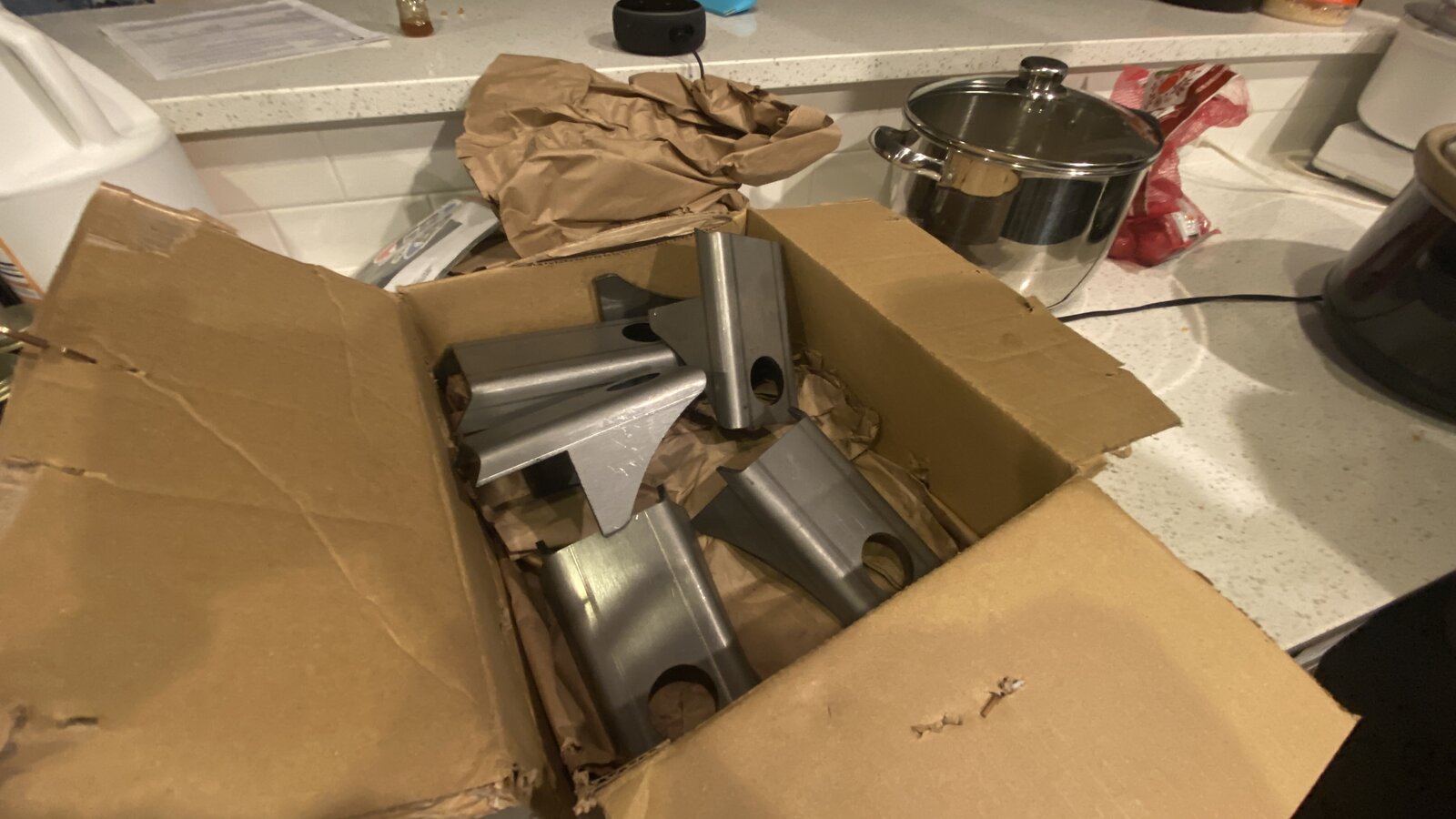

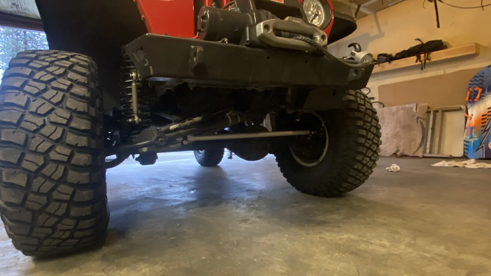

Well, I knocked Project One out. I’ve had the parts for the TR Flip since last summer, but I haven’t had the time or the machismo to do it. Mostly lacking machismo. I had Blaine’s undefeatable TR laying around. I finally said, “That's it. I’m doing it!” Get ready to laugh at my welds.

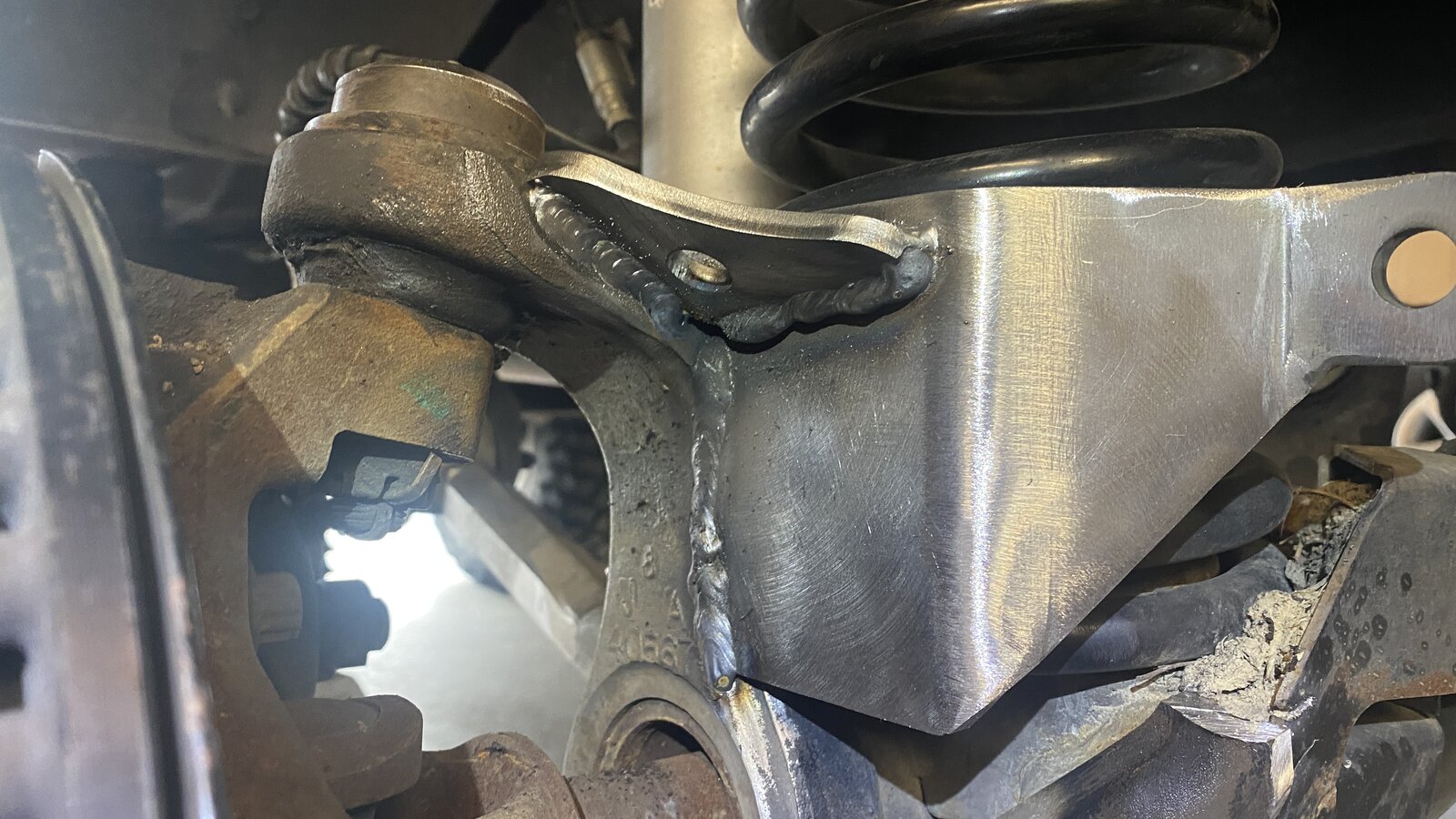

I had some trouble on the passenger side because the sway bar bracket was bent, so simply putting a plate and a couple of clamps there to align it wasn’t working. I had to improvise. I got it in place and got a tack on. Then it was easy.

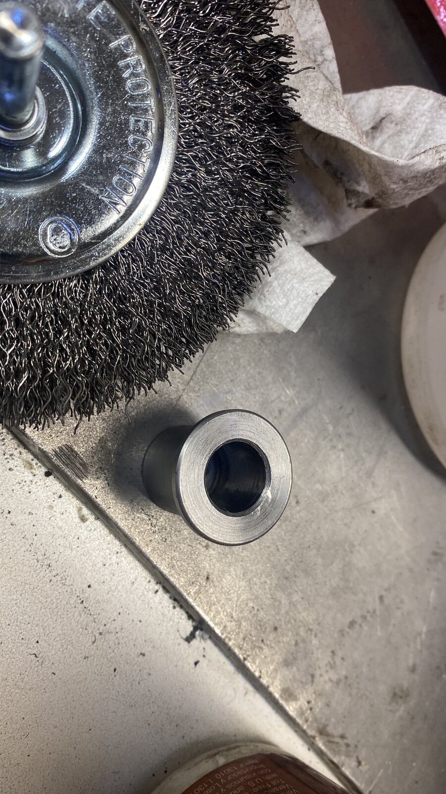

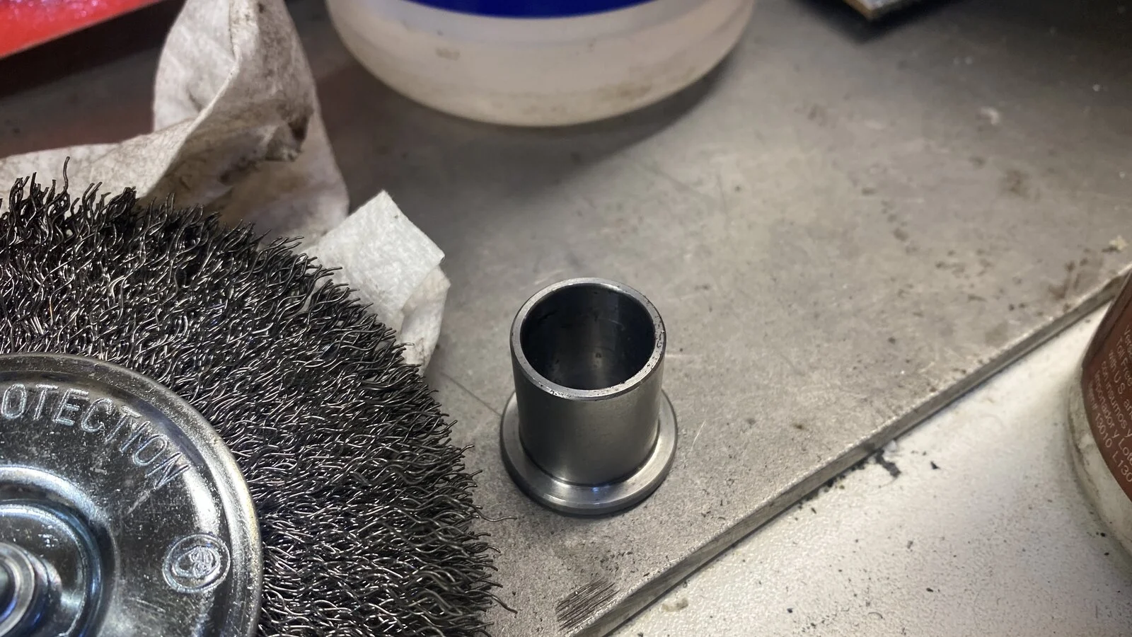

The other issue was the tapered insert from TMR was tapered the reverse of the one in @hosejockey61 video. I had to weld it from the bottom.
After installing Blaine’s undefeatable TR, I aligned the Jeep 1/8” toe in at 24” off center. After steering test I had to clearance some more metal at the drivers side perch. I also shortened my arms some to get everything to play nicely together.

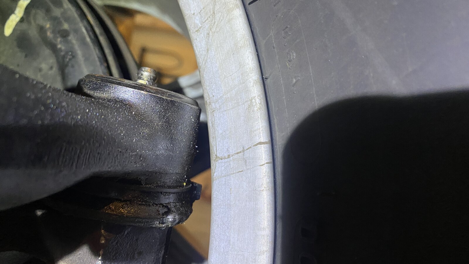

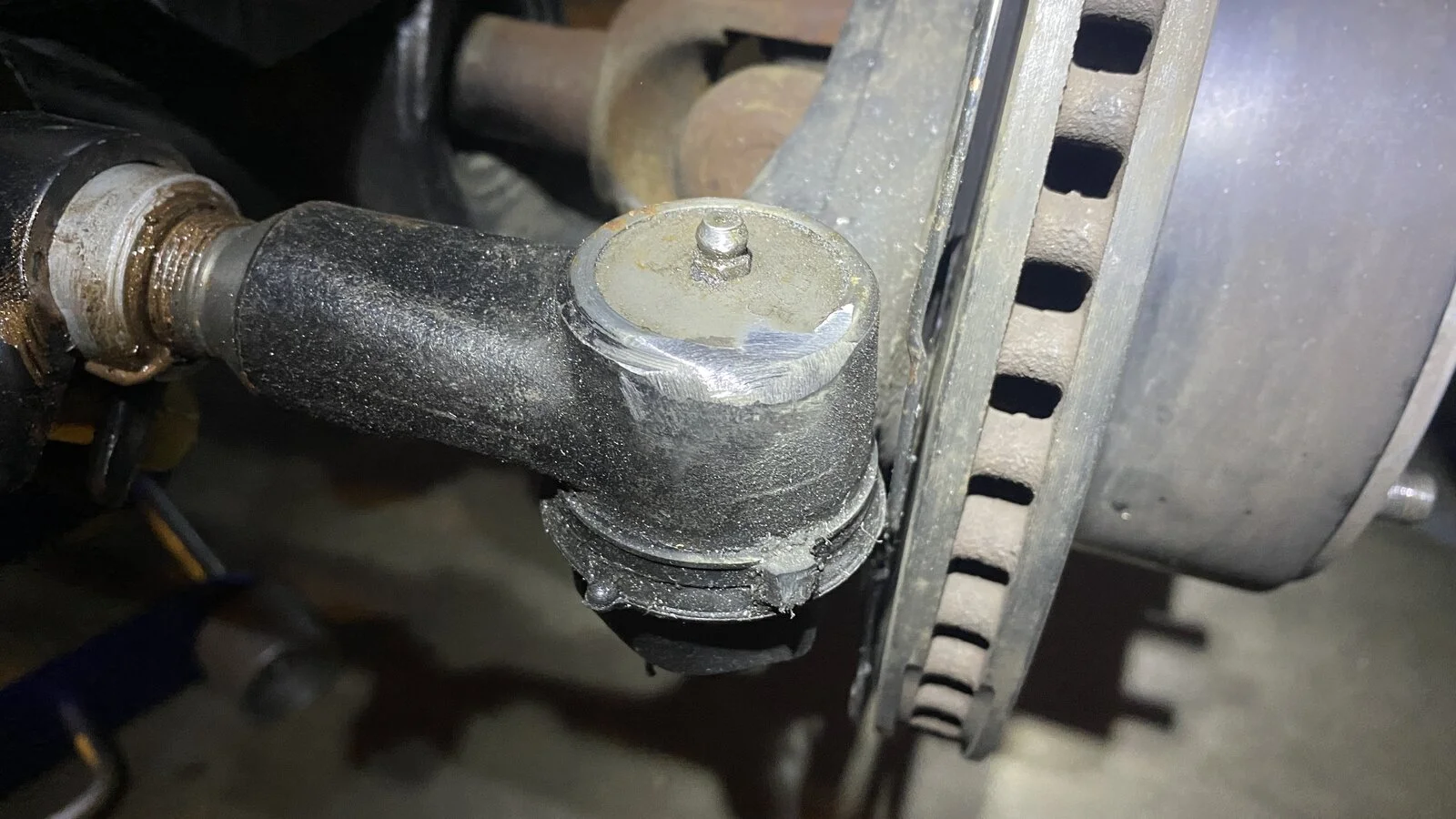

My biggest fear was the head of the drivers side Currie TR End hitting the rim. I have 4.25” BS. @FarFire70 it is so very close.
It is so close that when I went for a drive I immediately heard a repeating rotational sound. I looked and saw this! 🤣
It was nicking the wheel weights and had knocked 3 off!
I can’t do much with a welder, but there’s not much I can’t do with a grinder, so I went after that TR End.

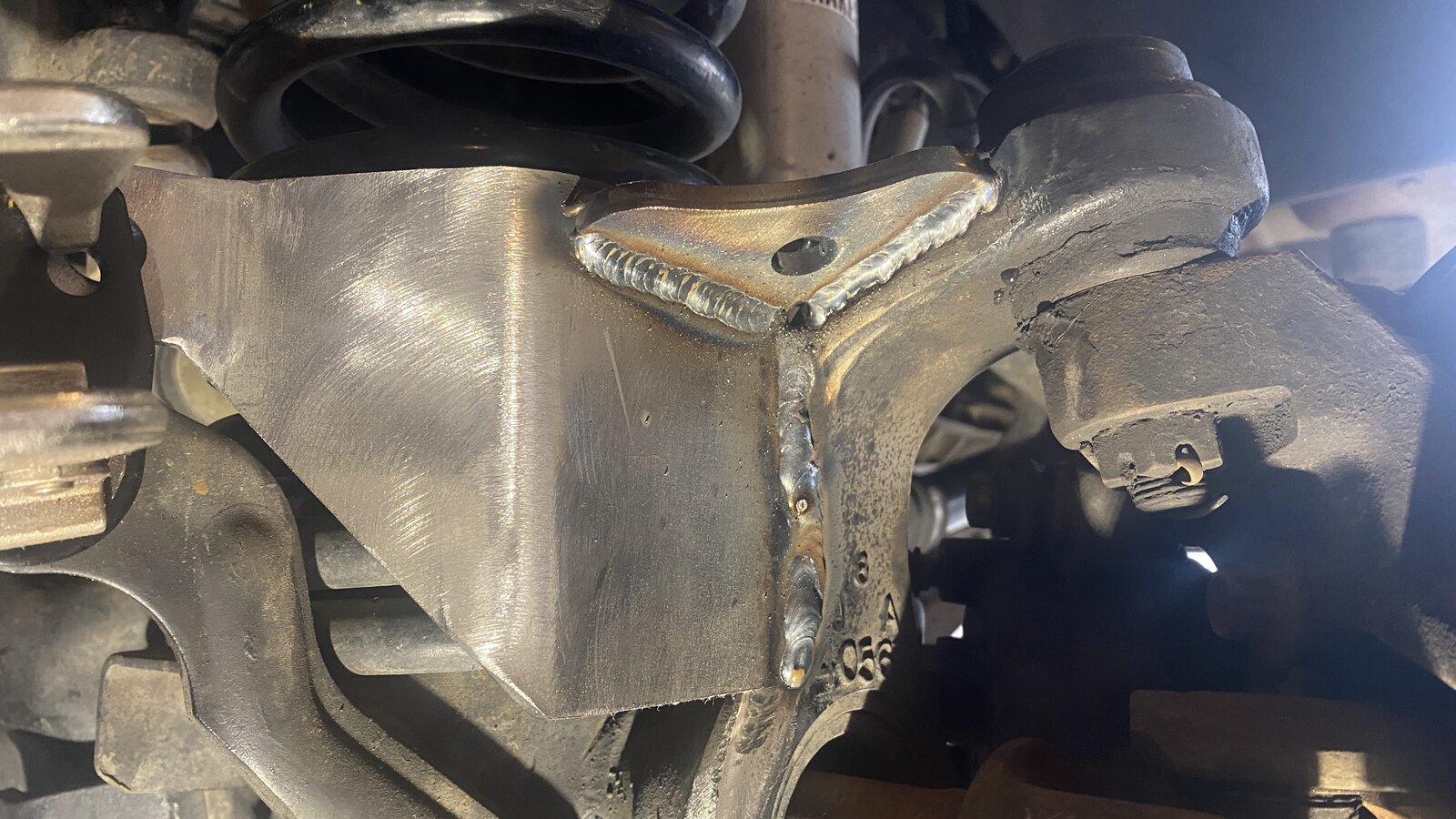

I’m all clear now. I’m very happy. I just hope the welds hold. Final pic and a few others just for fun. 17.25” at the TR!

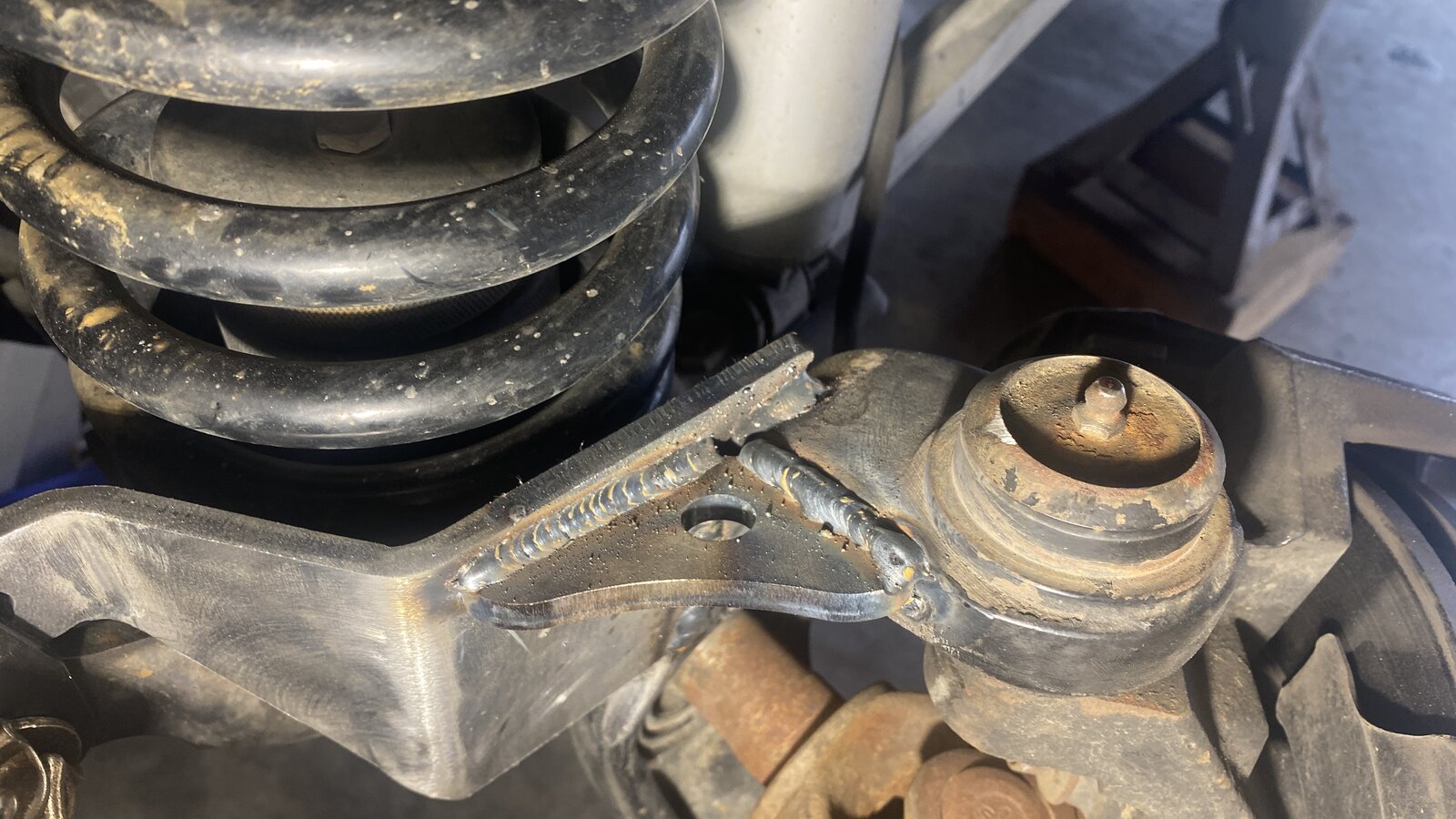

Are you ready to laugh? Here are a few of my welds.
Turn your heat up

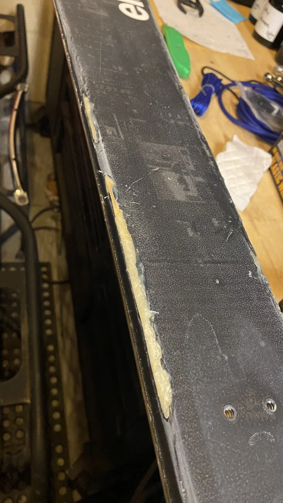

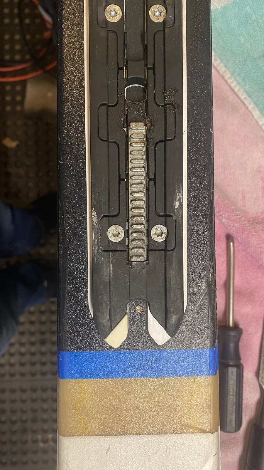

In the meantime I’m re-working a set of snow skis I picked up. They need a lot of love. I’ve already filled all the chipped and cracked fiberglass. I’ll be prepping and painting them to match the charcoal and red boots next weekend. They’ll be mostly charcoal and red with silver and black accents that follow the factory design. The poles are black and red. It will all match my Jeep. 🙂

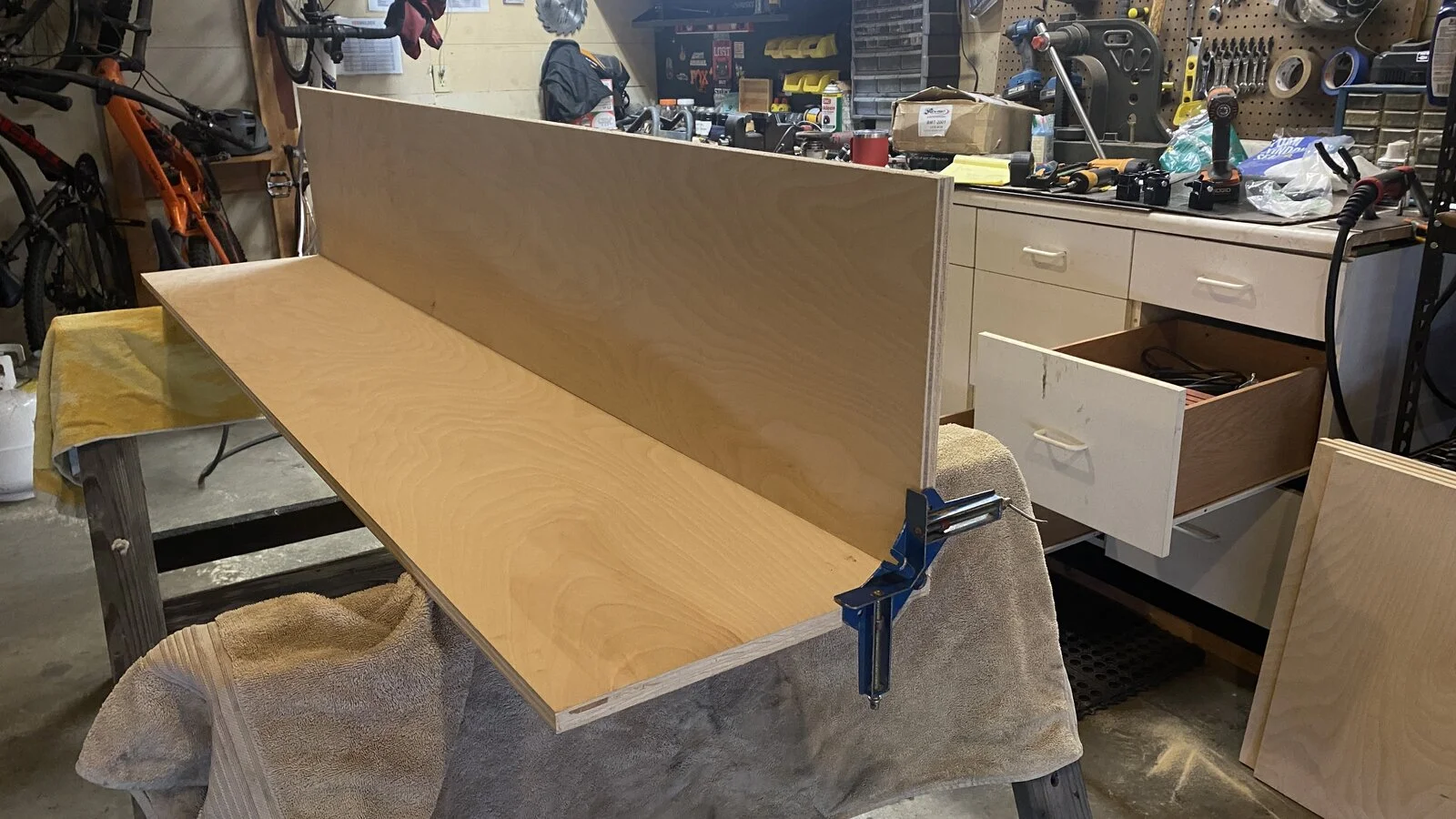

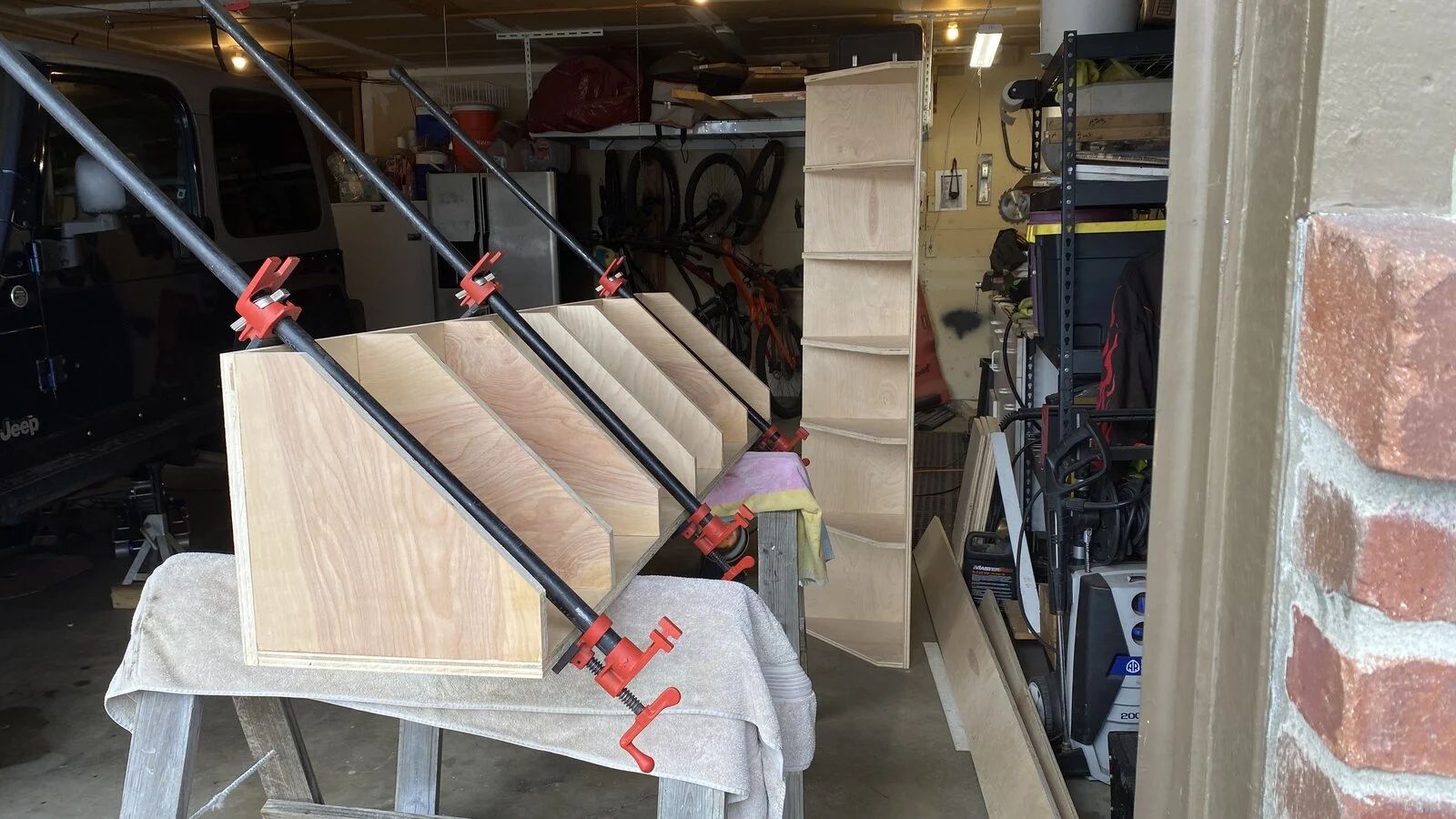

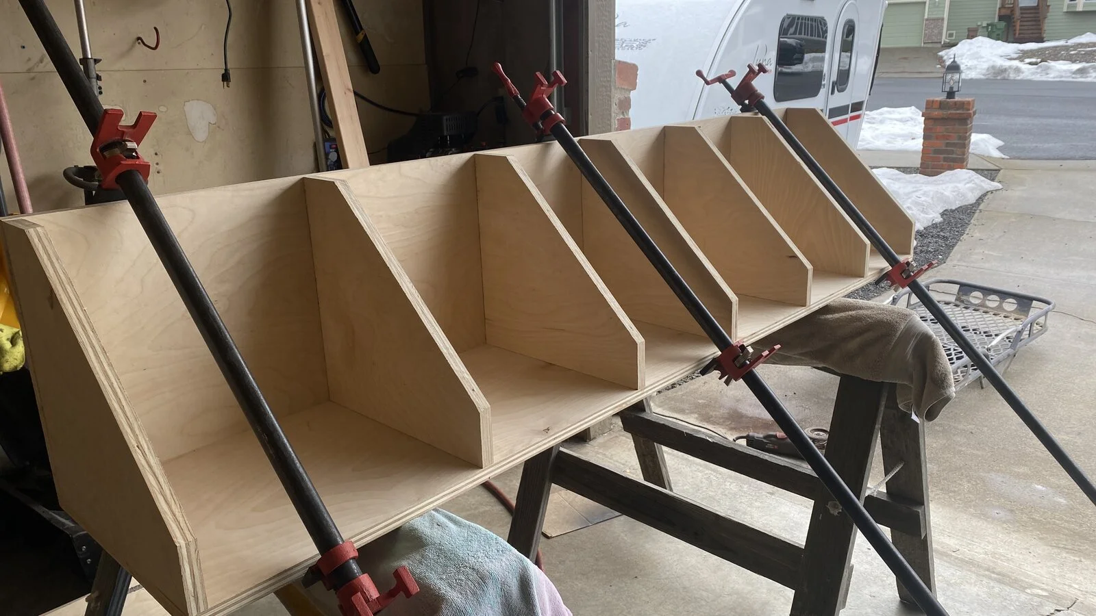

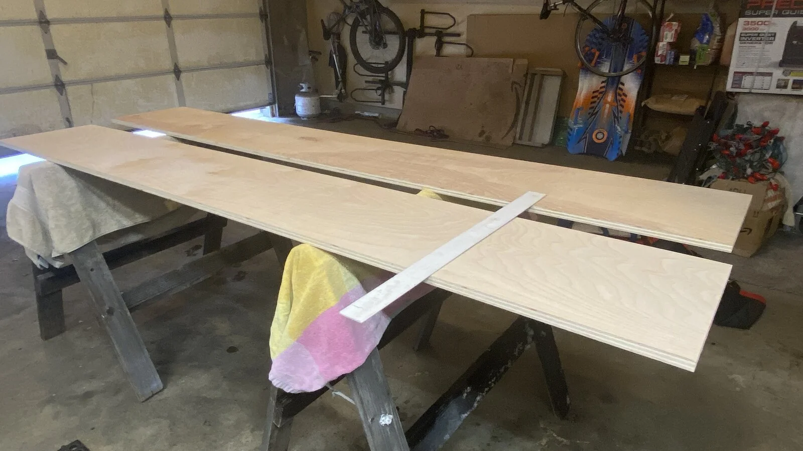

My oldest daughter has been wanting some bookshelves. Space is limited, so I’m building two small corner bookshelves. The lowest shelf is 14” for large books, then a 12” and those at the top are all 10”. I haven’t done any wood projects in a few years since the Jeep took over my hobby life. It’s amazing how much easier it seems now after all the Jeep projects you guys have walked me through. I still need to build some bases and add the trim, but these are turning out nice. Wood prices are crazy. There’s about $300 in 3/4” birch, some trim, and a 2x4” just in these shelves and paint. 🙄 I picked up another 10” Diablo 60T fine trim blade for my mitre cuts.

Bookshelves are almost done. Just need to fill all the holes and paint. My daughters birthday is Wednesday. She’s oblivious to any happenings in the garage. 🤣 I doubt I’ll be done. I hate painting with a brush or roller.
