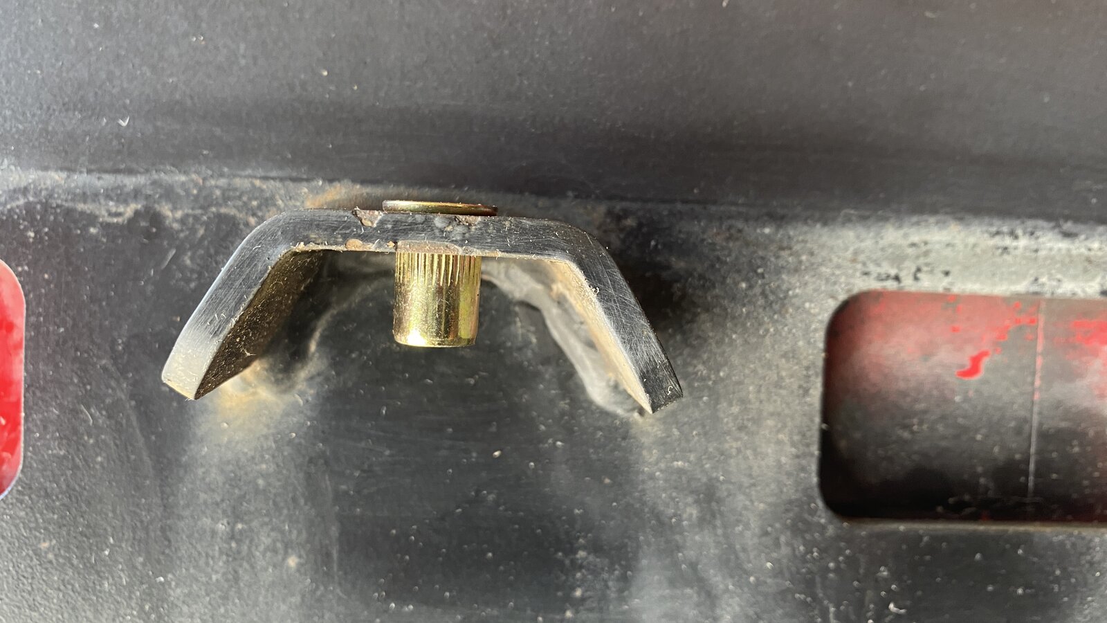

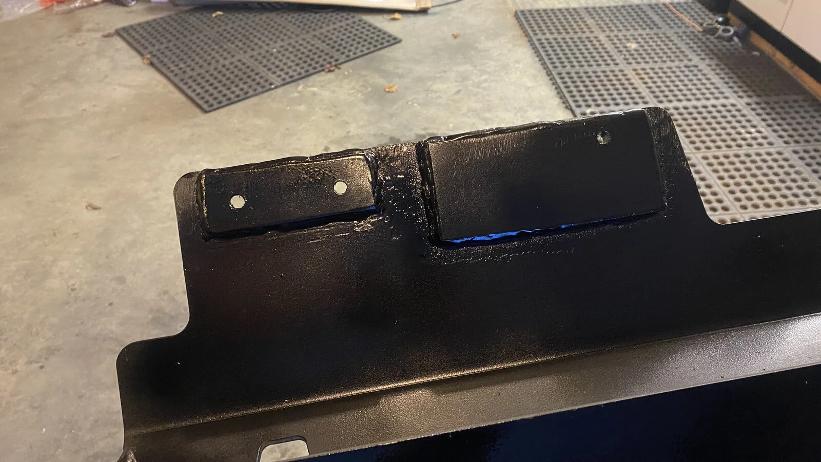

The JCR Sliders are just ok. The torque boxes are not level, so JCR added a 3/16” plate. It really needs about 3/8”. They didn’t even run it the whole length. They just did 4”. It’s about 11.5” long. @Mike_H fixed his and I’m following suit. It was time to take them apart anyway and see what’s going on with rust. It’s been 5 years.
Welded on some spacers, painted them and the torque boxes. They look better than ever.
There’s still rust to remove and painting to do. Annoying, but worth it.
Just wait until you’re laying on your back drilling and installing all those nutserts into the torque boxes. 💪

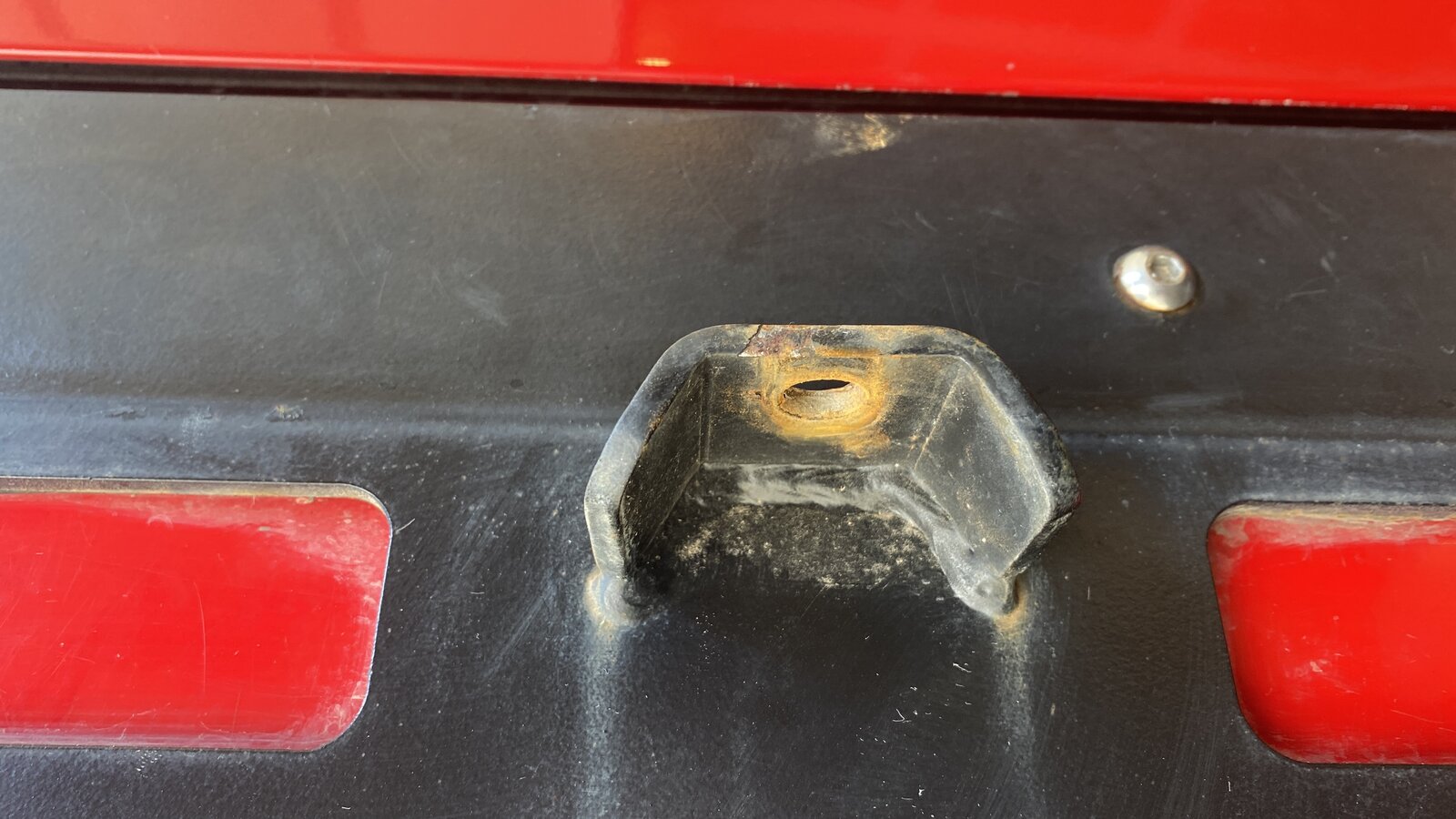

Waiting on McMaster’s for some 5/16”-18 nutserts with a crush diameter of 17/32” (0.53”). This stuff isn’t always easy to find at the local hardware store. They should be here Monday. That will give me time to paint everything. 🙂
Do you have a nutsert installation tool?

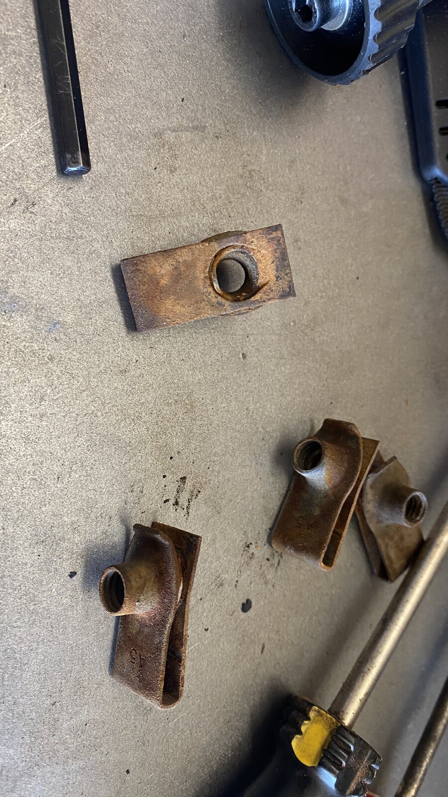

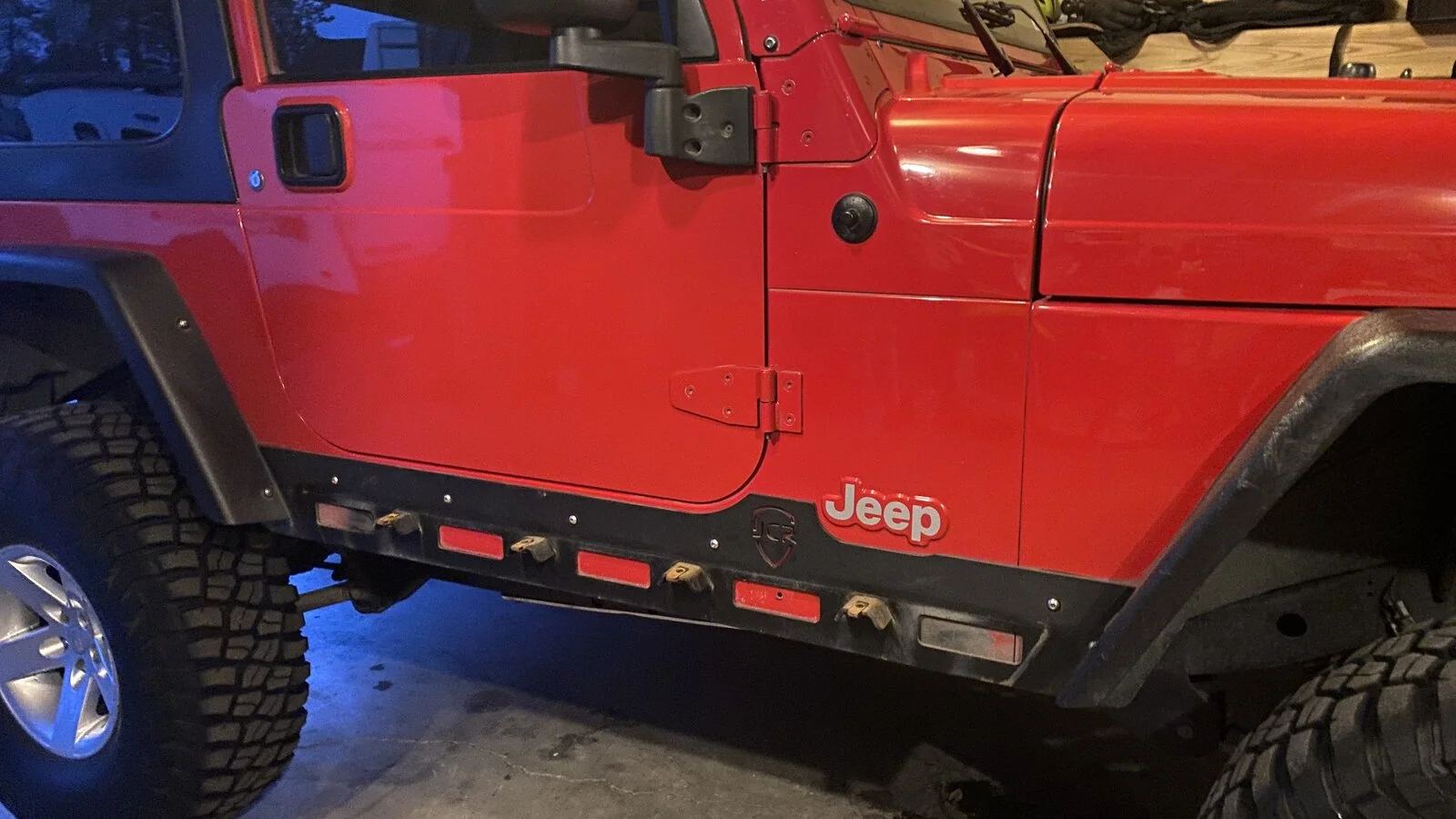

@Mike_H, what did you do with these dumb clips? The steel is too thick to get a nutsert to crimp. I could remove the backing plate and weld a nut on. It would need to be really centered on the hole. Or buy new stainless clips. 🤨
Reactions: JMT and NashvilleTJ

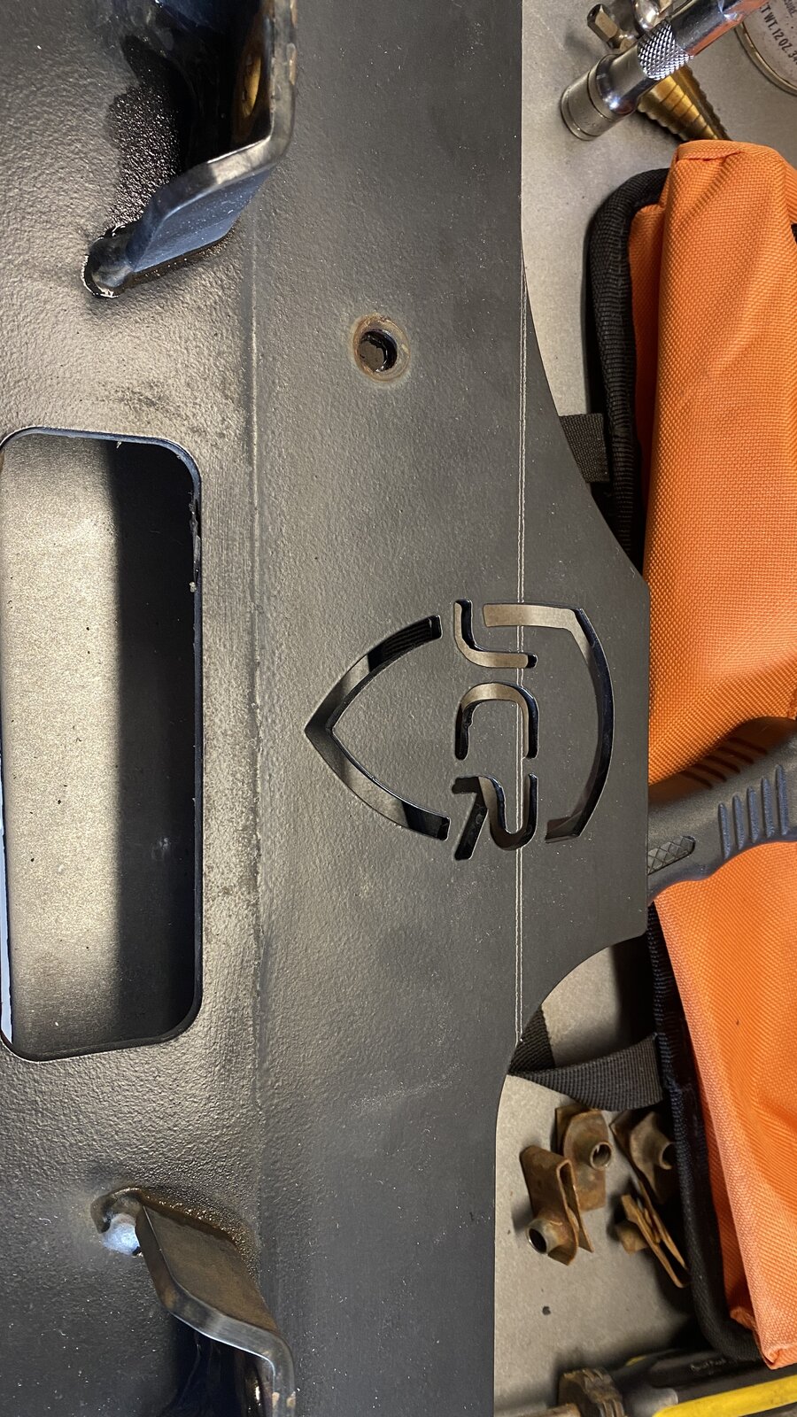

Contemplating cutting this part of the slider off straight and welding the remaining JCR logo closed and painting. What do you guys think?
