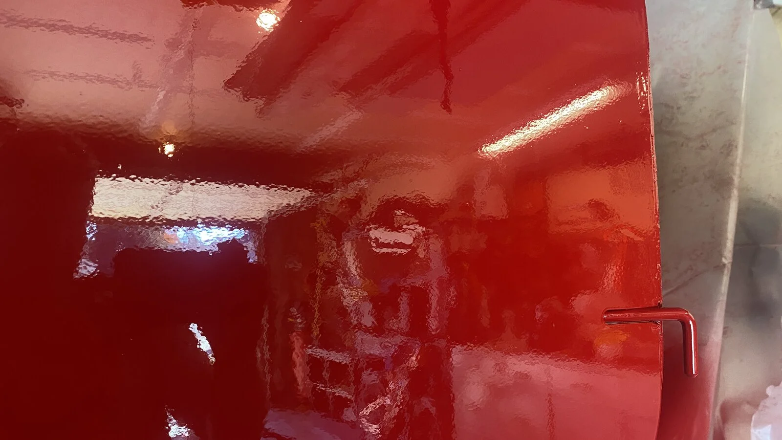

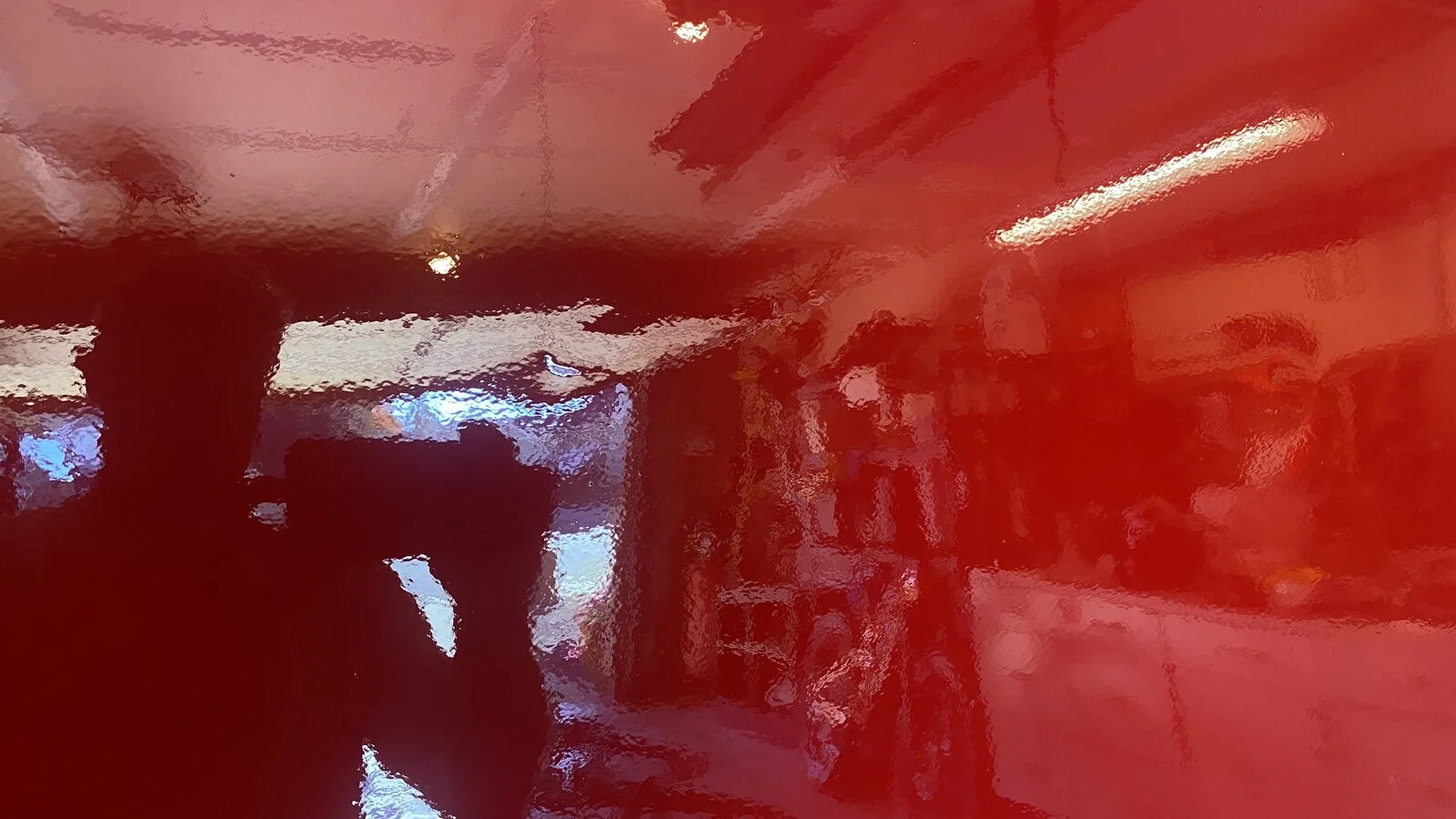

It’s quite normal, even for many body shops. I briefly mention how to remove it at the end of the video. There are several more steps I don’t mention, but essentially wet sanding in increments from 1000 up to 3200.
As mentioned in the video, if you are satisfied with the sample I show, then it can be done.
If you want better, and as good as a body shop, just color buff and sand. It will look better than most factory paint jobs.
My 02 Dakota has a factory original orange peel paint job. Shows up in bright sunlight.
Reactions: JMT
Older resto’s require orange peel to be proper. Very difficult to master. For ours, just matching factory is our goal, and there is orange 🍊 peel from factory.

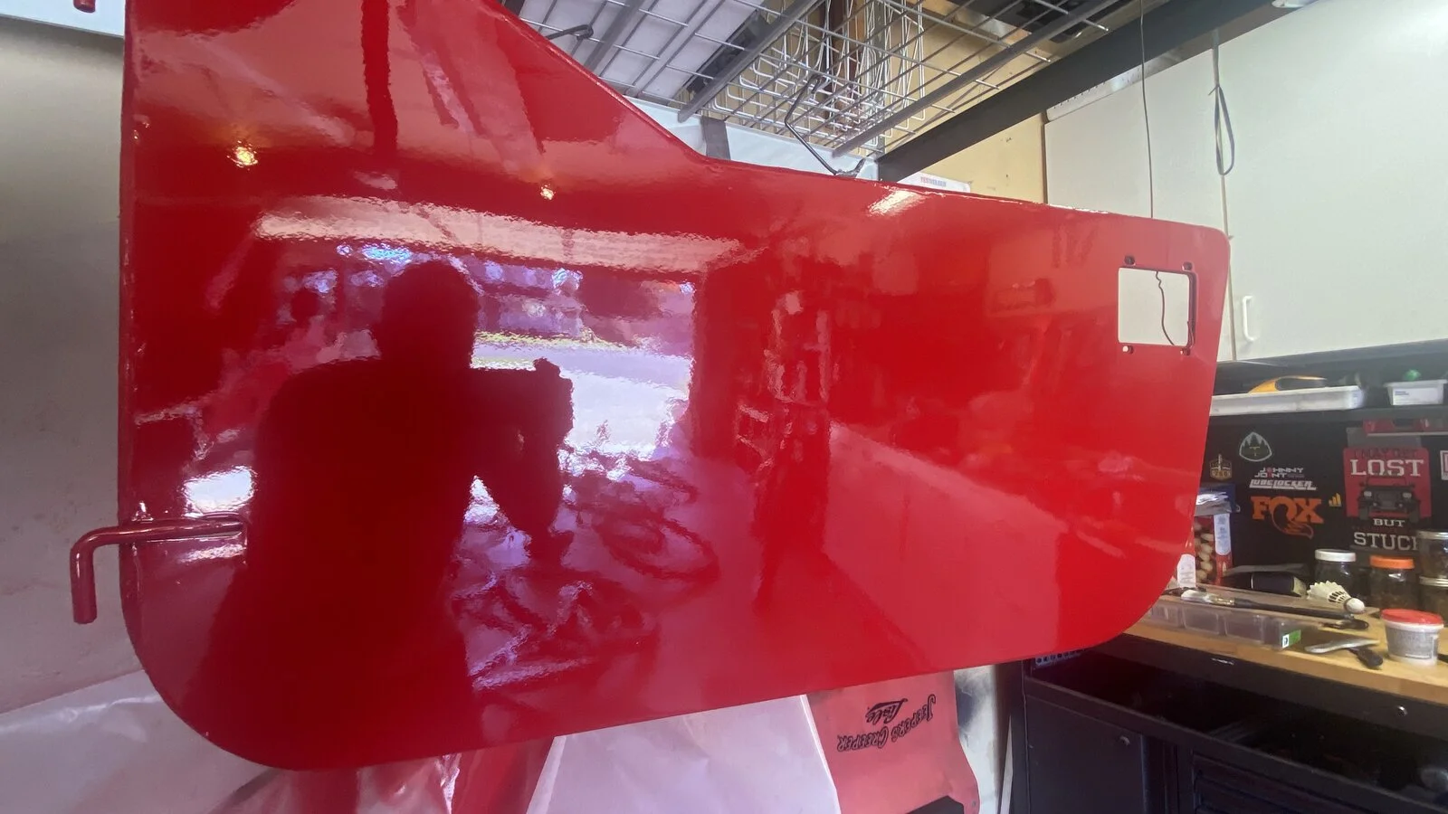

Doors look legit Jeremy. I done be schooled on painting!
You da bomb Jim! Thanks for all you’ve taught and explained to me. Super helpful. I’d never have done this without your knowledge, encouragement from @Alex01 and inspiration from @Wildman
The doors would be much better if the panels were flat. The PO who welded the skin to the frame warped them in a couple of places.
Some things don’t go as planned. It takes a lot of work to get 2K off. They’re getting a re-paint now.
  • Sad
Reactions: Wildman and Alex01

Read a thread years ago on Challenger forum of guys comparing their home paint jobs vs others pro jobs — Both had orange peel.
It was a question on the depth and visibility of that peel. Like you said - factory jobs have it too. Best effort to distort the effects. ;)
