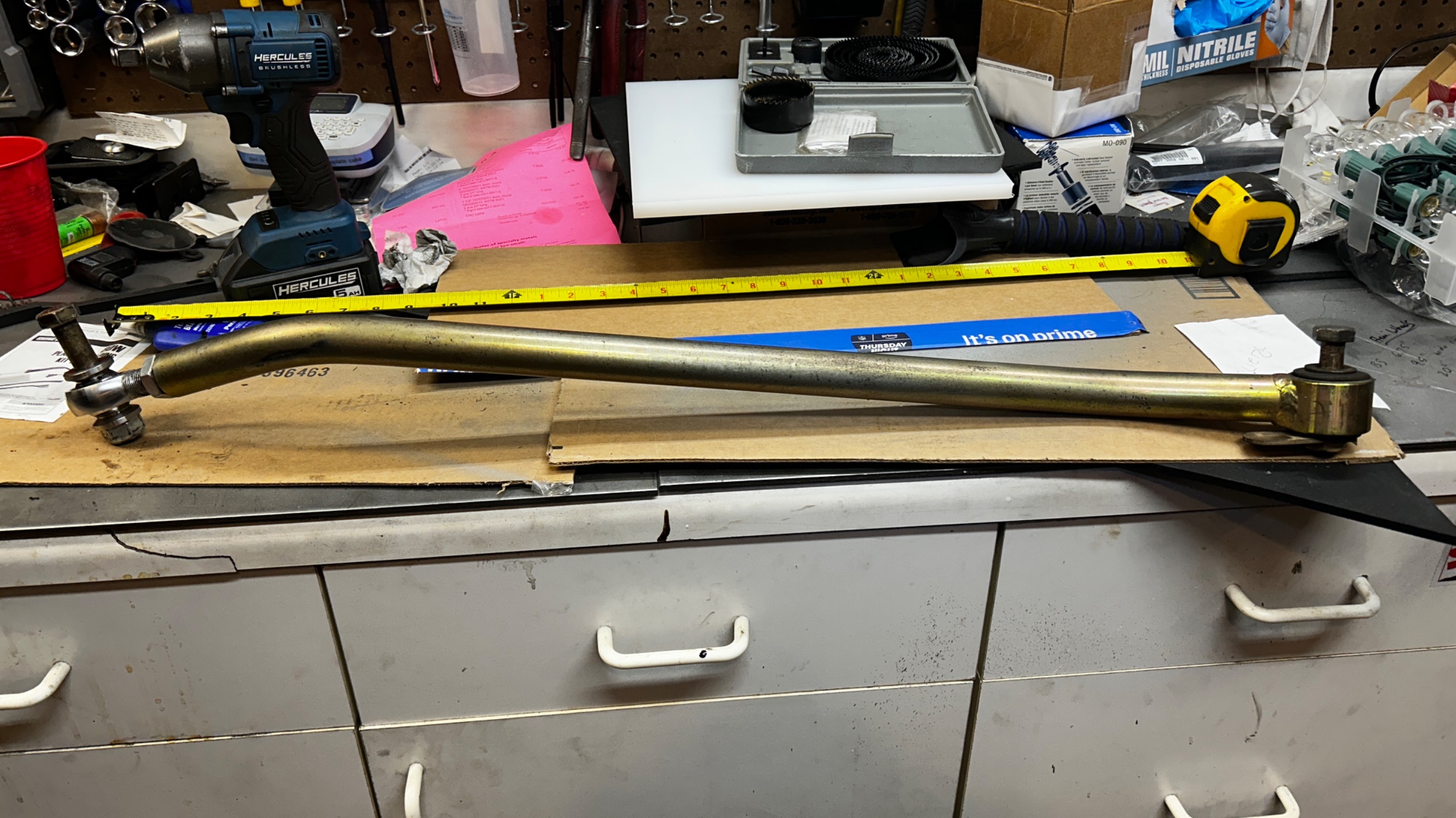

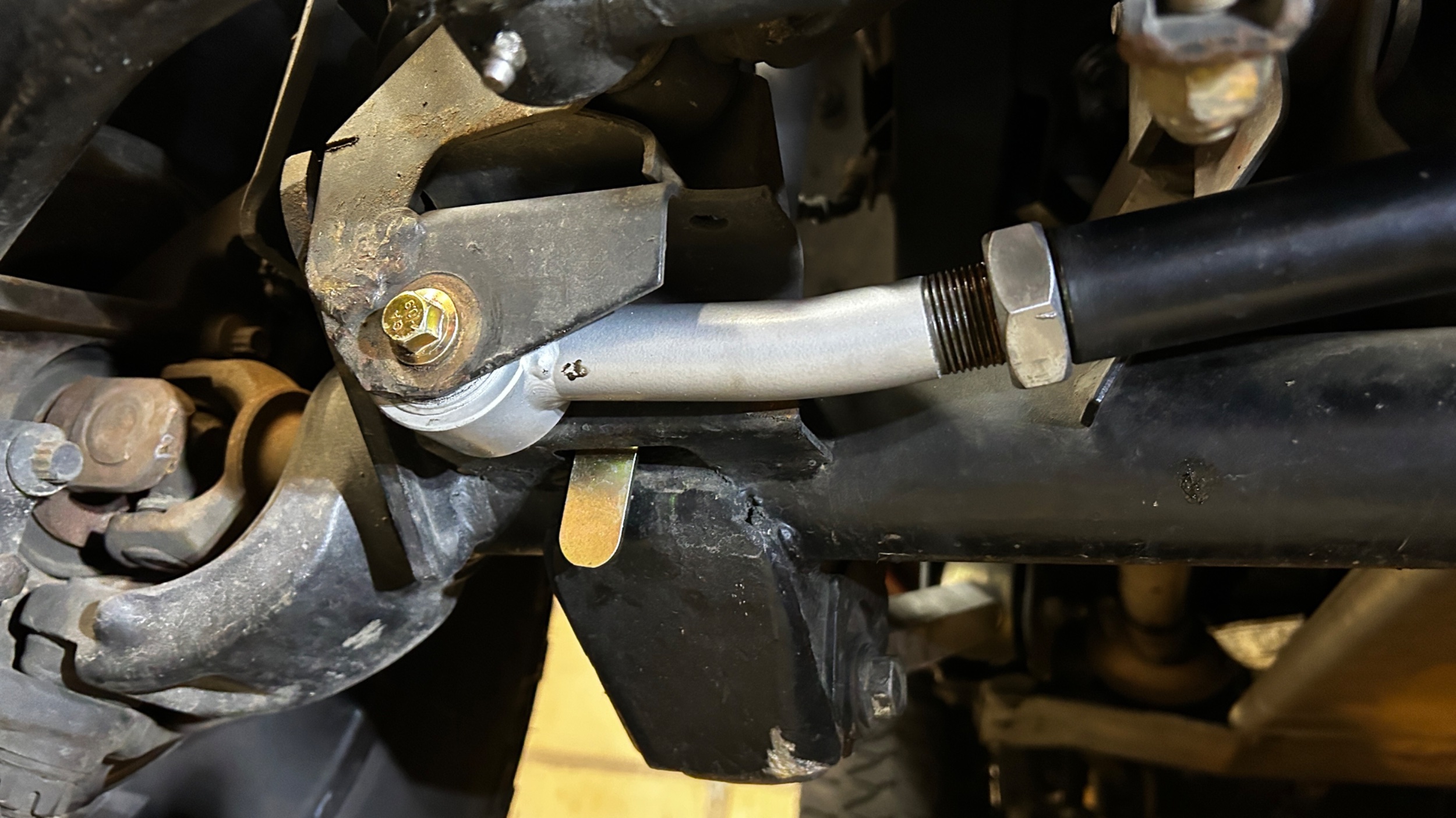

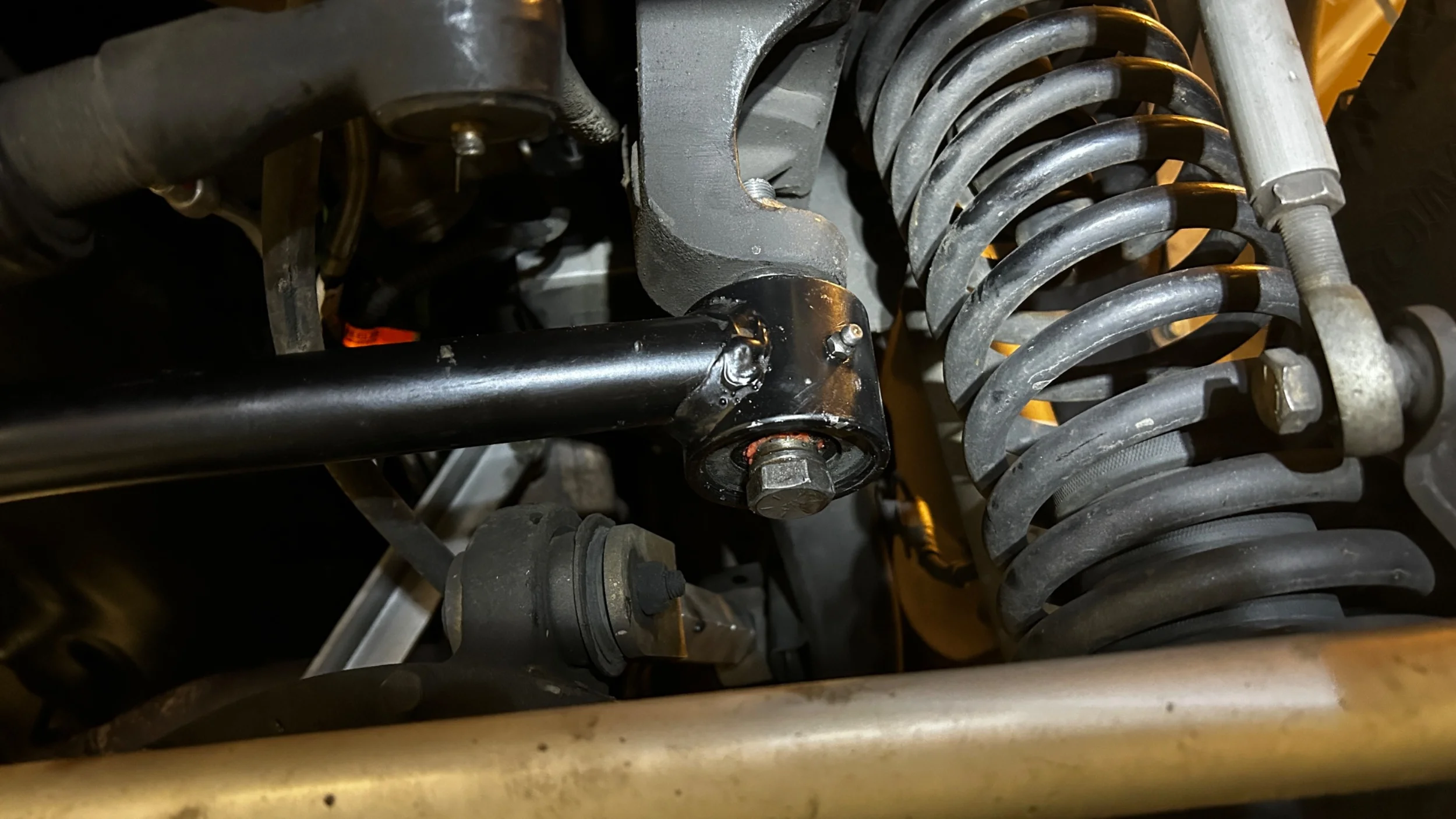

I finally got rid of one of my first mods, the MetalCloak front TB. I replaced the heim a few months ago thinking the very slight amount of play was contributing to a shimmy. In the end I just don’t think that joint is up for 35 tires on beadlocks that are weighing in at 105lb each.
I replaced it with a Currie TB, so all my steering is now RJ/Currie. I was glad to get the Currie TB because it has the smaller 10mm axle bolt and rubber bushing. I cut about 2/3” off the frame side bolt so I could get a 24mm/7/8” socket on it without interfering with the frame. Steering feels solid. Pretty quick job. Yes, the jam nut is not tight in this photo, but I tightened it after. Had a 1.5” crows foot for the job which is handy.

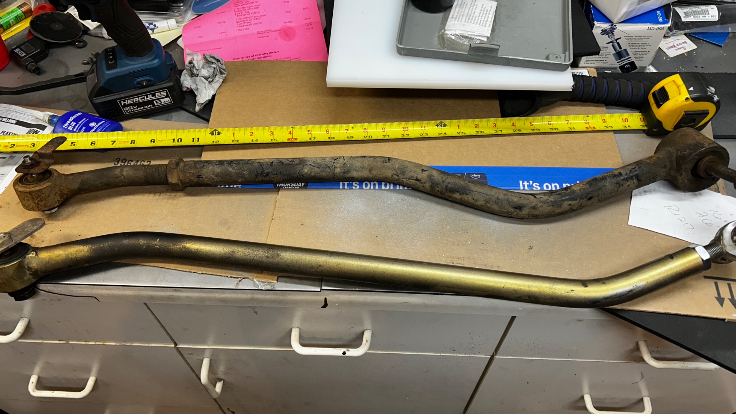

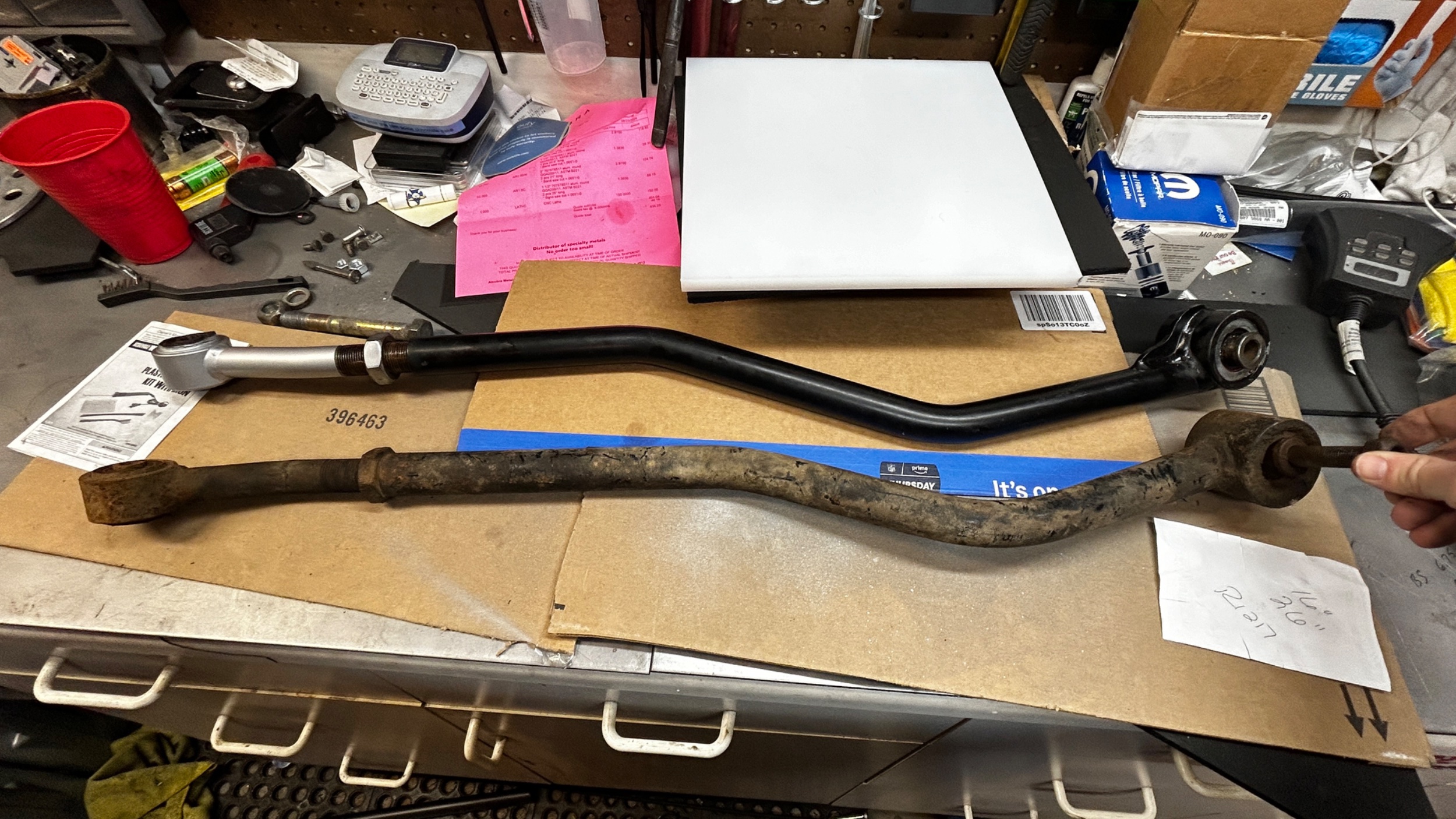

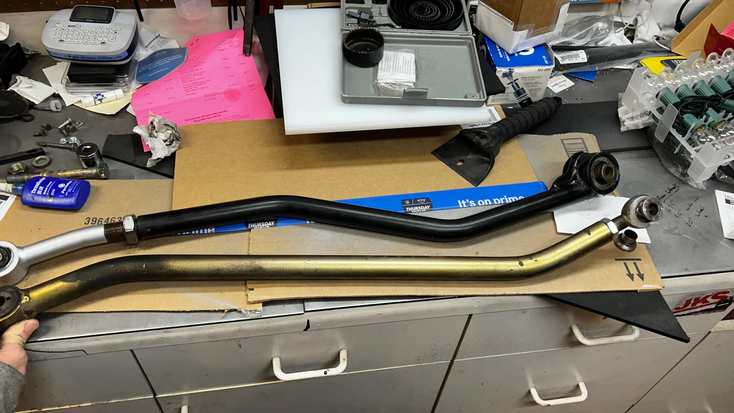

In the front TB process I drug down an old TB that must have been on one of my son’s rigs. I’m supposing it’s RC, but really don’t know (EDIT: it’s JKS). Thought it would be interesting to compare them.
Currie and JKS
JKS and MC
Currie and JKS.
The old one that you drug out of storage looks like a JKS to me. Rough Country has the adjustment at the frame side end.
That may be. One rig just got back home and I can’t even remember what TB he has. The other one has JKs and should be here in a couple hours. I’ll go take a look. These bends are only a little bit interesting, but the MC is quite different than both. I’m assuming if the other one is JKS that the housing indicates it uses a JJ.
I had a JKS for a while. They said mine had a johnny joint, but the poly race was slightly different than what I'm used to on my "real" johnny joints. The ball and construction of it was the same, and my JJ tools always worked, so I'd say it is a johnny joint, but the the castellations are of JKS design.

I remembered when you posted that you kept having trouble with the forged end bending. Probably good only up to 33’s. I’m glad to be leaving the MC behind, though it too seemed sufficient up to 33’s. Heims just shouldn’t be there.

Not forged...that was the issue.
Sounds kind of like theft.
I guess JKS used to make the bars for Currie, or so I’ve been told, anyway. So, I’m sure they had a gentlemen’s agreement at some point. May even have been a formal license.
JKS made the track bars for Currie at least 10 years ago, likely longer. Currie switched to in house manufacturing with the design change to the offset frame side joint along with changes to the bends. Around that same time, JKS kept the old designs and began using their own joints.

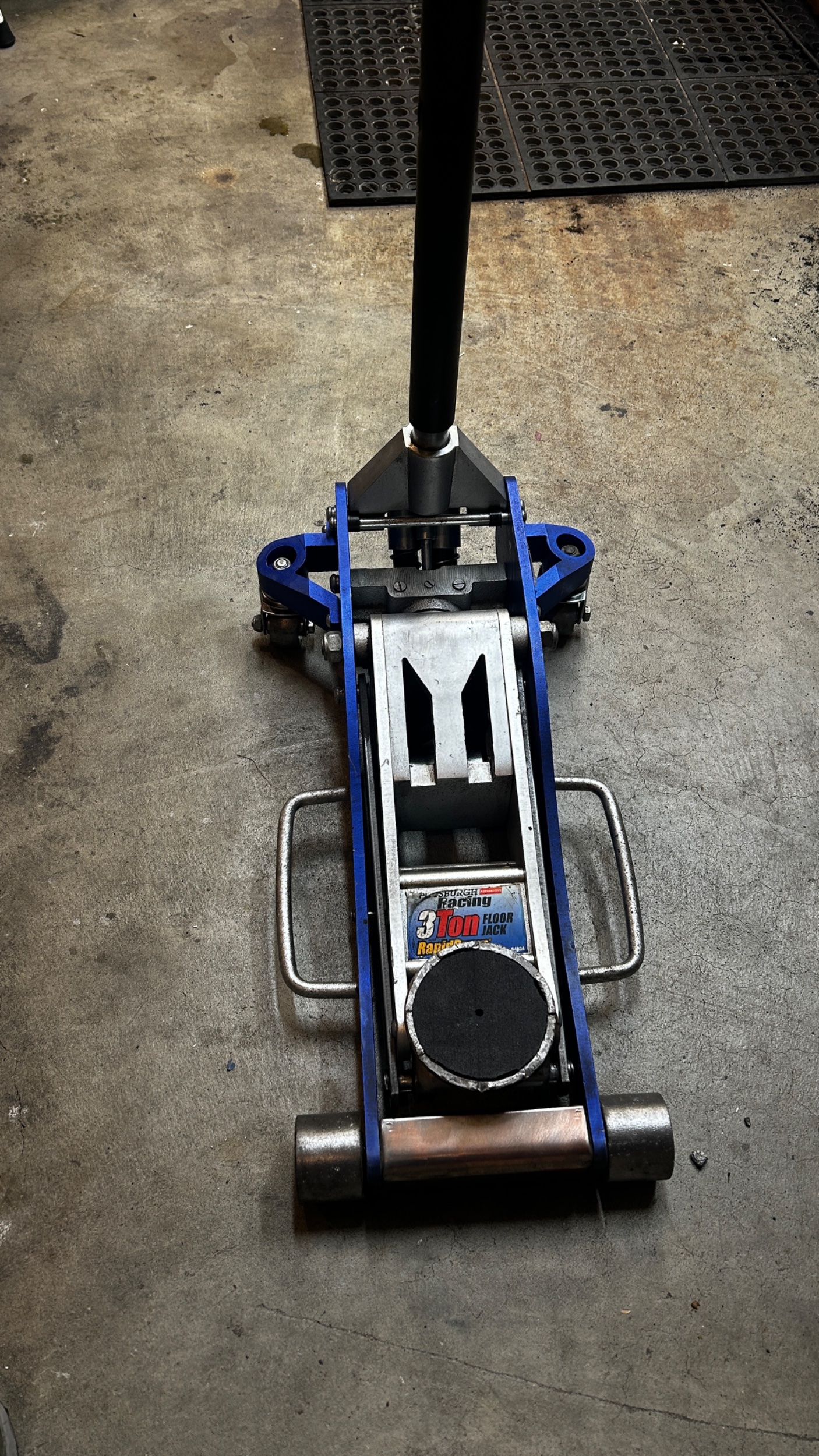

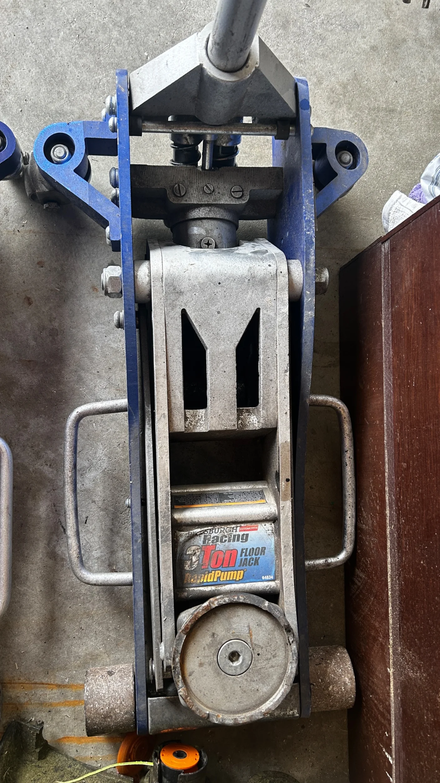

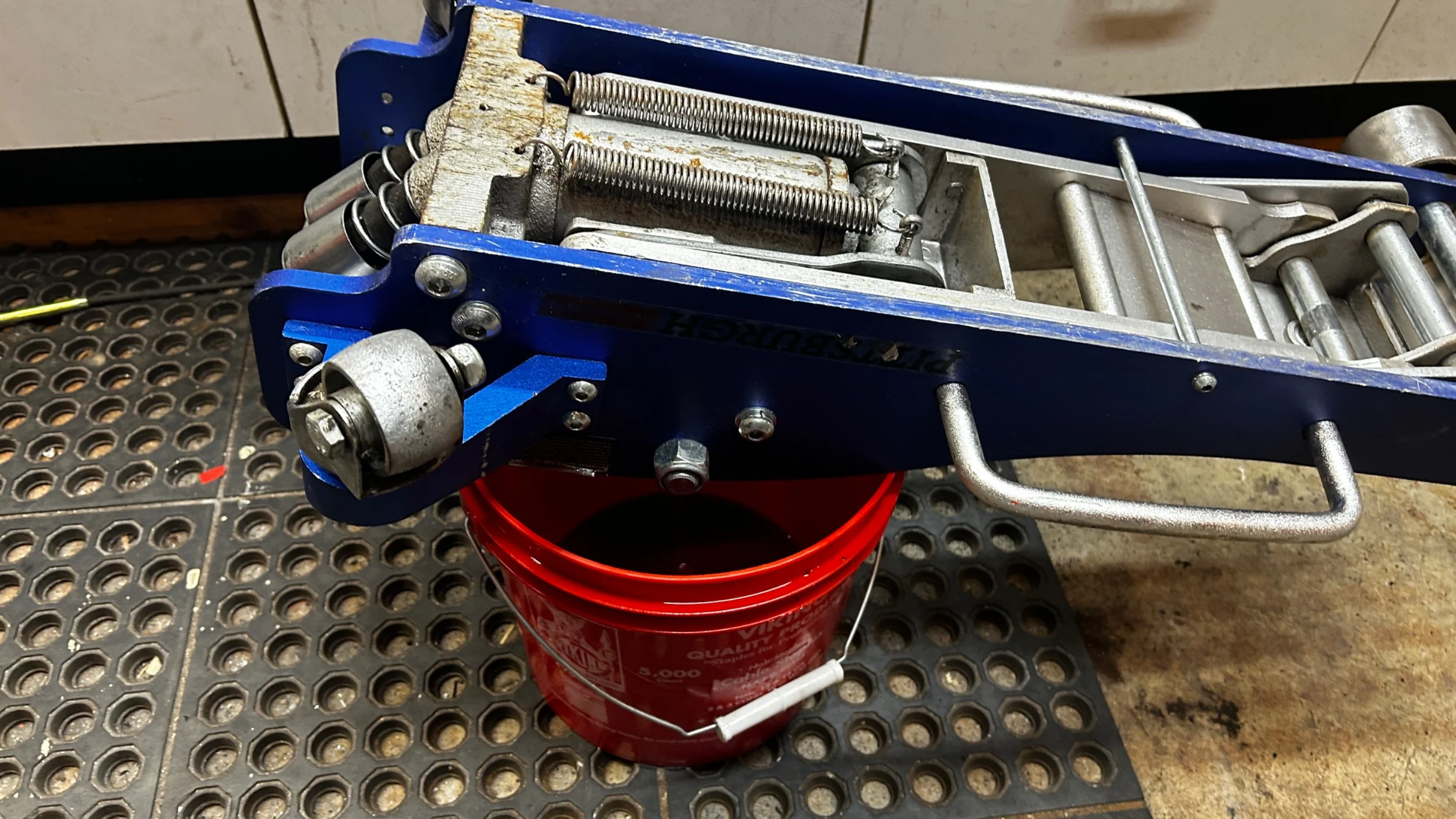

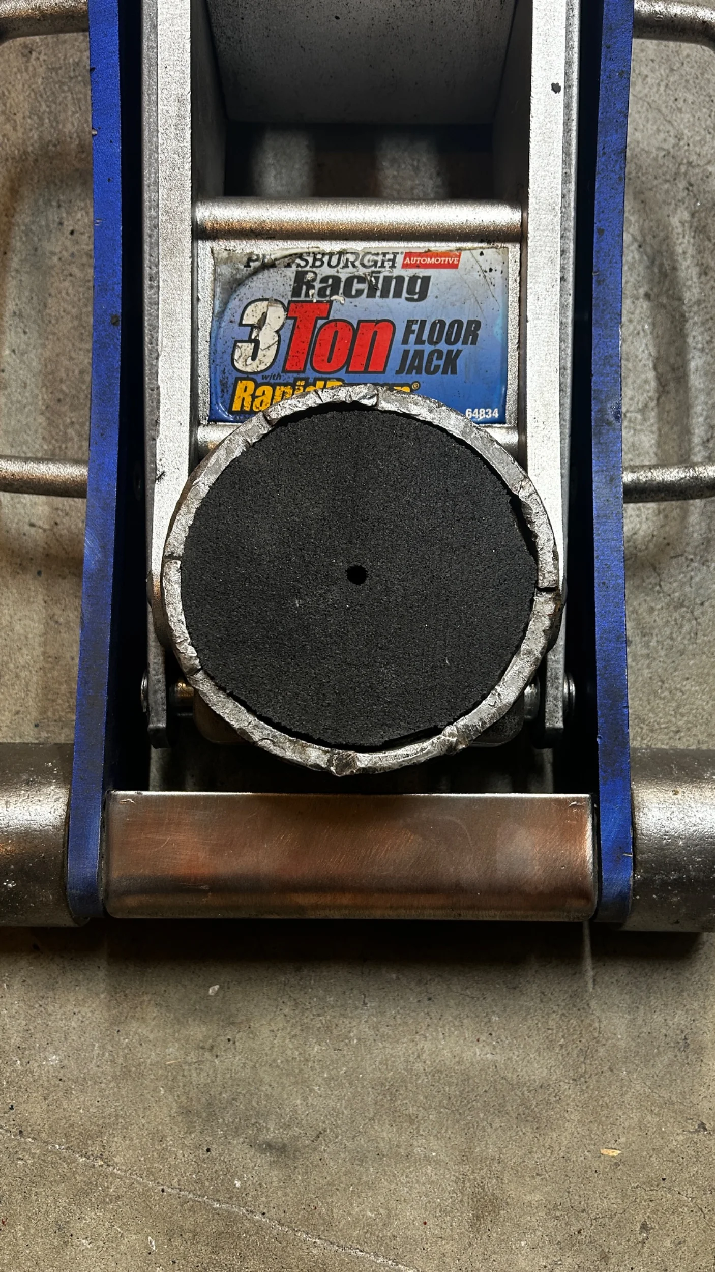

Snagged a 3-ton jack on FB for $75. It’s an aluminum Pittsburgh that matches my 2.5-ton. It had a lot of paint overspray on it. Had been worked hard and was making odd noises under load. I replaced the hydraulic fluid, greased the wheel bearings needle zerks came in handy), and made a new rubber pad for it. Ready for future projects.
