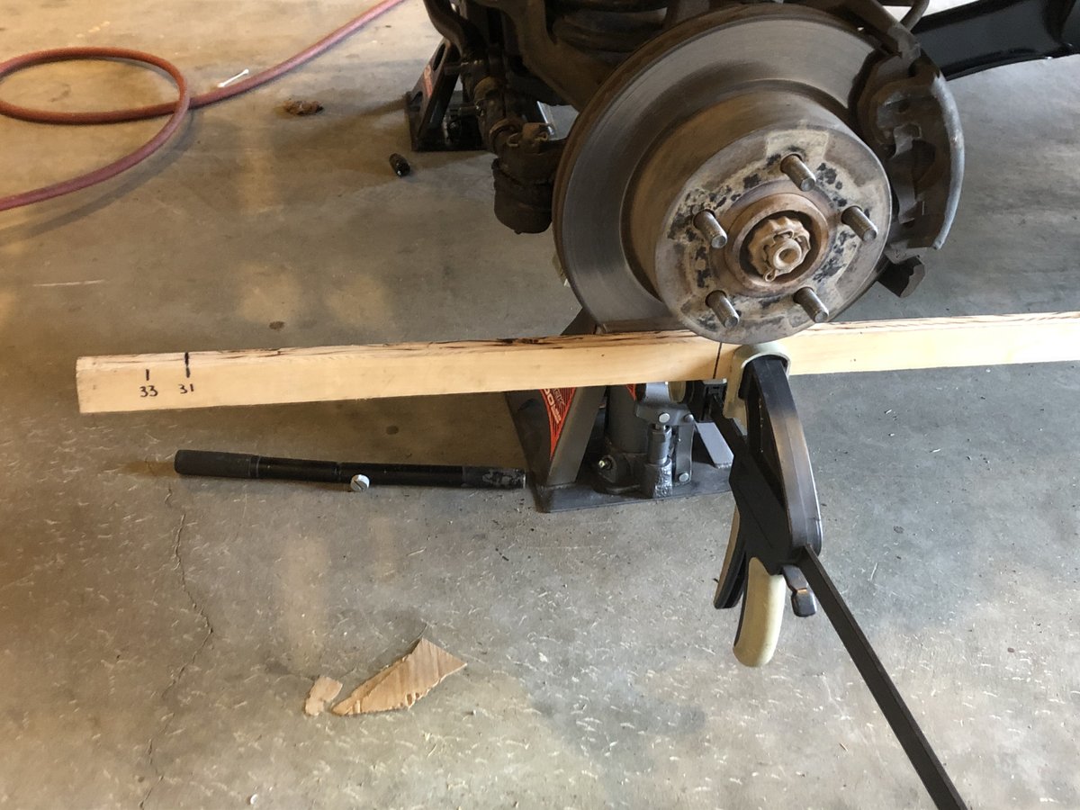

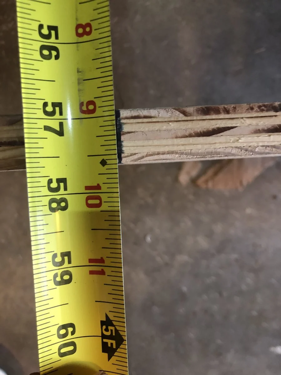

Also spent some time checking the alignment. I was toed in 1/2”. Got it down to 1/8”.
Front
Rear

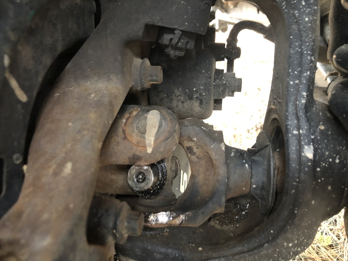

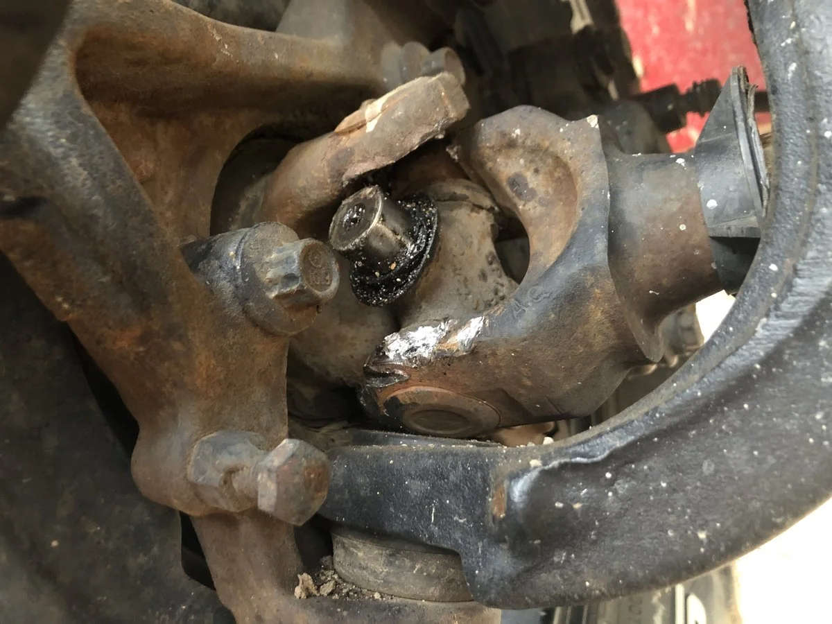

This happened today. Fortunately, I was at the ORV park about 7 minutes drive from the house and wife was able to swing over. Picked up a spicer 5-760X. I guess my plate is full tomorrow recovering the rig.
