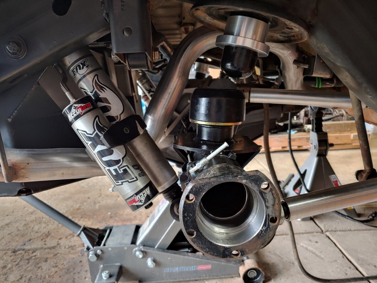

I have the ext crawler 19.5 gal with an RJ 60 with coils and shocks in stock locations. I have a ton of room between the 60 and the tank as it allows for 5" stretch. Not sure if this is one of the tanks you're considering. Kind of got lost in all the ones mentioned the past few pages.

How much room do you think you have to move the axle back?
I have a Teraflex CRD60 so about the same size as your RJ60.

I'll measure for you tonight. I already have the axle moved back some (essentially have my Savvy double adjustables fairly extended lengthwise).

Thanks, I know they say 5" for a Dana 44 so I'm sure our Dana 60's can't go back that much.

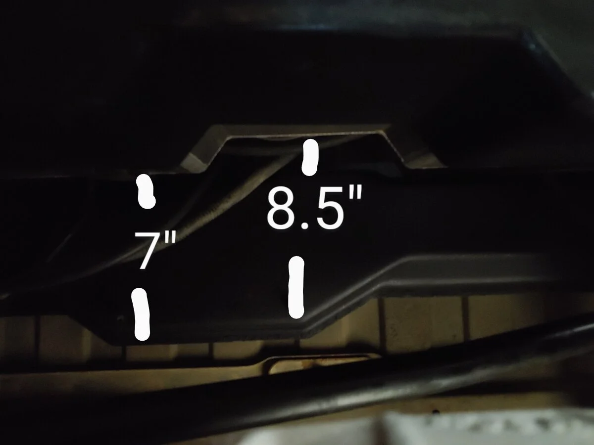

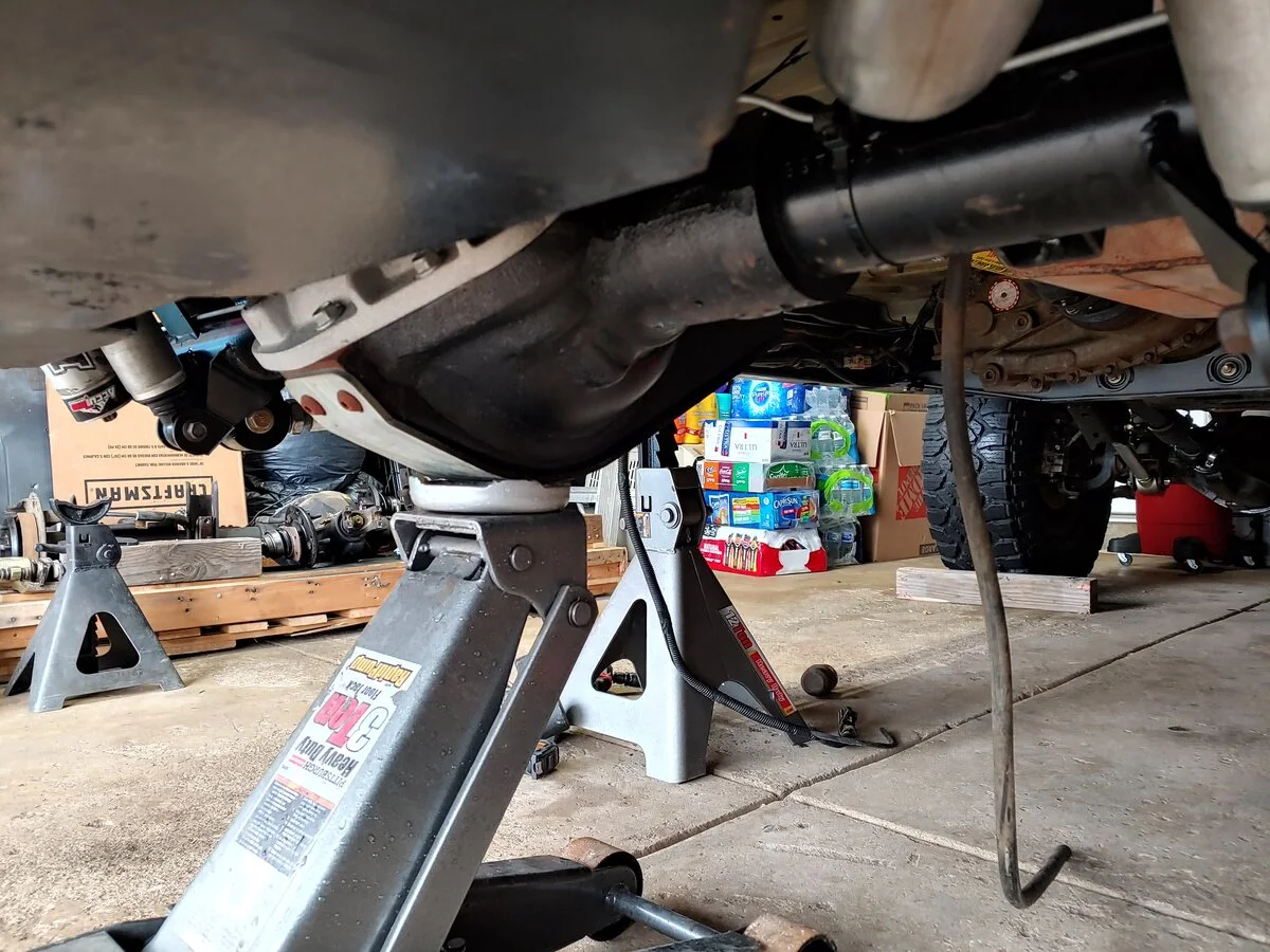

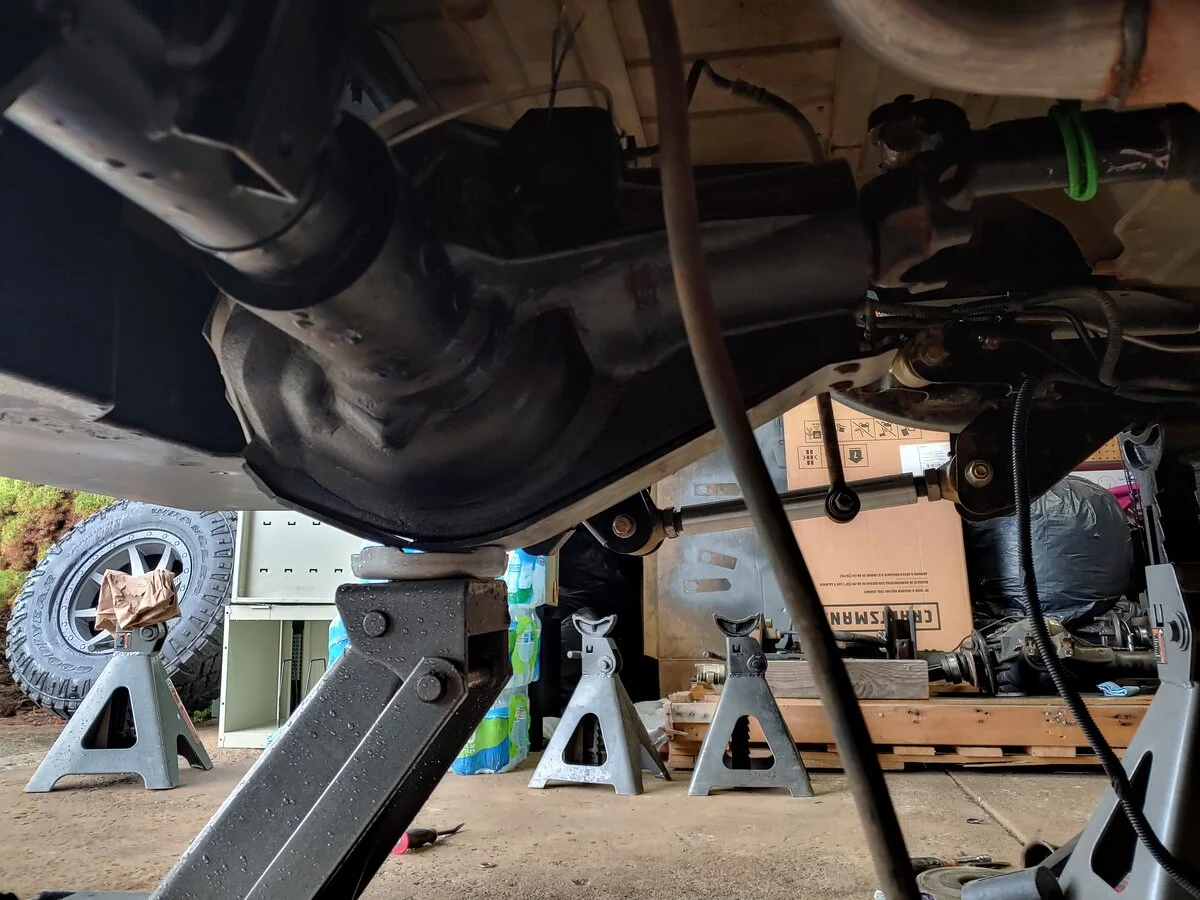

@Wildman because I have an LJ not sure where to get relevant reference points to measure for you. From stock CA brackets my uppers are 14" and lowers are 16.5" center of bolt to center of bolt on 5" of lift. Also, I measured from front of crossmember to front of tank and to center recess. From rear of lower CA bracket to front of axle is 14.5". Any other measurements you would like from different reference points?

I forgot you have a LJR so I am not sure either. I think it'll just be easier for me to stick with the fuel cell plan. But thanks for the measurements.

What’s your wheelbase?
I didn’t measure when I had the wheels off but just taking a tape measure to the center caps ~94 3/4”. I had pushed out the front to fit the 35s behind the front fender wall. The rear lowers are 15.5” to fit the tires as best as possible in the wheelwell
My lowers are at 15 5/8”, so very close to yours, could just be margin of error. My front is on stock CA’s and my wheelbase is 92 7/8”. IDK if any of this information helps with whether the Core 4x4 Rear TB is a good fit for your situation.

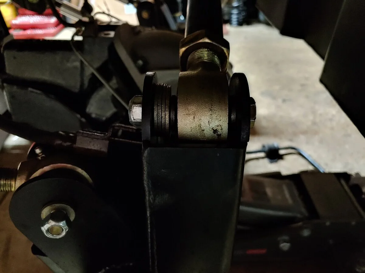

It sure is purty under there! What’s with the washers on the axle side trackbar bracket? What bracket has enough space for those? My Currie is super tight. I have to bang in the trackbar to line it up.
