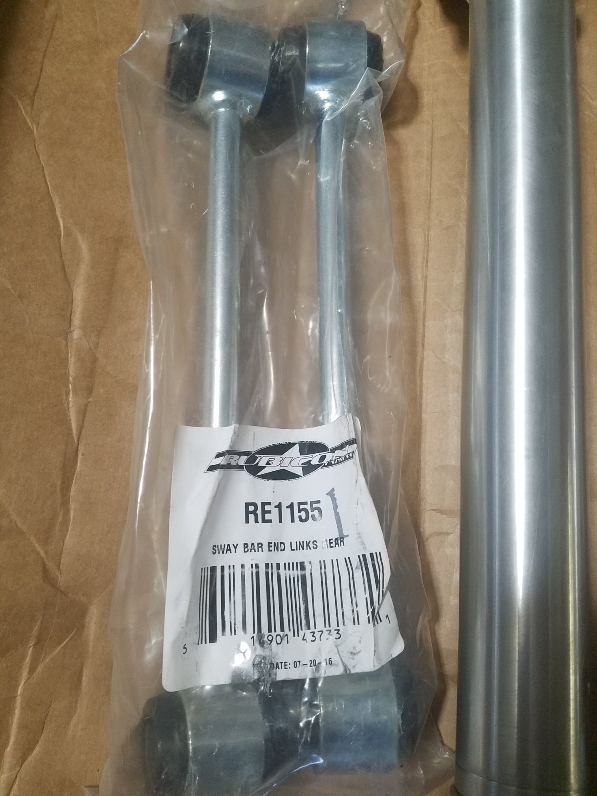

Got the final package of parts for my Savvy/Currie lift and thought it was interesting to see these when I opened the box.
Not that it's a big deal, I mean they are extended links and not some specialized part.
Yeah, they aren't going to bother building their own, when all it is a sway bar end link. There's not really anything that can be done to enhance that part, so I see why they've done it. Hell, on my Currie lift I am using Rough Country sway bar end links, and they look identical to those.

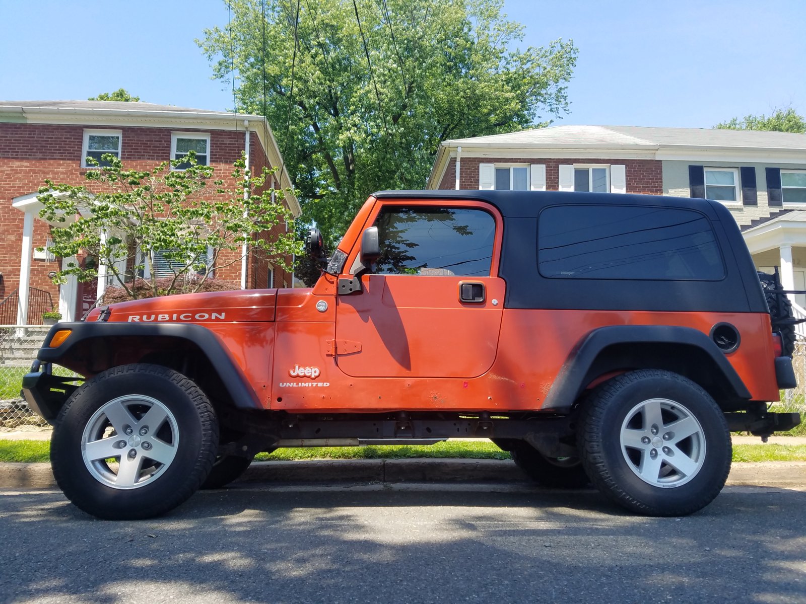

Another week went by and during that time I got my shocks ordered Bilstein 5100s (Thanks to Kolak over on JF for a great price!) Also ordered some Spidertrax 1.25" wheel spacers. Then this last Wednesday I got in the shop and mounted up my 285/75-16 Falken Wildpeak MT01 tires (that had been sitting in my basement for the last 5 months!), got the wheel spacers installed and finally got some proper rubber on the Jeep!
Funny enough I didn't notice till after looking at the pictures that after a week I ended up parked in the same space in the same position and snapped the photos from almost the same angle for the before and after on the tires :)
