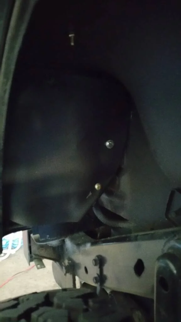

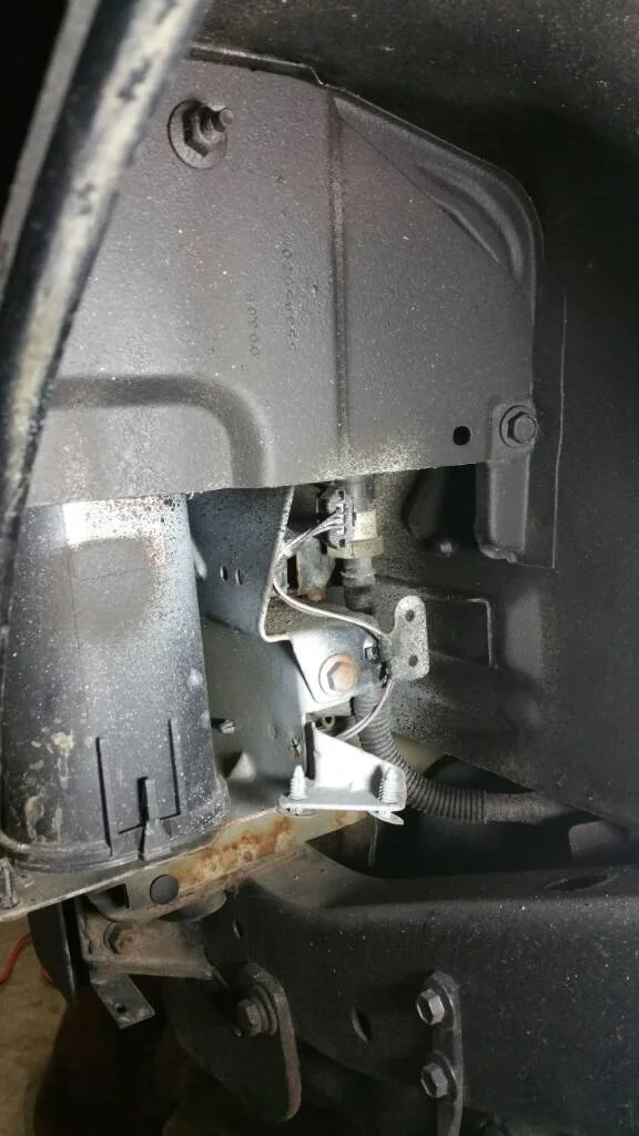

I made a debris guard today with some spare metal. When I took out the rear fender liners there were exposed wires and such that I wanted to be protected.

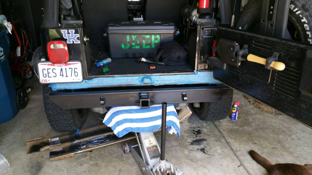

New bumper is bolted on, but not frame tied yet so I can't tow or recover yet.

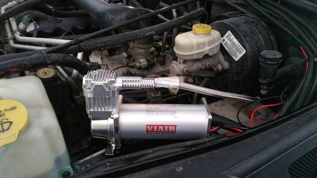

Compressor is also mounted

Is it absolutely required to have frame tie ins?
I bought one of Dirtworx's original bumpers (looks like yours but was 10 years ago when he was on ebay) and bolted it up on my 2k TJ that I had at that time. I yanked, towed, and got yanked with that bumper for years and it never flinched. They didn't have frame tie ins for TJ's back then or at least I never saw them mentioned on the forums.
Reactions: joshself
I've been told it will keep my frame from bending in undesirable ways when recovering or towing. I could do so now, but I'd rather not have the adverse effects on the frame in the long run.

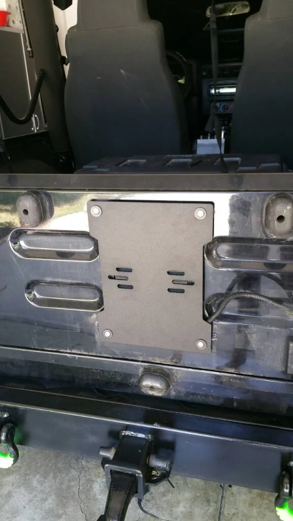

Well since my spare doesn't fit with the new bumper I added a vent cover. Hopefully soon I'll fab something up so I can mount my last small light bar there since my reverse lights no longer fit my new bumper.

That air compressor sure looks nice under the hood!
Thanks! It fit perfectly there and was close to being perfectly level. I had to get rid of my PA horn, but hey that thing was only for messing with people- this is practical.
I'm running the air filter for it into the cowl to keep it dry and clean and then the supply line to the tank will run under the center console to the back.

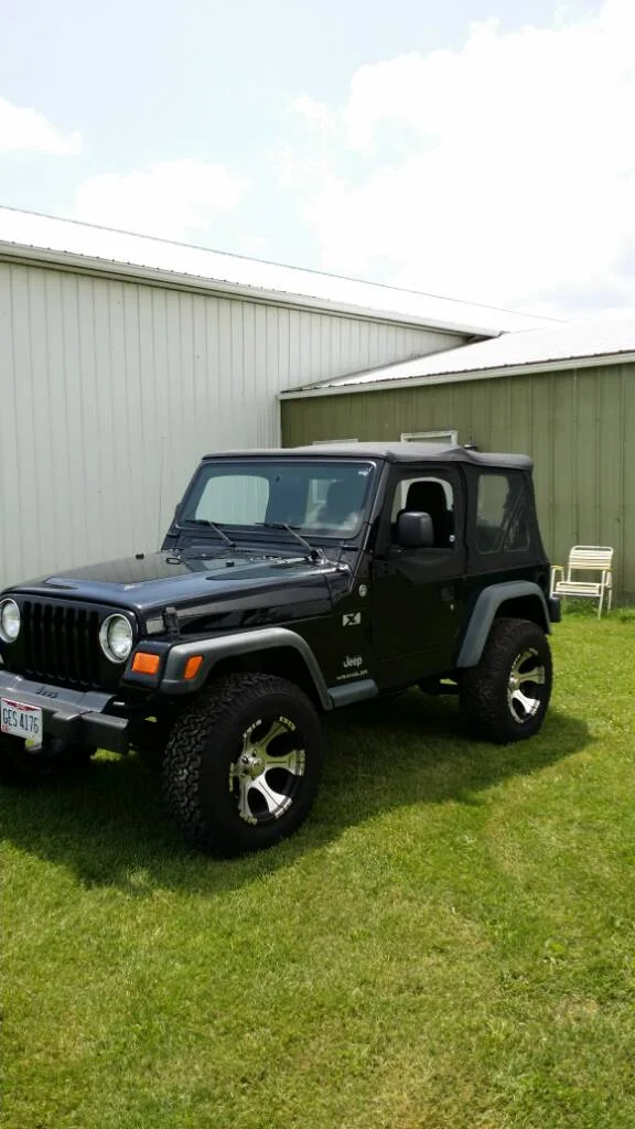

I bought my 06 TJ about a year and a half ago and it has progressed from then. It's a 6 cylinder 4.0l with a 6 spd transmission. I've done what I can with it whenever I have time, so most of the pictures I'll add are past projects and mods and they'll eventually become present.
Picture when I bought it from the PO:
Currently:
