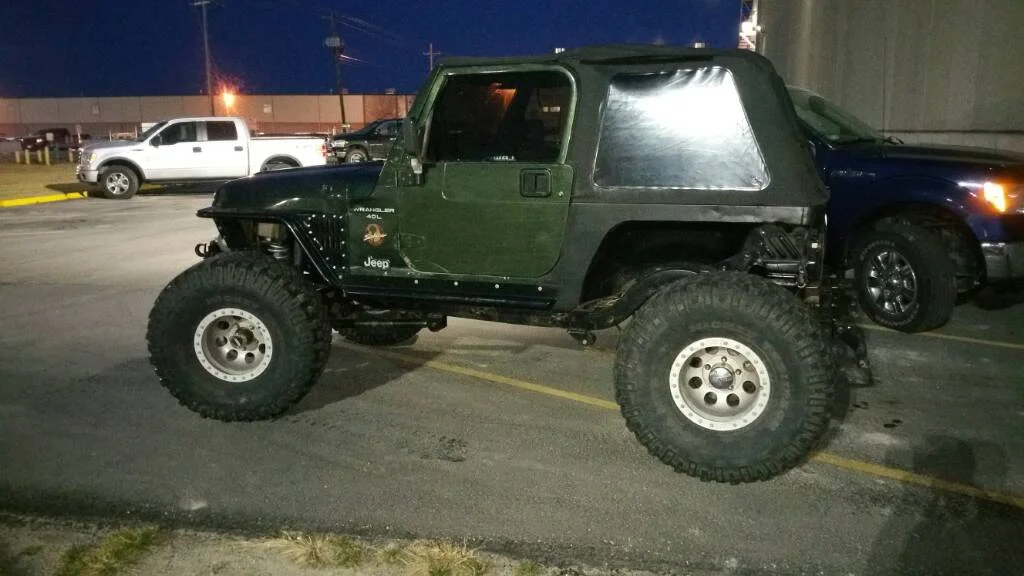

Decided to drive it to work. Was iffy at first,but it went ok. Did 75mph. Still needs shocks on the rear.
Why iffy at first? Did the jeep settle down or did you adapt?
The first time it was on the highway in 9 months. Thoughts of it flying apart crossed my mind. Mainly the spooled rear axle with no shocks. And no sway bars at all. But I cranked it up to 75-80 for a half mile and no shakes.
I think it woke me up at 5:30am, then it settled down

I will . I've gotta unbolt my current jk rubi shocks so I can get full flex potential.
Rear axle is bottoming out, a few things I didn't account for.
Either flip my u-bolts over and run them down or notch the frame.
