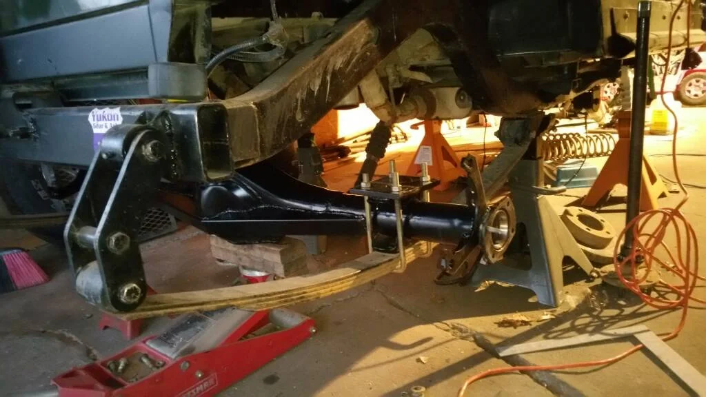

Damn, looks like you've really given this axle a new lease on life. I like it!

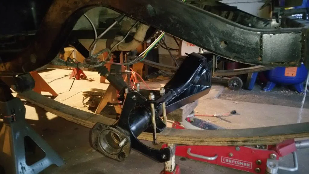

Test fit. As of now I'm using the most forward hole in the spring perch
I keep forgetting you have leaf springs! Reminds me of my good old XJ!
