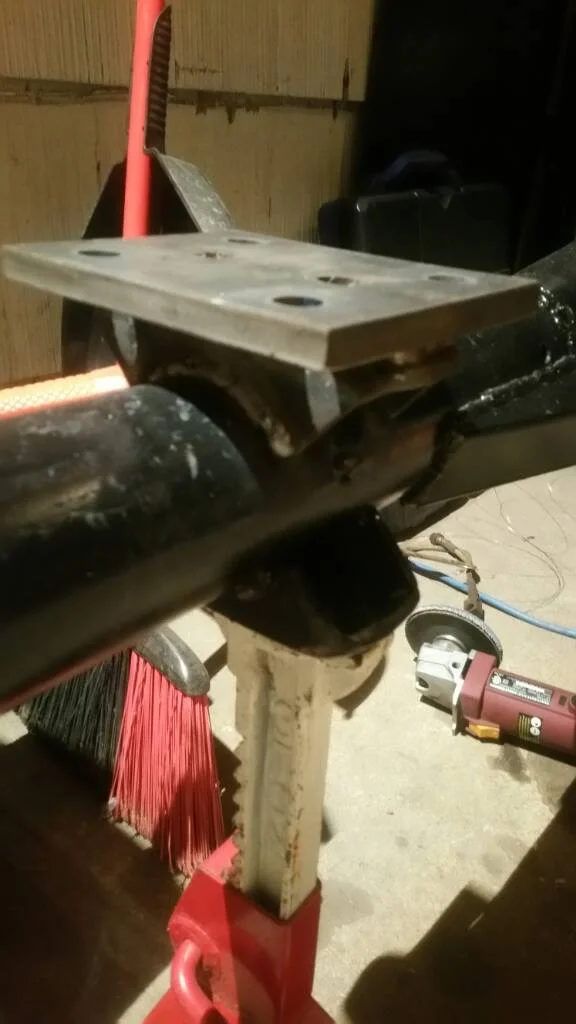

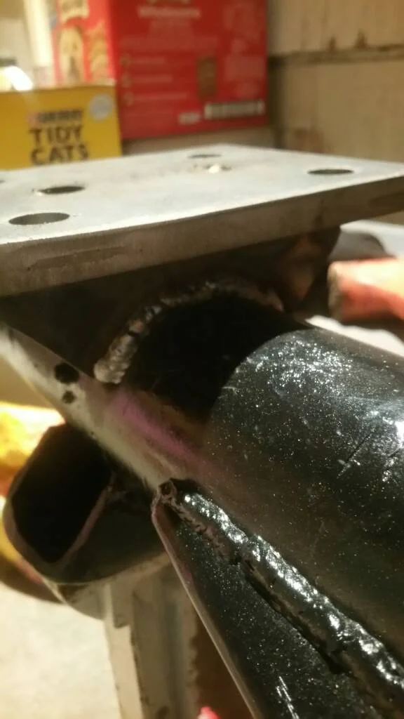

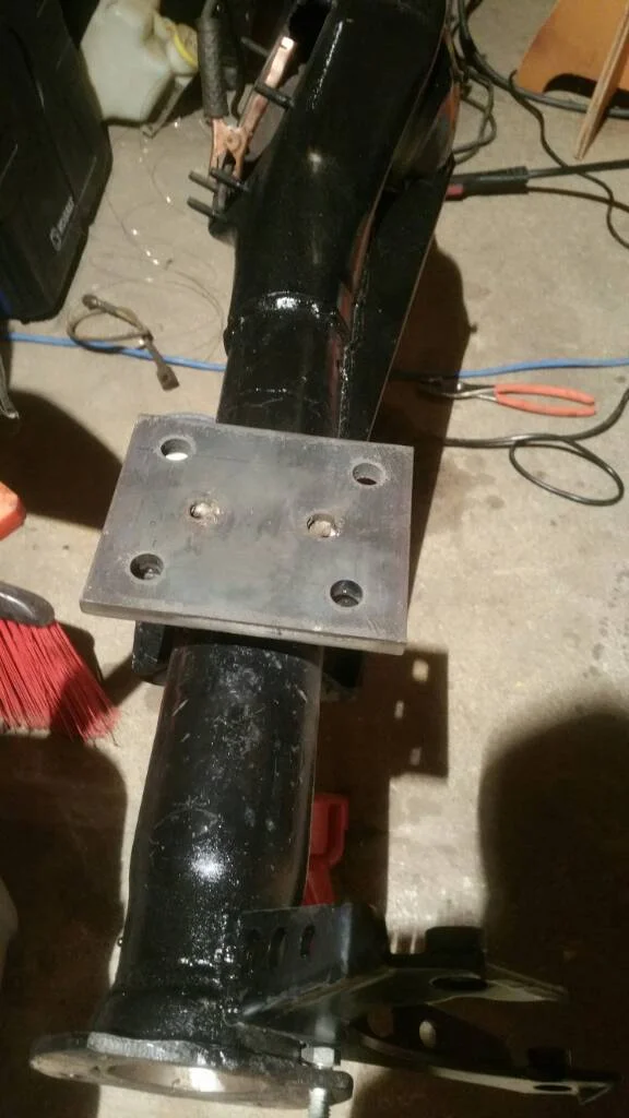

The welds are a bit on the cold side. Turn the wire speed down or the voltage up just a bit.View attachment 2188View attachment 2189View attachment 2190 planning on my U-bolts running up and not getting me hung up. I picked up some extra spring perches from our local dirt track store. It was not easy getting in the small area to weld.
I ran out of wire, so when I put the new wire in I turned the speed up to feed. I got in a rush and didn't check it. Still learning lolThe welds are a bit on the cold side. Turn the wire speed down or the voltage up just a bit.
Some progress. I should of took a welding class. I should get my 9" 3rd member tonight. And slowly get it ready for install on Saturday.Looks like you're making great progress though.
