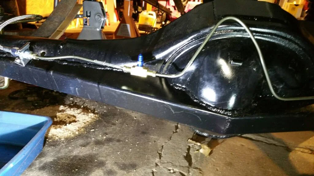

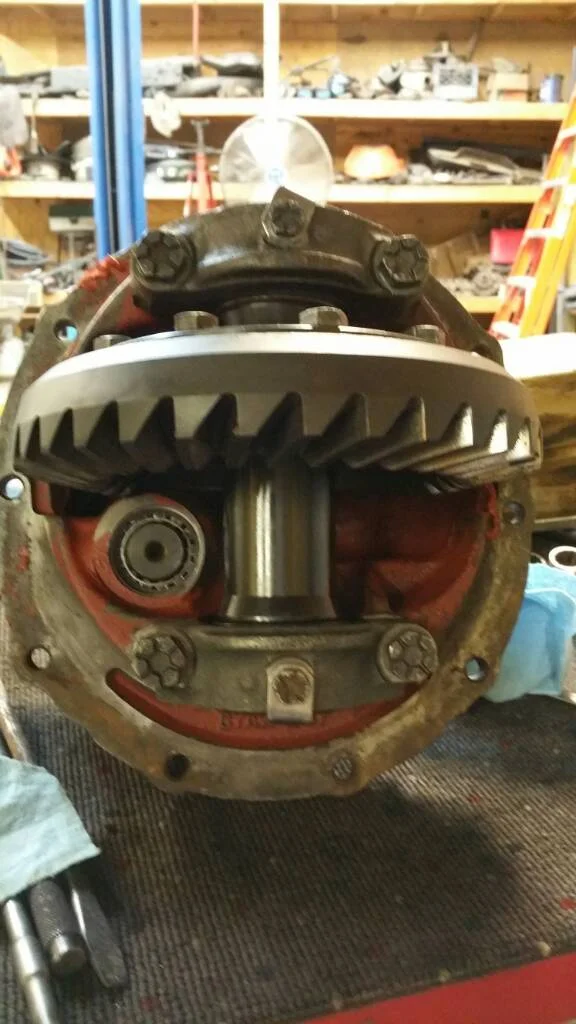

And spool is done. Gonna assemble 9" now
Not the best job, but it was a massive battle and several trips to local dirt track store.
It looks good, that's for sure. Looks like your hard work is paying off!

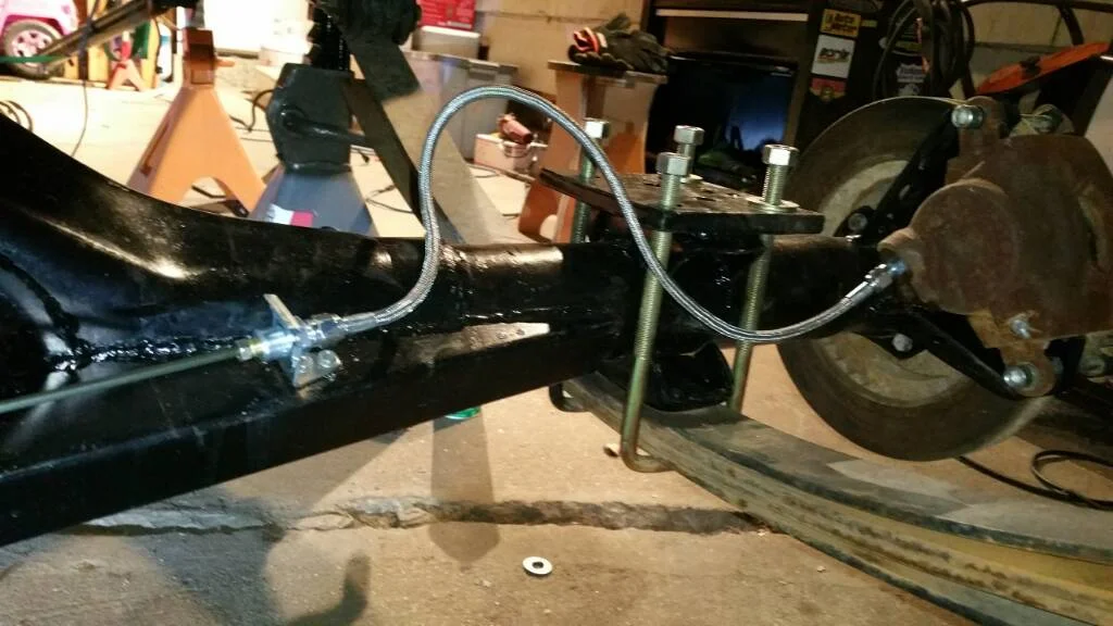

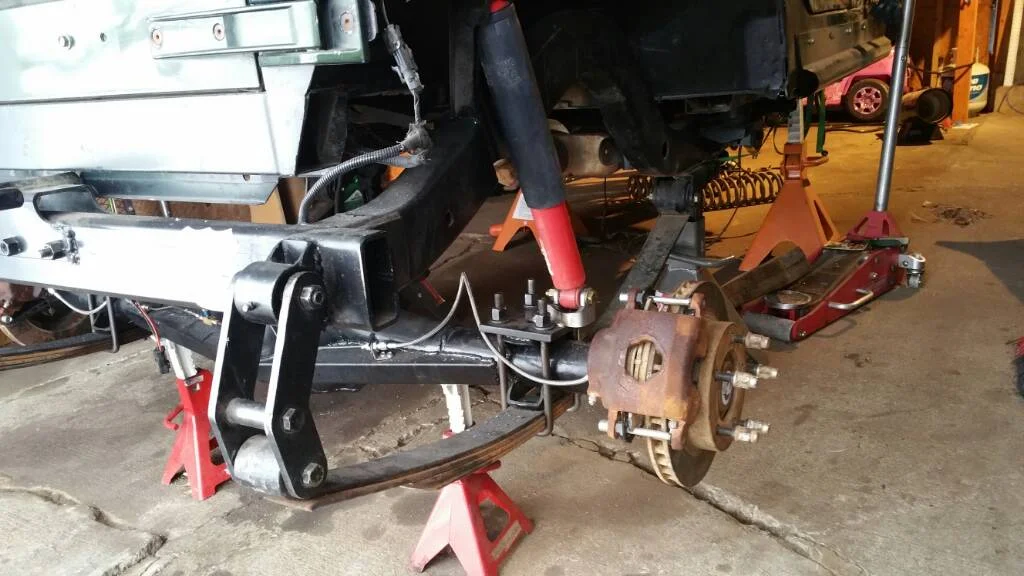

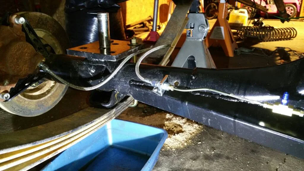

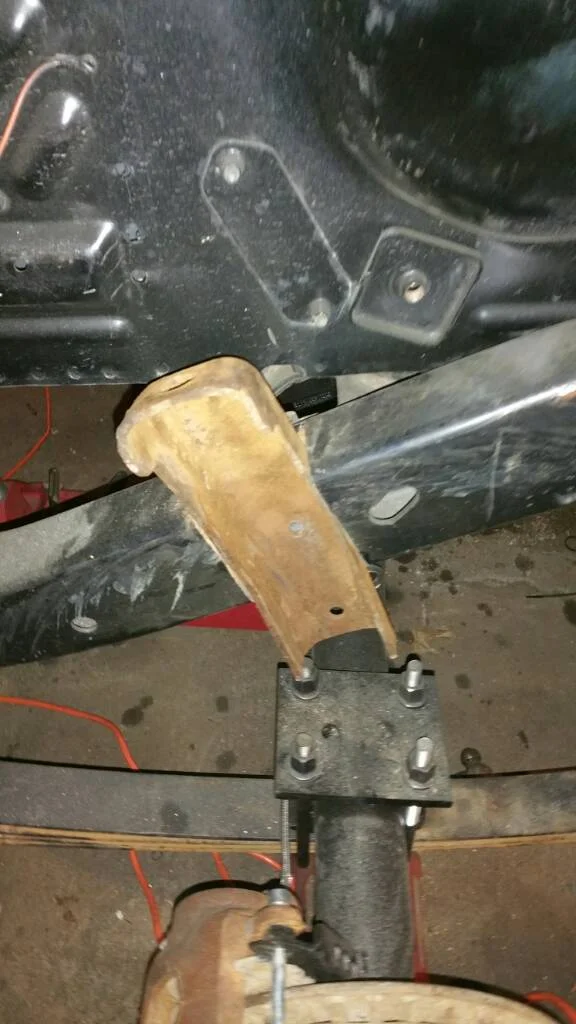

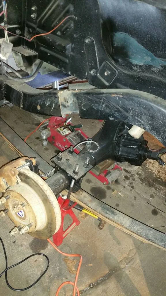

Brake likes done. New u-bolts ( from local big truck store). Frame notched for Ford shock towers, need to get drive shaft lengthened 4".
Going to get shock towers sand blasted, then hopefully weld them in tomorrow.
Nice, time to outboard those shocks!

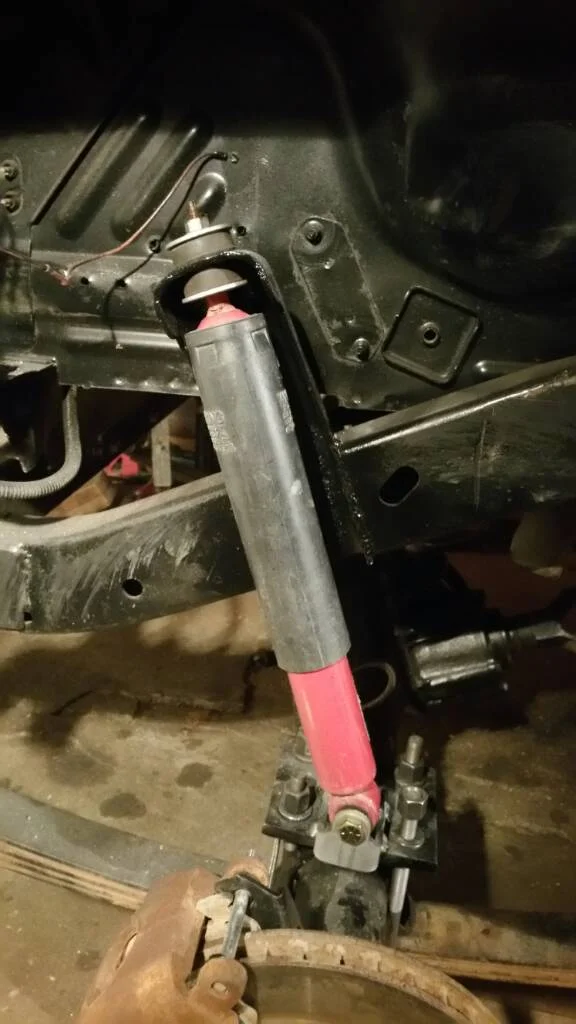

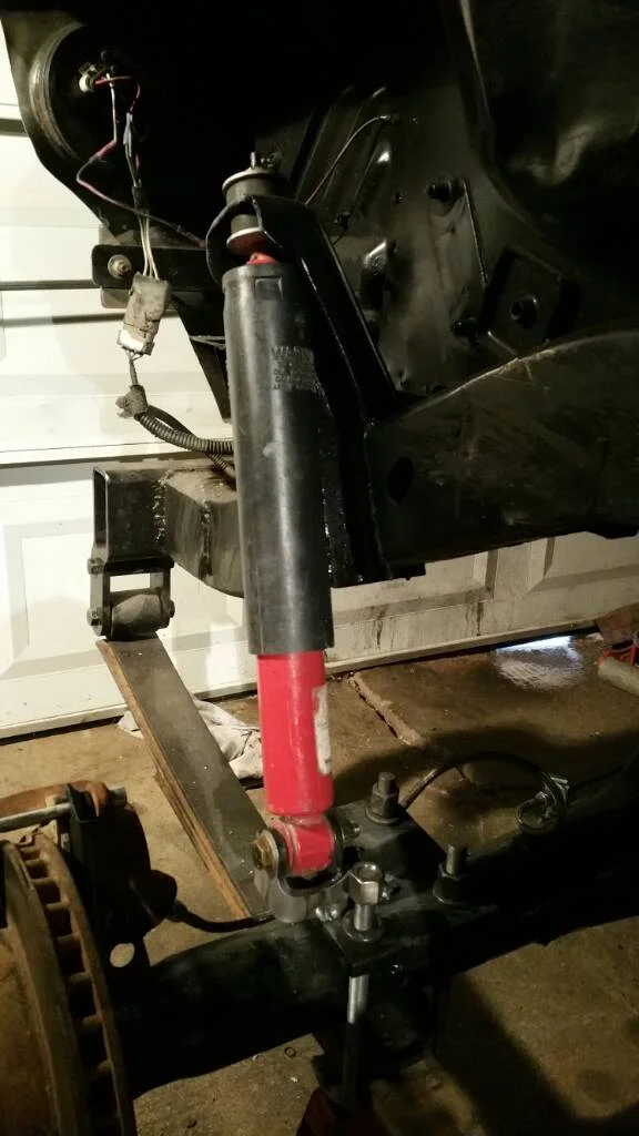

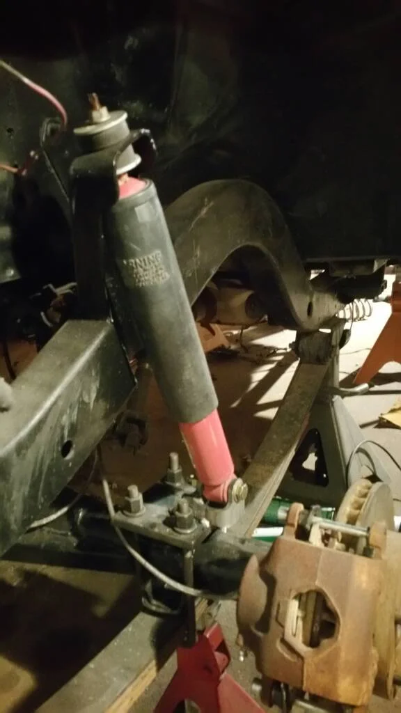

Trying to take advantage of my front JKU rubi shocks. They may not have ehough travel, but will get me by til I can get my clubs RTI ramp.
I realized I had some old Artec industries shock mounts. Worked good on of the spring plate
Yep, I'm sure people do a double take at it thinking it's a YJ or something.

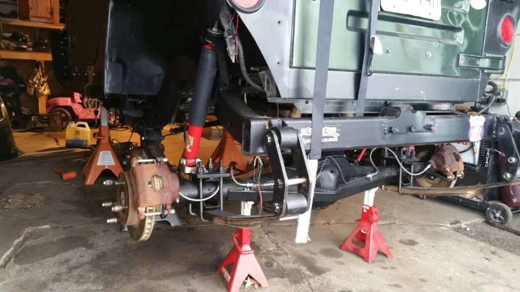

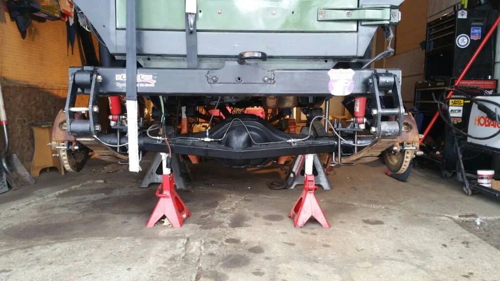

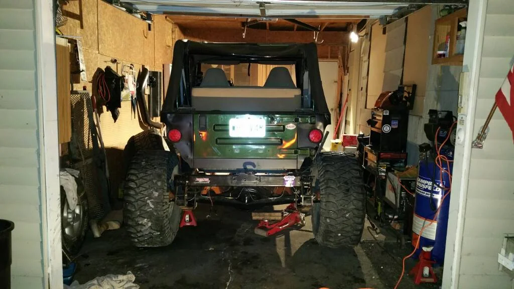

Got a quick chance to sweep up the garage (tight space with one outlet)... so snapped a few more. Driveshaft should be back tomorrow.
Now that's some quality craftsmanship!

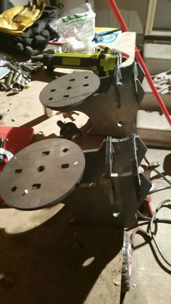

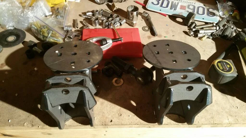

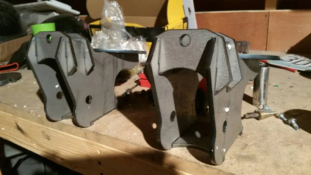

I'm happy with the product. The wait sucked, but having issues with my Dana 44.
I was afraid to weld these, so sourced them out for $30
For that price they can't be making much of a profit on them anyways.
