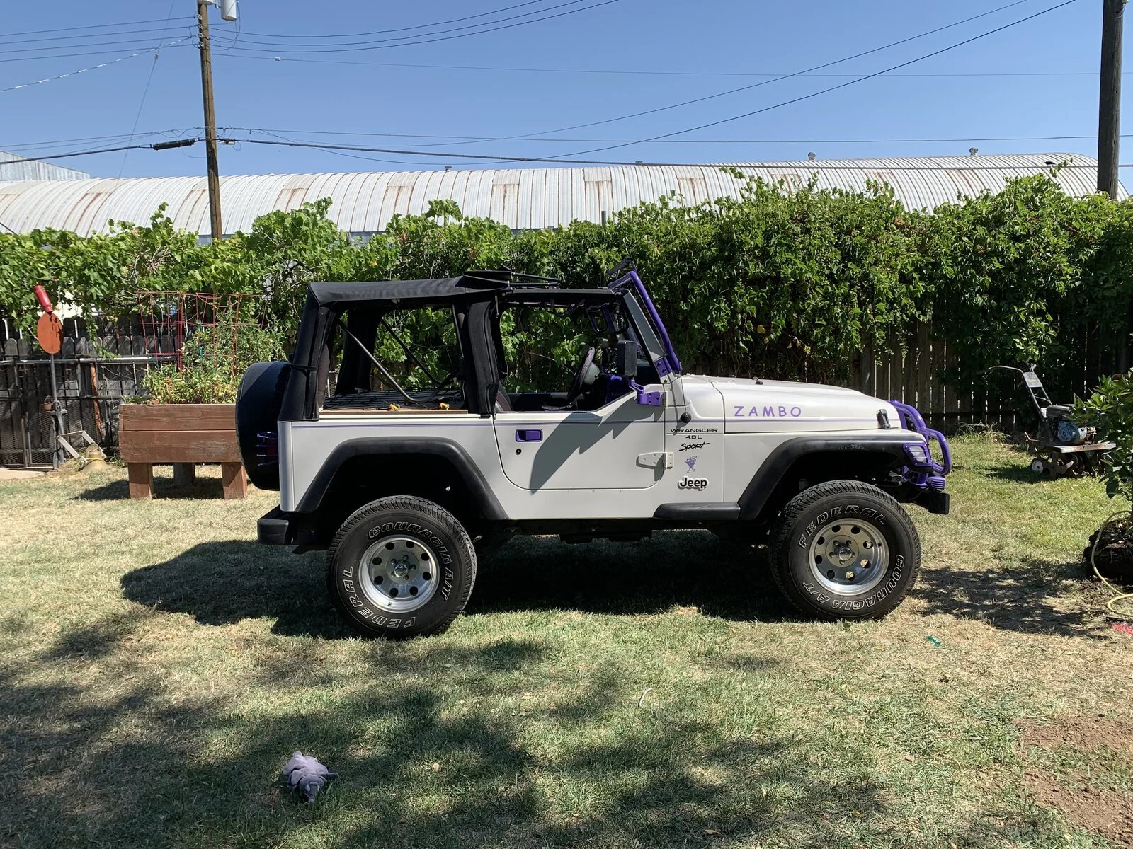

I have a 2005 TJ 4.0 Automatic with Dana 30/35. It has a soft top, roof rack, front bumper and winch, and new wheels with 32” tires. My father recently passed and willed this to me. He just got it in March and was in the process of building it.

I would like to run 32-33” tires and do a Tummy Tuck with this lift:
-2” Pro Comp springs
-2” Rancho RS5000x Shocks
-Saavy 1.25” BL
-Saavy or Brown Dog 1” MML
-Saavy T-Case Shifter Kit
I understand that I can likely lift the Jeep without needing the SYE, DC Driveshaft, Adj. Control Arms, etc…but I’m kind of confused how to go about the tummy tuck without all of those aforementioned parts. Here are my questions:
-Do I need, or is it recommended, to get an adjustable front track bar and rear track bar relocation bracket for this lift?
-Do I need, or is it recommended, to get an SYE and Double Cardan Drive Shaft for this lift and tummy tuck?
-Do I need, or is it recommended, to get Adjustable Control Arms for this lift and tummy tuck?
-If these parts are needed for a full tuck then is it possible to add a lower skid plate (and still provide more tuck than stock) without having to spend on the SYE, DC Driveshaft, and Control Arms with this lift? I know UCF offers a few different heights. I’d rather compromise an inch on the tummy tuck than spend a couple grand on those parts just to get the full tuck.
-Lastly, am I wrong in thinking that if I spent all that money on the SYE, DC, Adj. Control Arms, and full tummy tuck…that I might as well look at a 3”+ lift to better clear 33” tires?
I want to do it right but I also don’t want to spend the money on unnecessary parts if I’m not planning on a bigger lift and 35’s. Can somebody properly run a 2+1.25” lift on 32” rubber and tummy tuck without the SYE, DC Driveshaft, Control arms, etc.?
