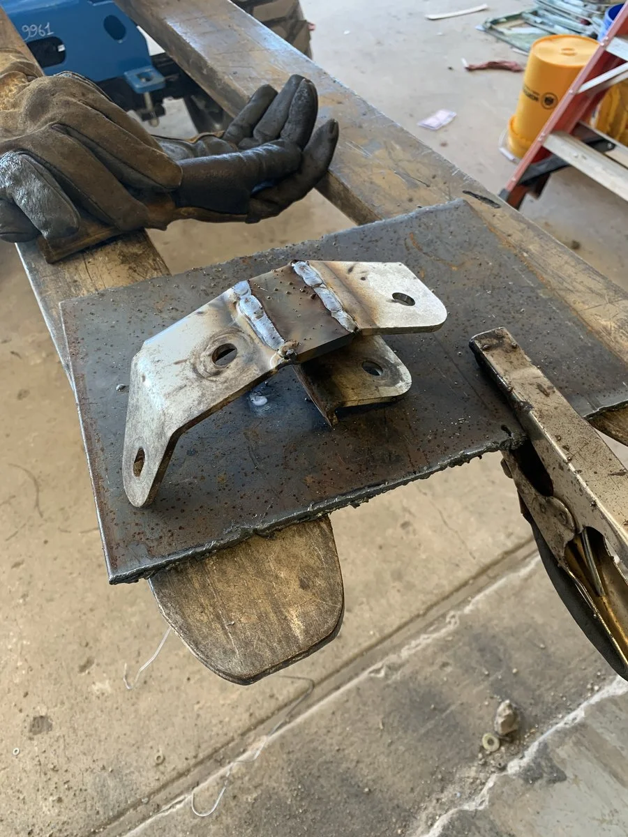

So I just got done doing a tummy tuck. I have tow zone 4.25 combo lift. Earlier in the build I did the savvy transfer case cable upgrade, I also did full adjustable Currie arms so I had my self set up to do the tuck. What finally made me pull the trigger was someone that I wheel with put a atlas in his Jeep and had to get new driveshafts. So I purchased his old t case with his sye kit and his rear driveshaft. Ended up making my own skid and low profile trans mount. Got the exhaust to barely fit with no modifications but the hangers. Modified the track bar relocation bracket for when I rolled the axle . Then I cut the spring buckets to clear the rear shocks. With all that I got the tuck done for 300 bucks.

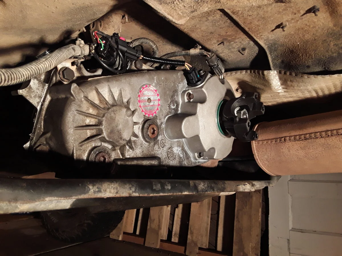

to answer your question, the best SYE for a future tuck that I'm aware of is the JB Conversions super short.
I just installed one, my driveshaft is supposed to be delivered today from Tom Wood.
It's short enough that it doesn't have room for a speedometer gear and instead comes with a tone ring and speed sensor. You'll need the BlueMonkey speedohealer to correct the speedometer reading, which you would also need if you got a 241 out of a Rubicon.
So in the end it'll cost you about $250 more than a standard SYE, but if you want to do a tummy tuck later on, buy once cry once.View attachment 141346

So fortunately for me (unfortunately for you) I bought mine from Blue Monkey, which included the harness to make it completely plug n play but it appears they are no longer in business.
The actual device is called a Speedohealer made by a company called Healtech. You can still get the device on ebay
https://rover.ebay.com/rover/1/711-...0001&campid=5337789113&icep_item=303478361327
But you'll have to wire it in on your own.
I also put in a new transfer case chain while I had it apart, and replaced the input and front output seals, the oil pump o-ring and filter screen.
And then there was all the rear suspension stuff to get the pinion pointed correctly - Savvy aluminum adjustable upper control arms and a JKS angled track bar bracket.
My transfer case shift linkage was jacked up and I got tired of messing with it so I made an impulse purchase of a savvy cable shifter. Totally unnecessary since I'm still on a stock skidplate but when I go for the tummy tuck, it'll already be done and I won't have to touch it.

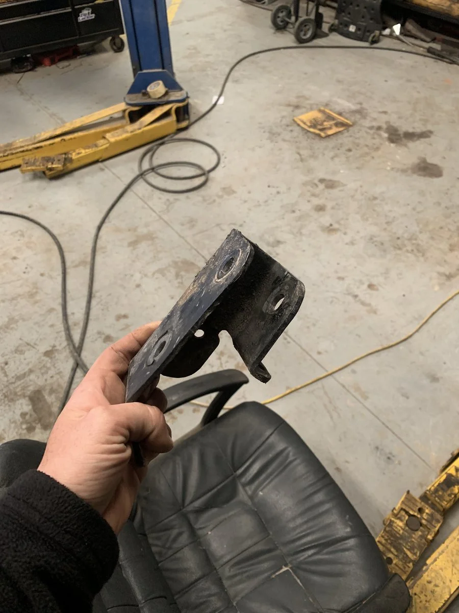

Idk what the track bar relocation bracket looks like in the zone 4 inch kit, but here’s the one from the 4.25. I just cut it and modified it.
