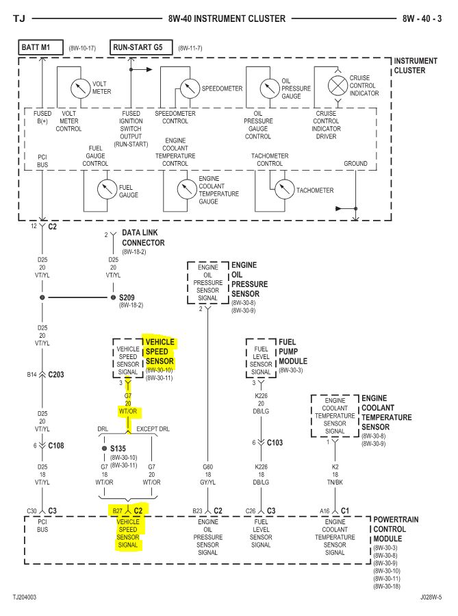

Here's the link to the 2002 FSM (Factory Service Manual). Speedo wiring starts at 8W - 40 - 3

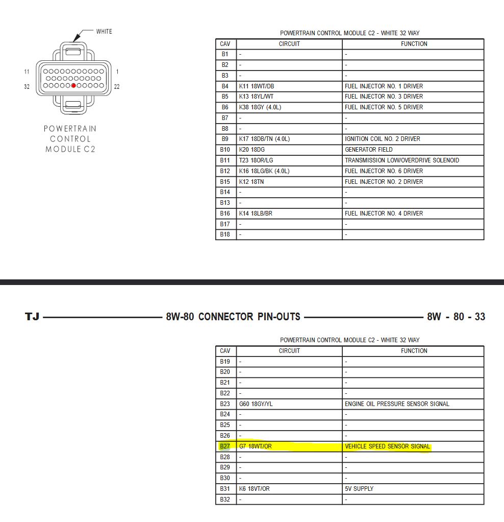

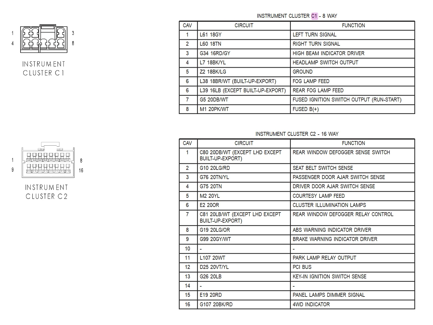

Cluster C1 & C2 pin-outs are at 8W - 80 - 25

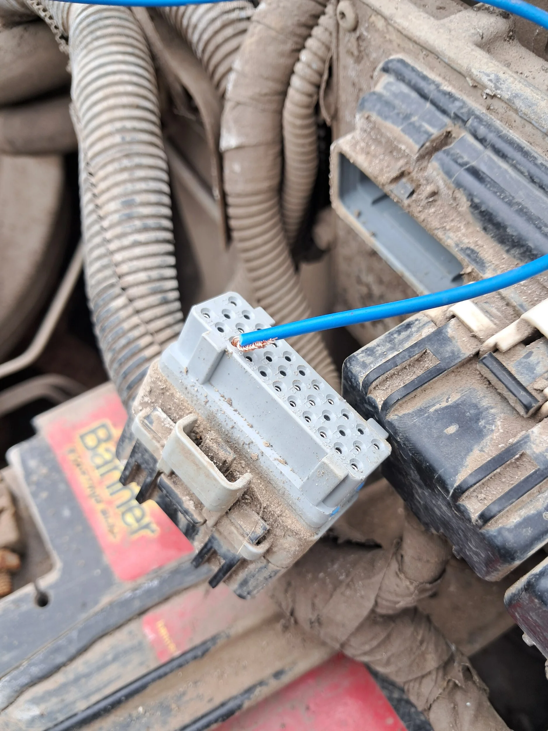

VSS wire B27 (white / orange) runs to EMC connector C2 (WHITE)
ECM C2 Pinout. Pin marked in red.
Cluster pinout

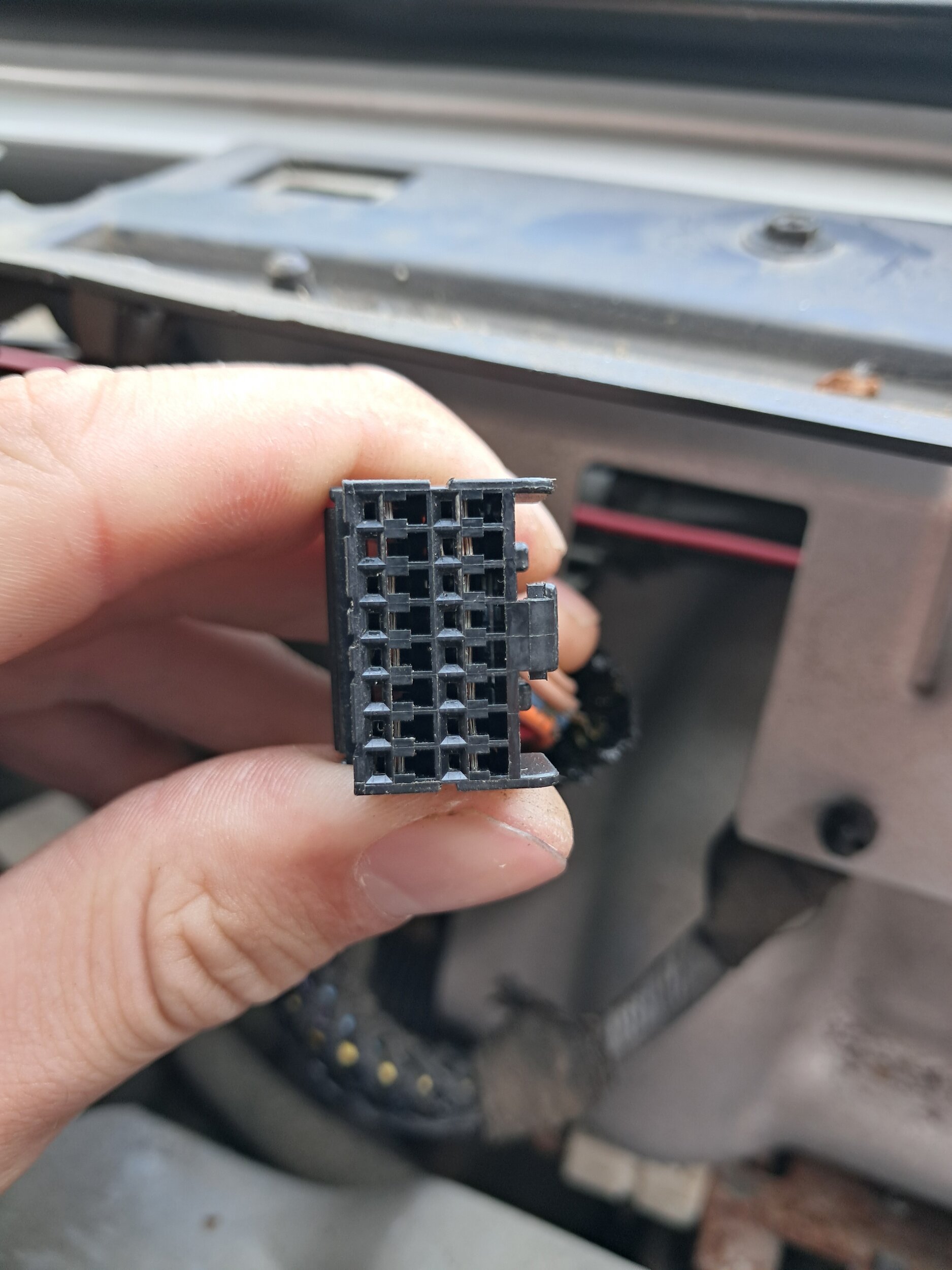

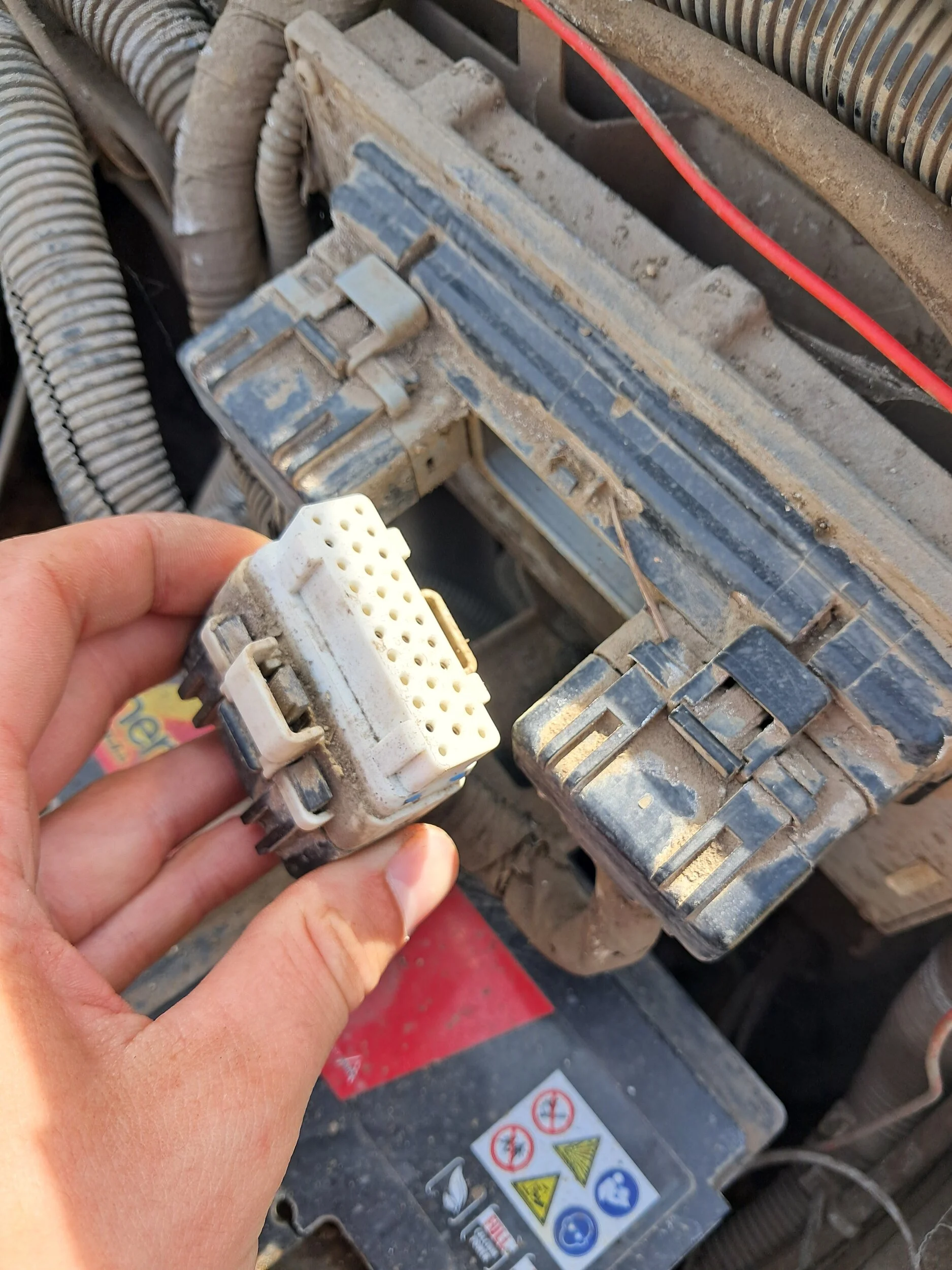

Ive located the plug, now how can i test the signal from the ECM to the cluster? Sorry if this question seems a bit obvious ( im not great with vehicle electrics).

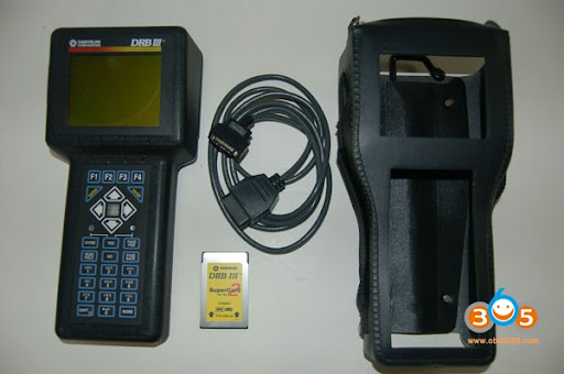

You would need to get your hands on a DBRIII scan tool or equivalent (HINT: they're $$$$$$$$$$$)

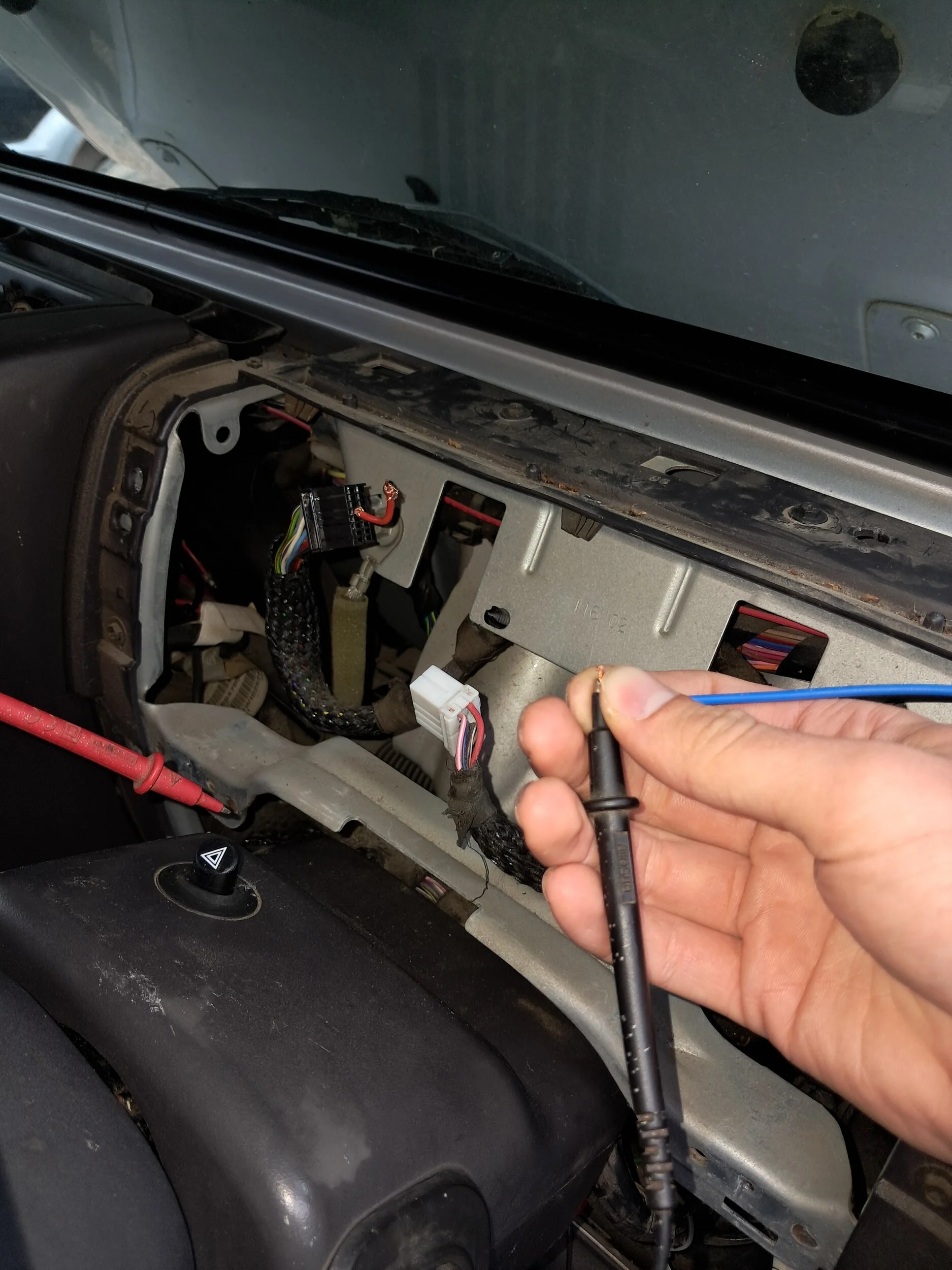

I have just tested the pci bus wire between the cluster connector C2 and c203 (the green dashboard one) and there is good continuity. Same between the obd2 port and c203. The wire between the white PCM connector pci pin and the cluster connector seems fine too.

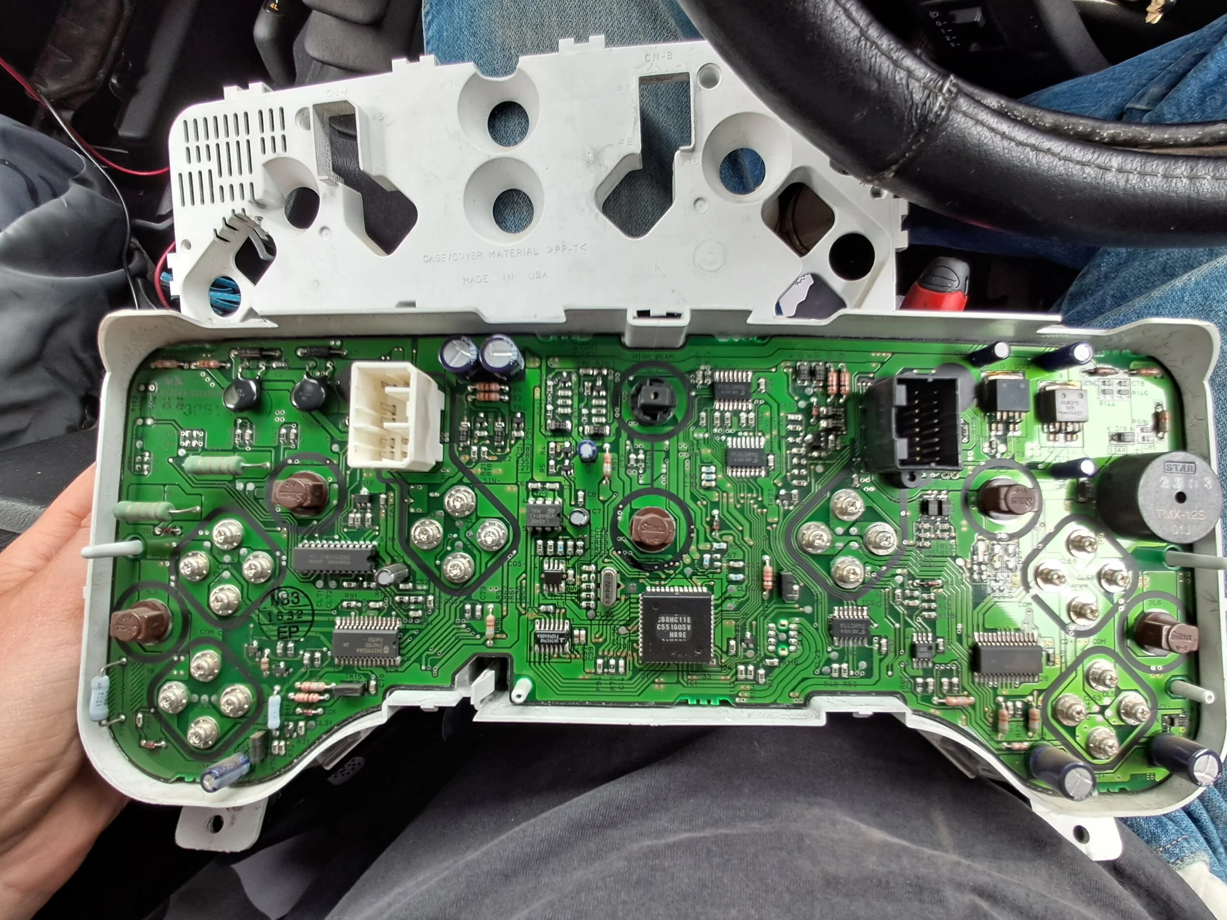

If your PCM sees the right speed, and the wires are intact...then it's got to be the cluster...have you checked the cluster to look for any damage... sometimes you can see damage to the circuit board.
I'm guessing the self test shows the motor working the needle but not necessarily verifying communication with the PCM.
-Mac

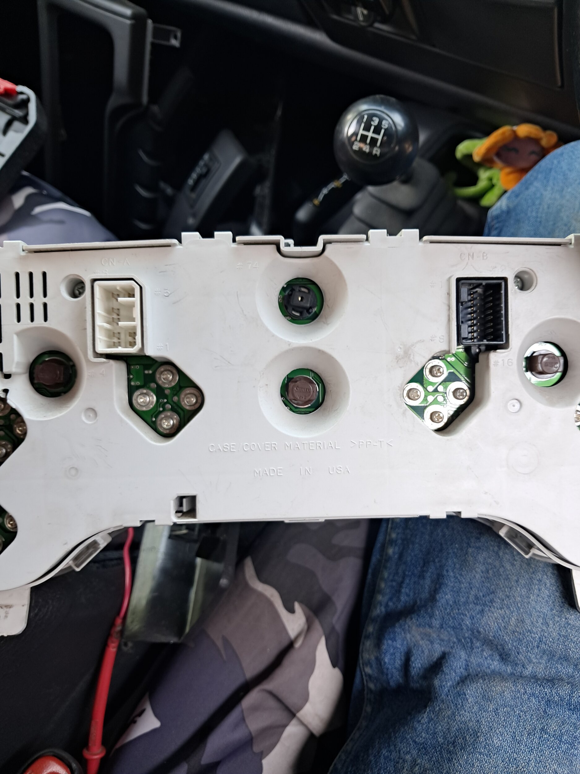

Nothing looks damaged in here though its hard to tell.

Thinking you need to send the cluster someplace for repair.
