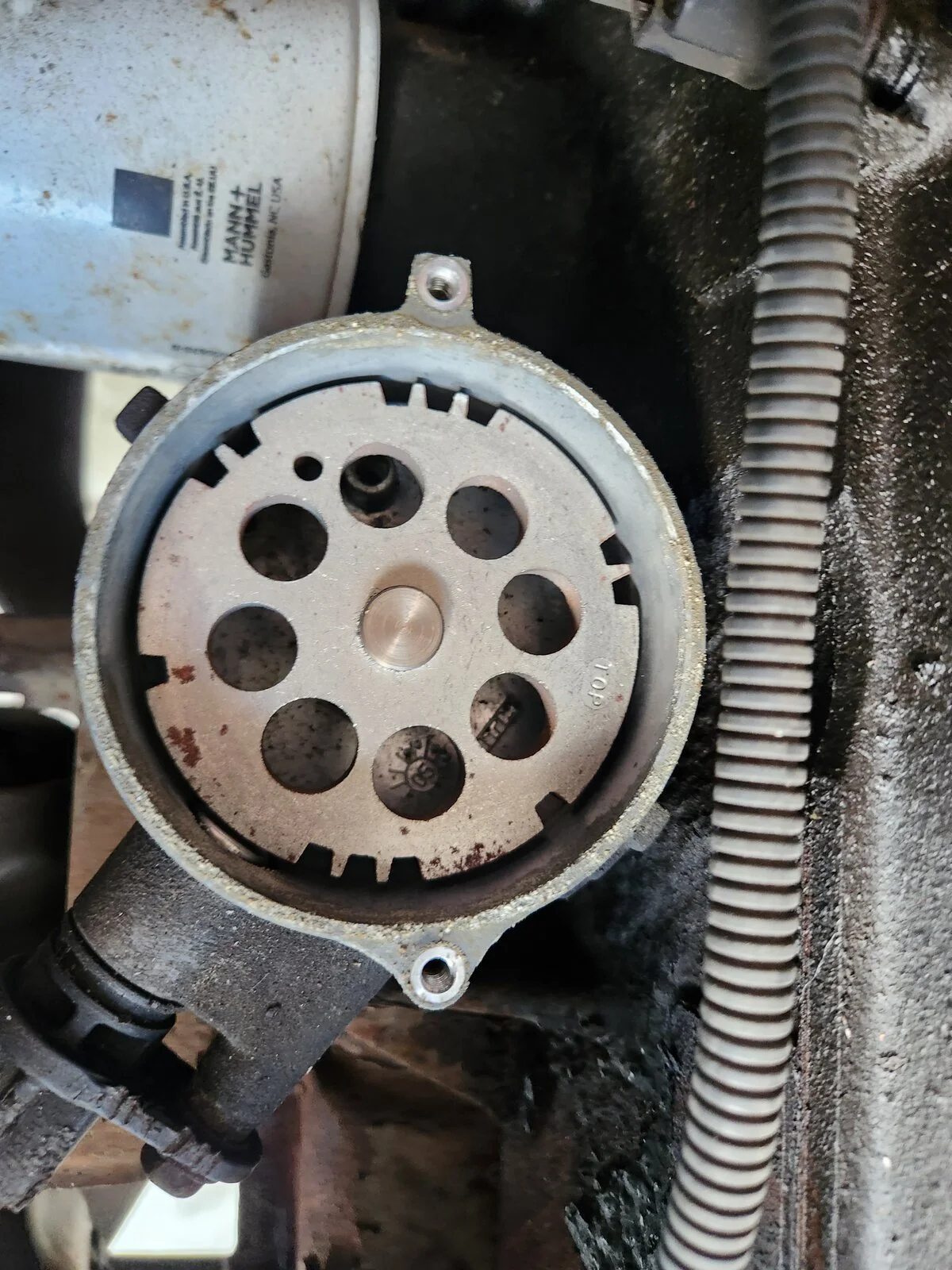

Pull the cover off the oil pump drive and check the alignment with #1 cylinder at TDC

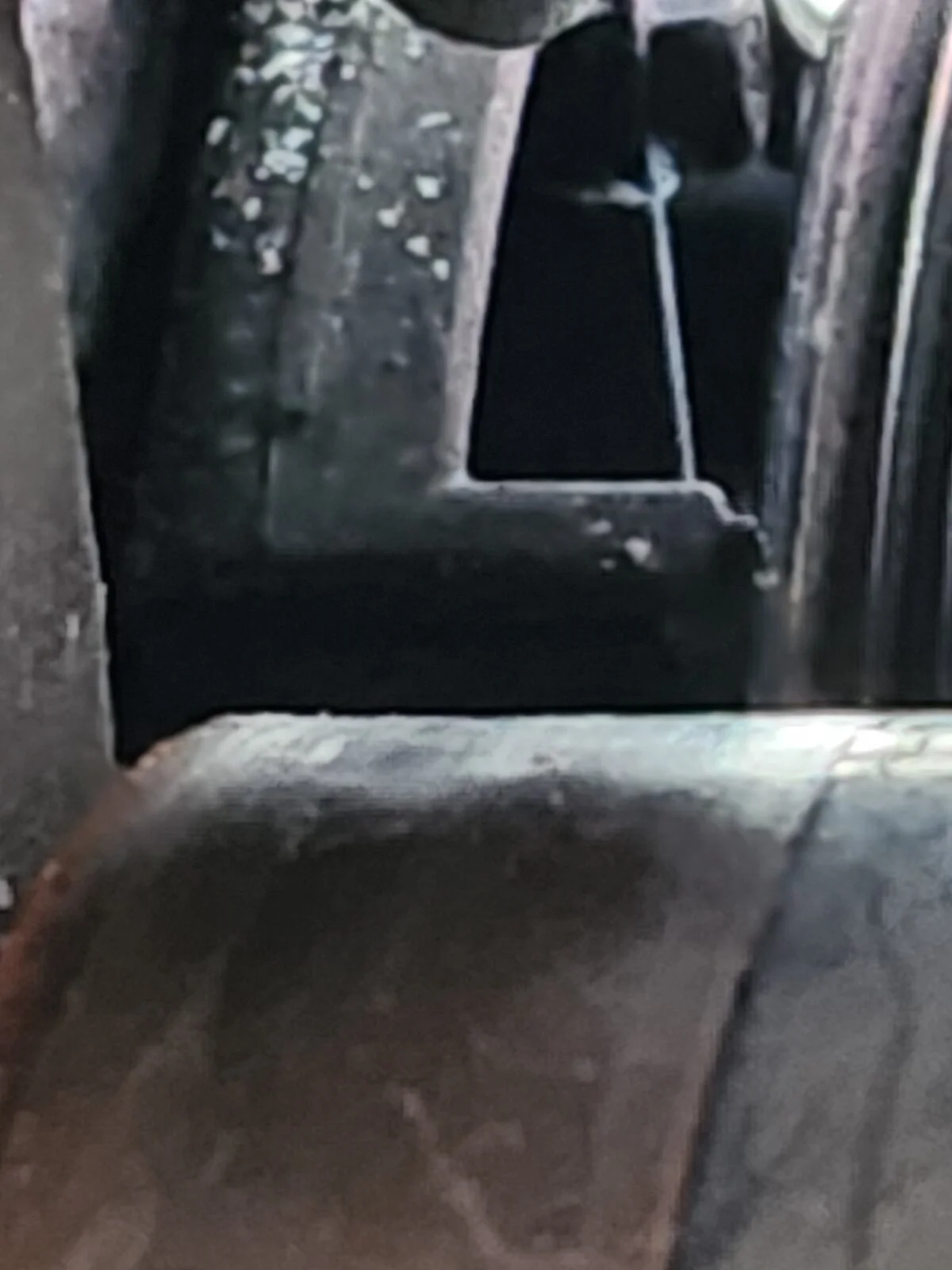

Does this look correct i was struggling to find a mark on the pully

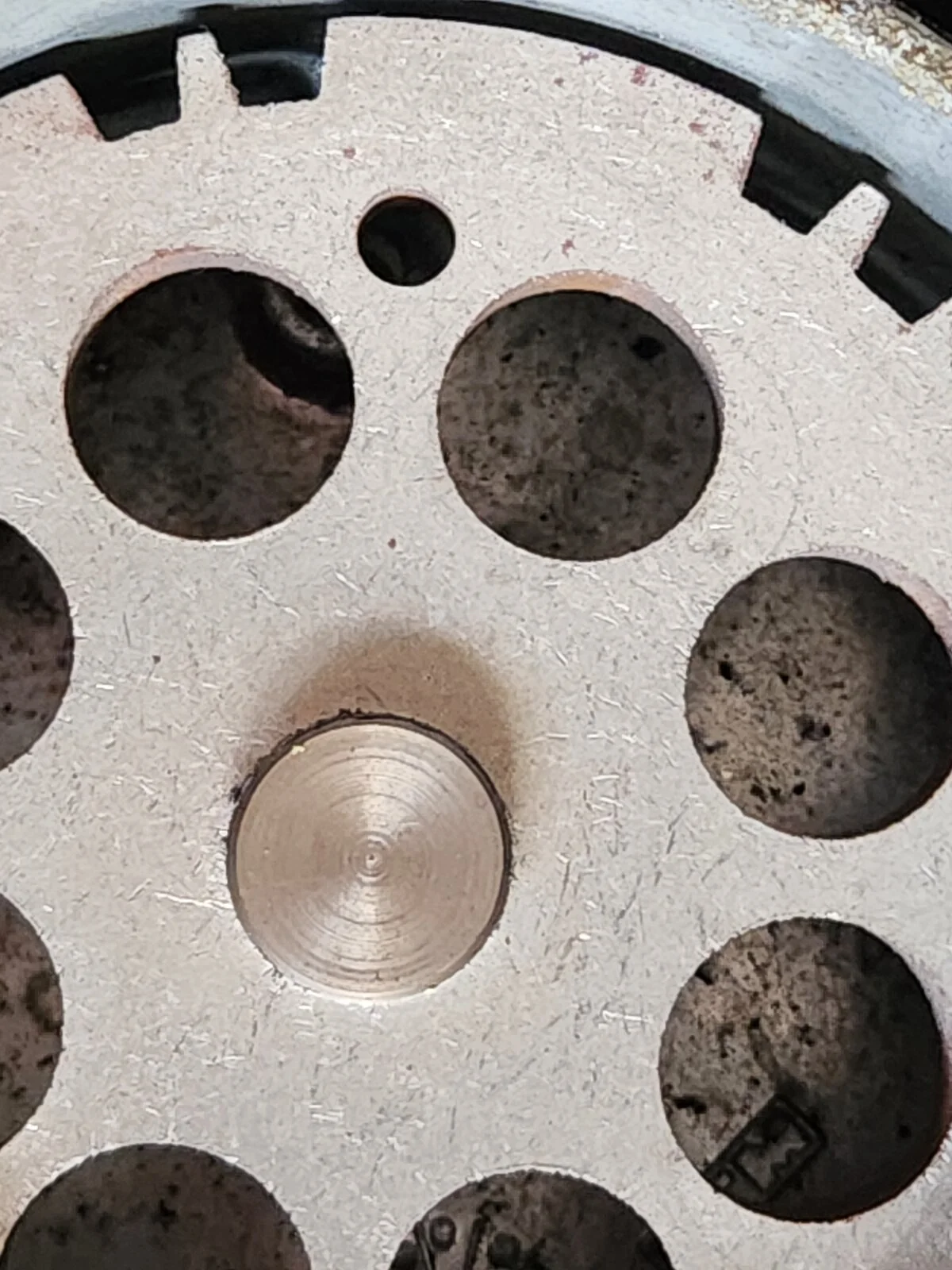

Are the alignment holes on the oil pump drive lined up?
That small hole located at 8 o’clock as you’re looking at it from the passenger side should line up with the one below it. If it doesn’t, you are either not at TDC or the timing is off.
It looks off
it looks off, if you are confident the timing marks on the harmonic balancer are aligned (TDC), you’ll need to adjust the oil pump drive to align those holes. Loosen the hold down and rotate it just like you would with a distributor. If you have a drill bit or something similar the same diameter as the alignment holes you can use it maintain alignment while you retighten the hold down bolt.
ill triple check my tdc and then adjust
