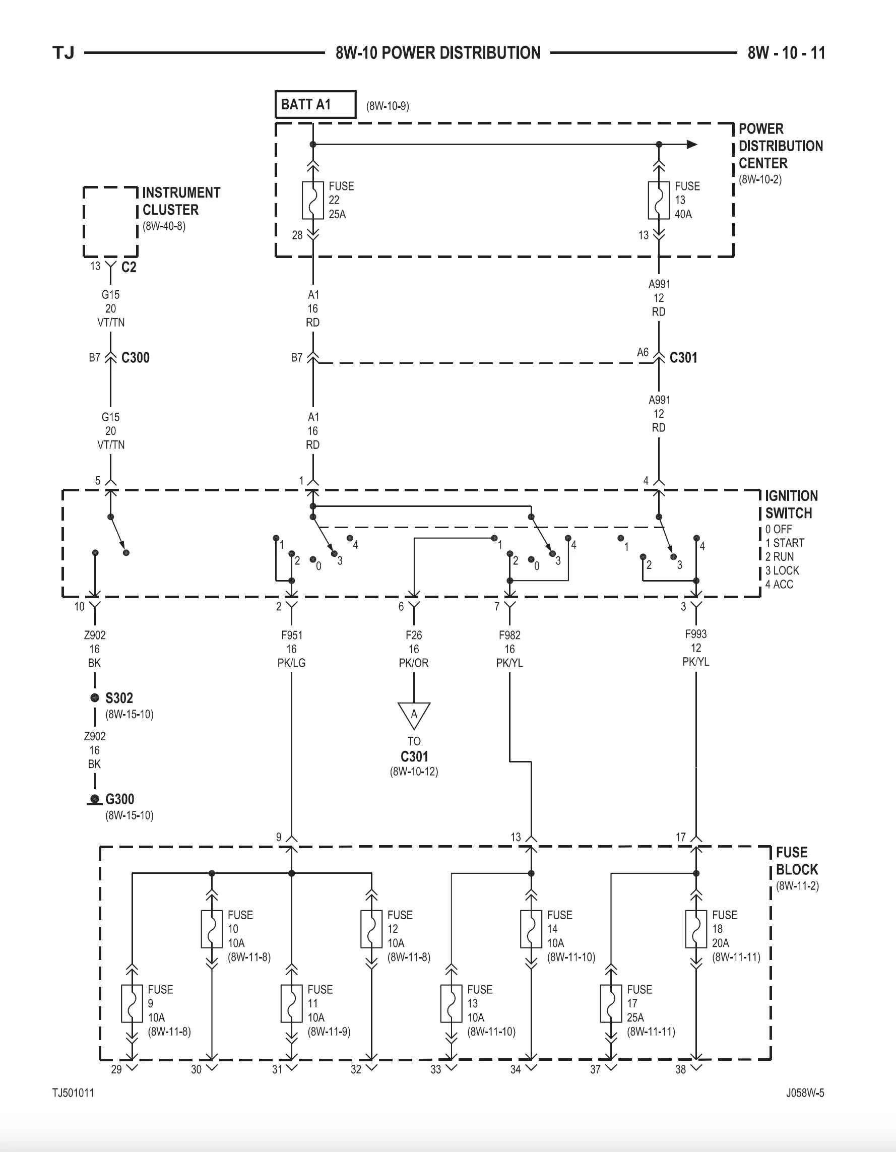

Hope this wiring schematic helps further troubleshooting.
Thanks for the diagram. If I'm reading the wiring diagram correctly, the PK/OR and PK/LG should have 12v in the start position. Am I correct?
Then I can test the ignition switch and know if that's the problem without buying a new one.
I feel like the ignition switch has to be the problem because the fuel pump and starter both work or both don't work. What else would control both the fuel pump and starter at the same time?
YES....
PK/YL, PK/OR and PK/LG are fed 12V thru them in the START position (1).

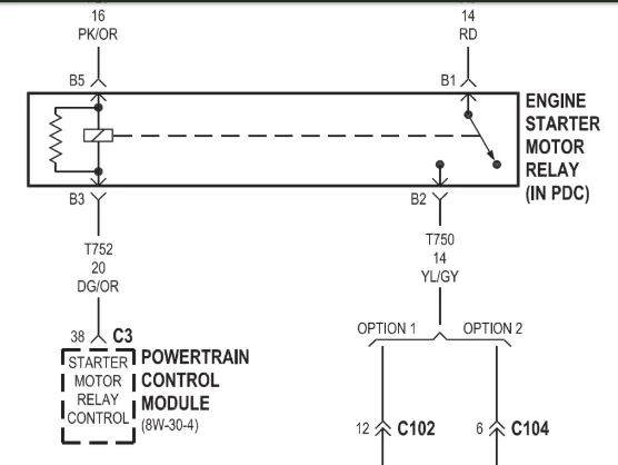

I tested the ignition switch, and it is fine. I tested the wire from the ignition switch to the starter relay and every time I turn the key to start, I also get 12v at the starter relay; so it is good. The problem is, the relay doesn't close every time. I bench tested the relay directly to the battery, and it works every time. So based on my logic, the other side of the coil is the problem. Looking at the wiring diagram, this wire goes to the PCM. How do I fix that?
I cleaned the main ground wire connection at the back of the engine compartment, and now it starts every 2-3 tries. For the past few years it has always started on the second try, so this makes me comfortable enough to drive it close to the house, but what is wrong?
Is it possible it is something other than the PCM? A rebuilt unit costs over $1,000, so I don't want to buy it if it won't fix the problem.
The strange thing is cleaning the body grounds fixed the problem for about a day and spraying the relay connections fixed the problem for a couple of tries as well. If the problem was the PCM, would those things have made a difference?
