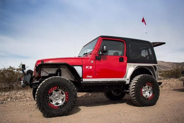

2005 TJ X
Yes, it's a hybrid build by my builder Larry Nickell of Vegas 4x4. Savvy Body Armor, Savvy Rub Rail, Savvy Rock Sliders, Metalcloak Overline Fenders, modified Rock Hard 4x4 Bumpers, and Trail Gear Creeper Bead Lock Wheels.
