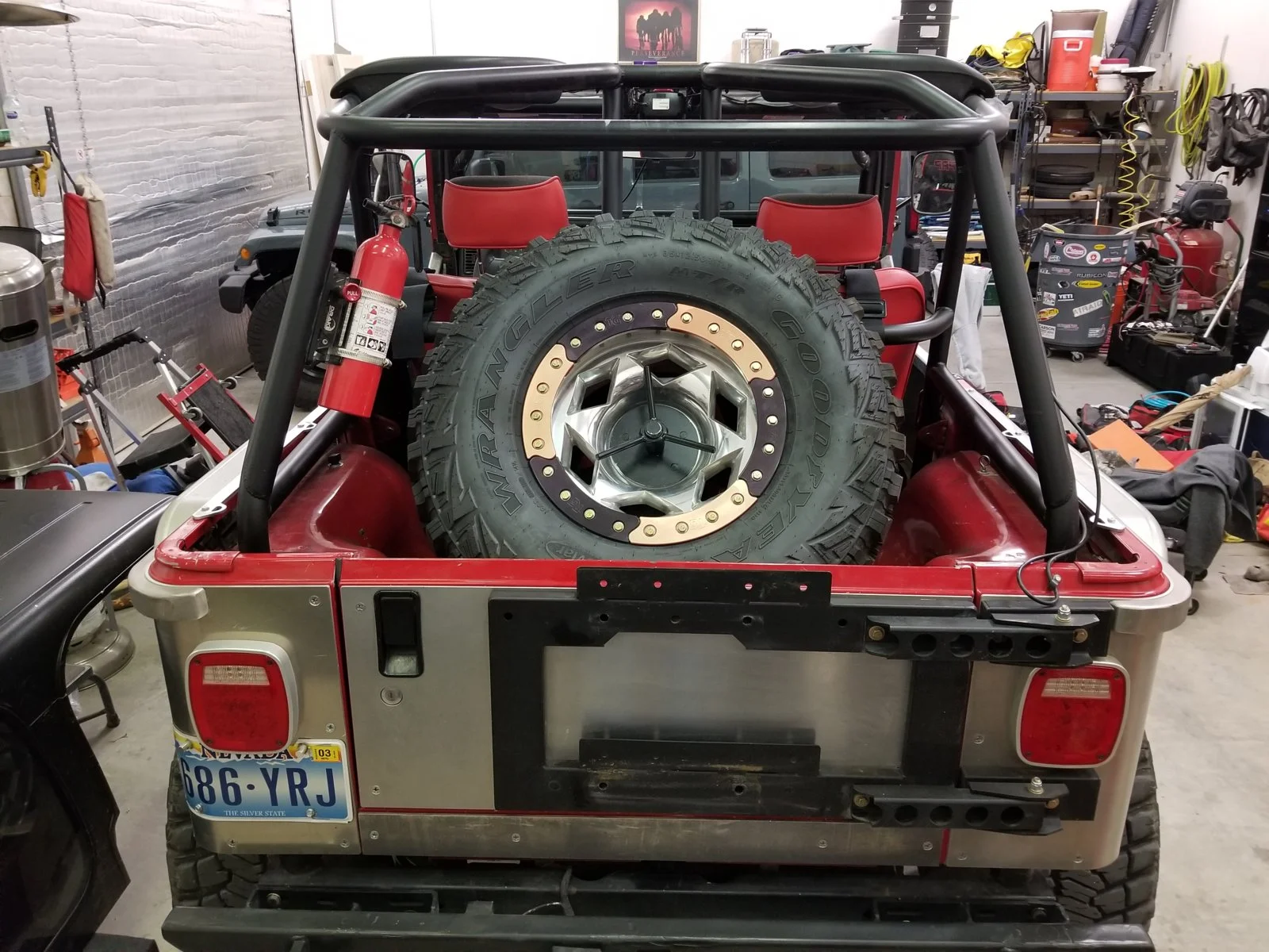

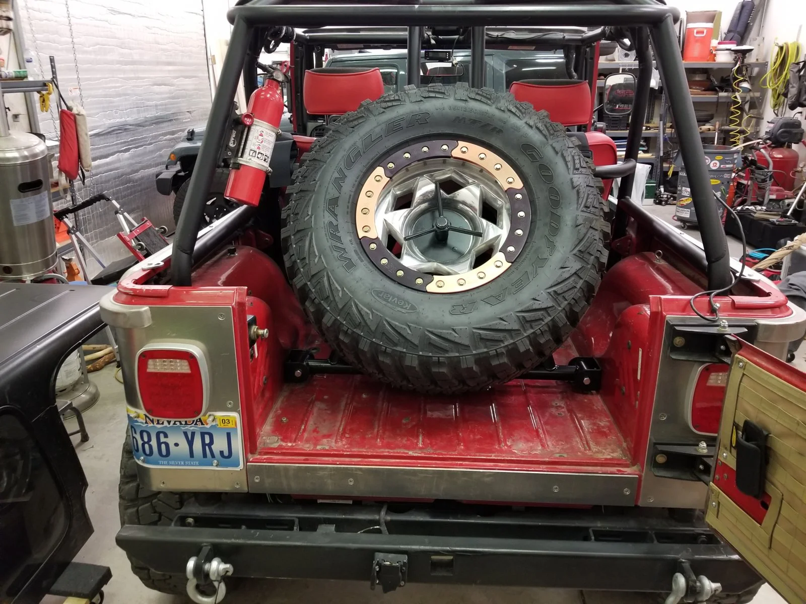

I'm not sure what they did but I just installed the later version that is seen in the build thread and it is twice the carrier the first versions were. Lot of folks had issues when they didn't get the tire hard against the snubbers with the gate closed and that tore up the carrier.

The design has been modified. Where they used 2" rectangular tubing they now use solid plate on the tailgate surround. The hinges are also different.

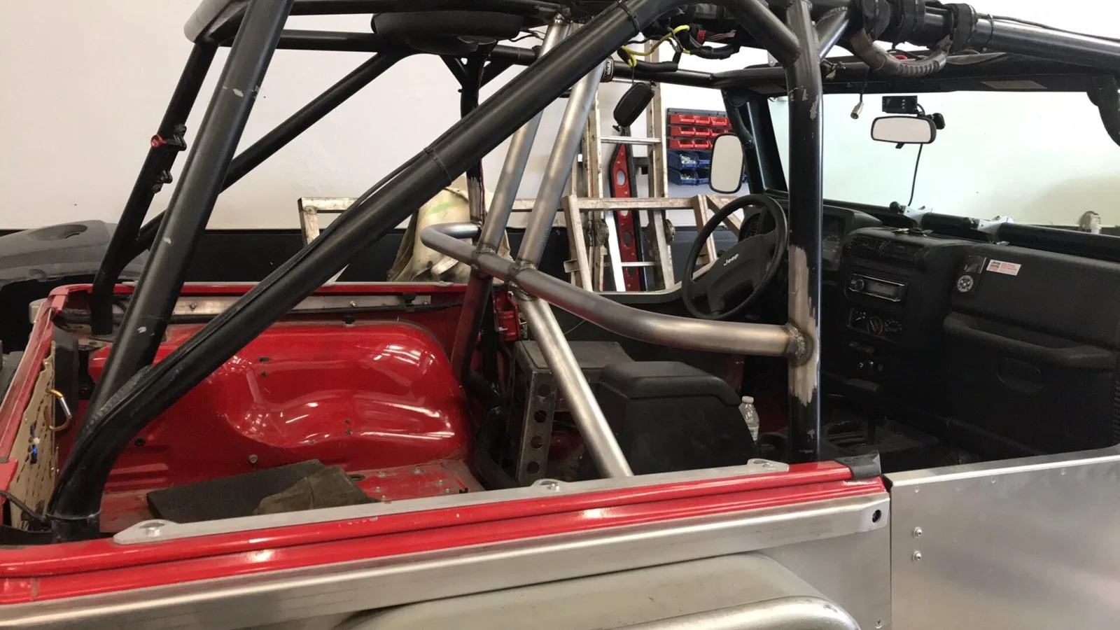

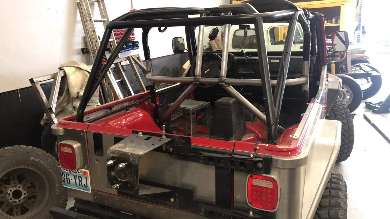

Getting some roll cage upgrades...
