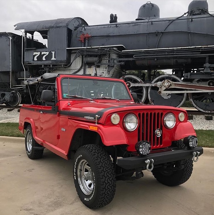

    That's awesome! It's crazy how popular these have become in the last few years. There are a lot of off-road shops that have been building their own take of what an off-road Jeepster should be. I believe off-road evolution did it first back in 2013 I think? Lots of awesom and creative ways to build them. If our rear fenders were to far gone than we would have probably done the same. But I'm not one to drill through good sheet metal. I had a hard time drilling through our LJ sheet metal but know I was putting factory Rubicon trim on it make me feel a little better about it lol.

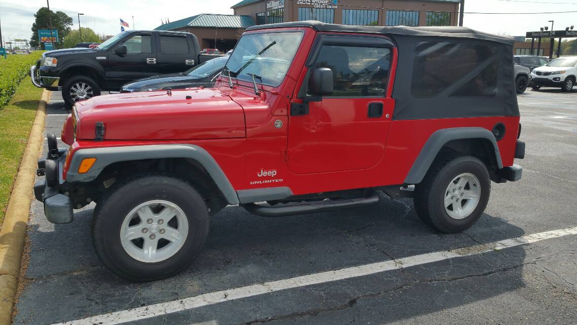

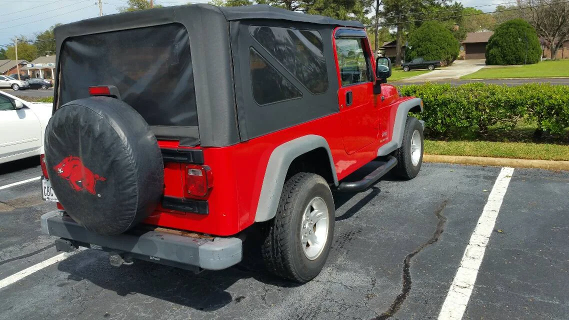

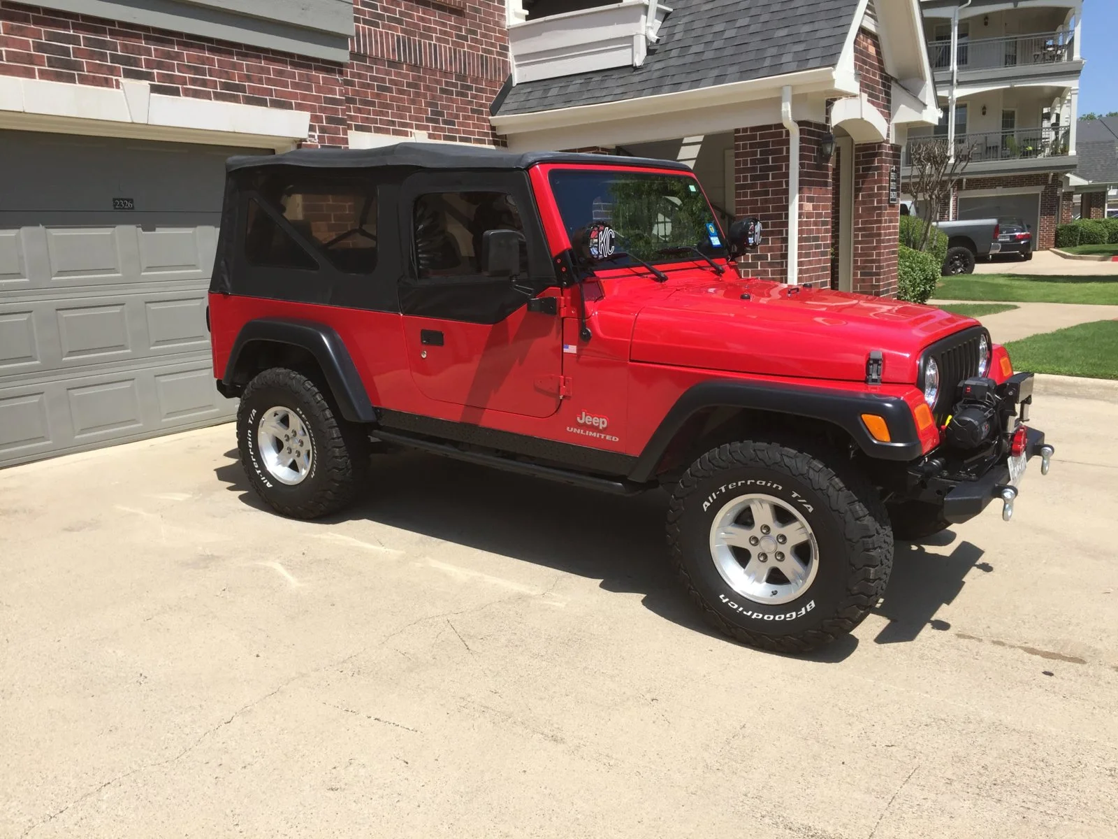

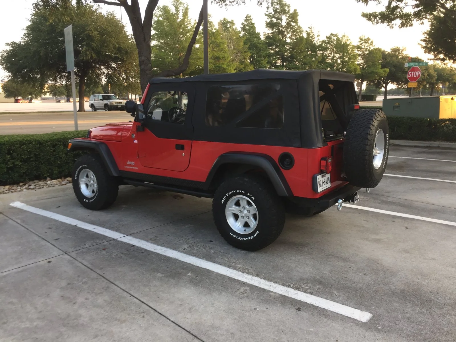

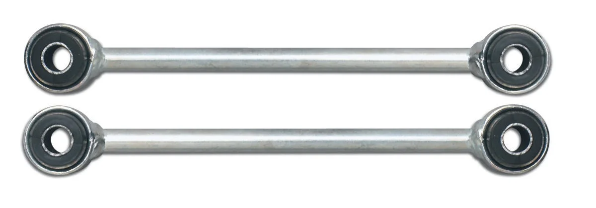

    Picked up a few items this last weekend. Wife is out of town this wekend so I will begin to install everything. Trying to get ready for my Hot Springs trip on the 21st and 22nd of this month.
    1. New Crown automotive rear track bar (I think my bushings are shot. Only $60).
    2. Rubicon Express extended sway rear sway bar links
    3. Teraflex rear trackbar relocation bracket for two inches and above lifts.
    4.Used factory LJ soft top with tinted windows. Came with all hardware, door surrounds, etc for $100.
    The plan this weekend for trip prep is to tighten up the e-brake, re do the track bar, install the relocation kit, install the extended links in the rear, get a new rear zipper for the soft top window resown into the top, buffout the windows, remove rear seat, and start planning what to pack. I can't decide if I should bring the tent or if I should just sleep in the Jeep (would only be for one night lol).
    Waiting on some of the parts to come in so I'll update photos as soon as they come in but for now here are some pictures of the top. This will be for trail use so we don't tear up our trek top. Plus I love how the LJ OEM tops look with half doors. Idk why but it looks very military to me. Also enjoy the pic of the earthroamer. Guy was at our local 4WP picking up a few things. So sweet.. maybe one day lol. IMG_5610.JPG IMG_5612.JPG IMG_5618.JPG

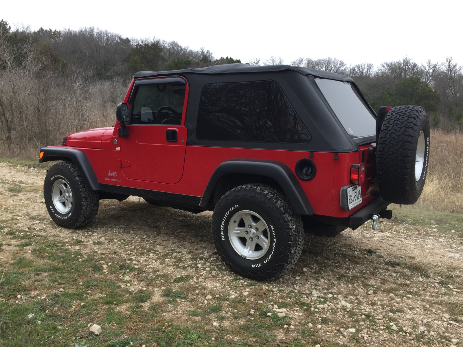

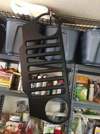

    IMG_5582.JPG IMG_5587.JPG I almost forgot! I'm not completely sold on it yet but we picked up a new black grill cover. One of the previous owners towed the jeep behind a motorhome so there are a few rock chips in the grill. Not only will this hide the previous rock chips this should hopefully protect it from new ones. I would much rather prefer the chrome grill overlay though. They are just so expensive and not easy to find new is all. This one only set us back $50.

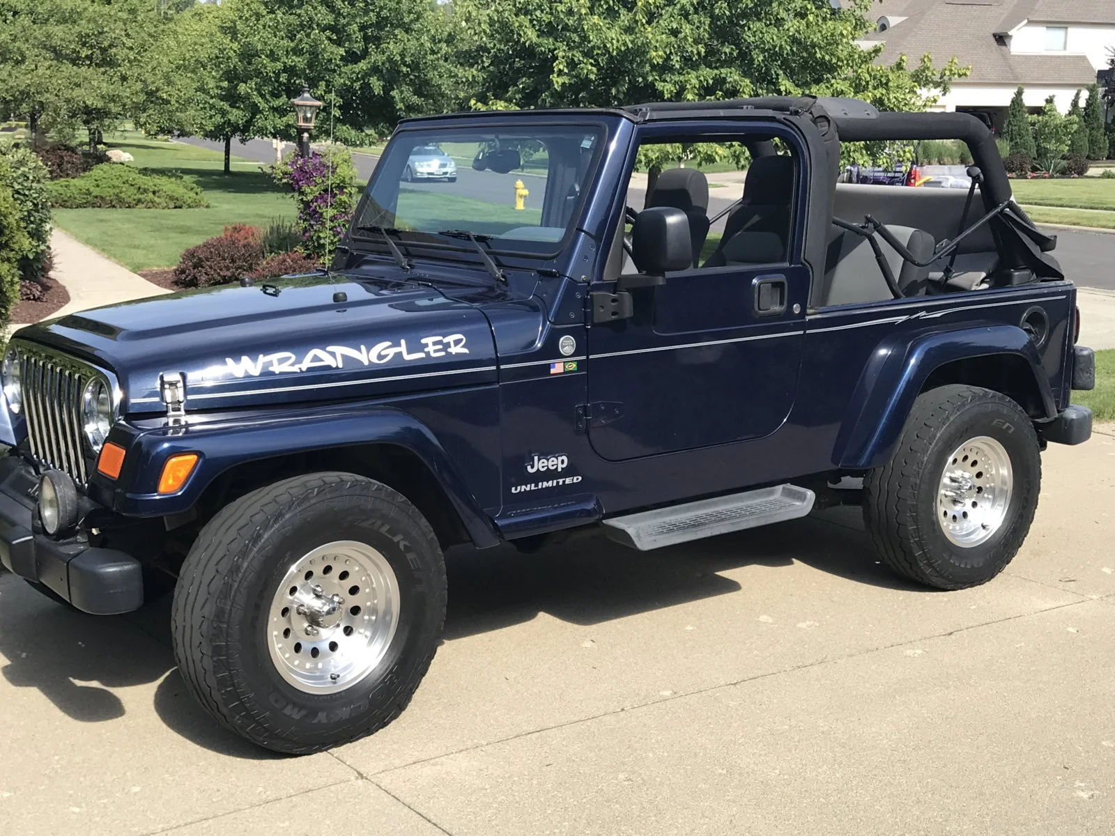

    Thanks for your posts Jeepersteve.
    I just purchased my own LJ last week (1st time Jeep owner) trying figure out what I want to do with mine. As I'm evaluating my next move , your details have been extremely insightful. Really like the look.
    I doubt I will off road much and no rock crawling but I hope to get it off road a few times a year. Who k owe. Once I take it off the road, may not want to get back on the road.
    Thanks again and keep the details coming and pics too.

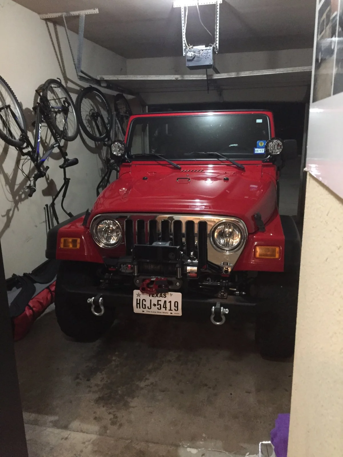

    IMG_5633.JPG Well today ended on a high note. I jumped on craigslist yesterday and saw a fresh post with a factory Mopar chrome grill for sale in like new condition. Asked if he would like to trade for my black plastic one that I just picked up and pay half of his asking price for it and he accepted! I'm so glad to get rid of that crappy black plastic grill because it did not fit right and only stuck on with 3M tape. The Mopar chrome is so much nicer because not only is it metal but it also fastens with factory plastic fasteners. You have to remove the headlight trim to install it and then install the headlight trim back over it for a nice secure installation. Very happy with the results!

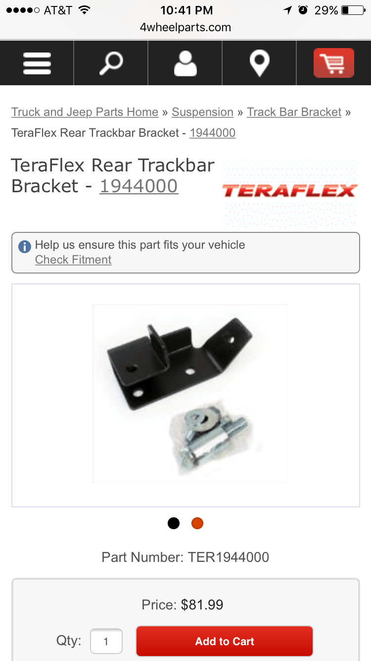

    Worked on the Jeep all weekend long while the wife was out of town! Finally ready for the big road trip to Hot springs this week. I installed the Teraflex rear track bar relocation bracket. I highly reccomend that this is a priority when lifting your Jeep. What a difference! No more fish tailing. My only regret is not putting this on when I did the lift kit. The bracket came a little warped (maybe due to the powder coating process?) so I had to break out the torch and rubber mallet to make it fit just right. This would have been 50 times easier to install if I had the springs and shocks out. So do this when lifting the Jeep. Take it from me and don't do what I did. Pay someone to install it instead if your Jeep is already lifted lol. Other than that I installed some Rubicon Express extended sway bar links in the rear. I failed to get photos of these on my jeep probably due to the amount of frustration I had in that relocation bracket but here is basically what I installed. Pics soon to come of my Hot springs trip!

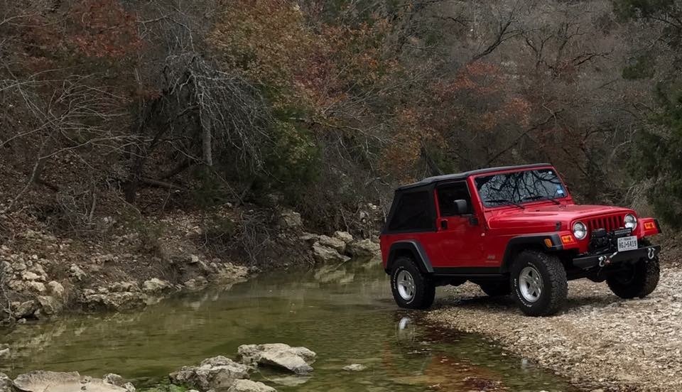

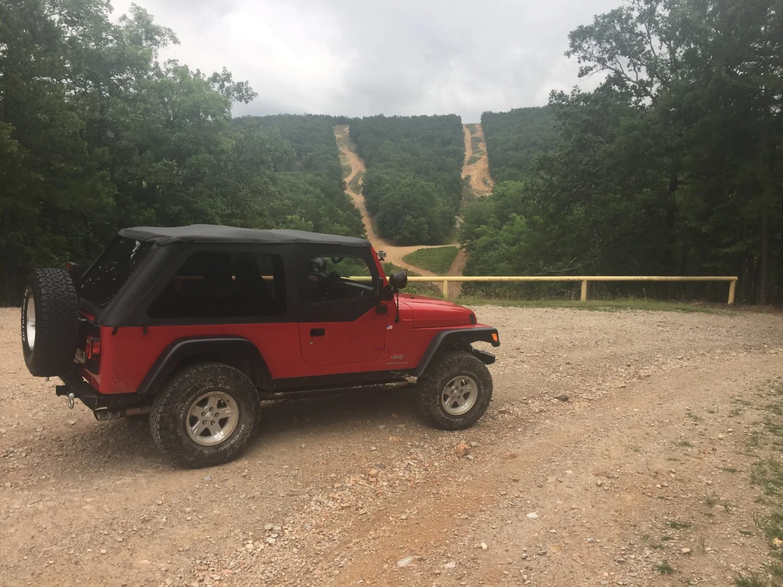

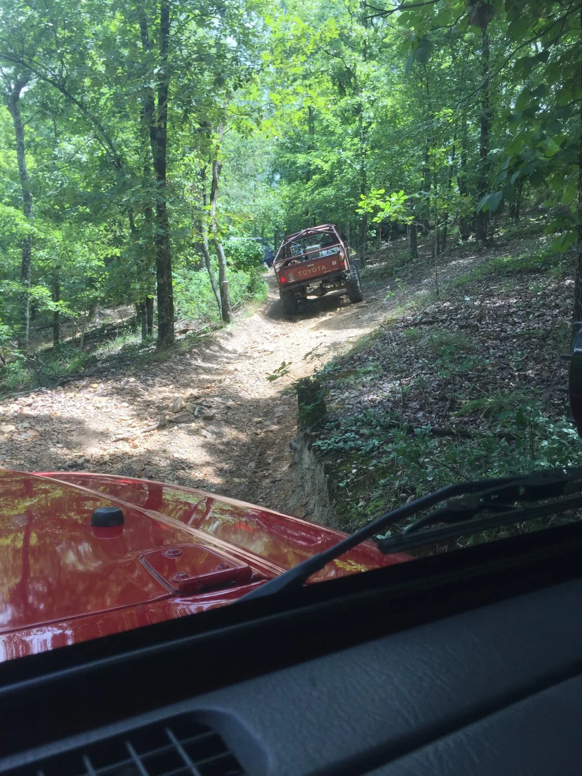

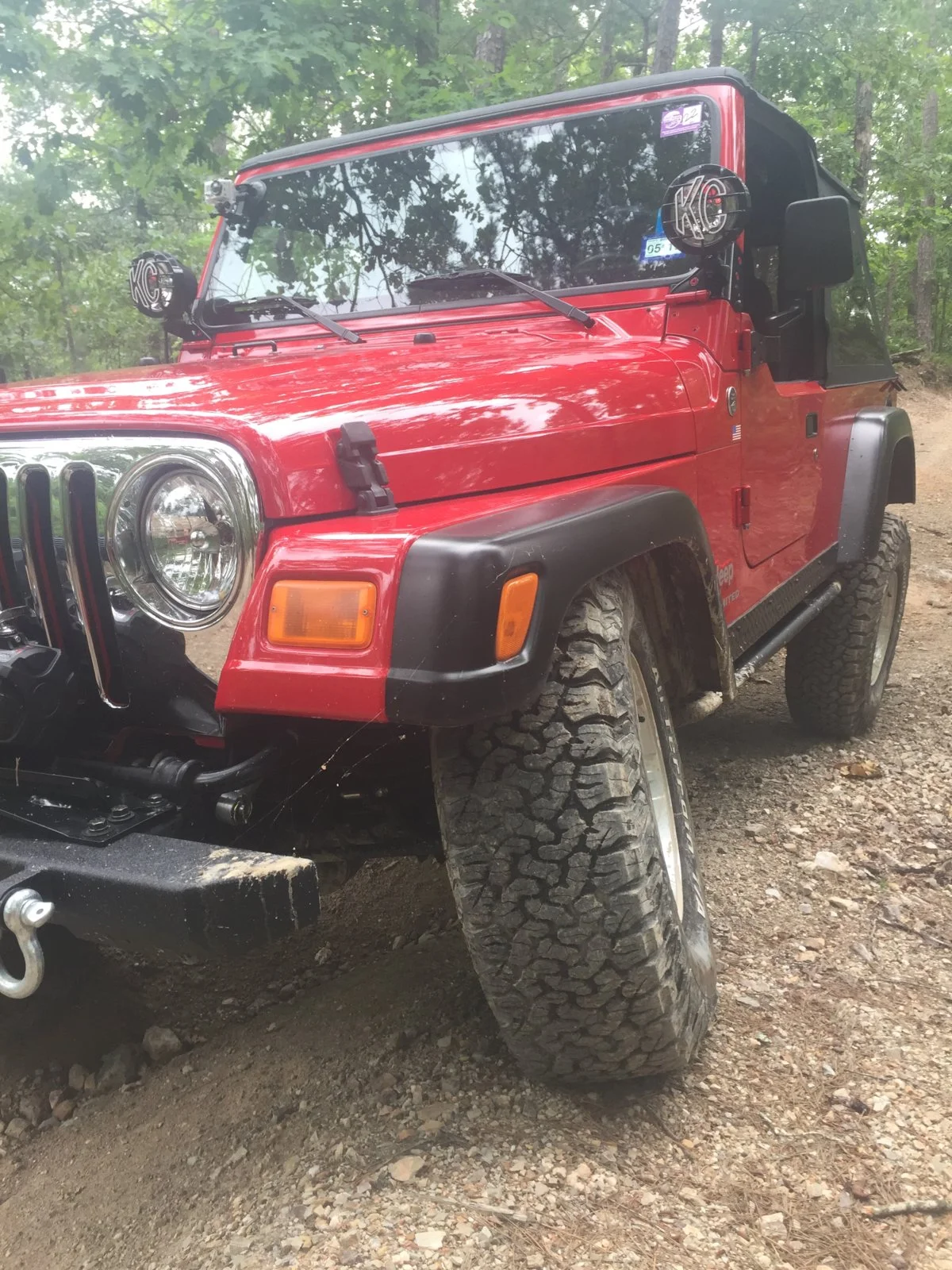

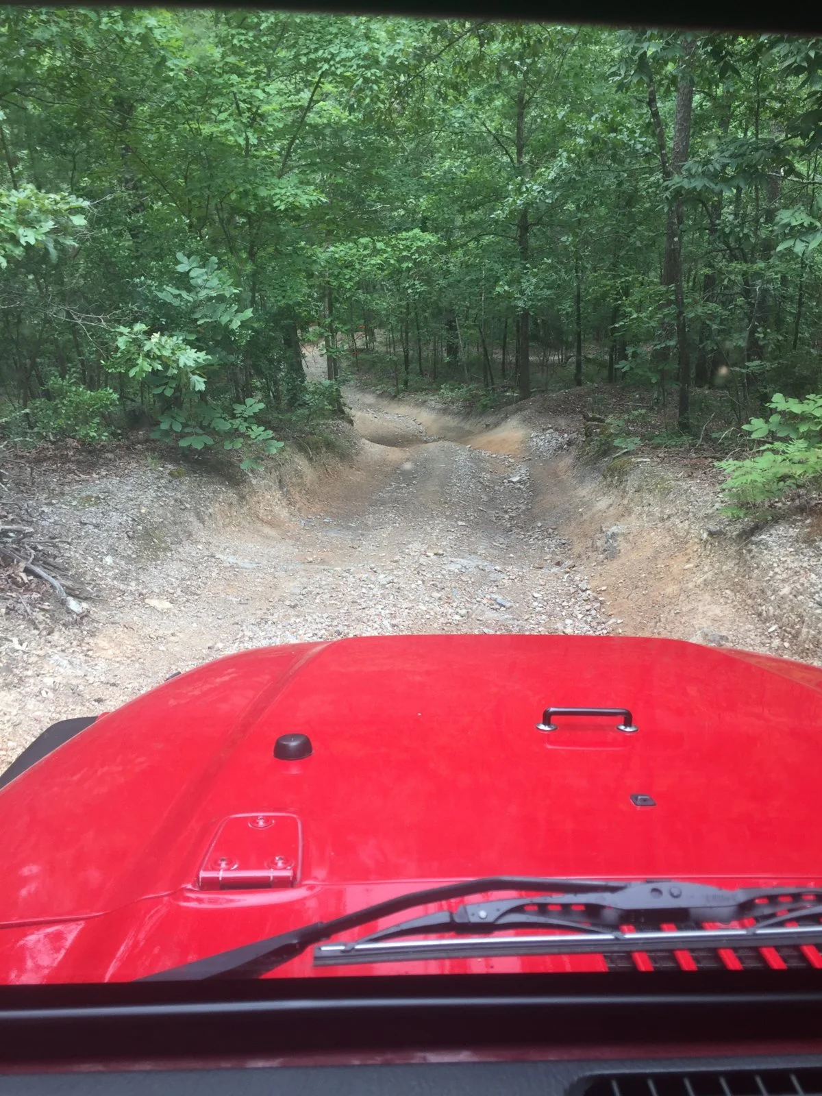

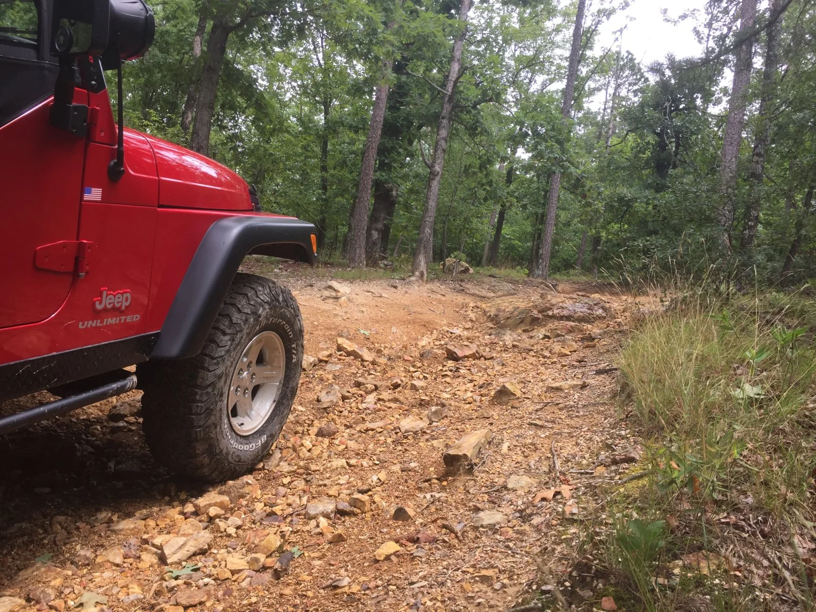

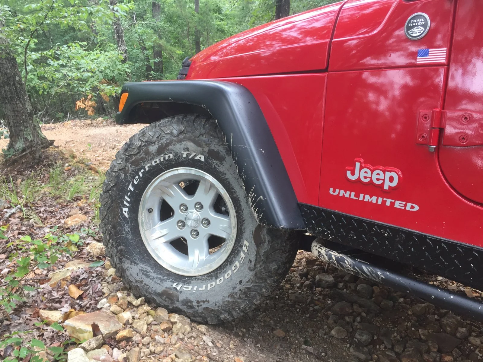

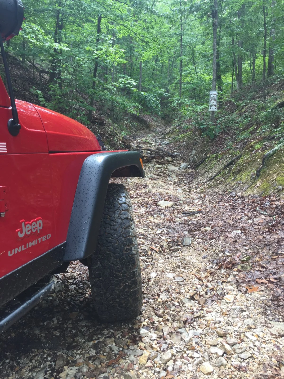

    Just got back from my trip. Had a great time! Nothing broken and made it back safely. I don't have the videos edited or uploaded yet but when I do I'll be sure to post them. Here are some photos for now. I let this group pass me (YJ on 40's and one tons, two white two door JK's, two TJ's and an 83 Toyota pickup) thinking I was going to hold them up. One of their TJ's ended up puncturing a side wall. After that was fixed the motor wouldn't start (pretty sure it was the crank sensor). They ended up holding me up lol. They towed it back to the parking lot,ran to autozone/o'Reilly's for the new sensor, put a new sensor in, and wheeled for the rest of the weekend. It rained on me most of the day I was there so it made things really slick. I managed to get through everything with no damage. I think I hit the transmission/transfer case skid a few times but that's what it's for after all lol. Can't wait to get the SYE installed and get a new skid to fix that problem.
    I did two badge of honor trails called Snake and the Fun Run. The 3rd badge of honor trail is called Rubicon Ridge. The park manager said I might want to pass that one up since I was by myself and it was really slick that day. I'd say I'm glad I took his advice lol. Mostly stuck with level 2 and some level 3 trails that day. Was looking to get out and have a good time and not do anything to extreme since I had to get back to Dallas (5-6 hour drive) on Sunday. Photos aren't the best due to the lighting. Took them all on my iPhone 6. Should have some really nice video. As usual pictures do not do these inclines justice! IMG_5699.JPG IMG_5701.JPG IMG_5702.JPG IMG_5704.JPG IMG_5707.JPG IMG_5710.JPG IMG_5714.JPG IMG_5717.JPG IMG_5718.JPG IMG_5722.JPG IMG_5727.JPG IMG_5729.JPG IMG_5730.JPG IMG_5731.JPG IMG_5732.JPG IMG_5733.JPG IMG_5734.JPG IMG_5735.JPG IMG_5736.JPG
