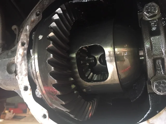

One editorial comment, given my experience with these axles I do believe they are overbuilt for my purposes, I don’t think I’ve approached the limit of abuse they can handle. It’s a moot point however because I believe they’re still necessary given that the only step down would’ve been to leave them stock & open which simply wouldn’t have served my purposes – I have unequivocally needed my lockers too many times to have been able to go where I’ve gone & had the fun I’ve had without them, and while I can’t say for sure I probably would’ve broken at least one stock shaft by now doing some of the things I’ve done, particularly in my first year when I was much less experienced behind the wheel.
Gears look as good as the day they were installed:
