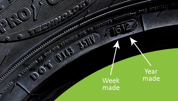

Sadly, most of us just buy a car or tires without checking the dates to confirm the age, it's of particular importance when buying second hand tires, in addition, I would only be using second hand if I lived on a rural property and wasn't intending on infecting my shortcomings on fellow road users so here's how you find when your tires were manufactured: whos running to the garage right now?
"The first two digits are the week of manufacture, and the last two digits are the year. For example, if the last four digits of the DOT code are 0203, that means that the tire was manufactured during the second week of the year 2003."
