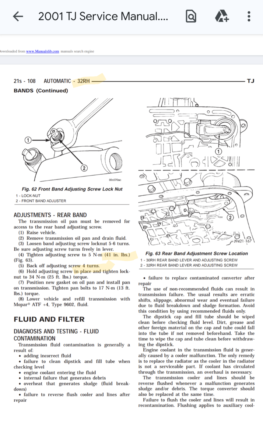

2001 TJ 4.0 32RH auto trans:

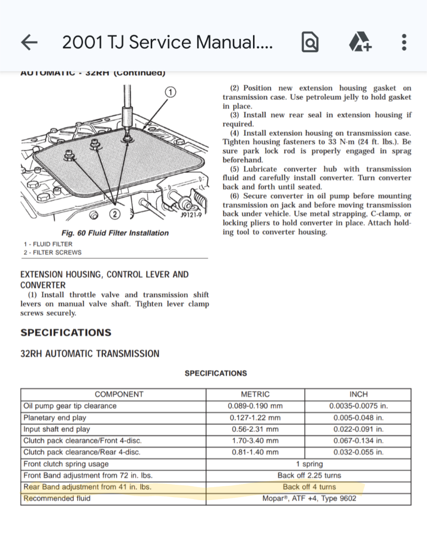

I'm about to drop the trans pan for a fluid flush. I want to check rear band while in there (jeep is 200k miles). However, there is a discrepancy between various guidance and service manuals specific to the 32RH rear band torque number. In the 2001 and 2002 FSM, the value is 41in-lb minus 4 turns. In the 99 and 2000 FSM, it is 72in-lb minus 4 turns. In the 30/32RH trans manual it is also 72in-lb minus 4 turns.
I am NOT mistaking the 30rh with the 32RH numbers. I read through all the FSMs from this site. This is a clear change in guidance that happened at the publishing of the 2001FSM. This also corresponds to the change in guidance from ATF+3 to ATF+4. Could this be part of the change?
I don't want to damage anything or need to drop this pan again later. Does anyone know what's up?
