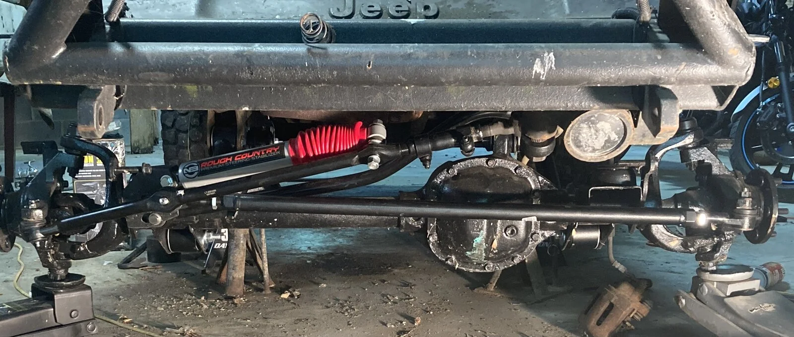

I am rebuilding front end of my tj where it was wrecked. I am installing a used Dana 30 with all new steering / tie rod components. I have everything on except my coils and shocks but my tie rod adjustment bar is not level, it goes up hill on the passenger side where it connects to drag link. Is there a way to correct this, or did I do something wrong?
Thanks
Normal. You may be thinking of crossover steering where the tie rod is level because it connects one knuckle to the other. TJ Haltenberger steering is an inverted Y and the angles change as the axle flexes or moves up and down.
