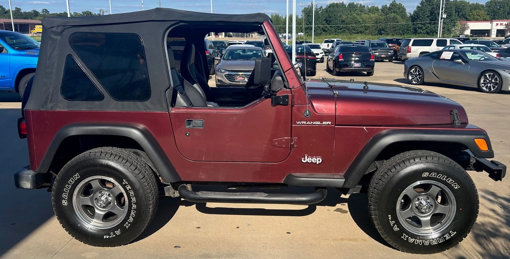

No one cares about the Wee Beastie. It is arguably the worst...no...THE worst example of the TJ to roll out of the factory. Who in their right mind would do anything other than sell a 2.5L 4 cylinder, 3 speed automatic TJ? I've built half a dozen rigs in the last 30 years starting with a '79 CJ7, 4 speed manual with a built 360 V8, a couple of lifted Cherokees, a couple of old Land Cruisers, a couple of JKU's on 35's, to a Gladiator with a 5" Clayton, 5.13 gears and 37s. Why would I even consider it?
Through unexpected circumstances, some expected ones, and sprinkled with a few incurable diseases, all our Jeeps and motorcycles went away this year. This baby TJ sort of landed in my lap like an unplanned pregnancy with only 82k original miles and in very good condition. I had a choice to make: build it or sell it? I pondered this question as I staired at my empty garage and my mind drifted back to my first vehicle: a '83 Toyota 4x4 mini truck with 87hp of fury. I had so much fun in that truck and not a week goes by I wish I didn't still have it.
I took the beastie for a spin with the mind set that it would be slow, but for heaven's sake, what a turd. The little guy couldn't even hold 65 mph, but was equipped with 31" tires and after inspection, 3.73 gears. After a speedo check, at least it was 5-6 mph slow at 60mph, so it would actually hold 65mph. It hadn't run much in a long time so I changed the oil and added some Lucas treatment, changed the nasty air filter, and put a fresh tank of fuel with the Lucas additive in it. I yanked the top, doors, and back seat to lighten it up and burn the first tank of fuel around town. On a weekend, I filled up the tank and took an 80 mile drive. The Beastie could run 70 mph given time and could maintain 65mph...sort of. But, it drove great, tracked well, and had obviously been well cared for in the past, and it was ALL STOCK except for the bling wheels and tires.
Challenge accepted.
I spent the next weekend going through the little guy, checking all wires, connections, fuses, cap, rotor, brakes, hoses, belt...all that stuff. This is one nice little Jeep. I mean, the previous owner had even changed out ALL the fluid reservoirs, hoses, injectors, sensors, wires, plugs, and a new aluminum radiator. I also discovered it was ready to flat tow with the proper diodes, wiring, brackets and brake away cable. The seats, carpet and top looked almost brand new. What a find, sort of....

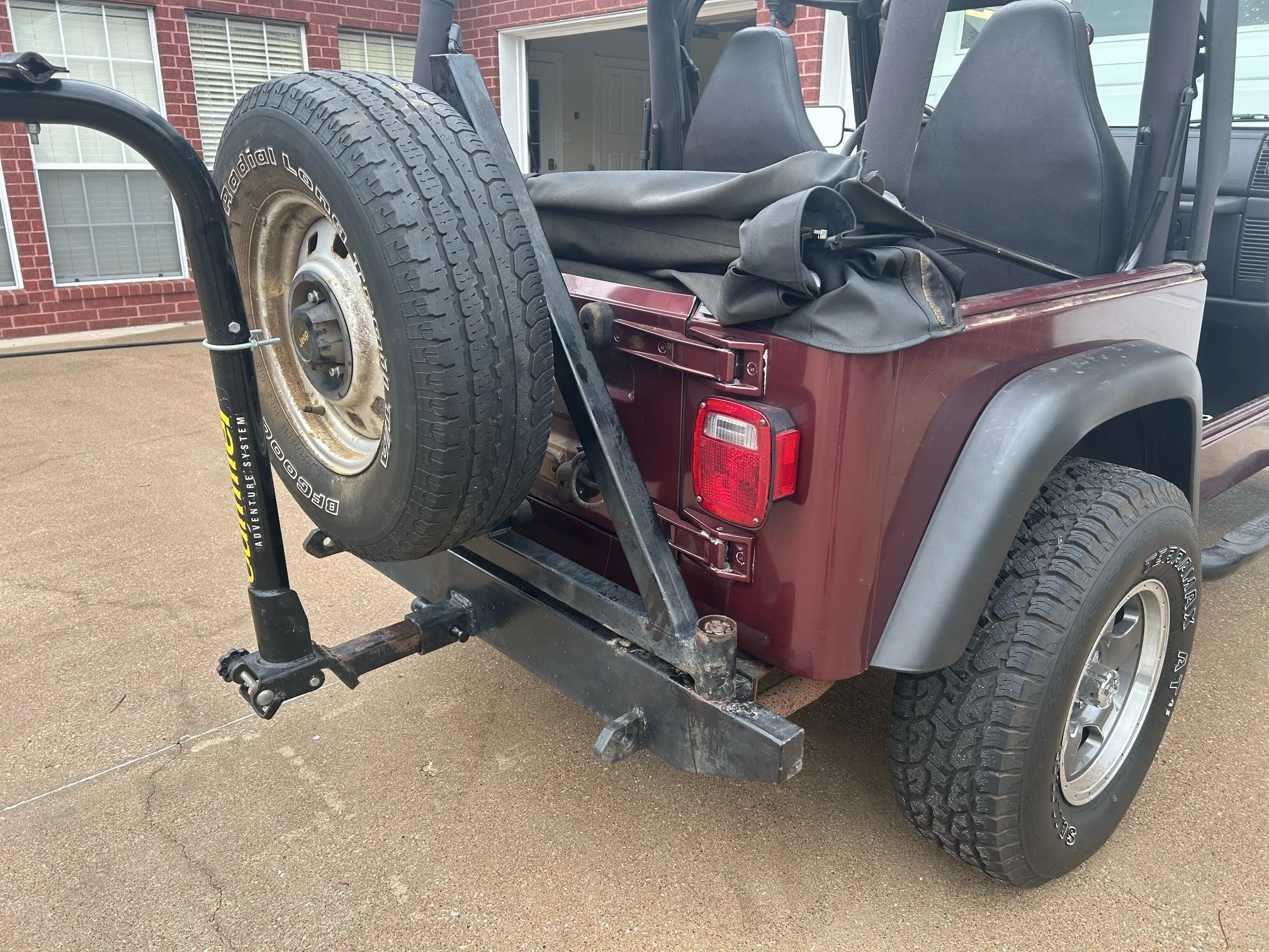

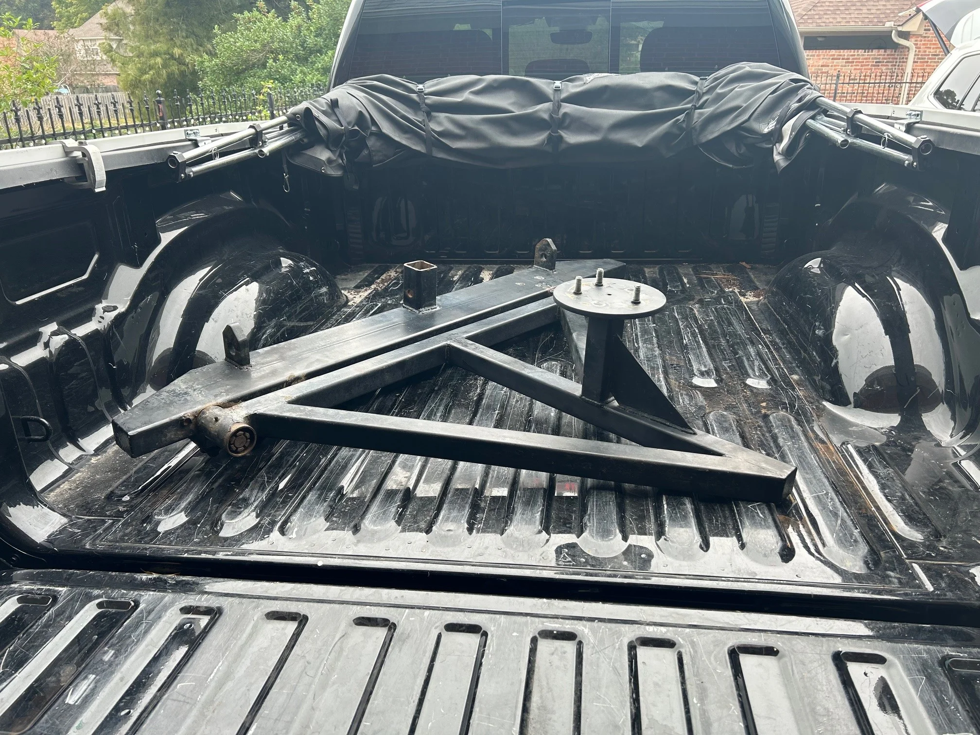

I sniffed around for used parts and by luck or by fate, happened on a rear bumper with tire carrier a Jeeper wanted to sell, or trade for the stock components. After some pics and exchanges, we agreed so I made the 2 hour trip to make the trade. On arriving, I was informed the bearings in the swing out were shot...or rather one was missing and the other was in pieces. Oh well, just another challenge and it was FREE!
I got it home and it fit perfectly to Beastie. It looks terribly heavy was was surprised it was light enough for me to handle myself and I knew I needed some beef back there for my plans. After pulling the swing out, I was happy to find the races were built into the hub and the shaft was in great shape. I pulled the OD of the shaft and the ID of the race, headed to the parts store and got a set of wheel bearings that were as close to that as I could measure for $25. They fit perfect, I greased it up and installed the carrier. The other pin side was a little loose so I dug up a small rubber washer and that fixed it. I'll pull it back apart and paint it at some point.

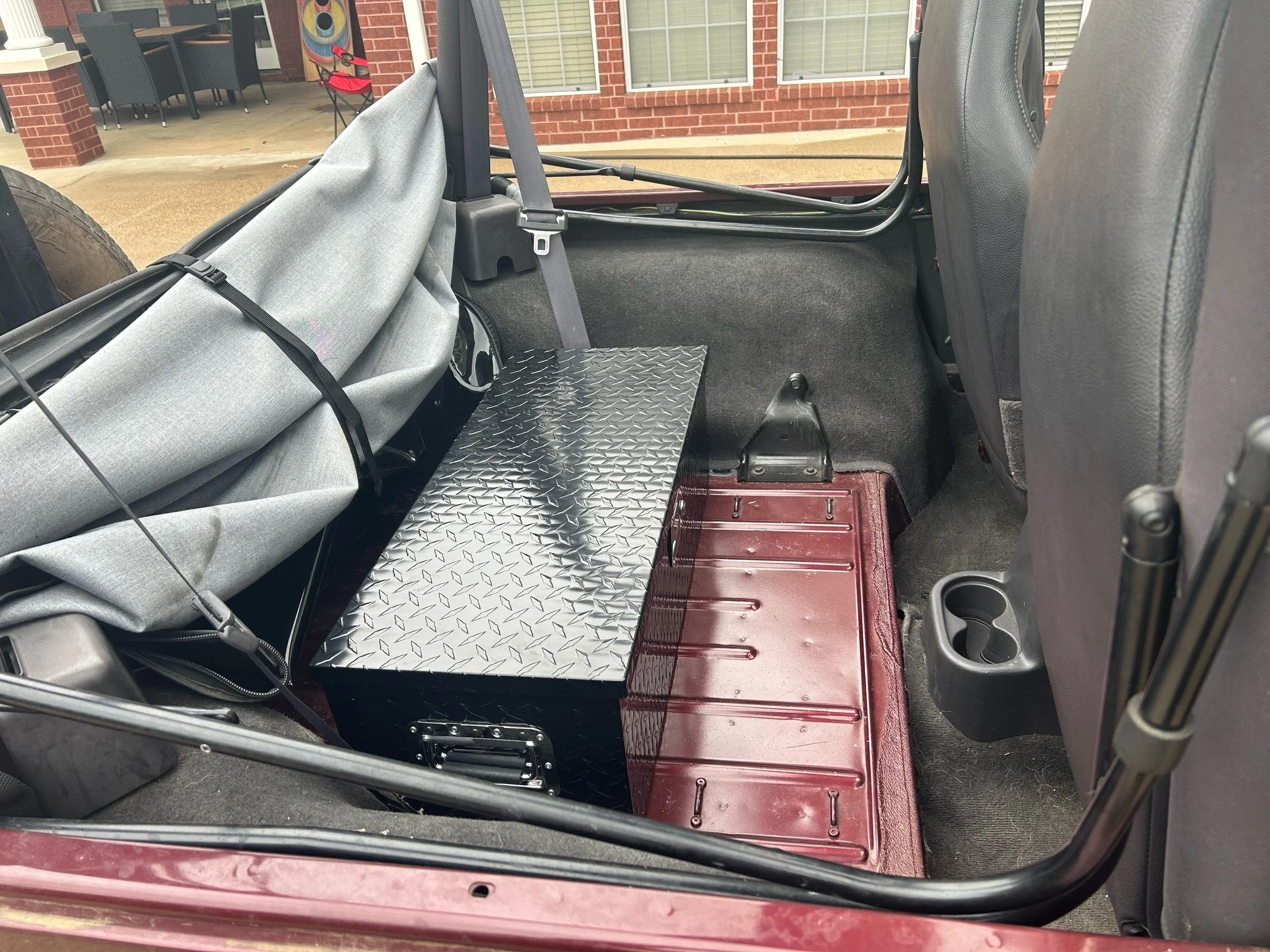

I mountain bike and like to keep my gear in the truck, or Jeep now but no way to lock it up. I wanted a toolbox of some sort to carry my tire plug kit, wrenches, straps, helmet and bike tools but was not about to pay $500+ for a Tuffy system. On a lightning deal, I picked up this tool box for $40 and mounted it where the seat belt bolt was. So far it is working out nicely and does not rattle.

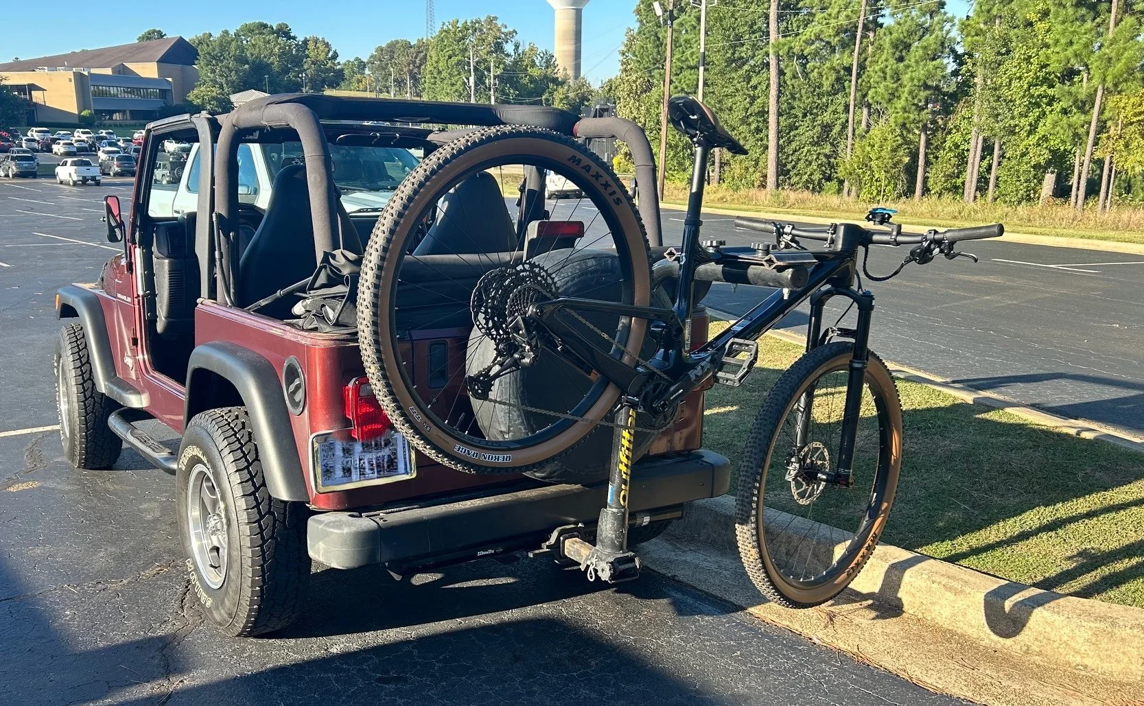

Gotta ask. Why the heavy swing away?
31s are fine on the stock carrier.
Welcome
It weighs less than it looks, and I had not planned on one initially until I picked it up for free. I picked it up myself and mounted it, and I am not a big guy. I like its mounting points for shackles (already had them) and the receiver is higher up than the aftermarket one I pulled off (picture below).
I am mounting my HiLift jack on the swing arm (already in the works and will post that once done) and a couple of 2 gallon fuel tanks I have laying around. In the end, it will be a useful addition, but at the cost of weight I did not want to add. I figure it is worth it though.

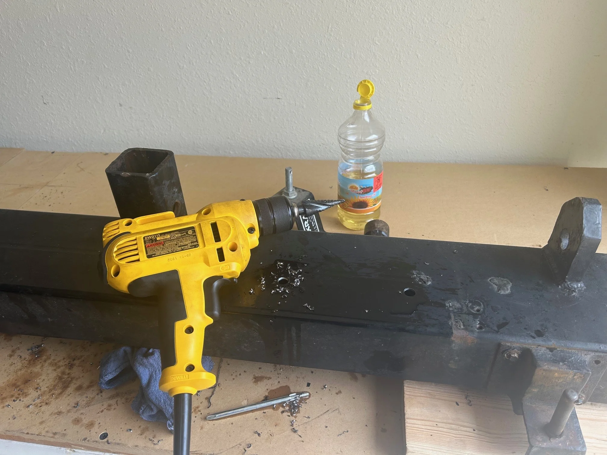

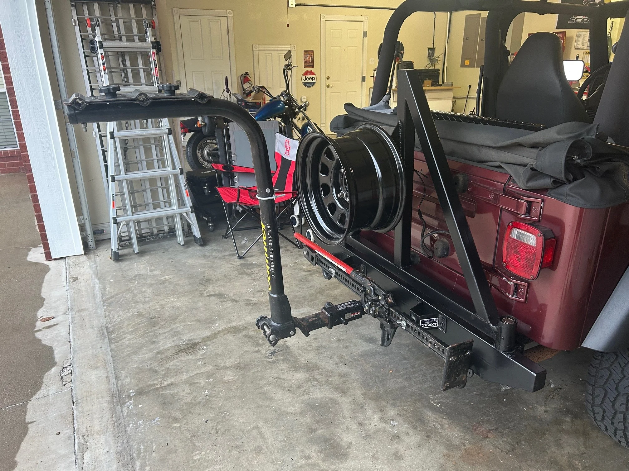

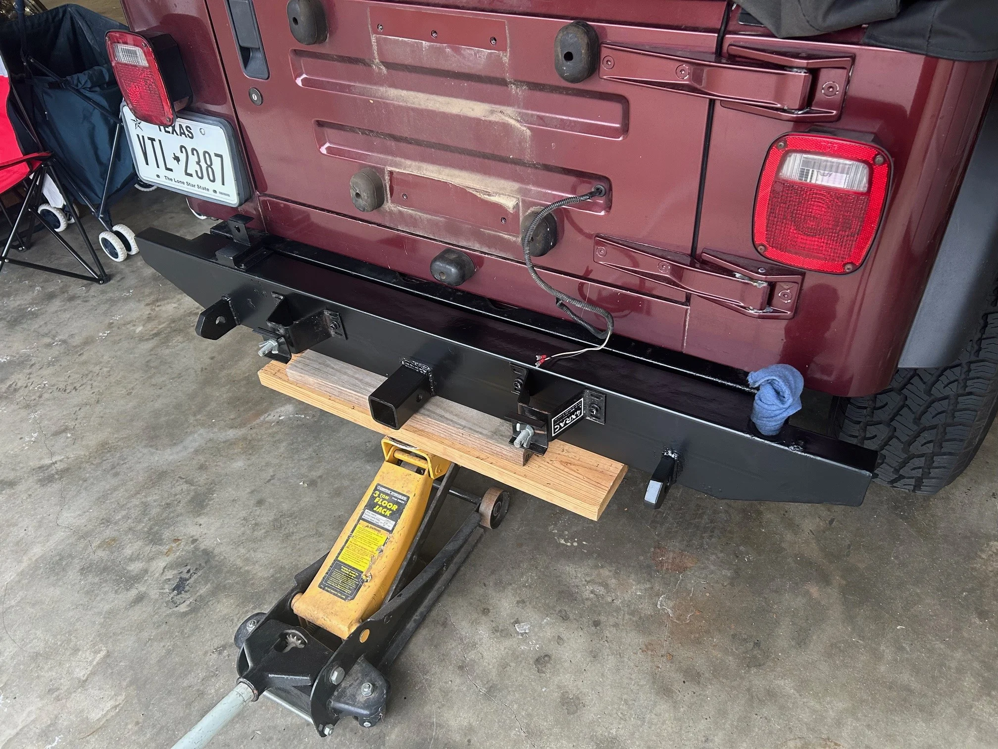

Once I felt up to it, I began the rear bumper rebuild and modification project. As mentioned before, I picked up the rear bumper and tire carrier for free, but it was a bit rough and the swing out bearings were shot. By shot, I mean they weren't even in there and it was just flopping around. I measured the OD of the shaft and the ID of the build in races on the carrier and headed to a local automotive store. After a few attempts, the enthusiastic fellow and I were able to pick out a set of wheel bearings that looked to fit and they did, or at least well enough.
I disassembled the bumper, drilled out holes to mount my hilift jack and found the hardware I needed in my box of bolts. I used sunflower oil for cutting fluid and it worked quite well.
I drilled out and added a mounting bolt, and after a wire brush to knock off any rust, a light sanding and cleaning, I shot it with some satin wheel paint I had laying around. The jack mounts were attached and got the third brake light wiring sorted.
The bottom swing out bearing was missing a spacer, so I fashioned one out of a plastic bushing, packed it with grease and installed it after its clean up and paint. On went a modified LED third break light and the spare wheel I picked up on a black Friday deal. I reinstalled my bike carrier, the jack for a test fit, and got everything wired up. I plan on hanging a Rotopax can on the carrier at some point and maybe get a spare tire, haha.
The foot of the jack hangs down a little but not as much as the gas tank skid plate. It might end up being a problem but it is in such a convenient location, I am willing to risk it.
