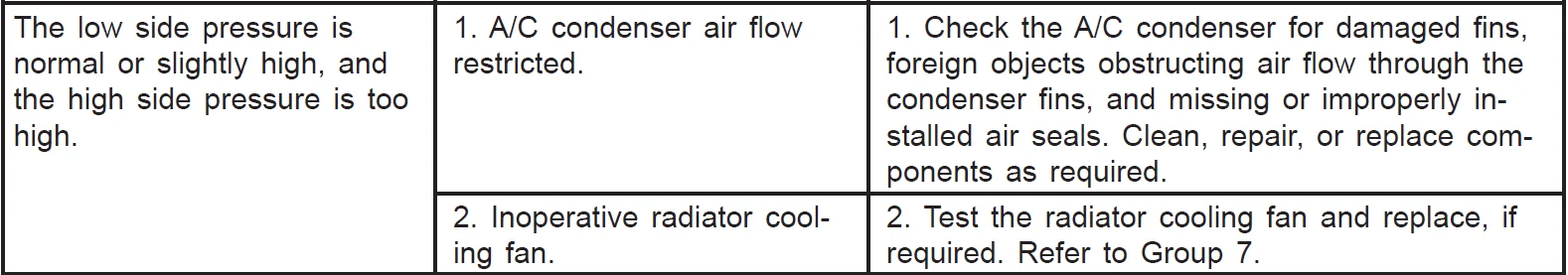

As much air as the mechanical fan moves, I would think that its maybe the fan clutch and probably the compressor and condenser. Id rather fix the problem than just adding another part to the mix (electric fan). Haven't seen or heard of alot of 4.0l needing more fan than the mechanical, for cooling or the AC to work properly.

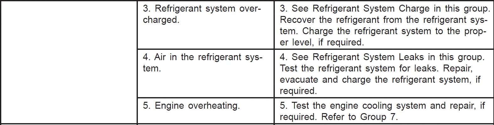

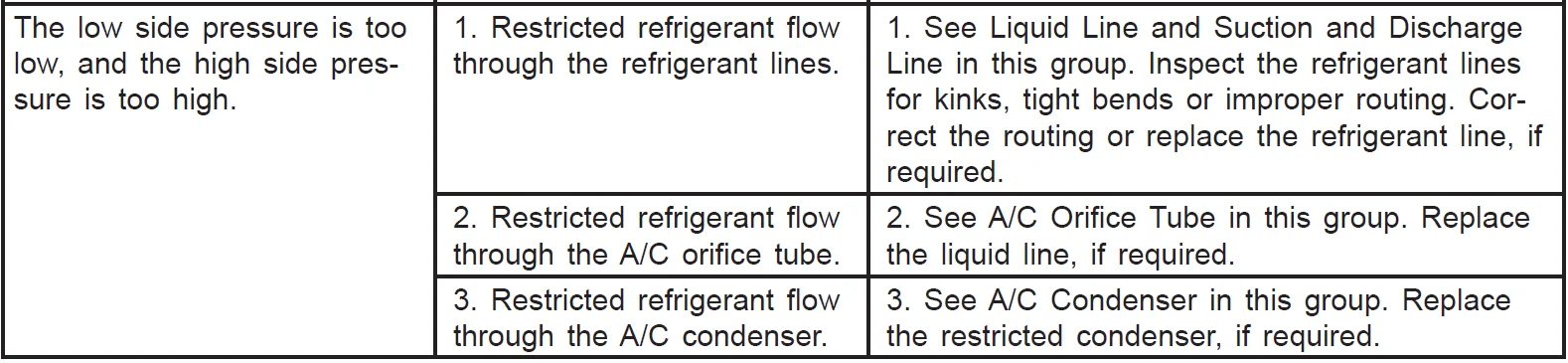

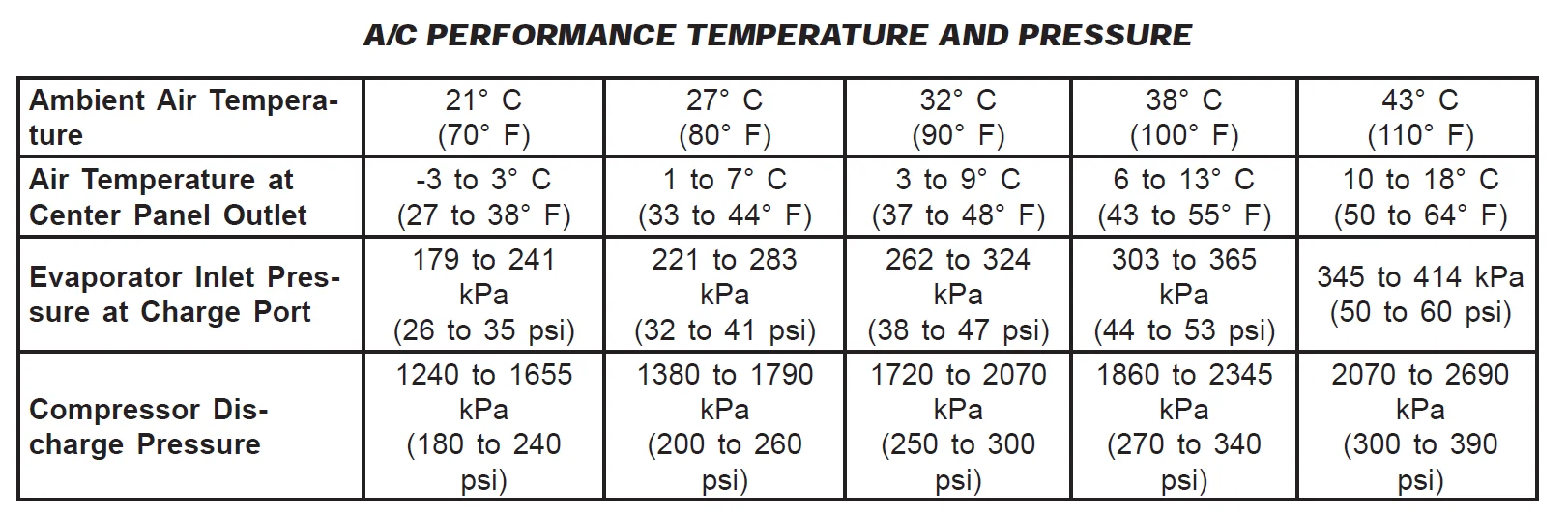

If the orifice tube was clogged, it could spike the high side and, IIRC, it would drop the low side.
I think I'd make sure you aren't overcharged before throwing parts at it if you are going high on both sides.
