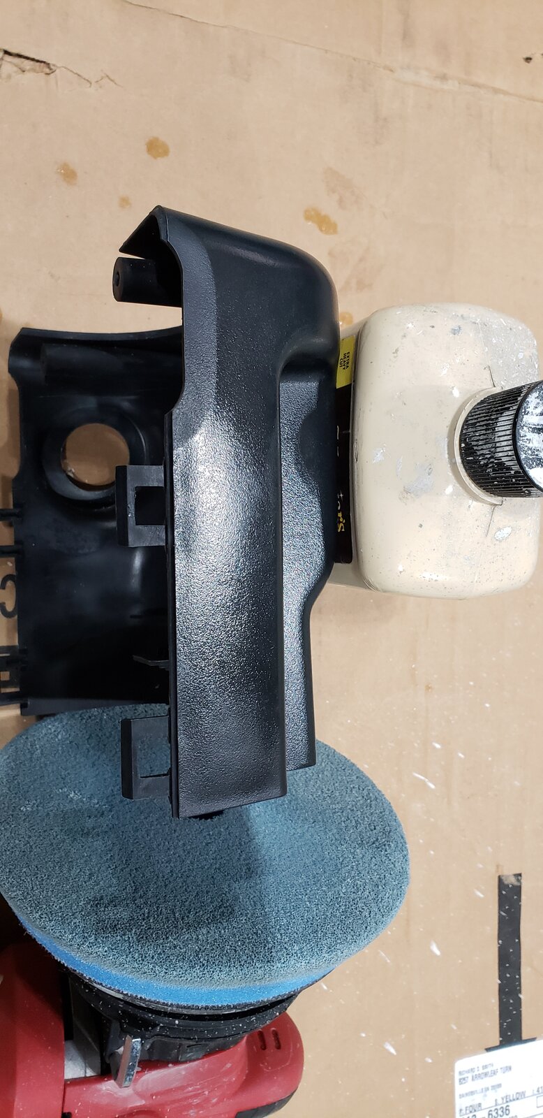

I had to pull the plastic trim around the steering column, to fix a lighting issue. The plastic was faded grey, much like the fender flares. To restore the original look, I first tried Meguiar's Ultimate Black. All that did was make the black look blacker, but the grey was still there (1st picture).

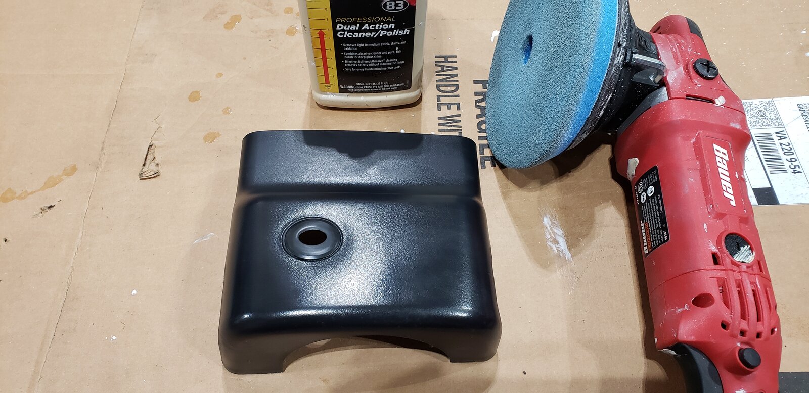

Next, I broke out the random orbital buffer, along with some Meguiar's Cleaner/Polish, and buffed the plastic. After about 5 minutes of buffing the factory black returned, which can be seen in the 2nd picture. FWIW, I tested picture #2 by repeatedly washing the plastic piece in soapy water. After 1/2 dozen washings, it was still as shiny as the picture! :)

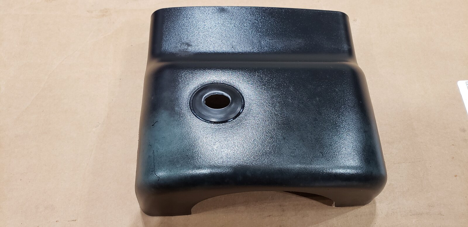

Pictures 3 and 4 are another piece, before and after.
Picture 1 - Test with Meguiar's Ultimate Black (Shiny, but still grey). Also, this washed off easily with soap and water, returning to a dull grey.
Picture 2 - Random orbital buffer used, in combination with Meguiar's Dual Action Cleaner/Polish. After 5 minutes of buffing, the grey was gone. Also, this was washed repeatedly, with soap and water, but the shine stayed and the the grey didn't come back.
Picture 3 - Before buffing

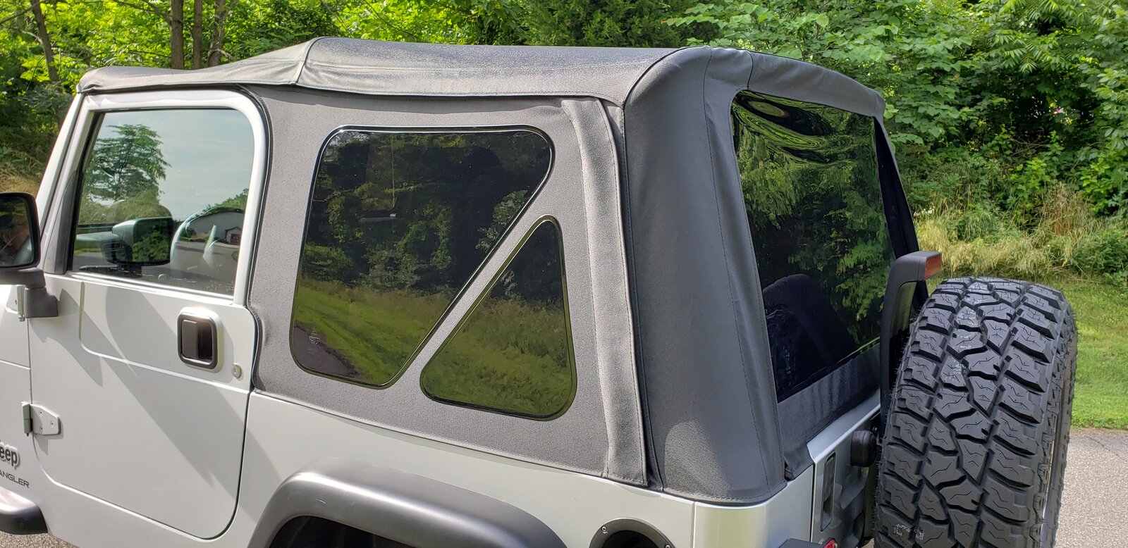

Picture 4 - After buffing
More info on your buffer , please. Looks like something that the wife really needs . Thanks.
Reactions: Wildman and Irun
I've used several buffers over the years and this is my favorite, so far. It's comfortable, easy to use, and the combination of random orbital motion and variable settings means it won't burn through sharp edges like other buffers. Thus far I've used it for more than 40 hours and the only negative thing I can say about it is the buffing pads can be difficult to remove (The velcro holds extremely well!)
When I bought mine, I also picked up the course, medium, and fine pads. However, I haven't really needed to use anything but the course. Just make sure to keep the pads wet when in use. If not, they will start to break apart.
https://www.harborfreight.com/corded-20mm-long-throw-random-orbit-6-in-da-polisher-56367.html
https://www.harborfreight.com/6-in-coarse-foam-polishing-pad-blue-56549.html
