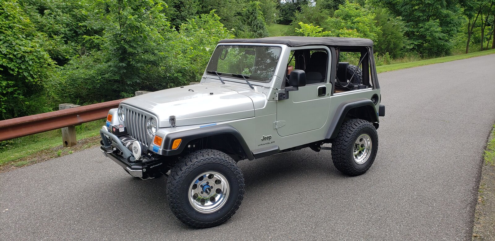

Got the driveshafts installed and finished all the wireloom installation and tidying up on the bottom side. Took the Jeep out for a short spin in the neighborhood.
The rear sits a little higher than I would like and there is a very slight vibration. The rear is currently set at about 16.5 degrees and the driveshaft looks like 21 degrees. I'm going to have to make some adjustments!

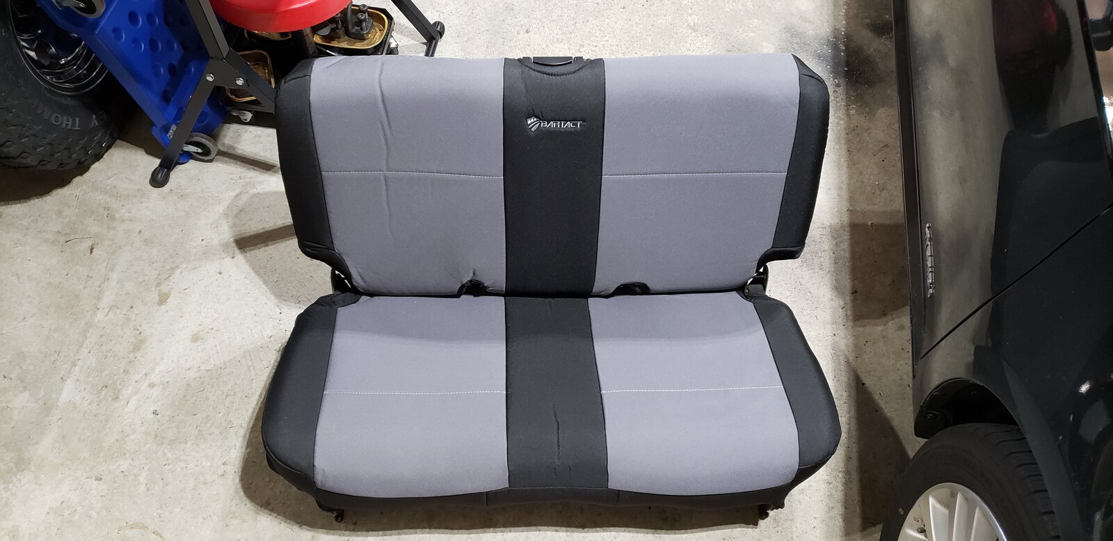

Picked up the last major interior part, a rear seat. It belonged to a local club member, who takes care of his stuff. In anticipation of finding a seat, I had already ordered and received a Bartact rear seat cover. To match the two tone factory front seat previously acquired, I went with black and gray. The covers still need to be tweaked, to get the lines matched up, but this is a decent first try.
Also, officially put the Jeep on the road for the first time. Tomorrow I'll get to take it out for a longer shake down drive and see what pops up. I was able to tweak the rear a little more, raising the pinion angle slightly. I did not however get a chance to test drive it.
