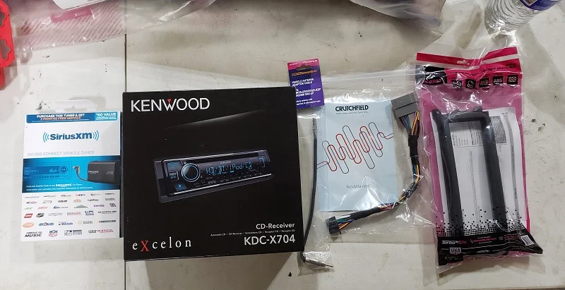

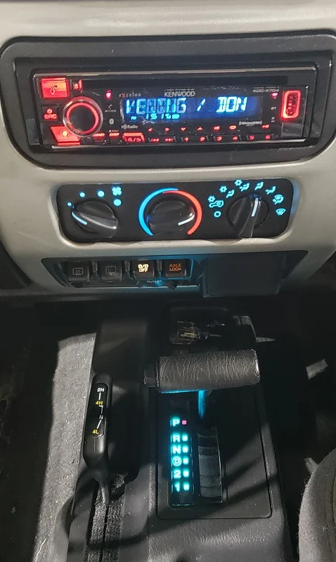

Focused time now continues to be a problem, so I'm working simple and small jobs (backwards from the way I usually work). Went to my go-to for stereo stuff, Crutchfield, and ordered a new receiver and XM tuner.

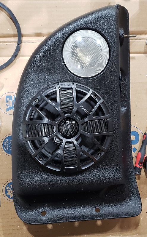

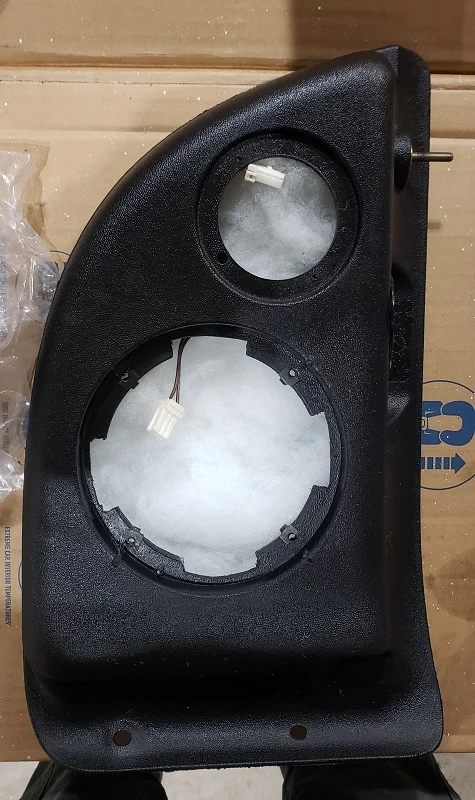

I don't like spacers, so I used a 4" cutting wheel to modify the speaker pod for a new set of 6.5" speakers that have been waiting for a home. These aren't the best speakers, but they have a very good sound and can handle an amplifier upgrade later on.

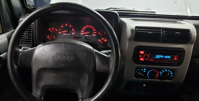

The new stereo had tunable lights, so I did so to match the LED upgrade I did on all the dash lights.
While I was in there I also replaced the busted center and outer vents.

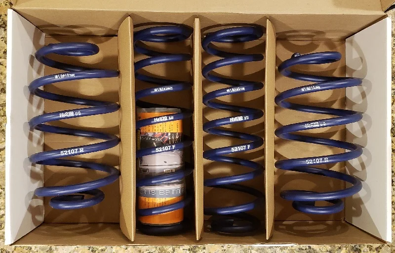

After over studying the spring choice, I committed to a set of H&R 52107 Sport Springs. Absent real data on the H&R springs, because H&R won't tell you their free length or spring rates, the decision was made for primarily three reasons:
1. Having installed them twice, I know they're well made and will yield 1' - 1.5 ", depending on sprung weight
2. I looked at the next best choice for my use, i.e. OME 2933 & 2941. These are close enough in free length to the 3" Nth Degree springs I have that when combined with the Savvy 1.25" BL, I'll end up with too much space between the tire and flare, with a 31" tire.
3. Price. A set of four was $238 delivered next day, from Tire Rack

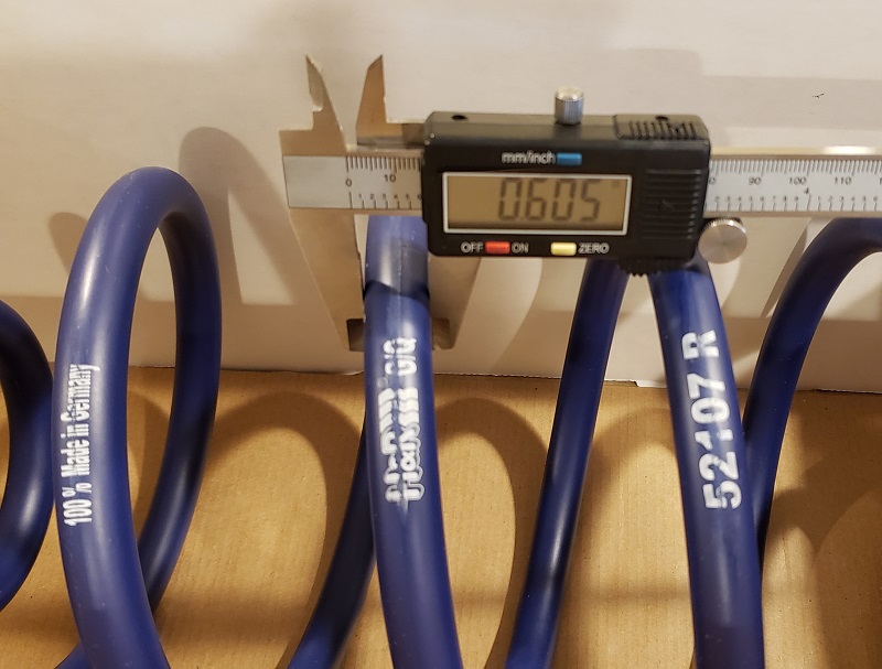

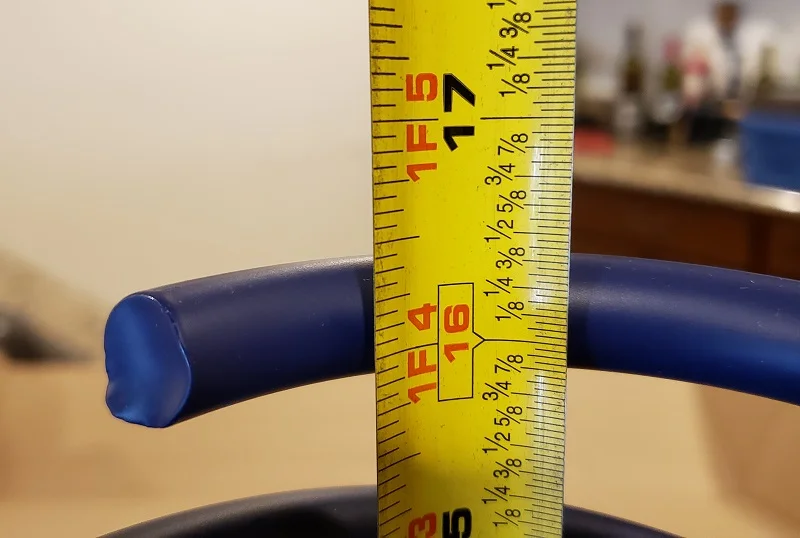

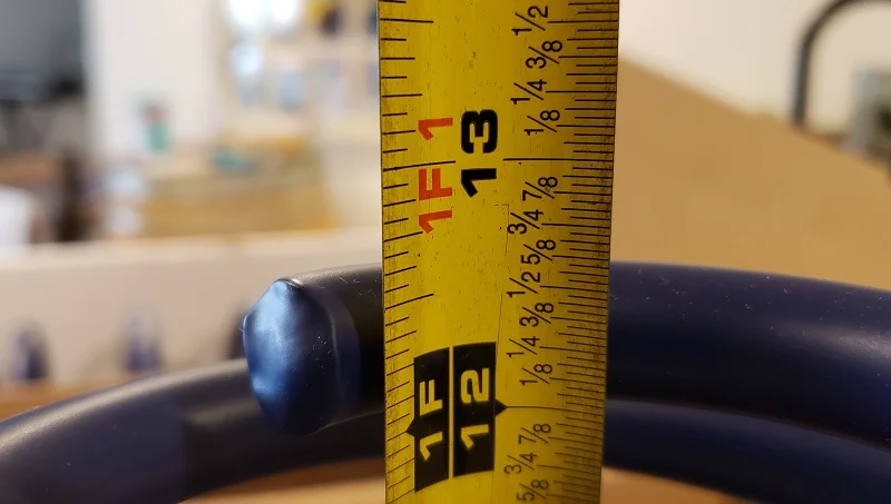

Ordered the H&R springs Wednesday from Tire Rack, because they had the best price ($238) and free shipping. They showed up at my door 1 day later and were extremely well packaged. Kudos to tire rack for excellent customer service!

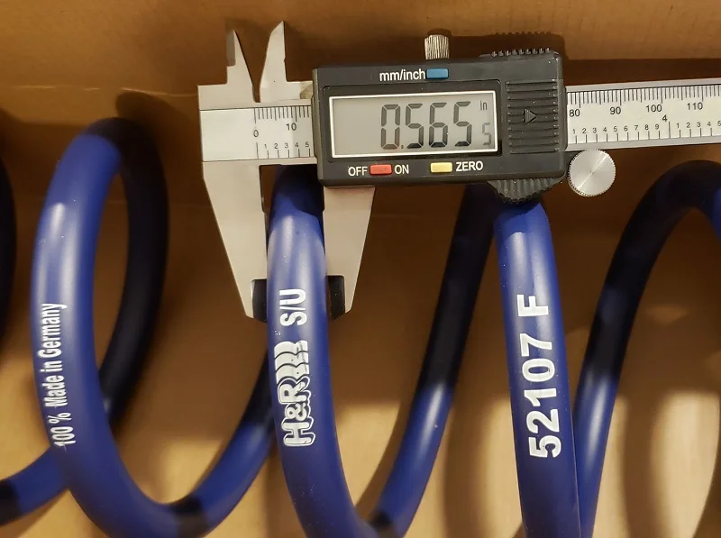

I made the mistake of not measuring the previous set I had, and H&R will not tell you, so let's talk numbers. FWIW, the only thing H&R will tell you is that the springs are Progressive.
Front = .565" thick & 16 3/8" tall
Rear = .605" thick & 12 5/8" tall
Based on what I could find, here's how the free lengths compare:
Stock Front = 17"
H&R Front = 16 3/8"
Stock Rear = 11 3/4"
H&R Rear = 12 5/8"
It will be interesting to get the ride height measurements!
Stock Front = 17"
H&R Front = 16 3/8"
H&R Rear = 12 5/8"

I believe this is due to the much higher rate of the H&R springs.
