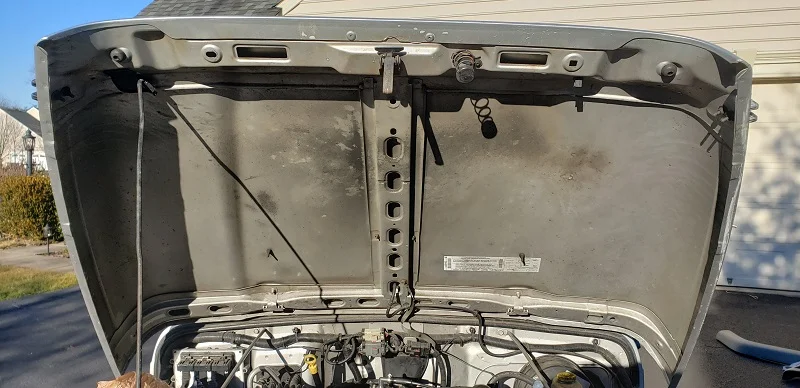

Also, detailed under the hood and engine compartment
I don't know any other way!OCD in this application is therapeutic, eh?

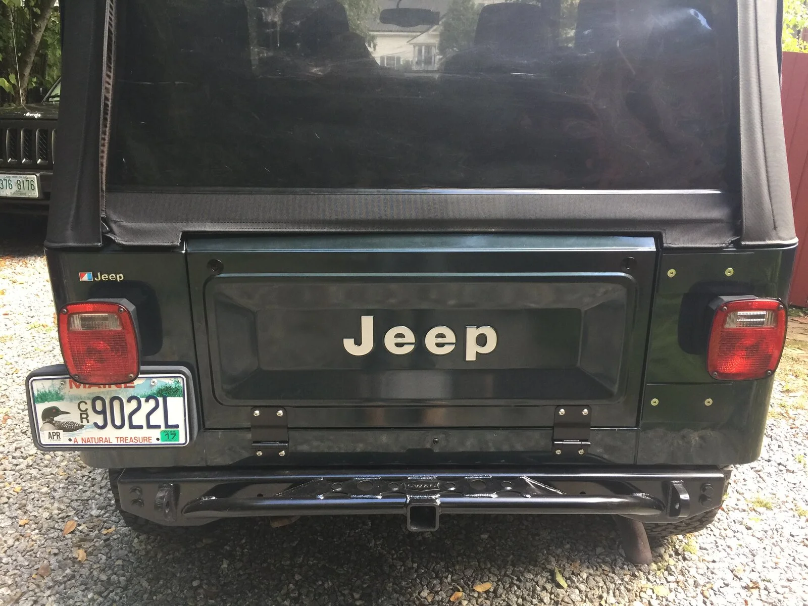

The other plus side of the UCF bumper, besides the fact that I have the swing out tire carrier version on my LJ, is the style would be consistent front and rear. My OCD might not be able to handle the imbalance!I‘d say get the UFC one or the lightest steel one that you can tow with. You may not do it often, but if you want/need to you wish you had went that direction. It could still be true to the nature of your build. There are always compromises.![]()

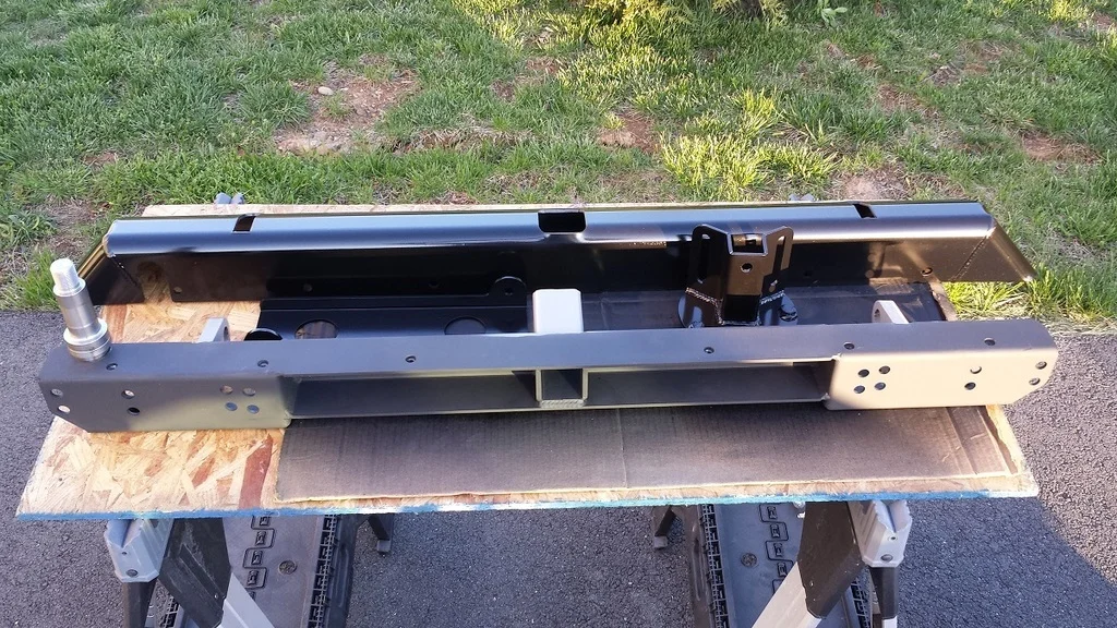

I actually looked at the SWAG bumper and like that one also. What's really making me lean in the direction of NV is they're offering free shipping now. That makes the cost close between the two, and I don't have to do the welding.I really liked the Swag rear bumper. I used it for a bike rack and towing a M100 1/4 ton military trailer with frame tie-in brackets. I'd throw the safety chain hooks through the dimple die holes on the plate. Of all the enhanced cross member bumpers, I like the looks of the Swag the best.
The Next Venture would probably be a close second for that type. I prefer how the Swag tube goes further across, which I would think helps getting the load from the hitch closer to the frame and putting less force into the crossmember. But it probably doesn't make that much of a difference. And they both are boxed around the ends.

That's exactly why I'm looking at steel, or this hybrid. It has a steel inner core, with an outer aluminum cover. This is the carrier version, which I have on my LJ.I've been going back and fourth on nailing down the rear bumper. This is an important decision and needs to be figured out soon, so I can install the new fuel pump and Savvy gas tank skid sitting in the garage. I've already ordered the Savvy front bumper and am considering their rear bumper as well. The only thing holding me back is the fact that I can't tow a small trailer or install a cargo basket with it.

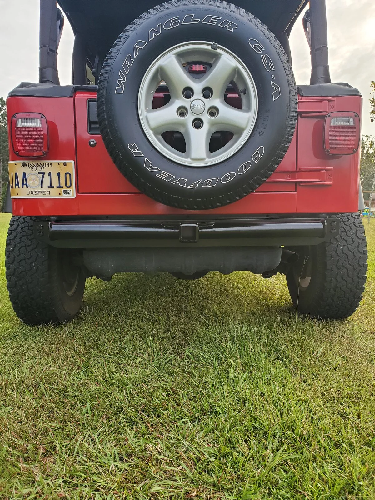

I followed this discussion, which was very informative. If I add a Savvy rear bumper, there would be no basket, bike rack, or road towing. The receiver would be used for its intended purpose, i.e. extraction.I’ve seen blaine talk about this with the savvy bumper but I’m not sure an aluminum bumper is the best choice if you want to carry a basket. The cyclical loading from the bouncing stresses the aluminum in a way that causes it to break over time. The tow hitch in those aluminum bumpers is meant for straight pulls.
Unless you run a factory like hitch receiver.I followed this discussion, which was very informative. If I add a Savvy rear bumper, there would be no basket, bike rack, or road towing. The receiver would be used for its intended purpose, i.e. extraction.![]()
Ahh I guess I didn’t think it was savvy specific. I was under the impression that the problem was for all aluminum bumpersI followed this discussion, which was very informative. If I add a Savvy rear bumper, there would be no basket, bike rack, or road towing. The receiver would be used for its intended purpose, i.e. extraction.![]()
