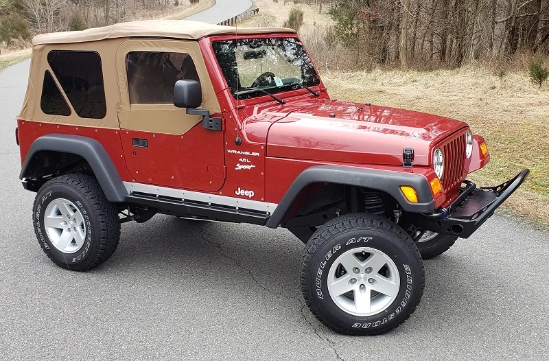

I ran the Nitro Charger shocks with 3" Nth Degree Springs and the ride was excellent. The problem was they were to tall with a 31' tire. This is a previous Jeep with 3" springs, 1" BL, and 31" tires. There's to much space between the tires and flares for my liking!

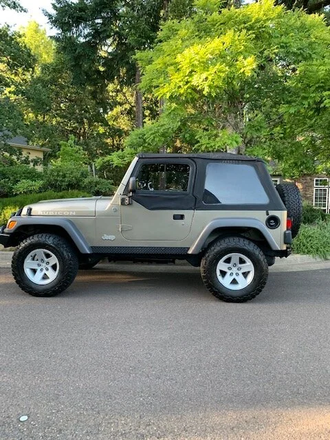

I have the nitro chargers shocks on my TJ (with HD OME springs). I don't like them, they are too harsh over slow speed bumps. They do handle well at speed, but the trade off isn't worth it to me. (265/75 tires in the picture)
Beautiful jeep. I agree that spacing is a little bit off

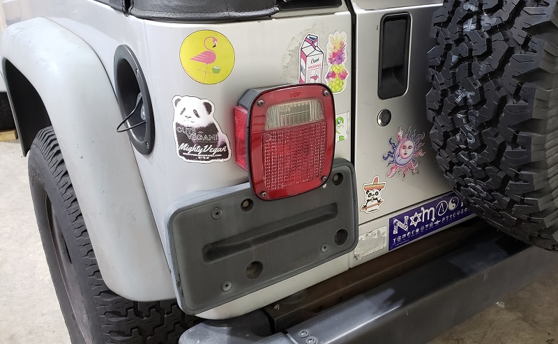

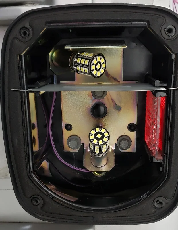

Replaced the stock tail light bulbs with some LEDs I had. This is a rare occasion where I say thank God for California. Zero rust in there!
The last thing for this weekend was replace the blower resistor and repair the inoperable 3rd brake light.
Kind of weird to me given i'm from Florida, it rusts in the taillight???? Isn't it supposed to be sealed lol
They're moisture resistant, but not waterproof. The gasket between the lens and housing tends to not work as well over time. Just ask those in the rust belt!
So unusual to me lol. Here it's pretty common to tap into the reverse light to power for a backup camera and route the wire by just drilling into the housing or squishing the cable in between the cover and the gasket. The idea of rust forming in there is so foreign to me that it hadn't even crossed my mind. Hell, I've even done it on a couple of friends' TJs!

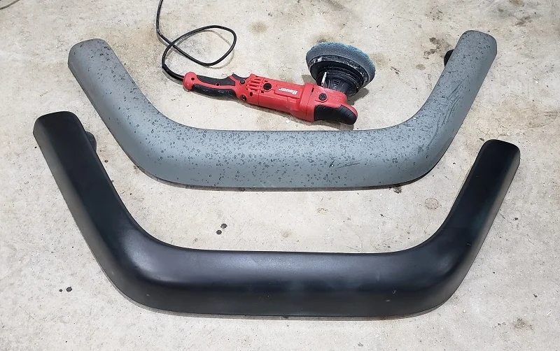

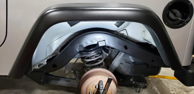

Spent some time trying something new with restoring flares. Mine were extremely grey, as can be seen in the picture. Using a buffer, I worked in three stages. 1st stage was a heavy cutting compound. 2nd stage was a light/medium cutting and polishing. 3rd stage involved wax. The results were impressive, but still not to my liking.

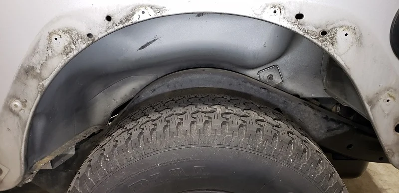

After the experiment, I cleaned up the inner fenders and painted the flares. I know I could buy new ones for around $135, but I had the primer and paint already. Also, I have a set of nice Rubicon flares that may go on, depending on how the wheels and tires fit.
Before
After
