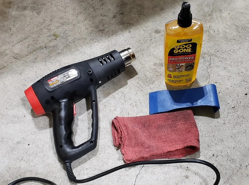

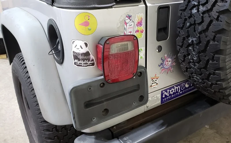

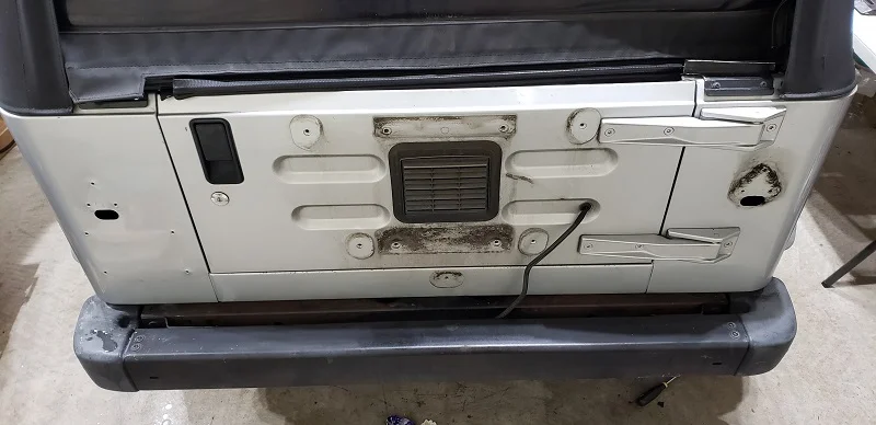

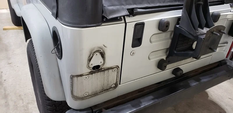

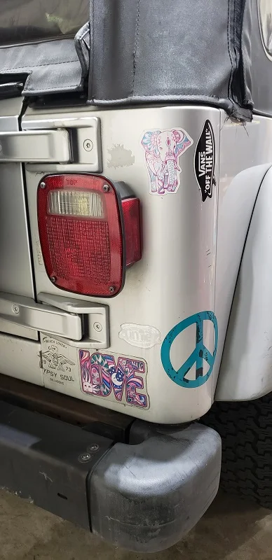

Had a bunch of stickers that were inconsistent with my personality and interests. Time for them to go!

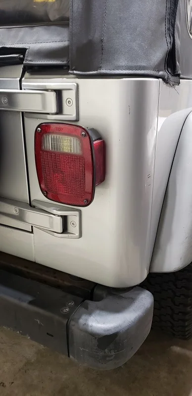

Passenger rear before
Passenger rear after
Driver side rear before
Driver side rear after

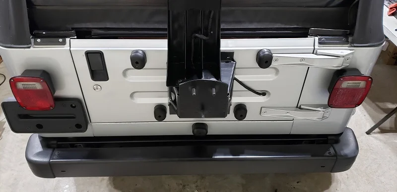

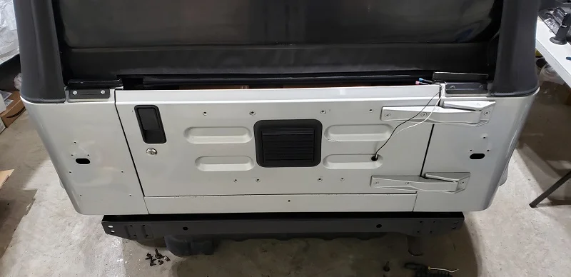

Disassembled the rest of the rear

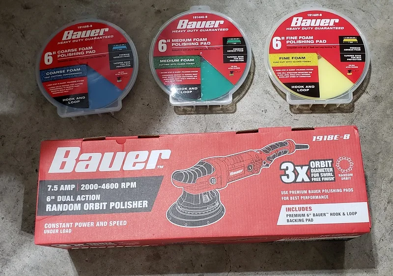

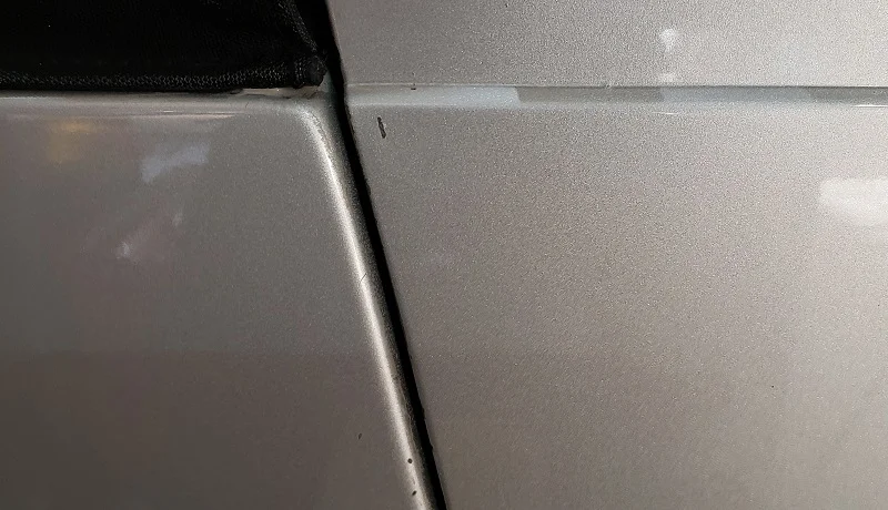

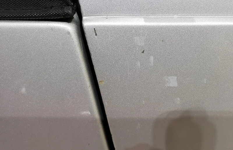

Removed the rest of the grim, then used the random polisher to bring this old paint job back to life
Then repainted, cleaned, and treated all the plastic. Rear is now done!
That new bauer polisher from HF is tits money compared to their older model. Does alot more in a lot less time and they have quite a selection for their premium foam pads as well. 👍 now, they just need to make a mini 3 inch or smaller.
I've used a rotary polisher for decades. They require practice and skill, so you don't burn through the paint. This random orbital is amazing. Anybody can pick one up and achieve amazing results, with zero fear!
I can't believe you didn't like all those stickers....lol.
Looks great now. 🍻

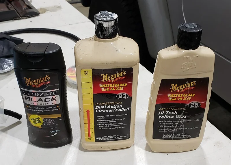

What compound did you use for those foam pads?
I tend to use Meguiars products. For cleaning and polishing I typically use their Dual Action Cleaner/Polisher. It's a light/medium cut, but usually works well for most vehicles and situations. If the hood or roof has deep acid rain marks, I'll use their heavy cut cleaner, then follow up with the light/medium cleaner/polisher, then hit it with wax.

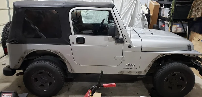

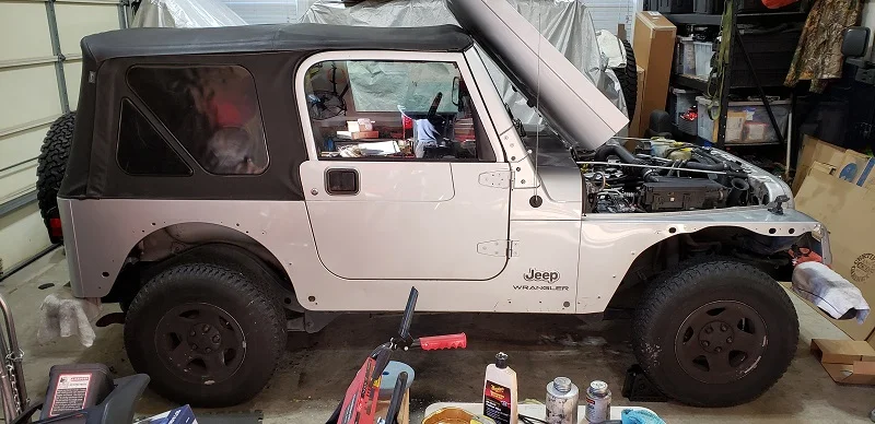

Spent a few hours on the passenger side today. Removed flares and mirror, then did a clean, polish, and 2 coats of wax. The new random orbit buffer did an amazing job. I was probably more excited by the fact that every nutsert bolt came out easily. First time I've every pulled flares without breaking one!
