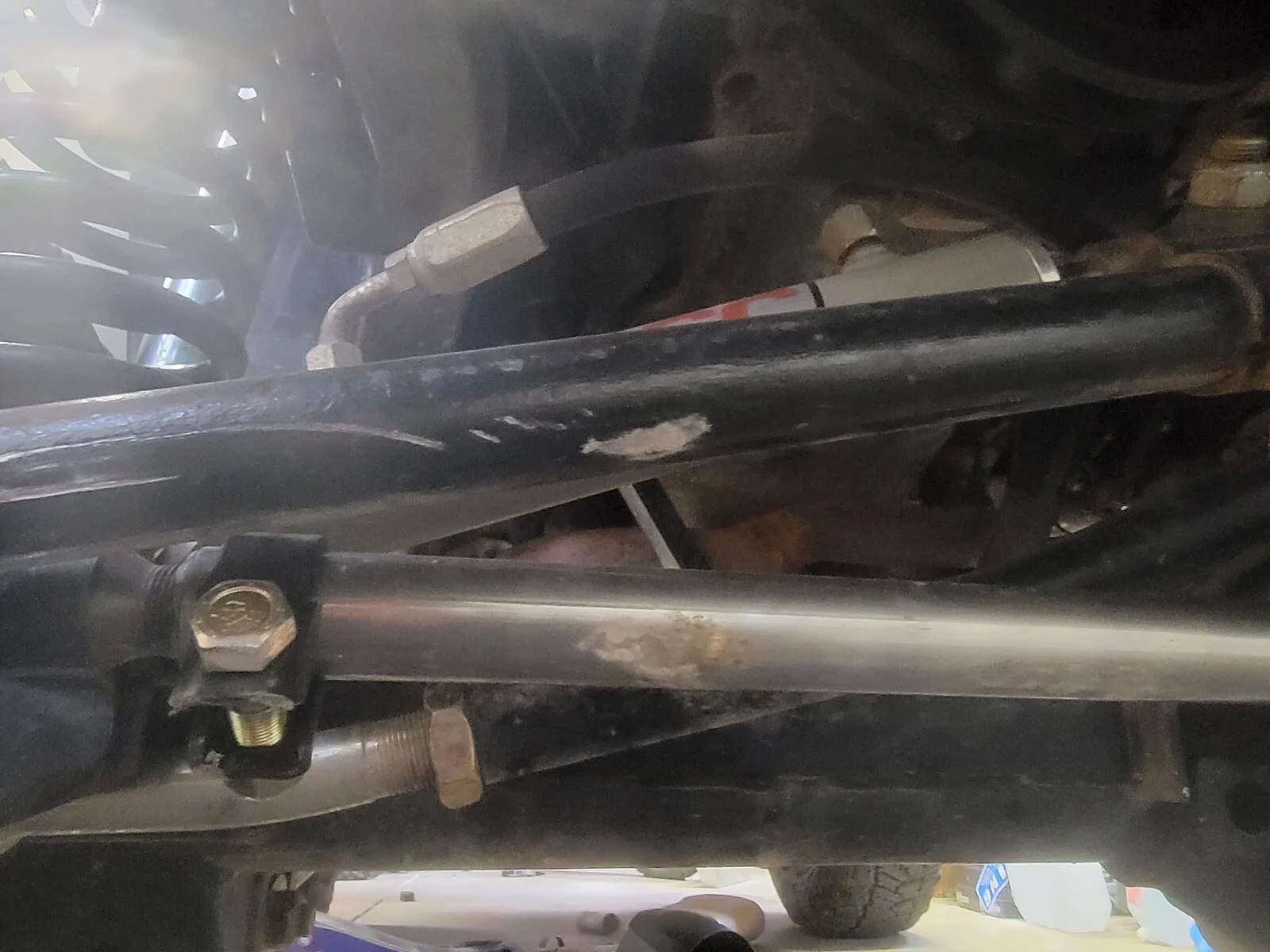

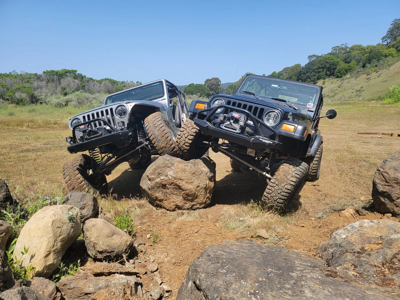

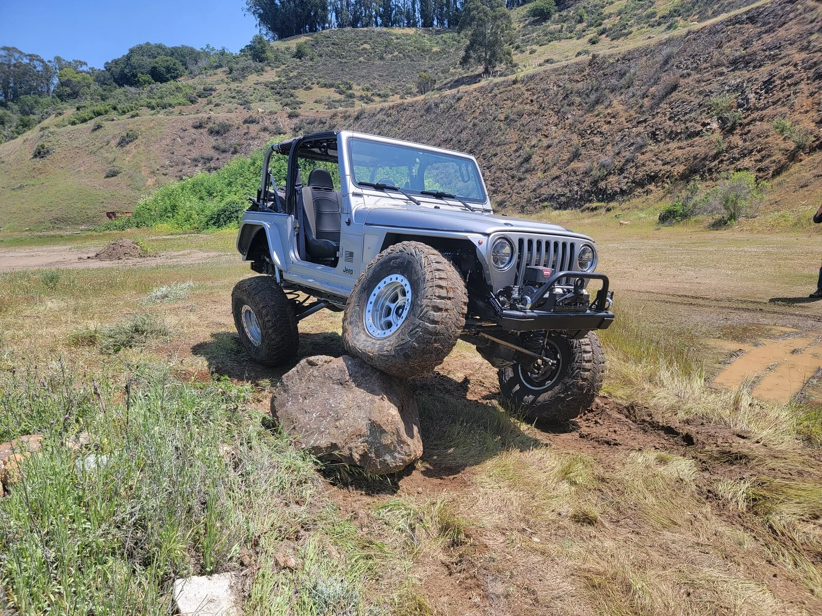

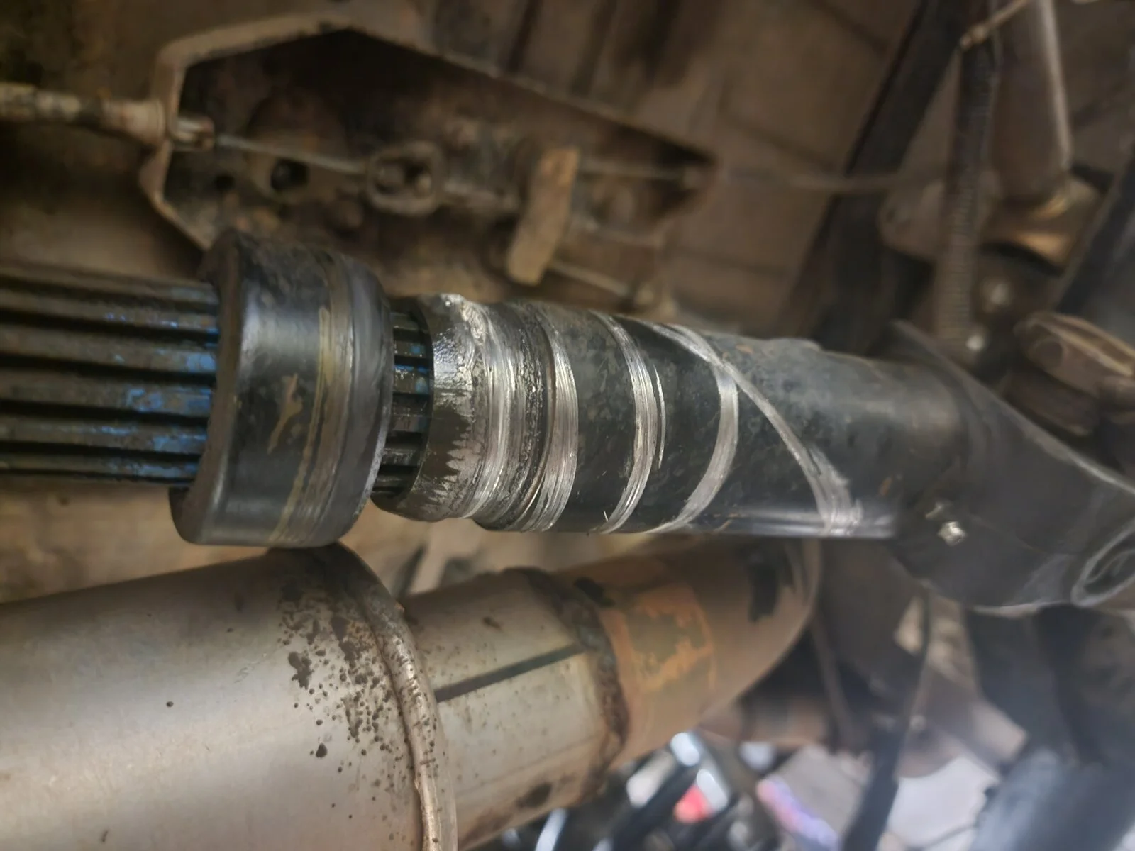

I had a bunch of fun building / running the "vigocon" at @mvigo's property. While the trail is short it certainly isn't for those scared of a bit of damage. Durning the trail I found an issue with my exhaust since the muffler was contacting the DS. It's hit in the past but under the extreme
conditions of the vigocon it was apparent it needs to be fixed. More to come on that in the next couple of days.

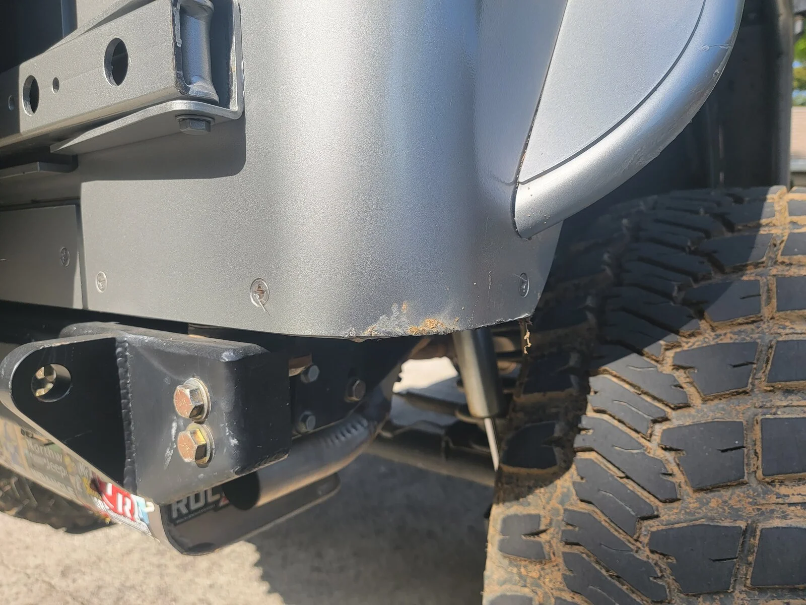

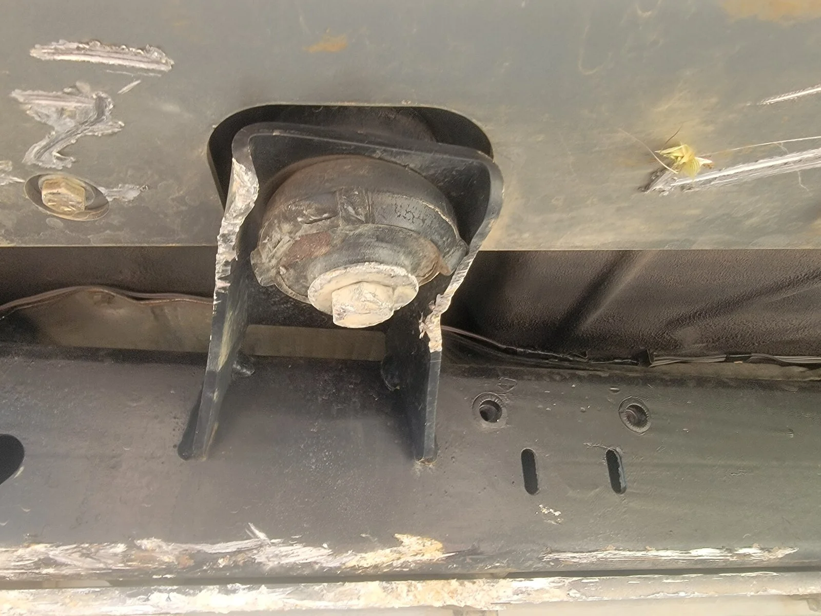

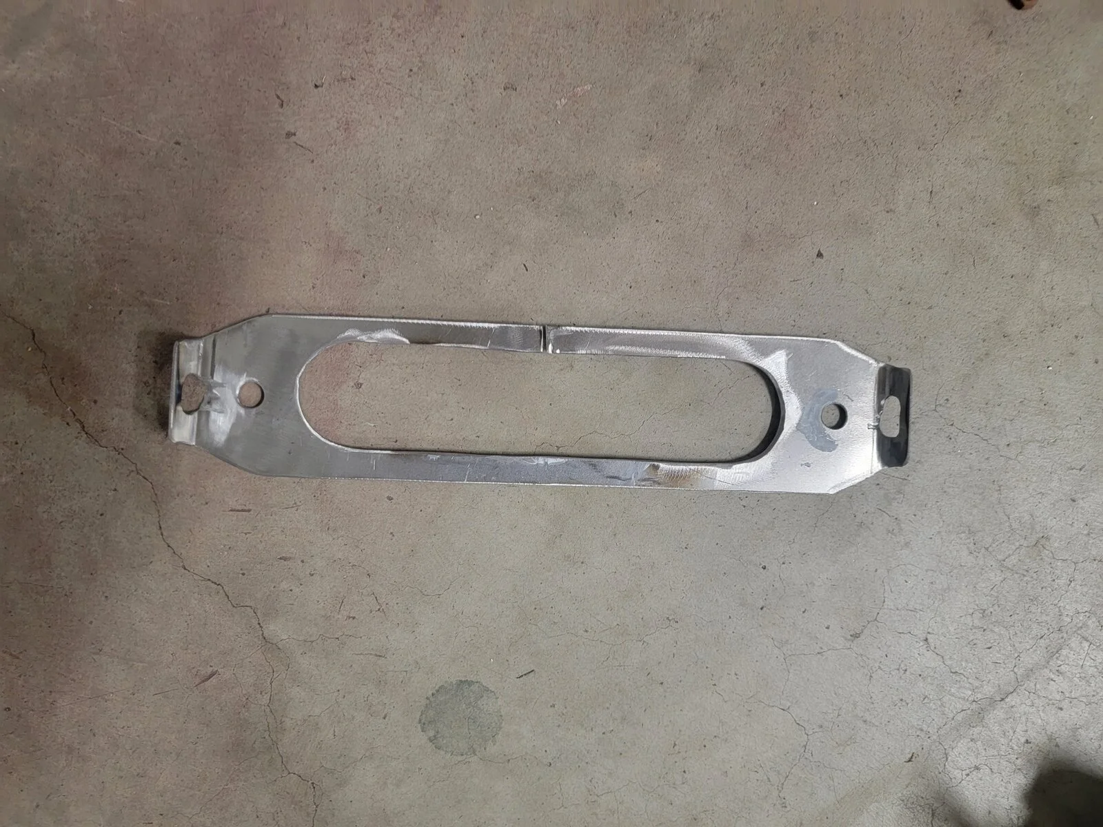

I also forgot to remove my front license plate and it hooked on a rock ripping the mounting tab off the tre winch side mount.
Broken bracket.
I got some steel from ace hardware, should have done aluminum, and made a new piece since TRE doesn't sell it anymore. Or at least I haven't seen it in stock for a year now when looking for the JL.

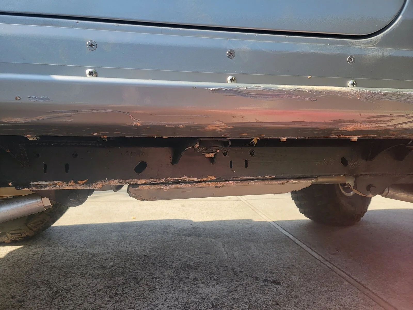

Every time I see damage to the frame like this I wonder if there is any merit to welding a piece of angle along the outside and bottom edge. I'm thinking something like a 2"x2"x1/8". If clearance under the skid is an issue, the angle could always be notched around it. Just thinking out loud here, but the frames are getting harder and harder to come by, especially here on the East Coast, and anything done to protect them can only help!
Possibly something like this?
It would be better if you had some bent up with a rounded corner. The sharp corner of the angle will bite in hard.

@Alex01, thanks for coming out to the rock party, fun times, and it is nice to be able to have a "shakedown" trail literally in your backyard...I have a feeling the more we run it, the easier it will become from rocks moving around...oh, and all that "damage" will buff out! my tires got chewed up pretty good!

It was a blast. Can't wait to do it again. And ya I bet it'll be tamed down a bit each run. It got way easier after the JK plowed some of rock around.
Forgot to mention. I didn't see it myself but I was told @mrblaine's tierod took a large hit and bent up pretty good. After getting off the obstacle the tierod sprung back to its original position and is as straight as an arrow. Very happy with it. @Midnight LJR you need to put it on the top of your install pile!!! After the sticker of course.

nice little barber pole bite on the driveshaft
formed like Blaine said, but maybe also bolt on/off, it'd be a PITA to keep sealed tight and need to be attended to during yrly maintenance to keep it from contributing to the trapped moisture issues. or welded on 100%

I know a guy that has access to aluminum if you need some, also your rear DS looks like mine now😳

I'm just happy the grease zerk on the DS got spared. It was 1 ration away from being taken out. Likely a rock on that part of the shaft but the cap has repeatedly been knocked off by the muffler.

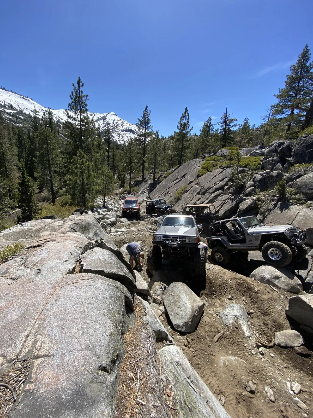

I had the pleasure of wheeling with @Lonewolf and @Choptop1954 over the weekend. We headed up north to Fordyce for a day trip since the water level was low, 50cfs, and the other options we looked at were all closed. The trail was a ton of fun and just the type of trip I've been dreaming of since last summer. While the parking lot was a zoo the trail wasn't all that crowded. We ended up turning around at winch hill one since one of the jeeps was starting to leak steering fluid and while diagnosing a group of Toyotas got in front of us and looked like it was going to take a long time for them to get all the rigs up.
What a great trail. Tons of standing water, river crossings, beaches, big rocks, and the armor sure did take a beating. I also ran it without the spare since I'm currently working on making my carrier a bit more stubby so I can get the tire close to the tub. I'm still debating whether I'll put the tire on the back or just keep it inside when the family doesn't come or commit to towing and leaving it in the truck when they do.
