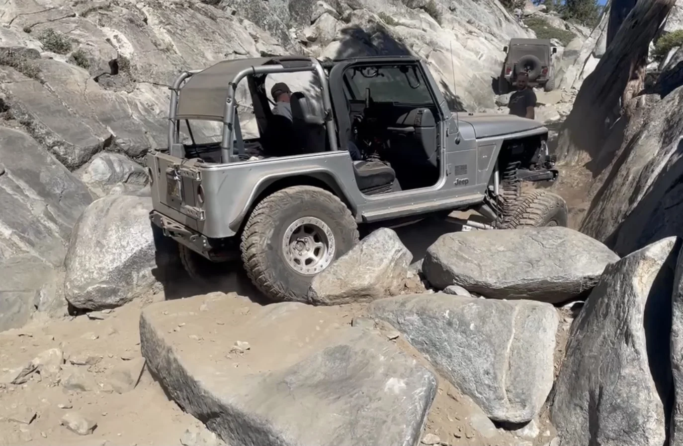

Had some fun on the trail with @Choptop1954 and @Lonewolf today on a last minute fordyce trip. (Bailed out at committee crossing)
I didn't get any photos of my jeep but it performed great.

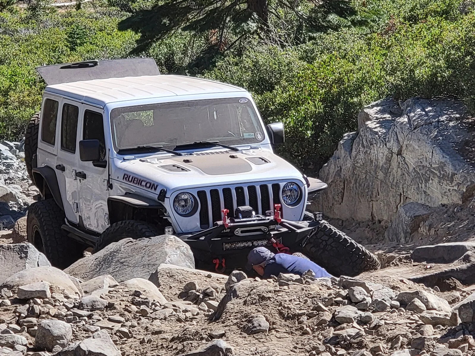

When going up winch hill 2 we let a JLU pass us since he was clearly trying to get past. He struggled a bit getting up one section and we heard a loud pop. A few seconds later his wheel came off but that didn't stop him from continuing to try. He was adamant he didn't want our help so we squeezed by and left him. His group was behind us so hopefully they got him off the trail. I can't imagine they'll get the jeep off without parts given the location.
Broken ball joints, outer axle, and ujoint.

Update on JL broken on Fordyce
Thanks for offering assistance in helping me out!! I always am willing and able to help out on the trail - a karma thing, but at the time I thought it was catastrophic and not a lot anyone could actually do on the trail.
However the damage was bad but not manageable:
Freak occurrence of both ball joints popping out of C (did not break just popped out) which caused the ujoint to basically exploded once it let go and the axle was on load and tire and knuckle off. One I was able to dig out and jack up the jeep we were able to take the axle out and stuff with rag and tape off and put the ball joints back in - had to try multiple times since I did not have a press but was successful just as the sun went down.
I was able to get it back off the trail the next day and trailered it home.
Multiple things on that stock m210 axle broke including the track bar mount on the axle (not repairable) sway bar links stabilizer shock and am going to have to replace axle. Want a 60 but kinda pricey - any suggestions?

The u joint/axle failed first which led to the ball joints popping out.

Glad you made it out OK. It certainly didn't look like it was going to be a fun extraction. I'm glad you were able to get it out without ratching a tree on it and dragging. I felt bad when you said who your group was in front because we saw them behind us at WH1 and I'm sure you were pushing it a bit harder than nornal thinking you wanted to catch up. We were all convinced the tight squeeze moments before would hold up your longer wheelbase but when you were right back on us we made the call to let you pass.
What sliders do you have by the way? We also have a Blue JLURD and I'm looking for something like yours that pop out a bit more.
60s are definitely $$$ best option may be getting a take off.
From my view I heard the ujoint fail before @Lonewolf ran out of his jeep saying the wheel came off.

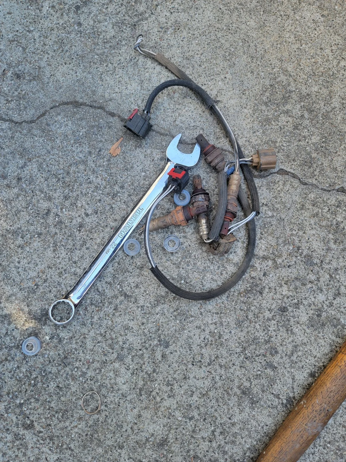

The jeep threw some codes durning the last outing that pointed to the O2 sensors. Looked like the fuse blew that powers them but since it's something that was on my list anyways I changed them all out.
fairly painless job.
