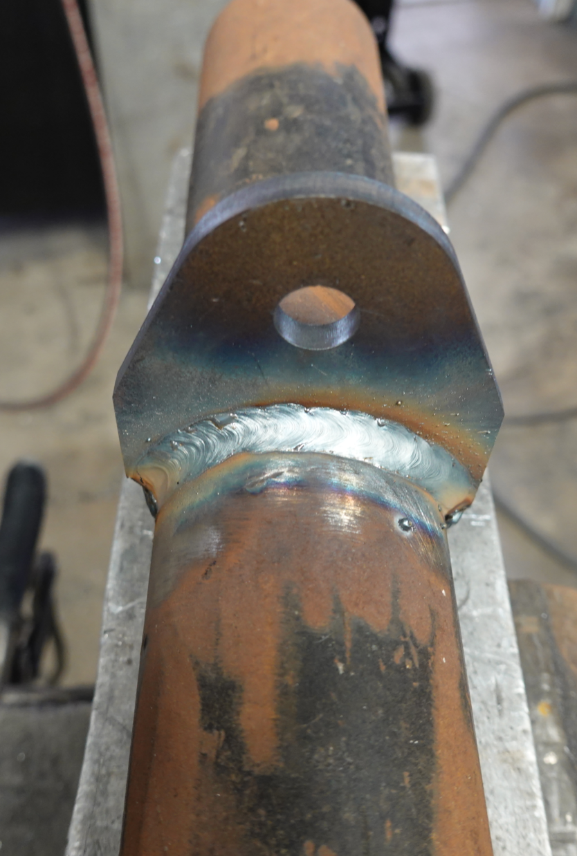

Not to piss in any of the expert's cheerios but this is a case of CYA and theory not quite standing up to practical application. I know this from experience welding lots of brackets and tabs on axle tubes with zero ill effect. I needed a way to show that it isn't as bad as lots of folks tend to make it out to be so I dug in the pile and retrieved a piece of front axle tube and an equivalent to the AR tab in an old control arm tab. It wasn't fully correct for the smaller 2.5" diameter on the .250 wall front tube so I ground it out to fit and also to really increase the amount of contact with the tube to ensure a worst case scenario with how far the weld goes around the tube.
For reference, the rear axle tube is the same wall thickness and slightly larger in diameter at 2 5/8" IIRC.
I cleaned it and then welded it hotter than normal after checking the tube with a straight edge to ensure straightness and it was. I welded both sides, one right after the other with the only pause between being the length of time it takes to move from one side to the other. I did two large tacks, one at each end and then went right to welding. This is the end result in pics.
You can tell by the small bit of spatter and smoke that I'm a tad hotter than I should be, by design.
End result is the tube is exactly as straight as it was before I started.
edit- I forgot to clarify. There is zero wrong with doing the welds as directed by other than me. I just wanted to show that there isn't as much to fear as is often related and if you follow their direction, you'll be just fine.
Nice experiment and weld looks great. I also didn’t realize less splatter could indicate high heat. How about if you weld longitudinally? Would that make a difference?
More spatter is from staying in the puddle too long and it starts popping a bit instead of the nice smooth buzz. No idea on the lengthwise weld but guessing from the fact that I've welded on many mid arm stiffeners that the effect would still be negligible. This was also intended to be a lot more weld that one would normally do on something as light duty as the AR tab.
