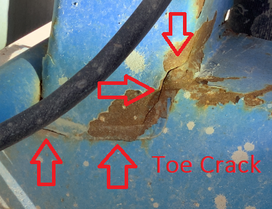

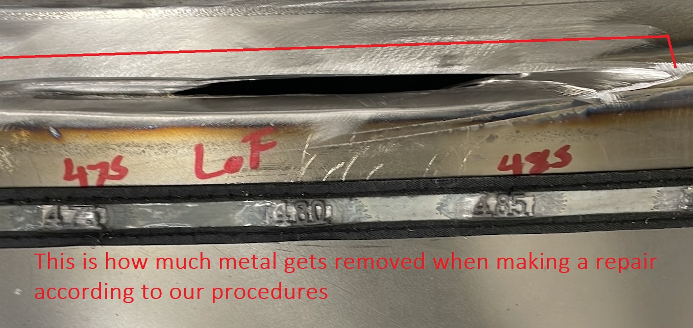

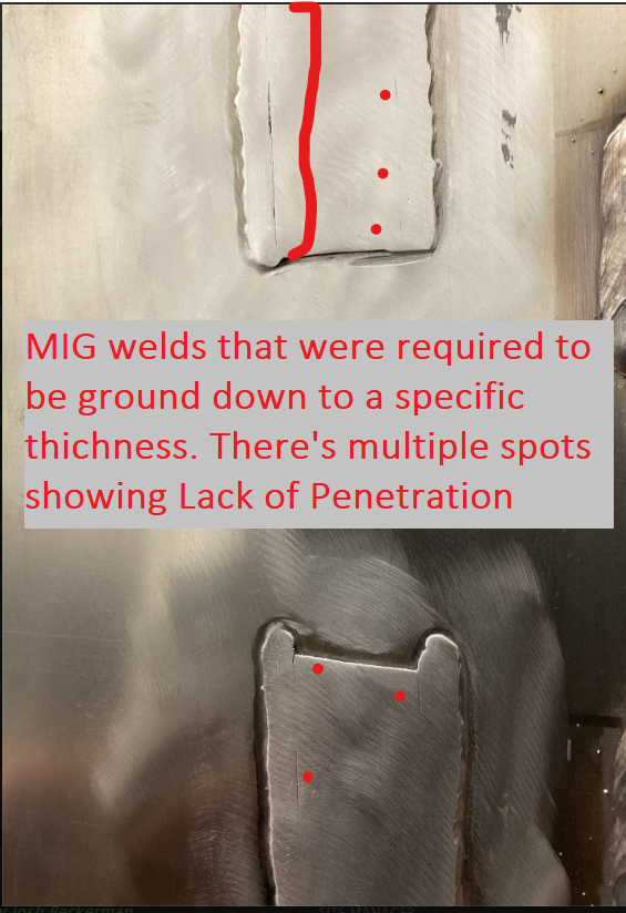

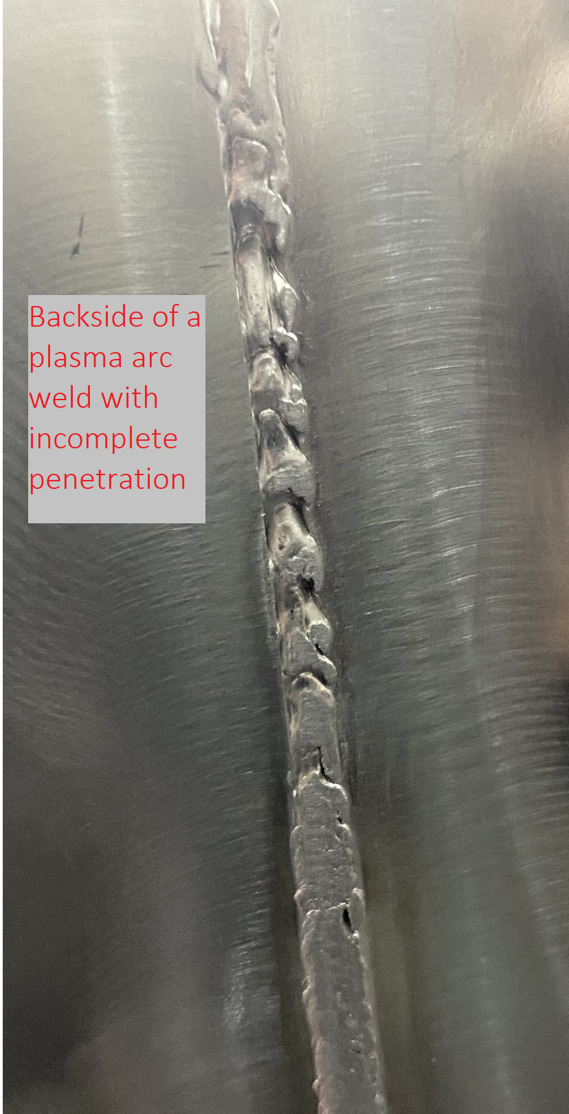

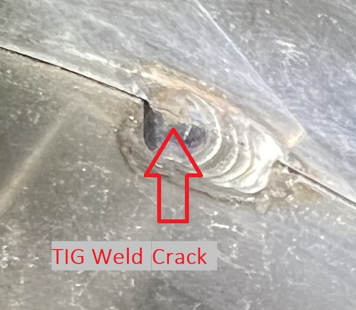

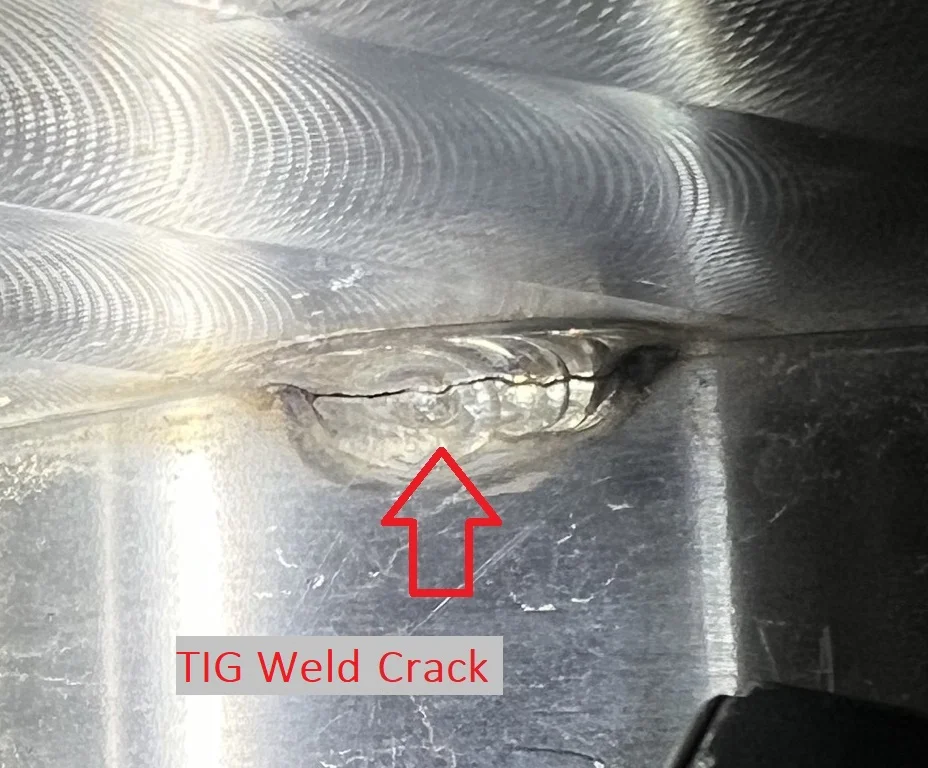

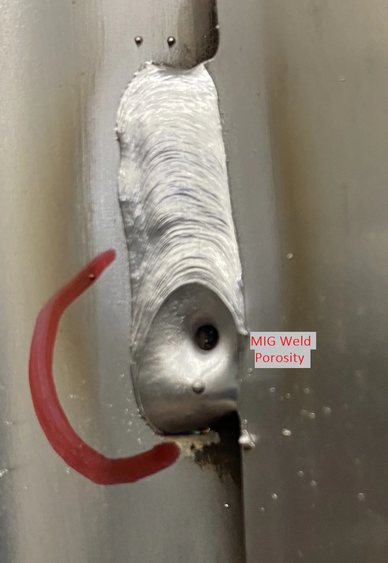

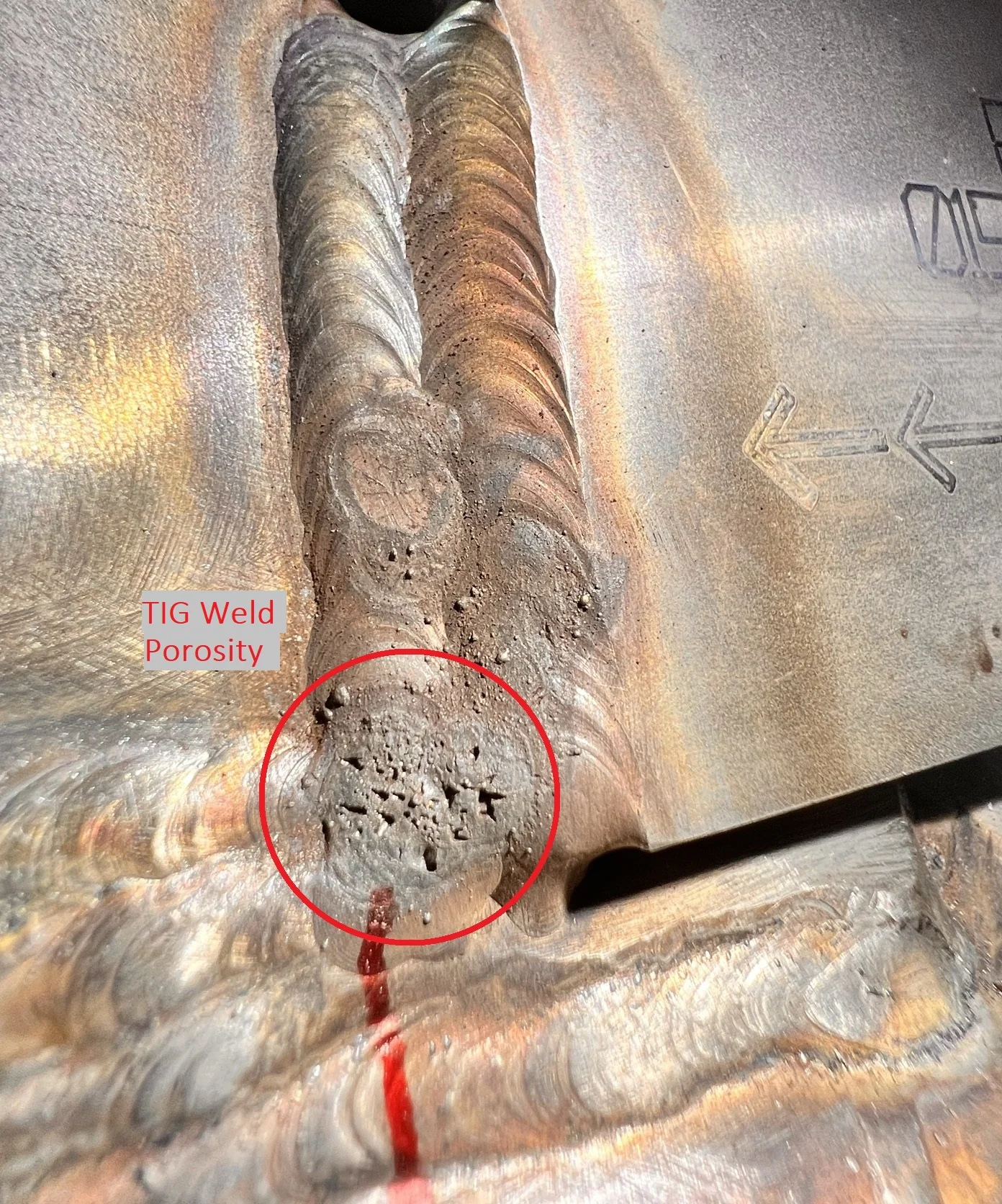

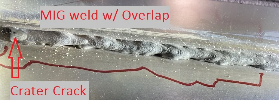

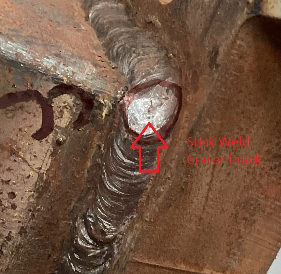

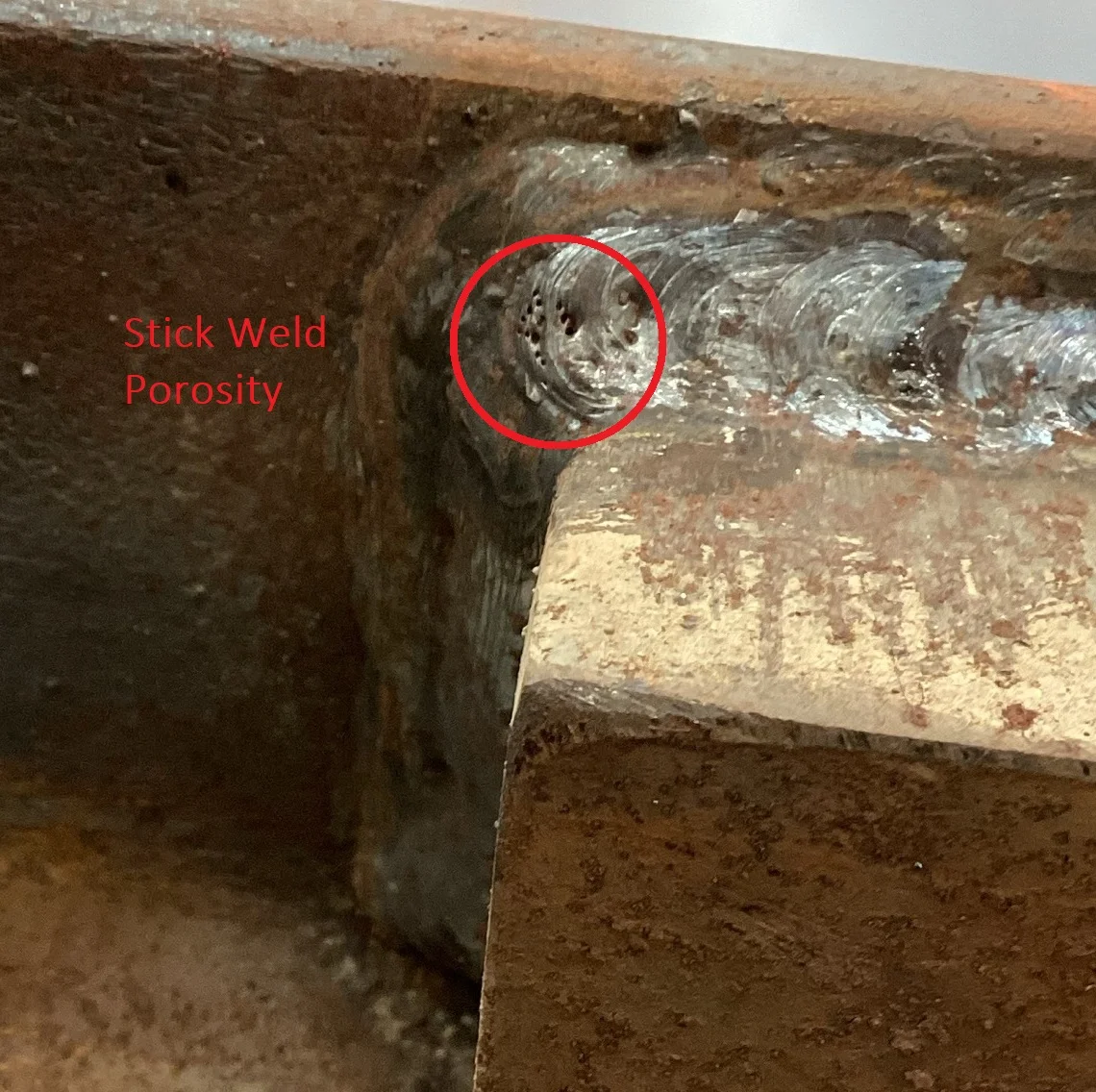

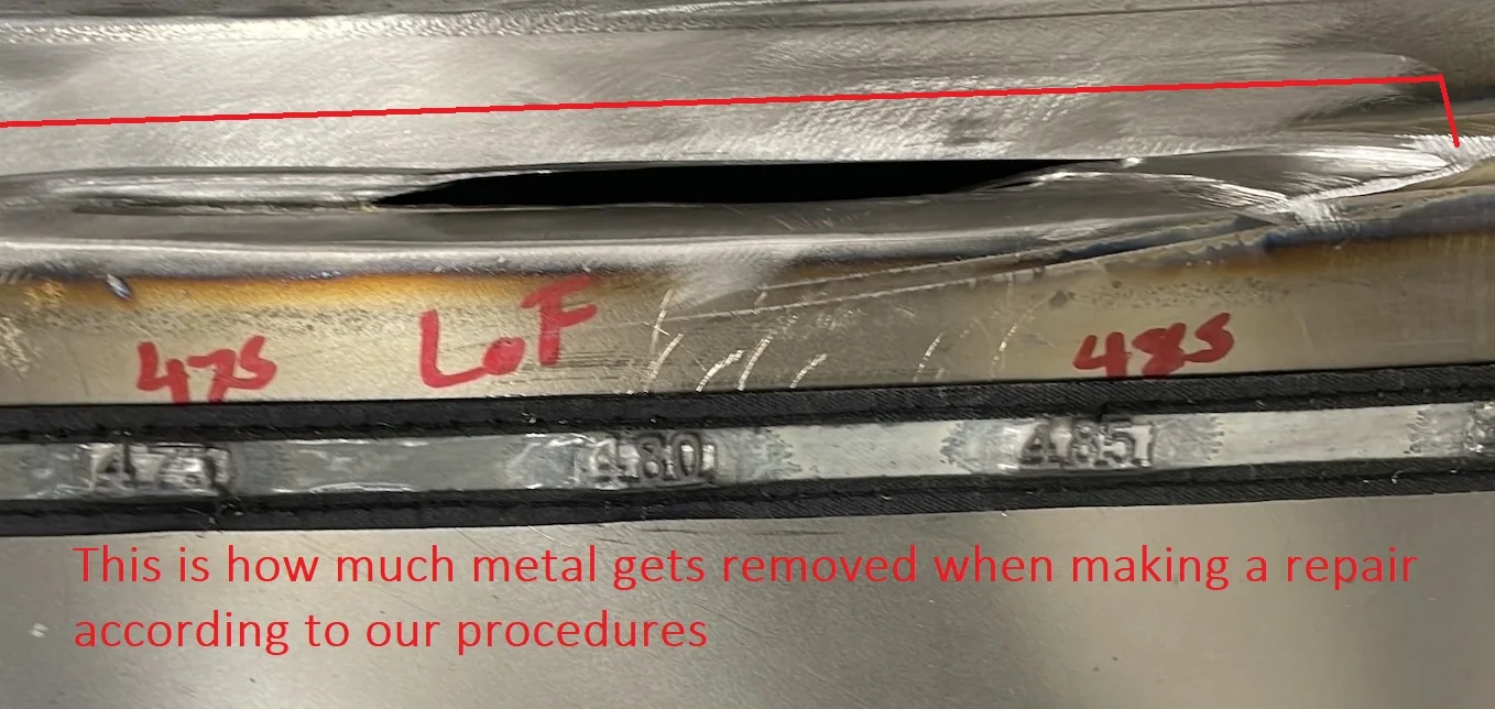

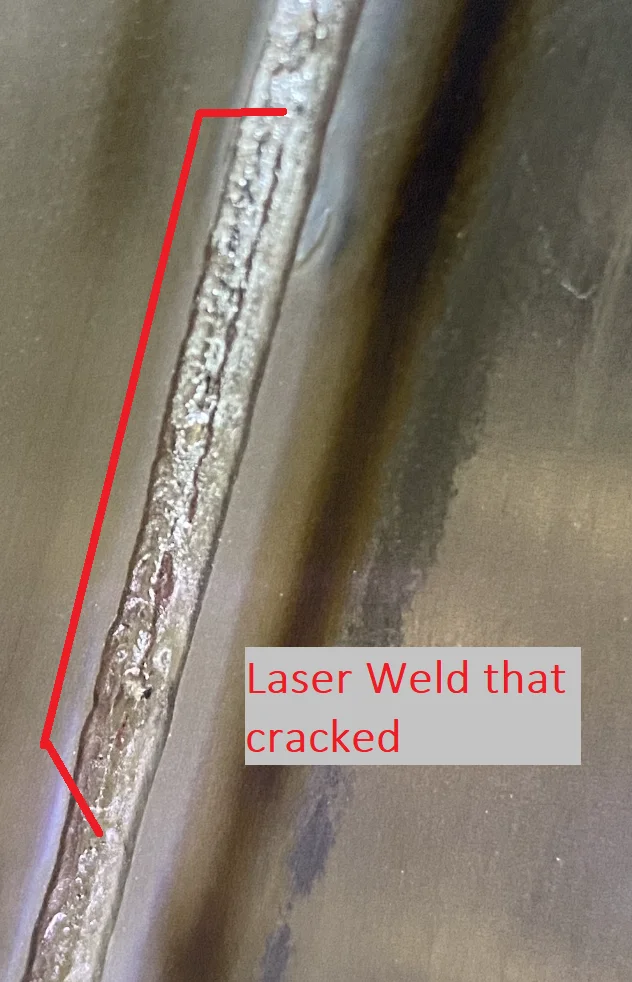

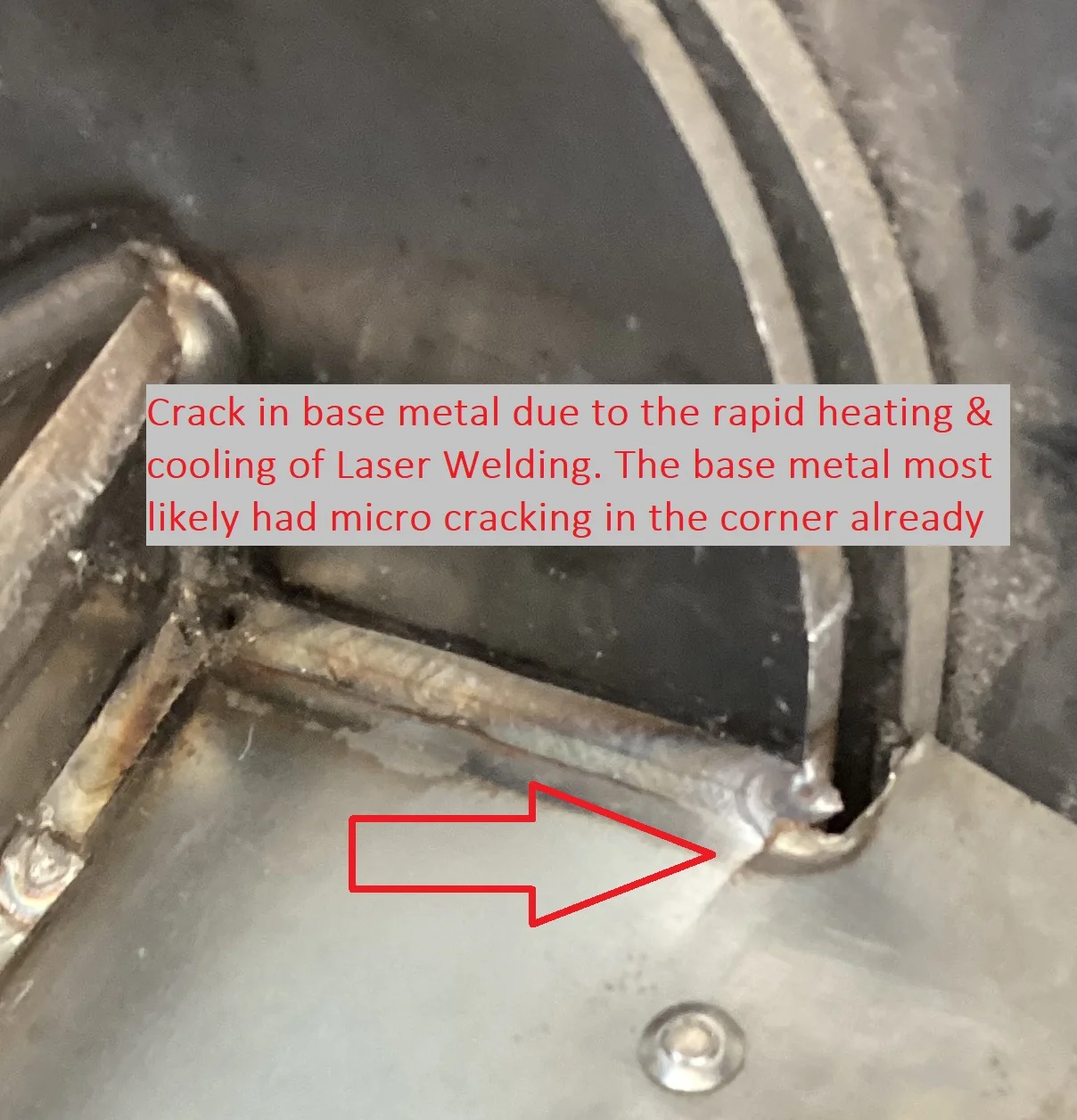

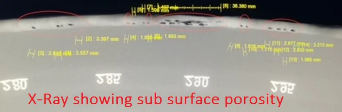

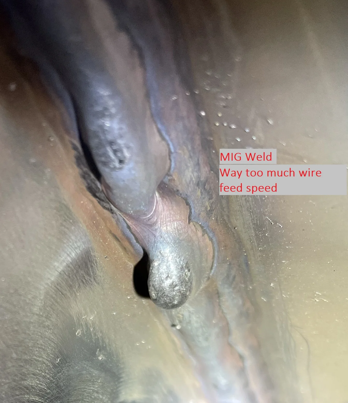

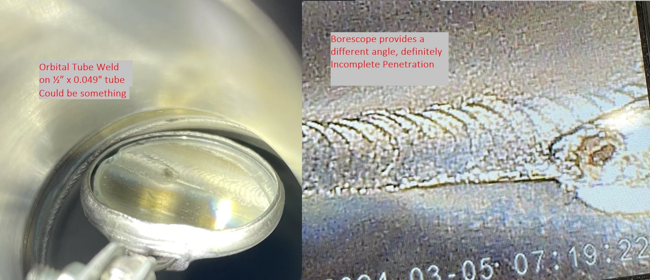

Something that I'd like to discuss is weld quality. I've seen a lot of welds on various structures that seriously make me question it's integrity. Some of those welds are on build threads in this forum. I'm not saying that every one is a bad welder, but part of learning is recognizing your mistakes.
I weld quite often, probably every weekend & even I sometimes put down a shitty weld. Instead of just looking at it and saying I'll do better next time, I grab a grinder, remove the weld & try again. Especially if it is something my kids safety depends on. I find that this is good practice because you can try to make corrections with nearly identical variables. Also learning to repair welds is an important part of fabricating. Inspecting welds takes time to learn also, but an easy trick you can do is spray some flat primer over your welds & trust me those defects will jump right out at you. You can also use a flashlight pointing at the weld from different directions & look for shadows.
This is mostly Stainless & different welding processes but these defects translate to most welding.

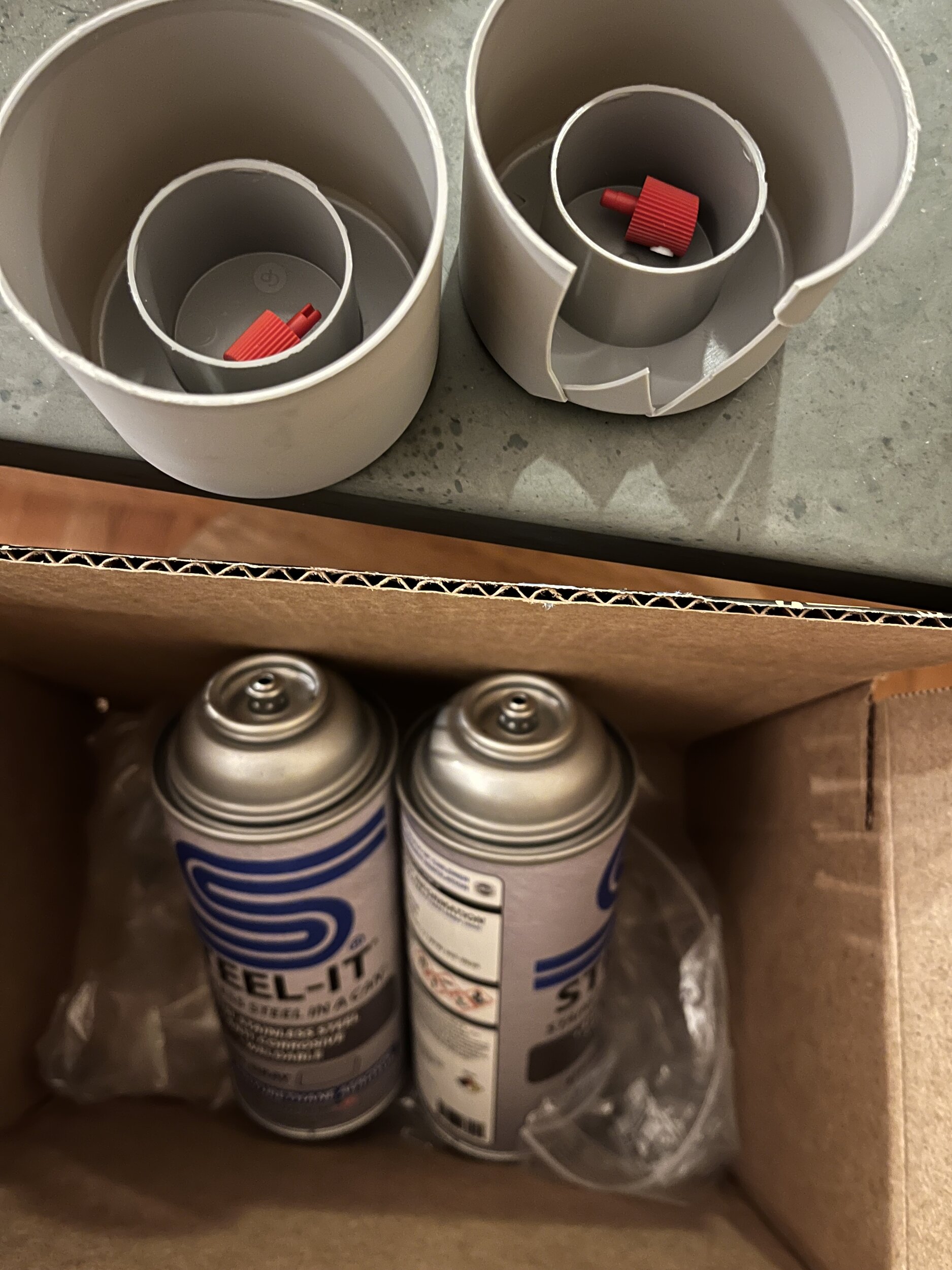

Good news / bad news. I got 2 cans of steel-it from Amazon today and they came like this with the nozzles out, caps off and one cap broken.
The good news is Amazon let me keep the cans and refunded me the $70.
Do you think I’ll be able to insert these nozzles without wasting all the steel-it and still be able to use these? I’d hate to waste them.
Nozzles on spray cans are easily removed and replaced. In fact, I routinely remove a nozzle after spraying, soak it in acetone, and then spray it clear with a compressed air blow nozzle so that it's good-to-go next time I spray. I wouldn't have bothered going for a refund for those cans.
Reactions: Apparition
well dang - I’ve had nozzles come out and never successfully gotten them back in before without spraying all over. So I didn’t know this was common.
I’ll see if I can get these working. Might have just got myself 2 free cans of steel it with just a broken cap! If so I’ll feel a little guilty … might have to call Amazon back and pay again.
