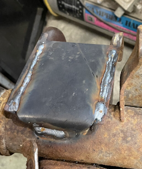

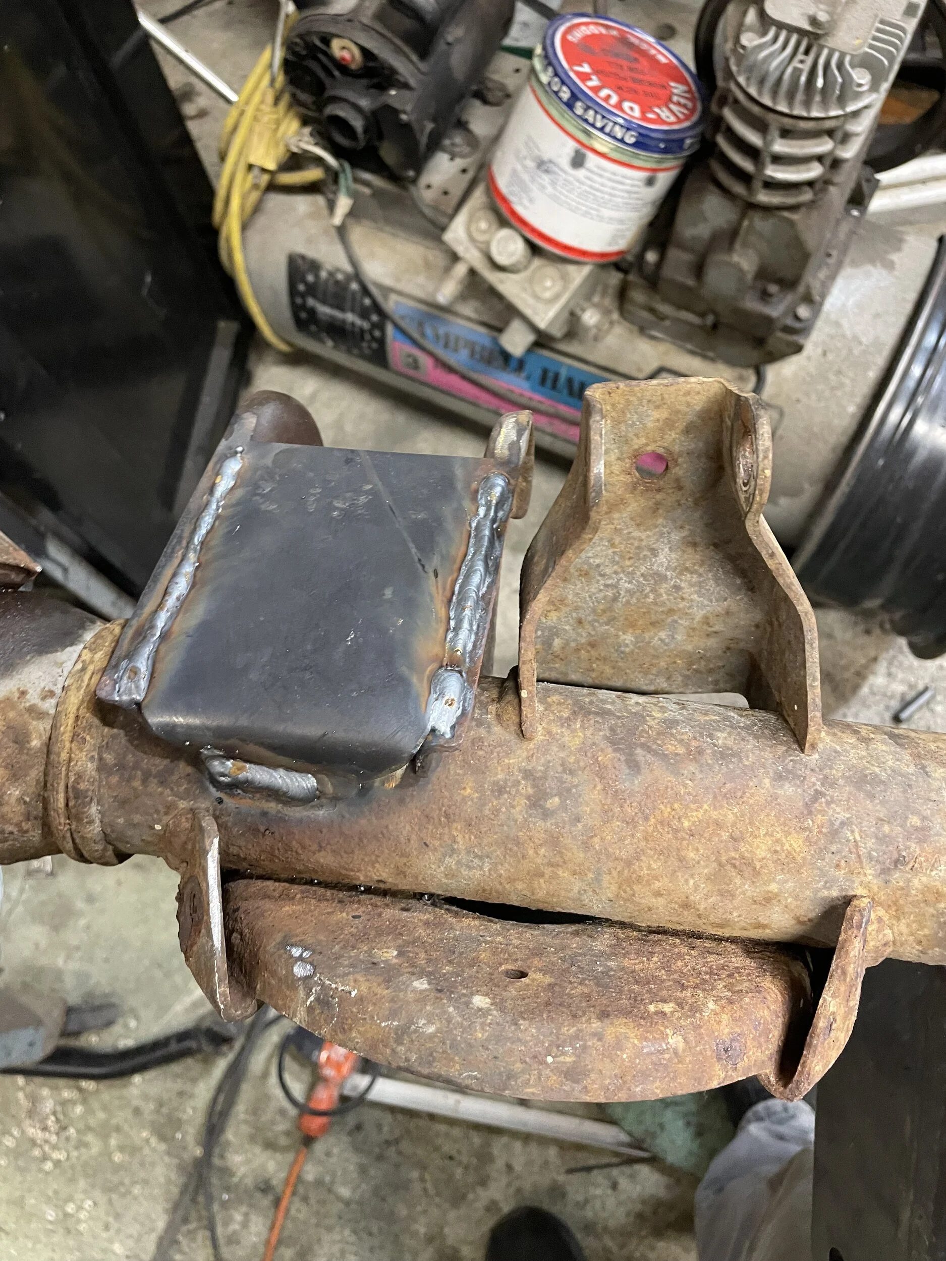

Mine just suck but it’s good enough.
Reactions: BC Moto
No they don't. I've seen way worse.
You were moving too fast on these welds
The other bracket looks great.
Also, it's hard to tell, but did you remove the rust/dirt before welding.
Yeah, I removed the rust, just ran a flapper wheel over the areas that I was going to put the bead. I may need to turn down my welding helmet a notch so I. An see the puddle better

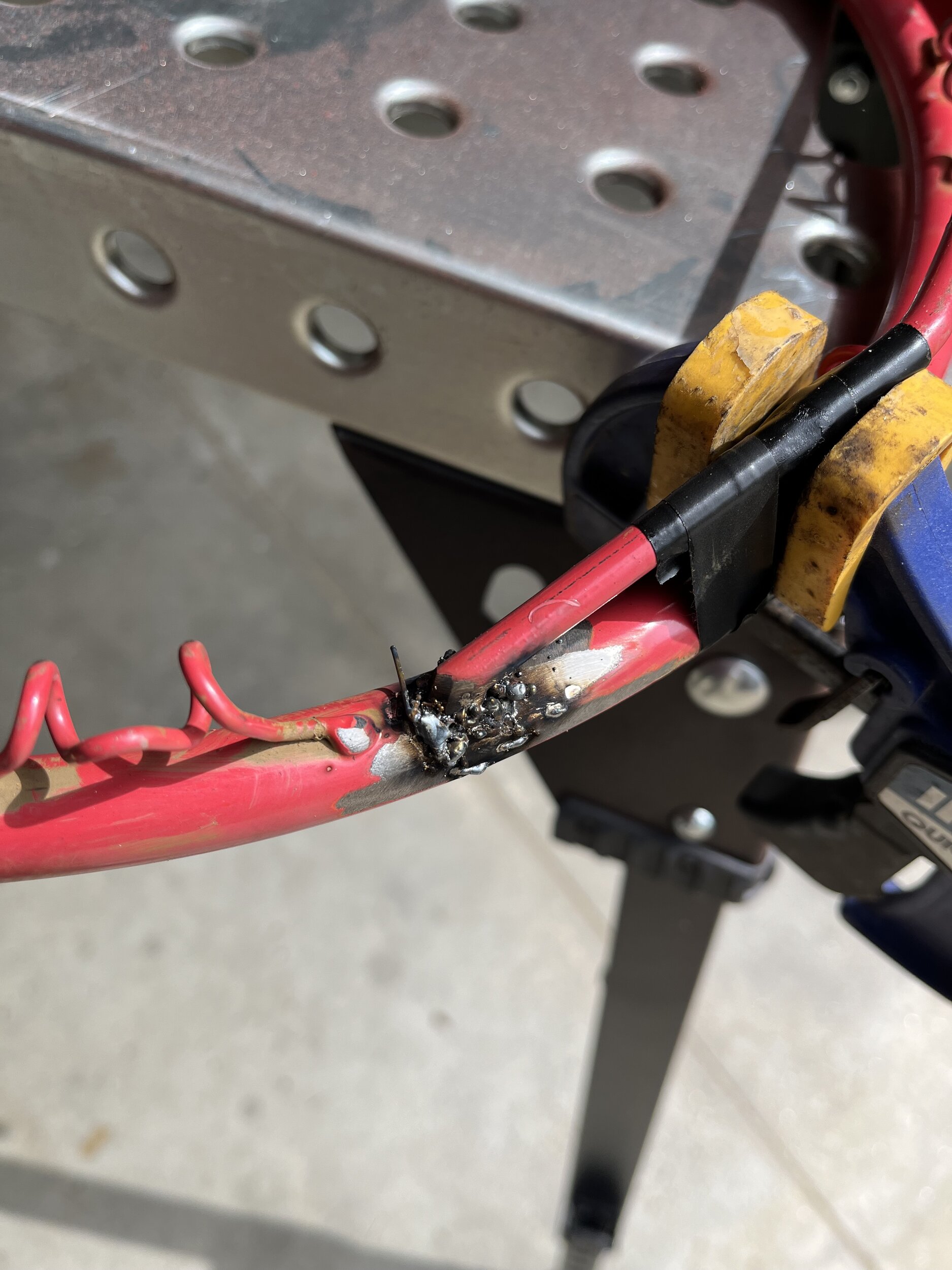

Alright - for your amusement, I present to you, my very first weld! Or first since shop class anyway.
It’s my son’s basketball hoop; the brace broke at the factory weld. What a perfect test subject. Only thing is I don’t know how thick or what kind of steel it is so I went with low voltage and dialed up the wire speed as I went until it more or less filled the holes and stuck metal to metal.
It was good just to figure out all my gear - the helmet, the gas regulator, even the welding table & clamps. And - I didn’t die!
My favorite part is the wire sticking out of the glob. I thought you guys would like that! What a travesty.
Now that this ugly thing is done I’ll move on to some 18 gauge coupons in preparation for body panel patching on the jeep. Fun stuff!!

I applaud you for the balls it took to post that on here! 🤣🤣🤣

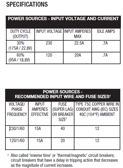

Owners manual states for 230V, max input is 22.5A (30% duty cycle).
However, that same page recommends an input of 15A, with 40 amp breaker, and #12 wire. This seems incorrect. Or am I not reading it correctly? For an input of 20A, sure #12 wire makes sense. But at 22.5A, I would think #10 would be a better wire choice. Including a 30A breaker vs 40A. Thoughts?

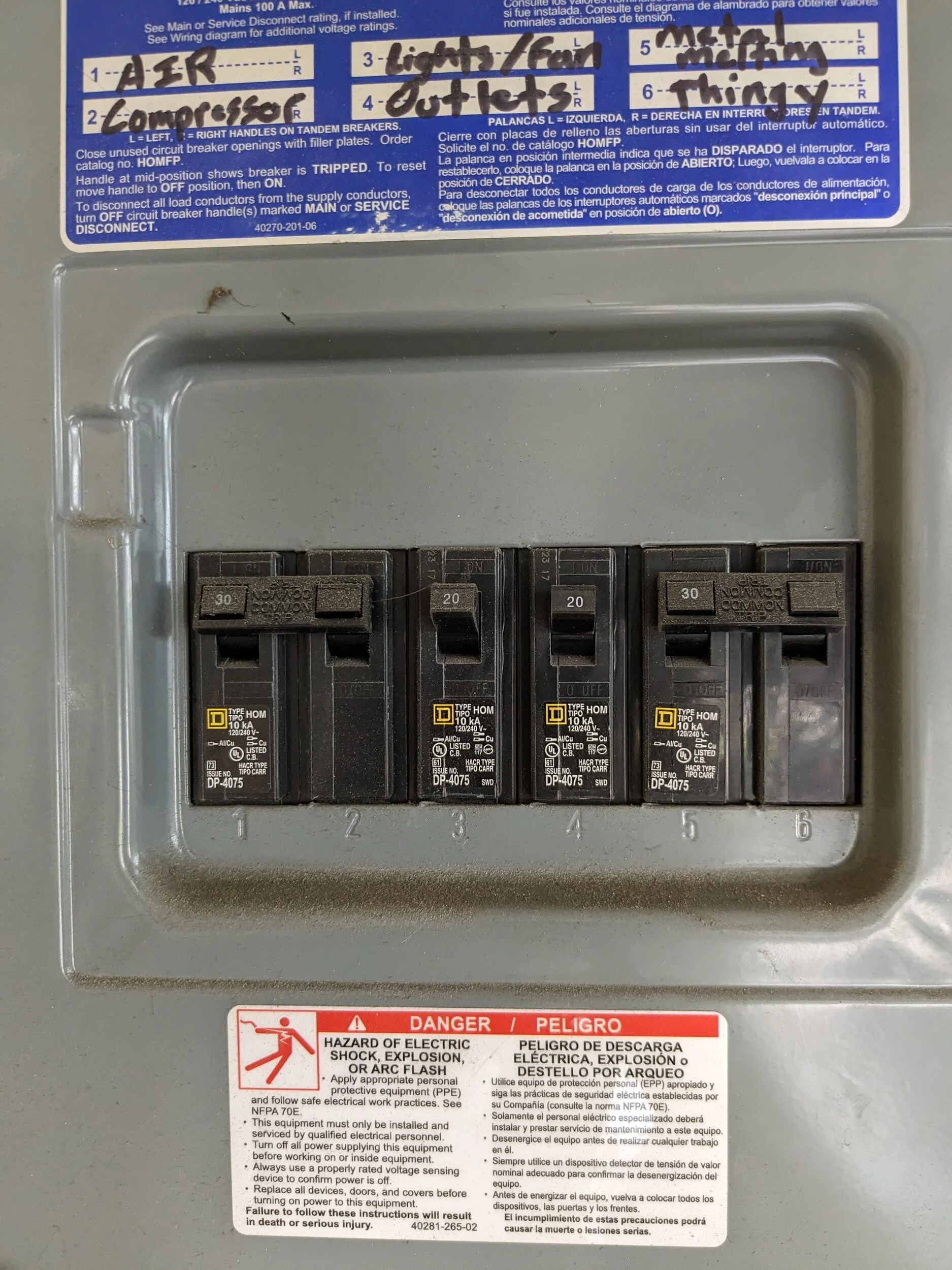

I've done this twice & never had any issues. I did it this way because I've never had the main panel inside the garage.
Ran 10/3 from the main panel to a sub panel in the garage on a 70 60 amp breaker. The sub panel is set up for the welders & air compressor each on its own 30 amp breaker.
You could get away with just a 30 amp on the main panel with 10/3 to an outlet in your garage. I only did it my way for easy maintenance if it's required.
Often times the machine will stop itself before the breaker does. But if the manufacturer suggests a 40 amp then I'd go with that.

1) #10 wire would support the 22.5A required input. #10 should be able to support 30A easily. #8 would support 40A.
2) A 30A breaker would protect the #10 wire. A 40A breaker would protect #8 wire.

That wire size recommendation isn't apples to apples with what you're likely to use...the NM-B stuff typically used in residential is a 60C insulation, sheathed and run through a wall cavity so the allowable ampacity is different than what that chart shows for 75C in conduit.
I would think you could probably get away with a 30A breaker and 10awg wire but it would suck to have to redo it if I'm wrong. And if you can get 8/3 cheaper then might as well go with it.

Good catch on the 75C. I completely overlooked that!
